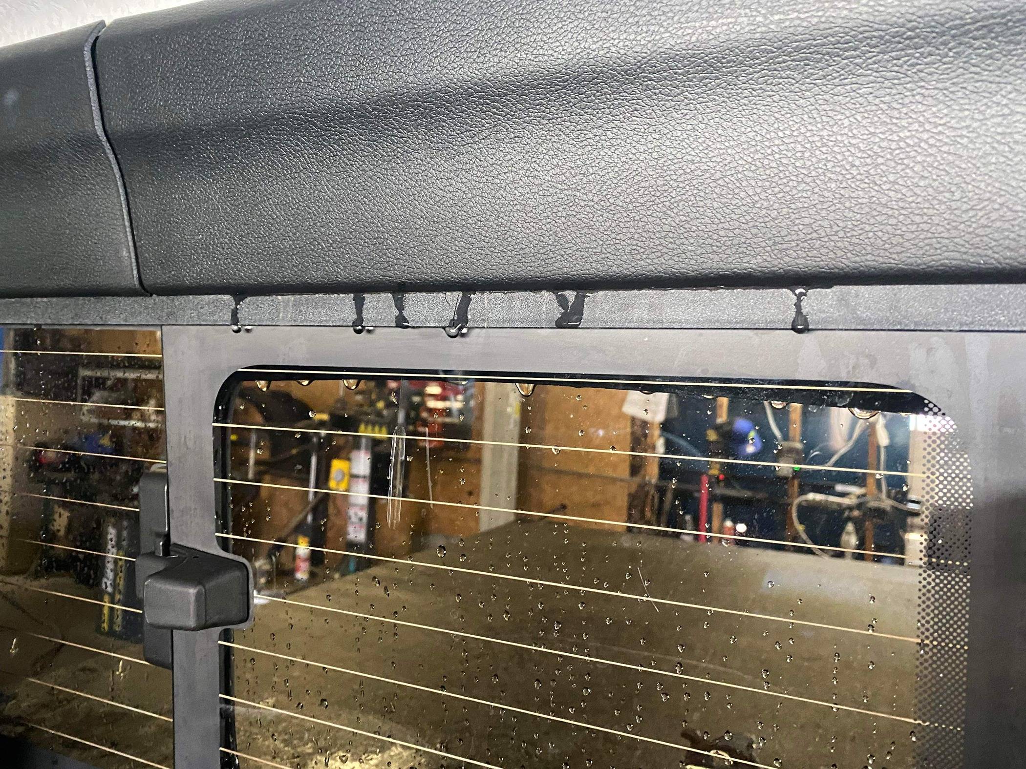

Mine had NO plugs on the floor! The holes were empty. Found out doing an electric step install. Also make sure the front hood vent/screens are clean and not full of leaves/dirt. Also, mine just started leaking from the rear window, very common.

Looks like it's getting in on the back window (see picture).
Any idea what a dealership will cost to fix this? Or is there a recall?

Is this
Going to be my best option??
I live in upstate NY
We get some extreme weather. Better to go to dealer or do something like this?

I just did the silicone rubber fix, took about 30 min. Dry so far. Be careful with the dealer, there appears to be no real fix, the new window installed by the dealer chosen glass shop will leak within a year or two, again. Also, a lot of JT's are ending up with dealer installation damage to the paint, and other surfaces.
