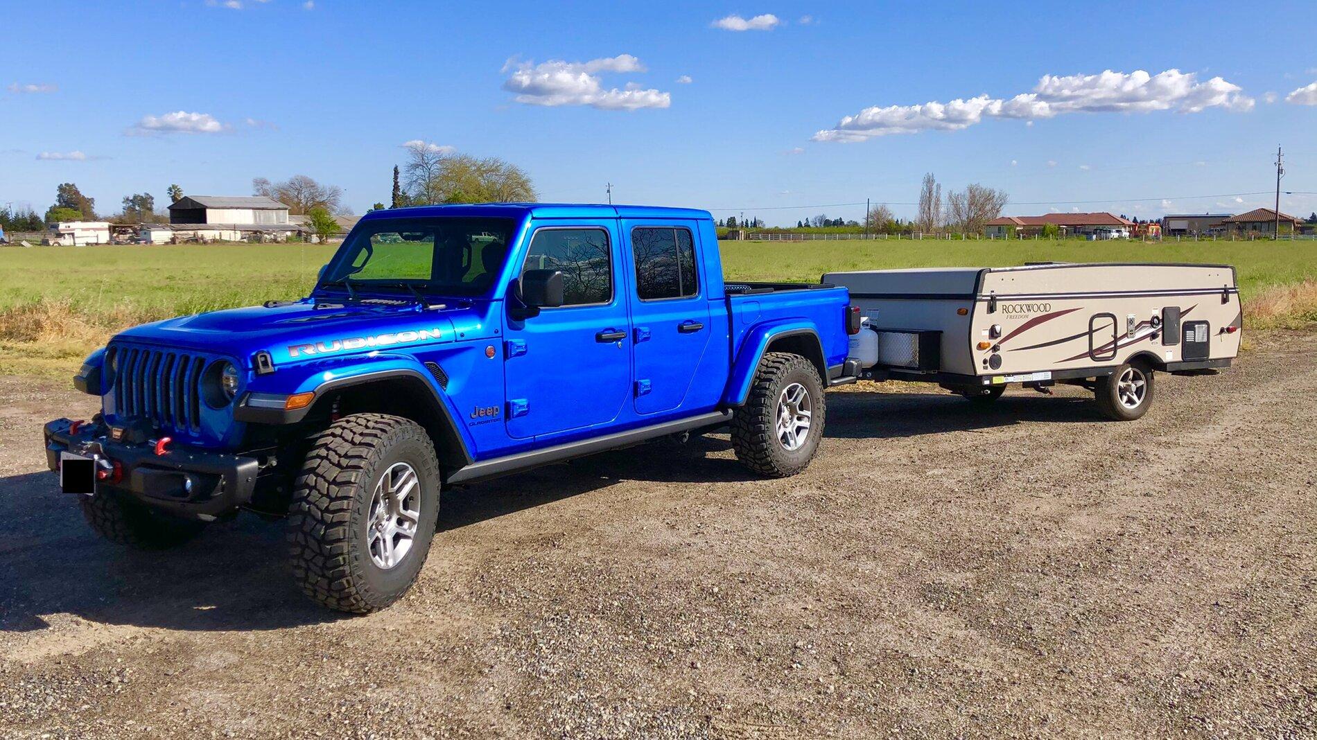

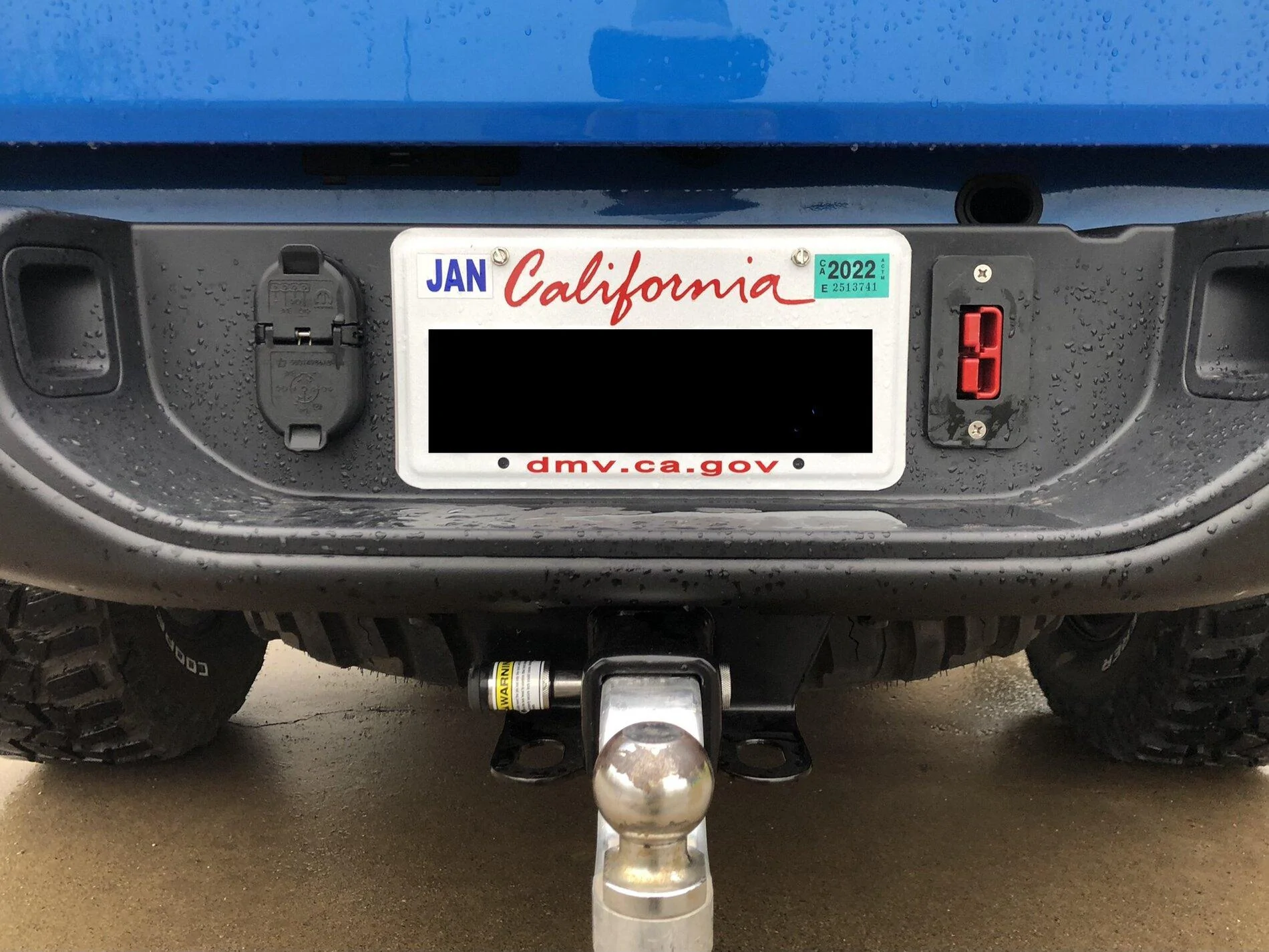

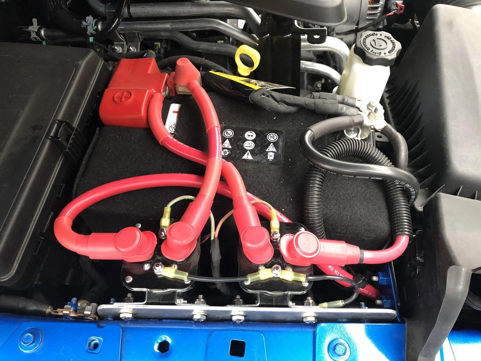

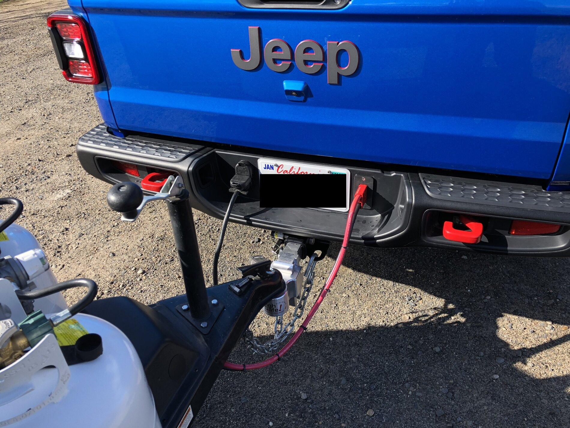

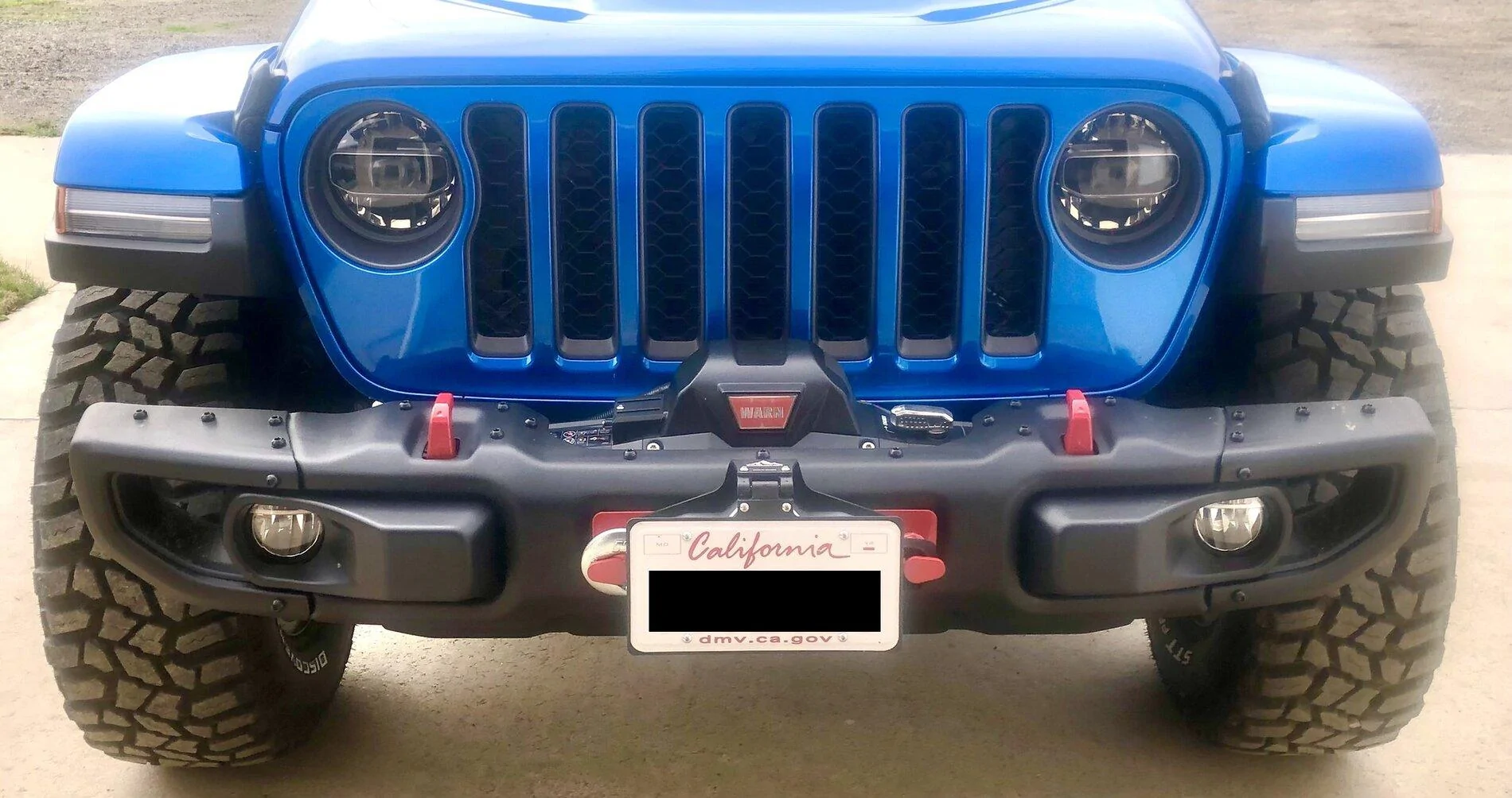

I posted this in another thread. I hope this helps you out.
This month I installed the Warn winch, the wiring and Anderson plugs for the DC to DC Ctek 250SA/120S charging setup in the tent trailer, and the two 500 amp continuous duty solenoids (controlled by the Aux dash switches) that direct power to the winch and the DC to DC charger.

very nice, very clean. where did you get that SB50 mount?
Limestone
Sep 28, 2019
81
150
California
2021 JTR
Search Jamdon Gear
Search JamdonGear on Etsy. They also have a similar housing for the 50amp anderson plug. Mine is the housing for the 175amp plug. If you decide to mount through the bumper as I did, be aware that the outer surface of the bumper is plastic, but the inner part is steel and there is a gap between them. Also measure carefully as there is not a lot of suitable area on the back surface of the bumper for mounting. If you need more i formation, just let me know.

Many people are surprised to learn that the standard trailer plug and wiring will supply only around 5 amps to the trailer. A DC to DC charger on the trailer supplied by heavier gauge
wiring from the truck alternator is required to efficiently charge the trailer batteries and supply any additional load requirements.
