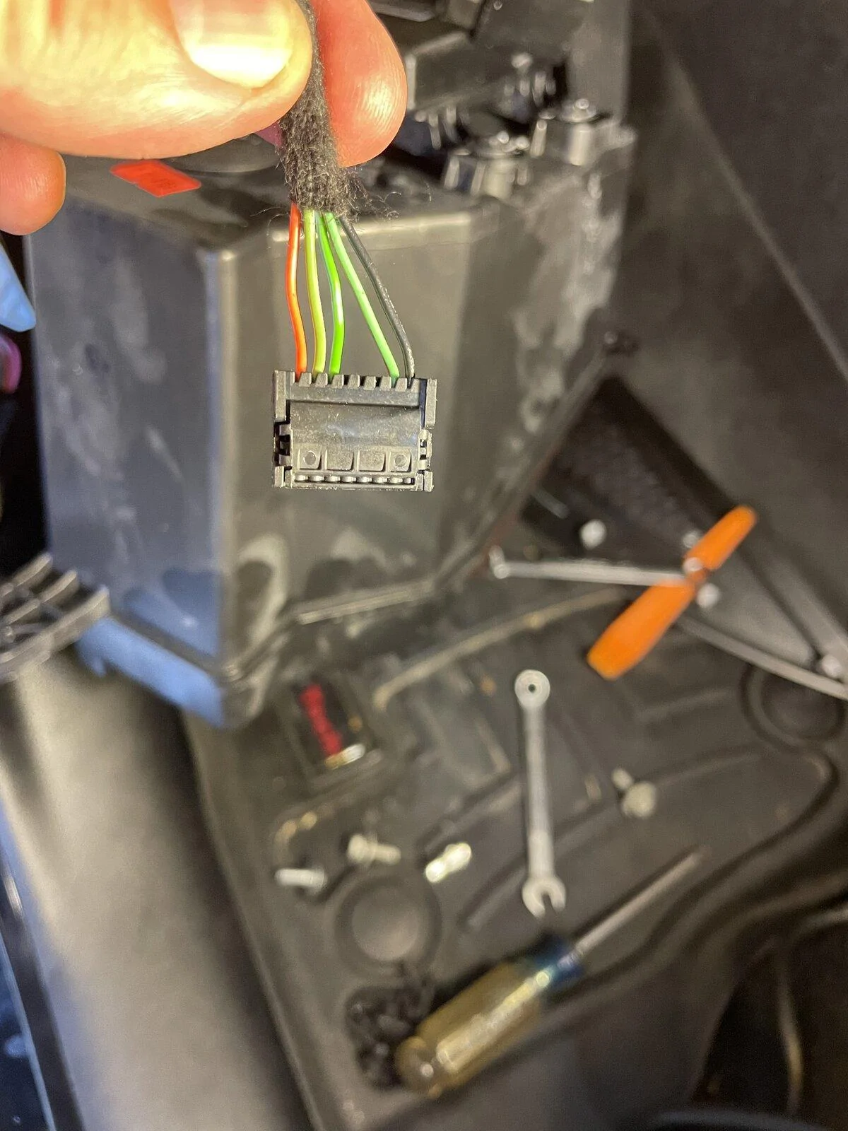

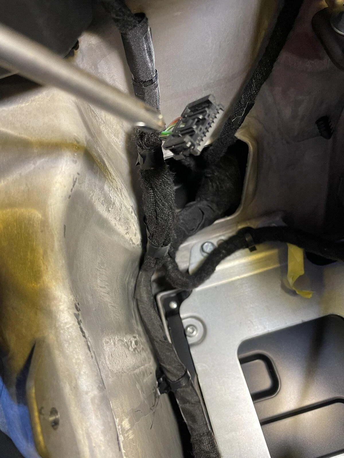

I went looking for my trailer brake controller plug today. Below you will see two pics of a plug that I found that was taped up behind my driver side speaker pod, this was the location I was expecting to find the trailer brake controller plug. Can anyone identify what purpose this plug would serve.
Has anyone else have a tow package without a trailer brake controller plug and how did you overcome it. The recommended wiring harness PN82216416AA is not available.
any guidance would be greatly appreciate.

I know that's not the plug, I ask if anyone could tell me what that plug was for. I have also checked under the kick panel, still no trailer brake plug.

I was hoping just to do the plug and play, my back up is going to be the blue tooth brake controller. I was trying to avoid pulling wire and if I have to, I was going to use a
brake switch from E-trailer.
I appreciate your input, very informative.

I have a 2021 Diesel also. Has tow package. I found the trailer brake plug under the dash just to the left of the throttle pedal. Couldn't see it but stuck my hand up there and found it on top of a harness of other wires. Works like a charm. No re-programing needed. Have not seen the other plug you are asking about.

Thank you, I haven’t checked that area.
