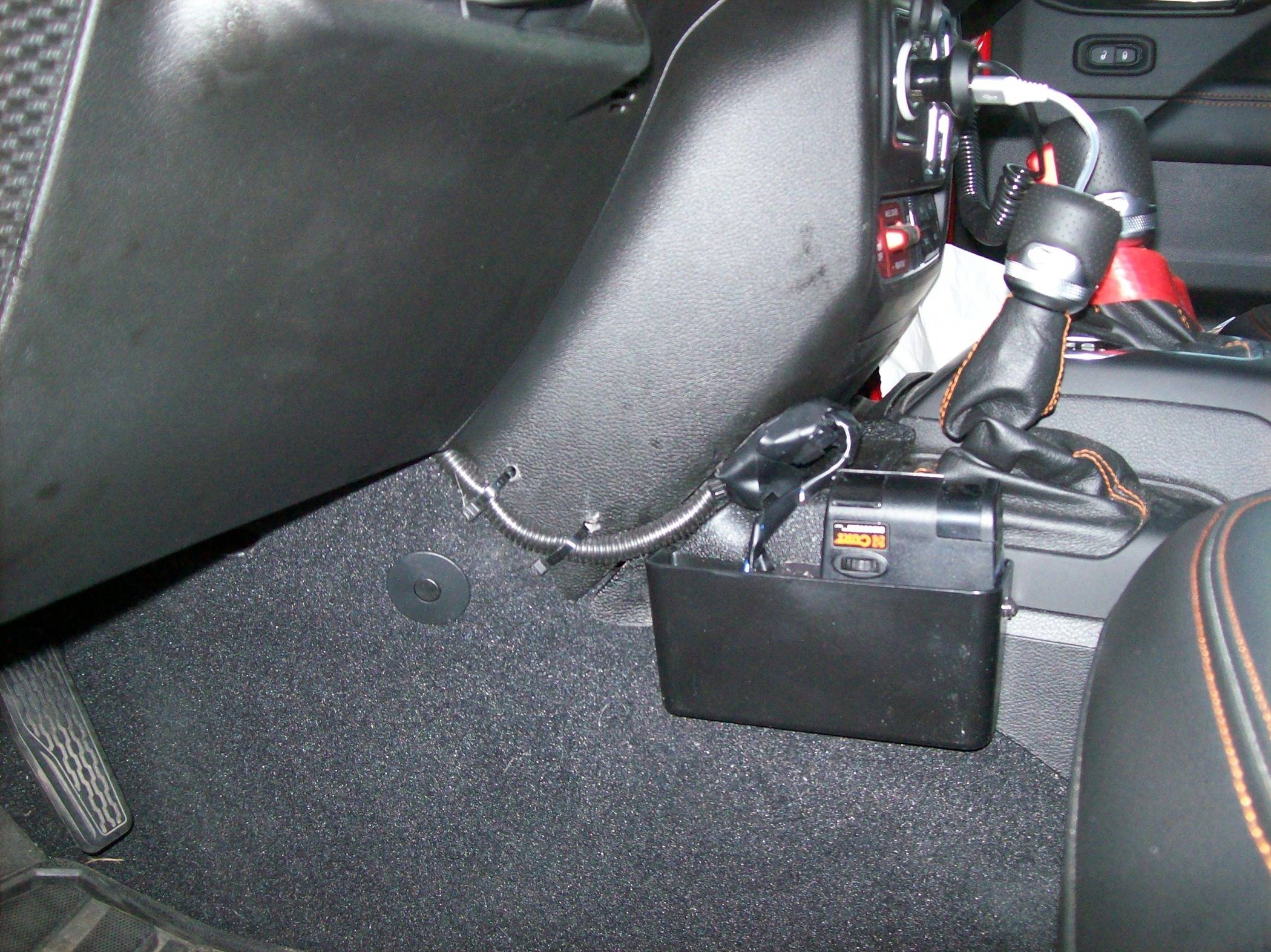

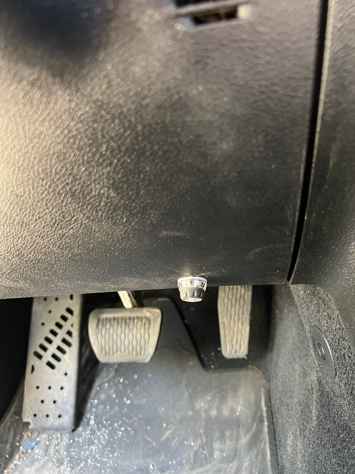

Curt Discovery 51120, harness 51527. Controller mounted in amazon saddlebag type side pocket.

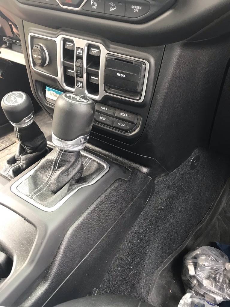

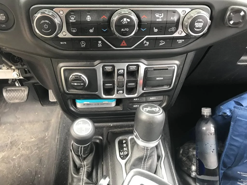

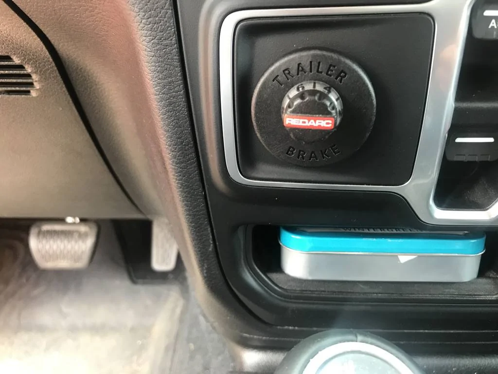

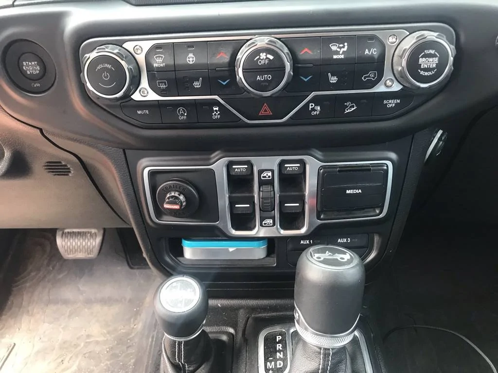

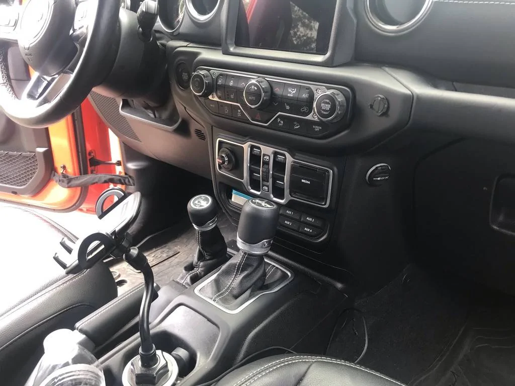

I also went with the Redarc Tow-Pro Elite Electric Brake Controller and have no complaints. I opted to relocate the 12V Aux plug to the passenger side of the dash which I now use primarily to charge my phone. Before and after pics are attached.
At the time (Apr-21) Redarc seemed to have the best reviews with better capabilities and more installation options due to its small size. Redarc has both Proportional (inertia-based) Activation and Time-Delay settings PLUS a push button manual trailer brake override for emergency braking if needed. Again, I did this in Apr-2021 so not sure whats changed since then, but I had these comments in my notes about the Mopar and Curt options:
Mopar - gave me too many concerns about installation and harness issues so decided against it
Curt Spectrum - looked very nice but only allowed for manual override when controller was set to it's highest setting (10)
Hope this helps!
