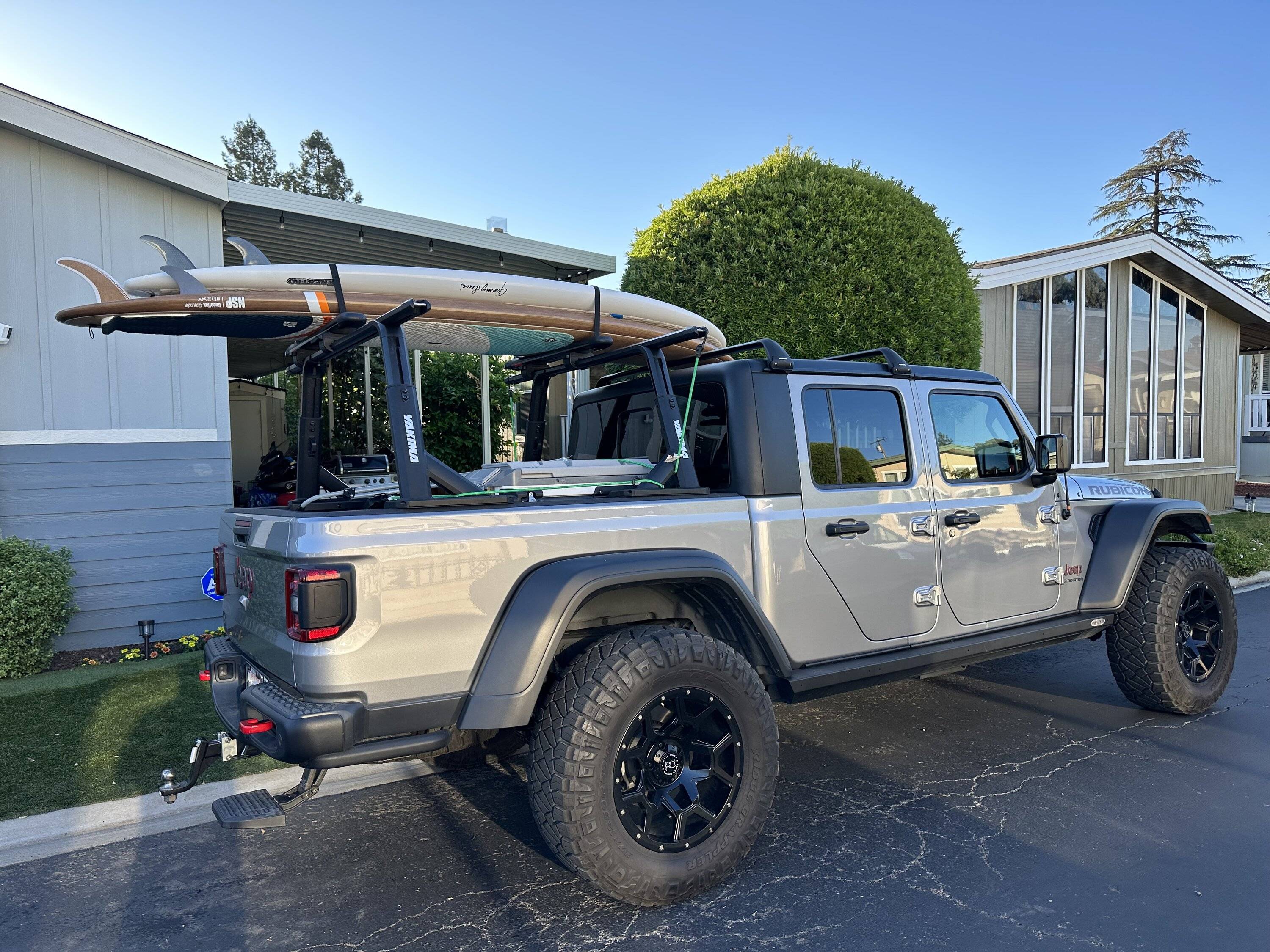

Lahaina Hi
2019 Jeep Summit
I’m looking at some shocks and wanted to see what everyone thought of the SDI set up. I’m running about 60% on road 20% on sand in 20% trails and no rock climbing.
thoughts?

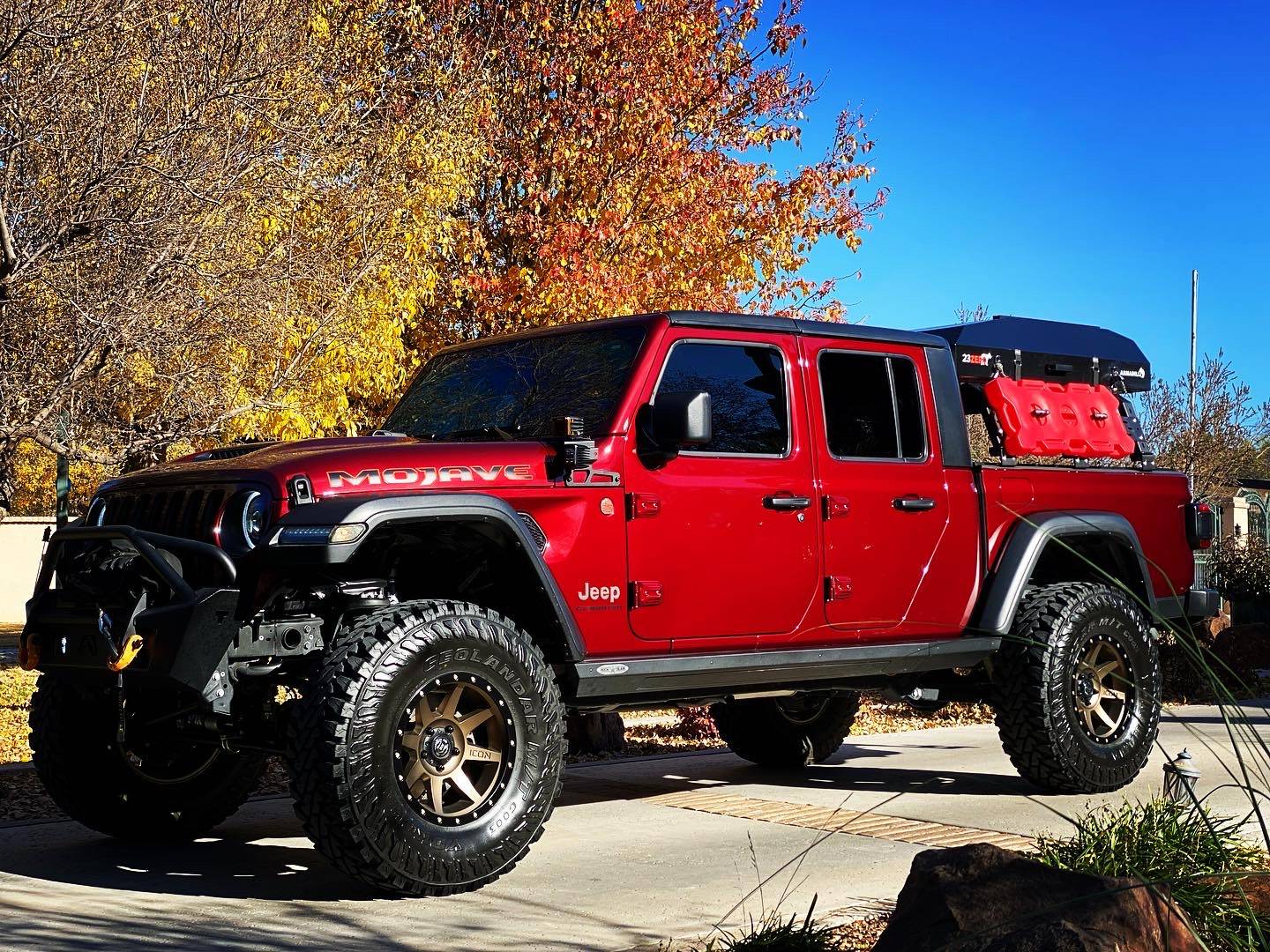

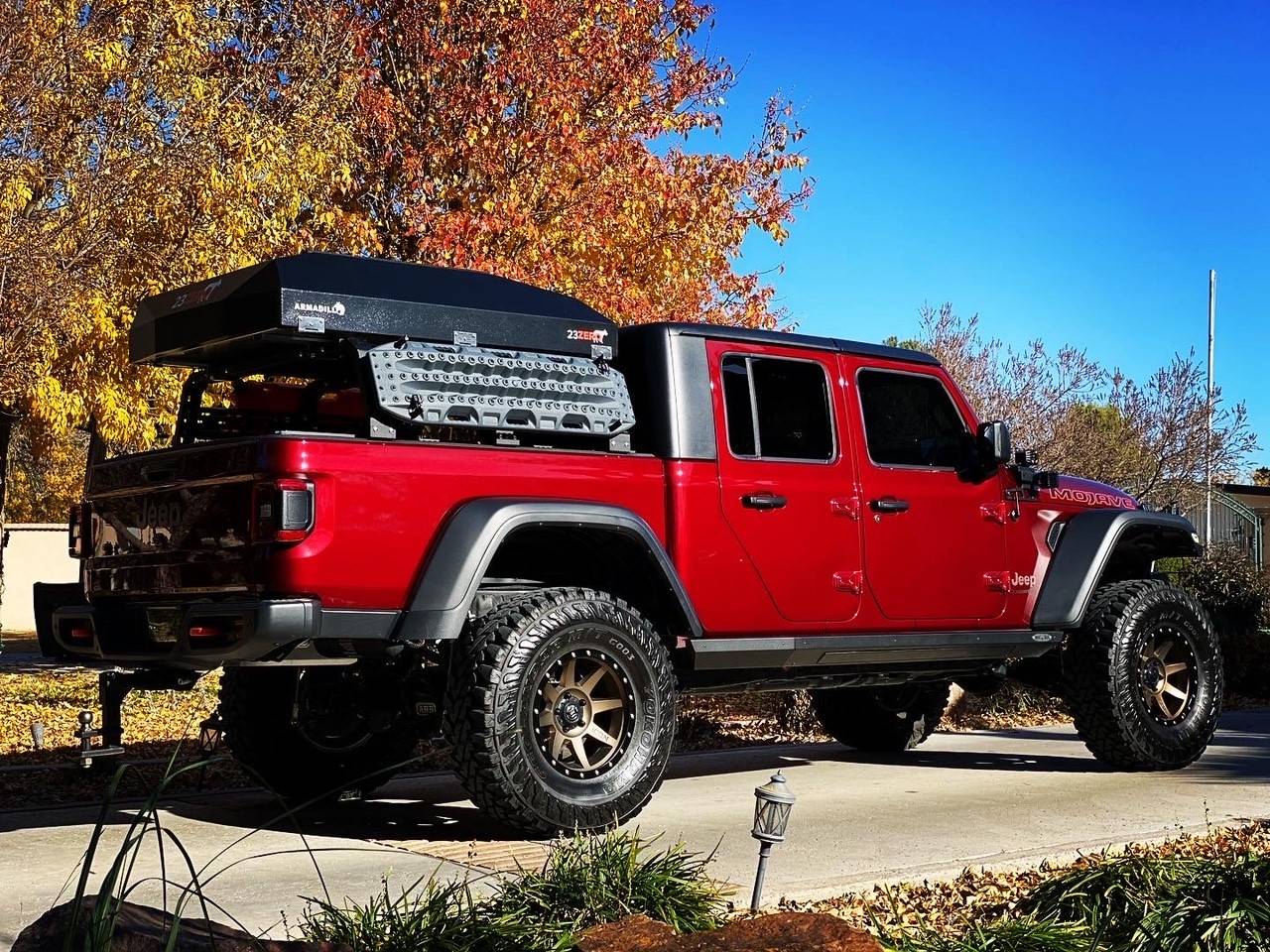

Tony,
thanks for the post. I'm considering options for suspension and would love some feedback for my rig. Here's a couple pics for reference. Please DM so we can chat. Thx buddy!
Jeep Gladiator SDI Full Suspension 2.5” lift - feedback / reviews? Glad6
Jeep Gladiator SDI Full Suspension 2.5” lift - feedback / reviews? 27163B6A-24ED-40D5-BDB1-BC5BD07AE454
Jeep Gladiator SDI Full Suspension 2.5” lift - feedback / reviews? 7357C545-F034-4F49-9220-ECBE689D90CF

Tony,
PM sent!
