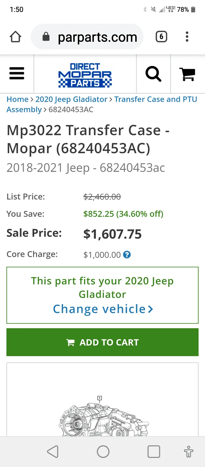

So I am wondering if this just bolts in
Jeep Gladiator Selec-Trac Retrofit Screenshot_20210123-015052
I read some marketing material that said selec trac takes input from wheel speed sensors. I can’t find it now, but that’s the only thing that gave me pause. If that were the case, it would seem that the vehicle would need to be flashed for the different TC. Wish someone knew for sure.
