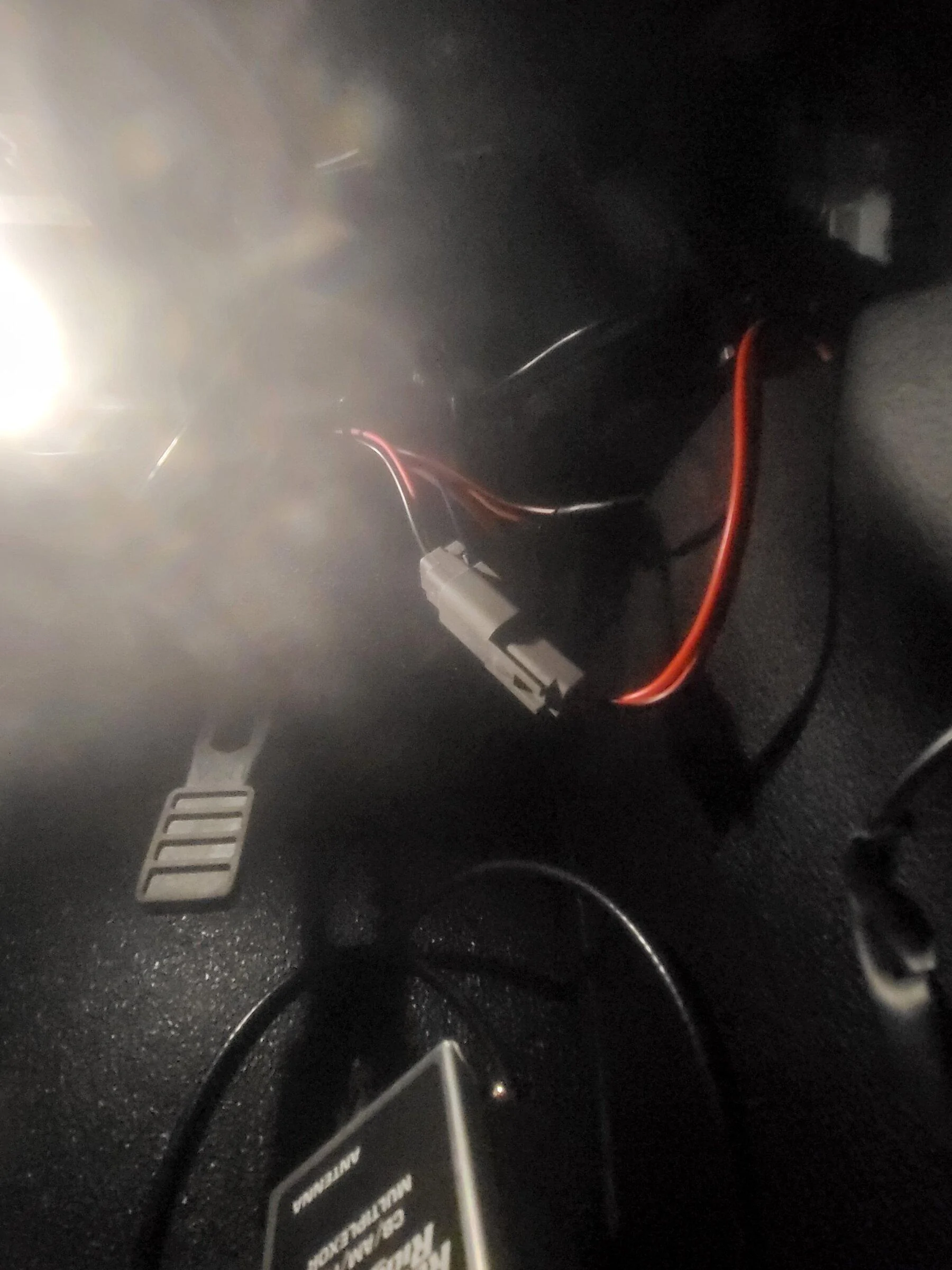

Playing around with my GMRS radio and I shorted out a mystery circuit.
It's on the passenger side footwear, but isn't the aux wires.
It goes behind the panel for the door connector and disappears.
Anyone know what circuits are back there?
I didn't install the radio so I have no idea what it's tied into. But there can't be that much in the passenger footwear door area.

Not really under the dash. It's behind the passenger kick panel. Was hoping that would narrow it down.
Freaking pins on a cheap connector pulled out and touched.

Wires run to a big plug behind that kick panel

What big plug? The door connector?
Can you get a picture of the plug?
Runs to what appears to be a pink wire, black wire right up under the dash
What ever that plug runs to is the circuit. Just don't have a clue what it is.

I thought on Wrangler that's the side the wiring going back to the trailer connector follows......... at least if you add it, that's where you are supposed to run it.
