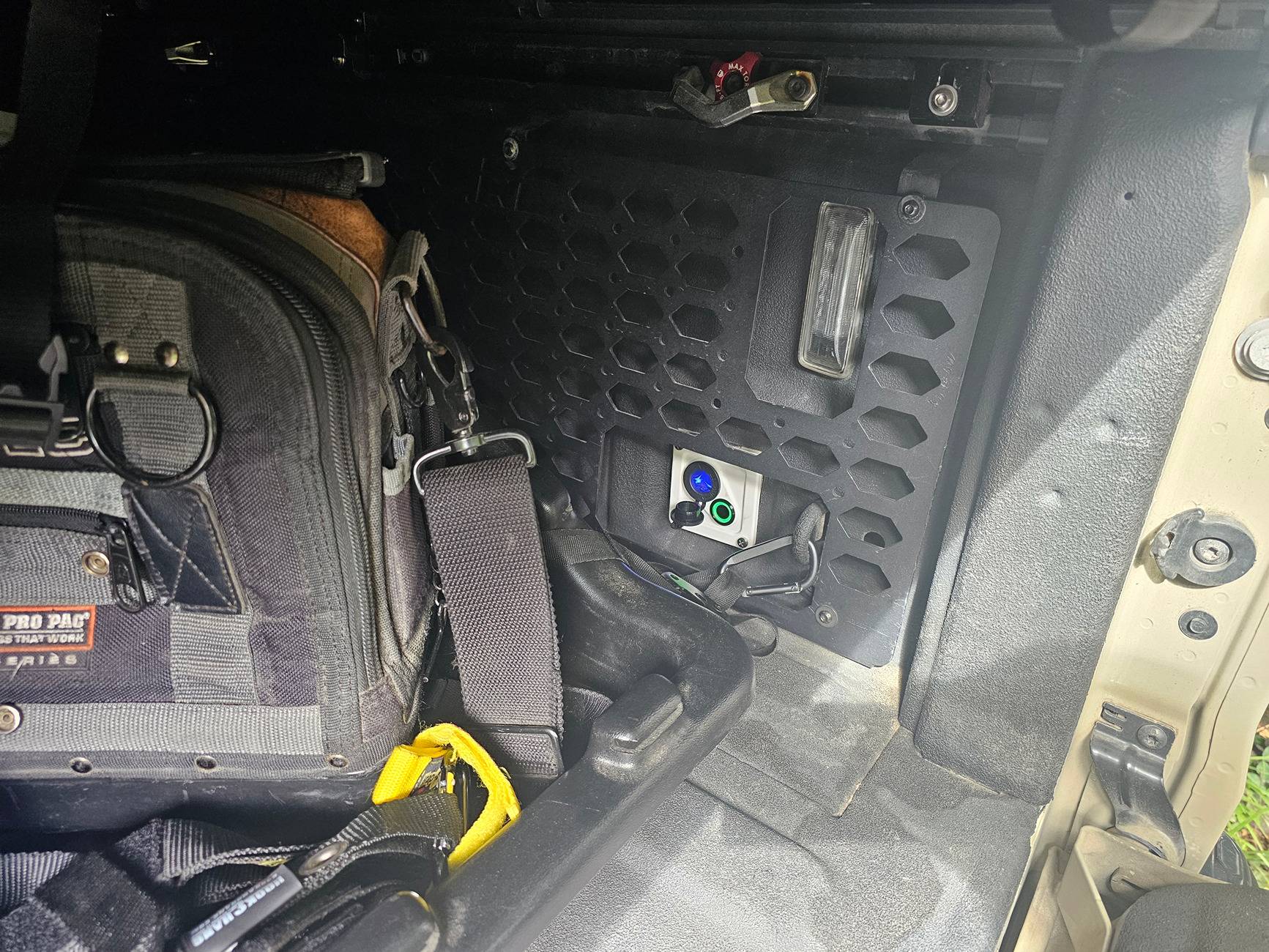

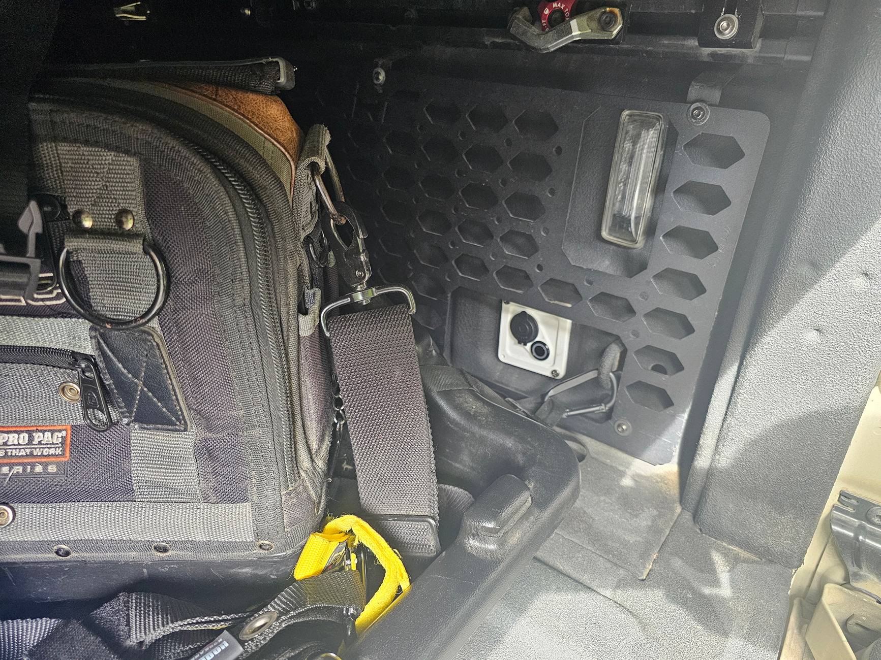

I did something similar, just using the factory aux switches. Tapped into factory aux switch 2 under the hood, ran 10 gauge to the rear, 3d printed a new cover plate, and slapped in a 12v outlet and a separate light up toggle switch because I am old and increasingly blind.
I plug the Ecoflow into the 12v and use it for charging tool batteries, the fridge, a blender last weekend for margaritas.......whatever really.
I don't know about the Jackery, but the Ecoflow has a setting to adjust the draw while charging from the solar/12v input. I just set mine to 4 amp max as a failsafe. Although, since I am using the factory aux switches, that's probably unnecessary. Might be worth looking into that on your Jackery though.
