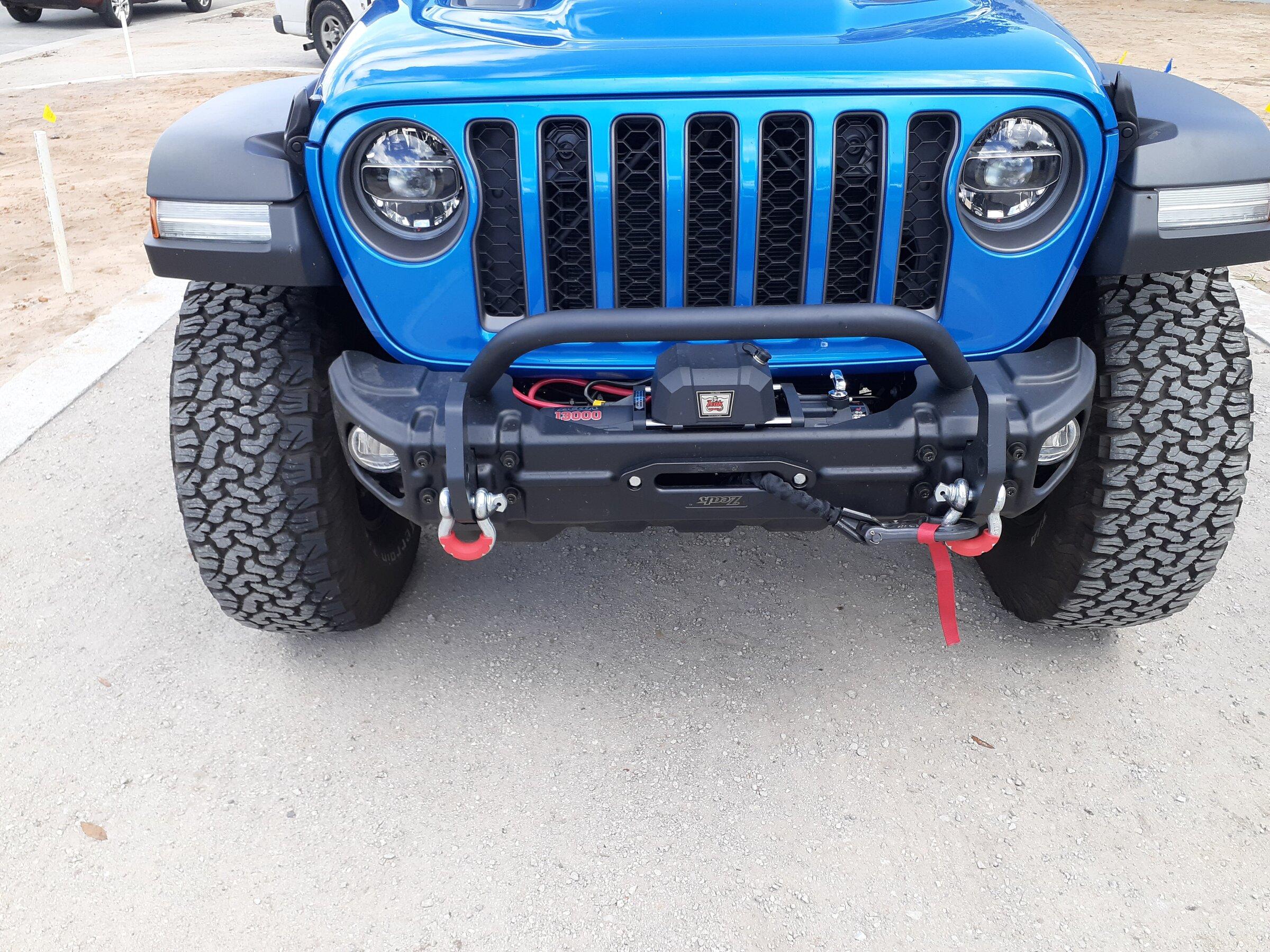

I'm aware of the Badlands winch but are there any other budget winches that typically get recommended along with them?
I paid about 350 for a synthetic line 13000lb. Zeak winch and it doesn't look bad either.
It has great reviews and I've done some light duty with it. The thought of putting 13k on the cast aluminum mounting points and hardware makes me shudder so I invested in a few pulleys to divide the load and invested time in learning various winch techniques.
