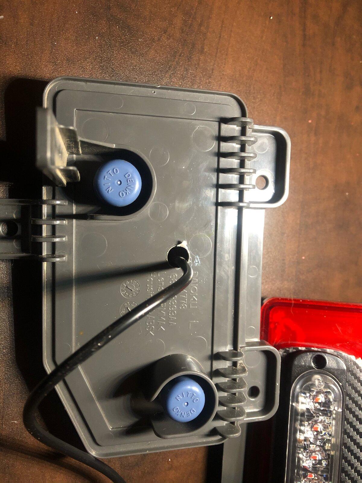

I took the reflector in the rear plastic bumper and drilled a 3/8" hole so I can run a wire through it for 6 " emergency LED light beacon/ Flasher. (Make sure your drill is on high speed or the reflector will shatter)

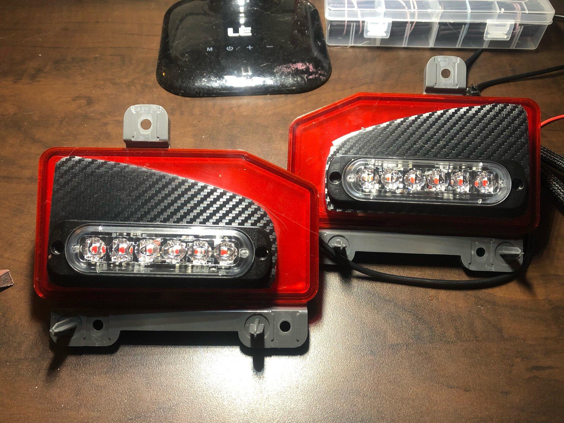

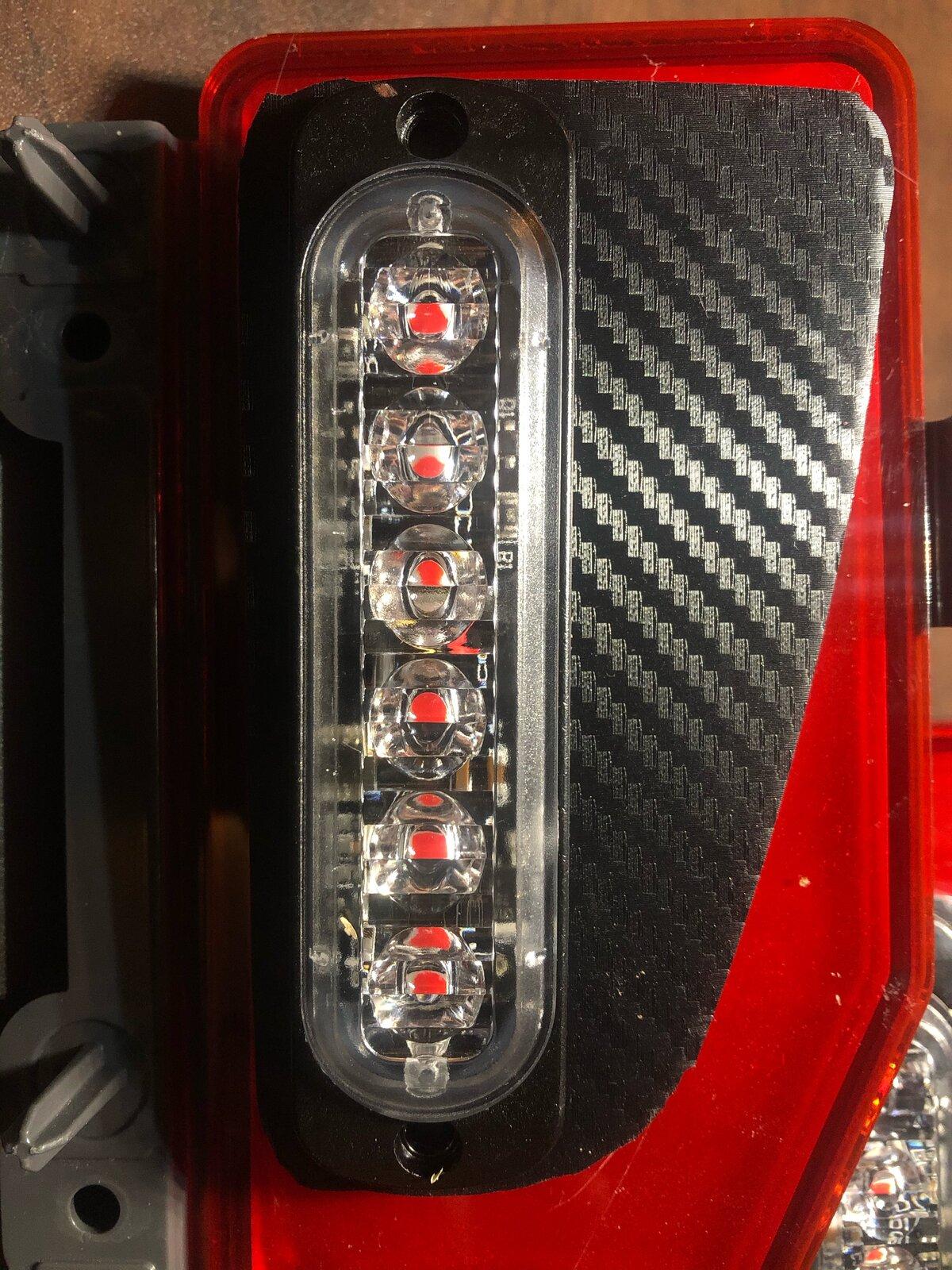

since my car has a black and white theme, I figure I would black the red reflector out with a film. Initially wanted just a black film but found a carbon fiber one that could be shipped quicker so I said what the heck. once I wrap just the red visible part of the reflector with the film, I mounted the LED flasher with 3M doublesided tape.

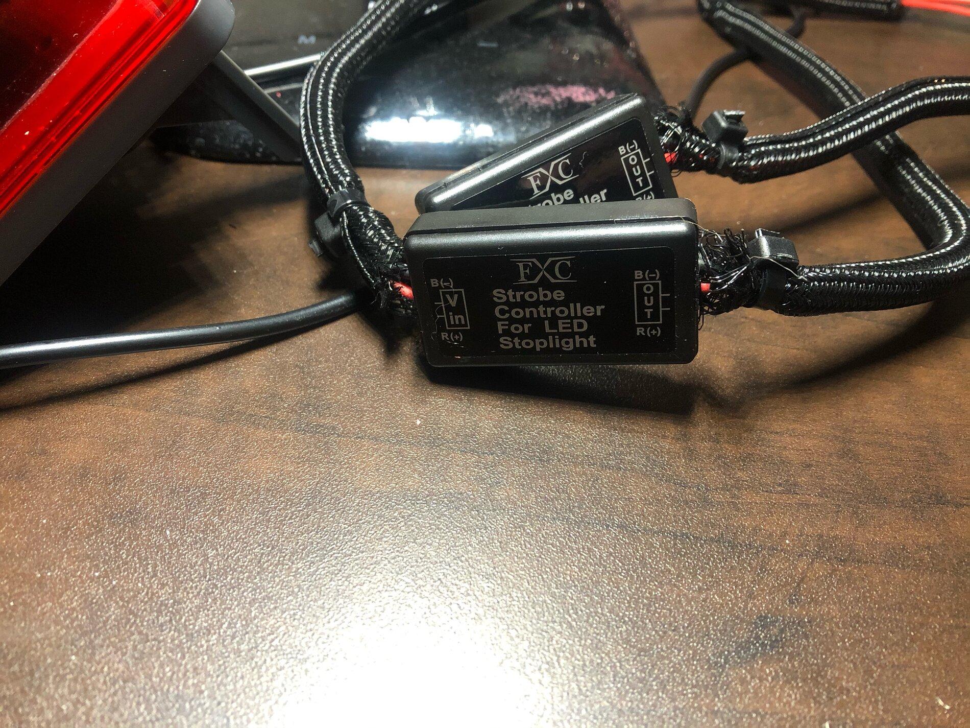

So, for the main purpose of the LED flasher which was to get drivers attention when braking, I wired an inline strobe module that will hyperflash the beacon quickly 5 times before remaining solid as the rest of the brake lights during brake application.

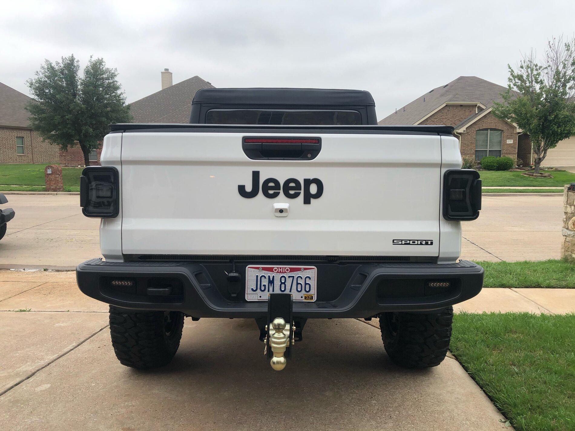

UPDATE: finally got it installed. I like how it turn out.
