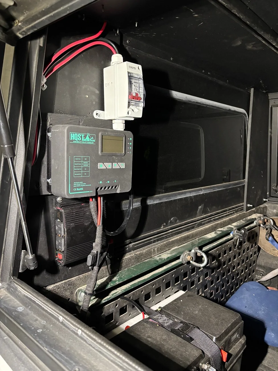

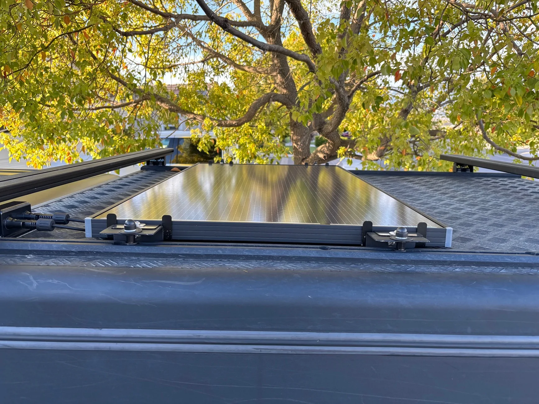

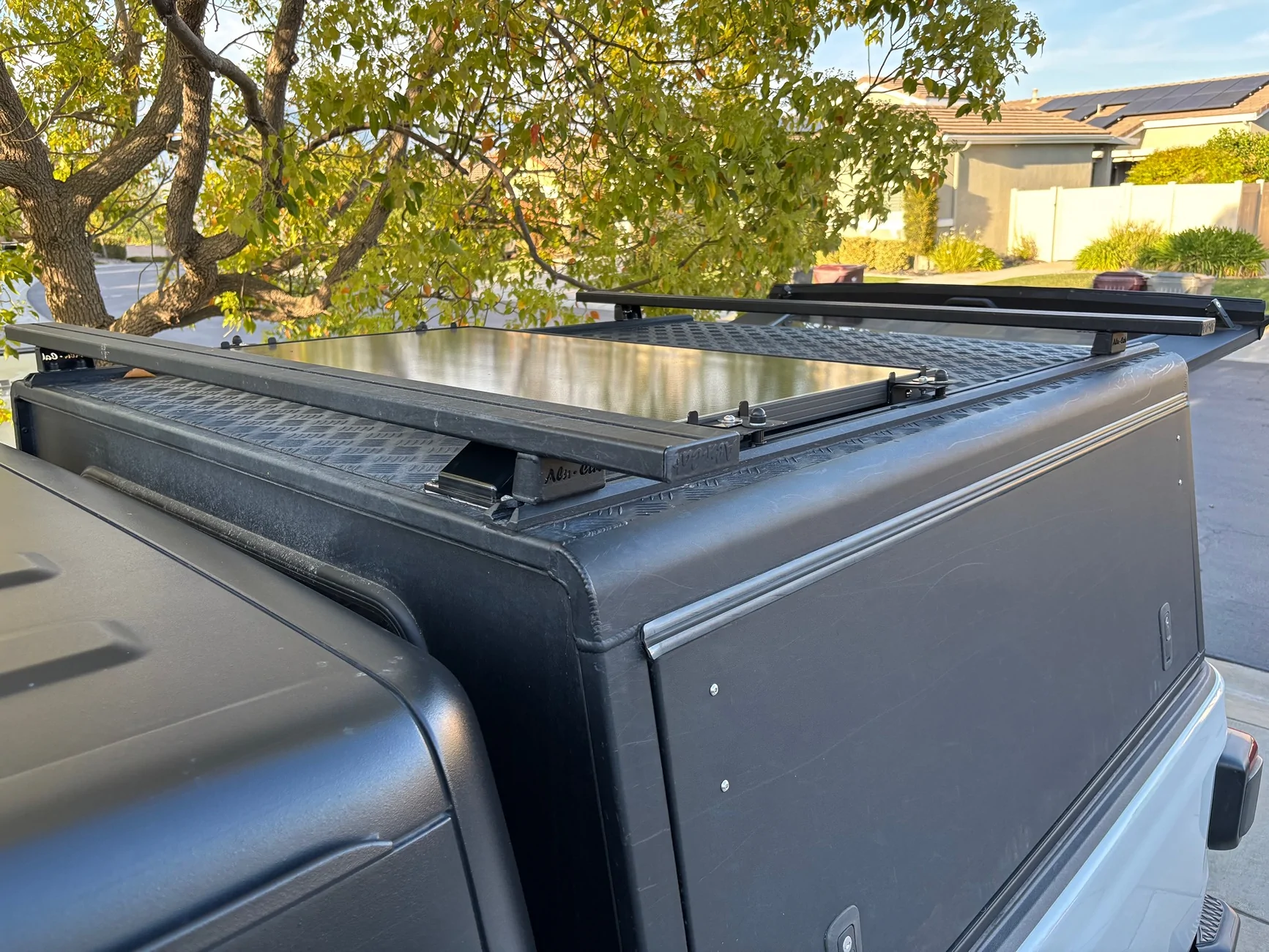

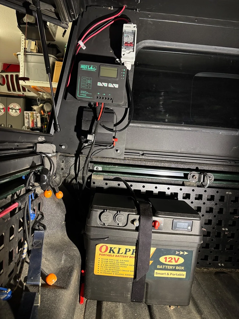

Recently installed solar on my Gladiator. A few months ago, I purchased Iceco, 35 quart, dual zone freezer. The first few times using the iceco I would run out of battery using, in combination, my Jackery 290 and Iceco battery pac.
For the solar I didn't want to tie into the vehicle electric system as when in the middle of the desert the last thing you want is a dead start battery. I know a solar system can be wired to charge the vehicle battery as well as power any electrical components being used. However, I wanted to leave the trucks electrical system separate from the auxiliary solar electric system.
Using a Renogy 120 watt anti shading solar panel and 100 amp hour lithium battery I have been able to produce enough electricity to run my Iceco freezer indefinitely. I went out for four days and when I came home I was still making ice and my solar system battery was at full charge! And best of all my food did not get soogy from ice melting.
I also installed a 400 watt inverter for 120 volt application.
I am in Southern California with about 350 days of sunshine. I will keep the Jackery and Iceco battery pack for backup if we ever get any rain.
Nice setup! Where did you get those solar panel brackets to attach to your cap roof rack?
mdyucca
mdyucca
Mark
Feb 25, 2021
762
822
92223
2021 Gladiator
The mounting brackets are a combination of two components from Amazon:
1. Spartan solar panel Z bracket
2. Fanmao 3X3 12 gauge brackets
The 3X3 angle brackets were sized, cut and drilled to fit as needed.
Thank You
