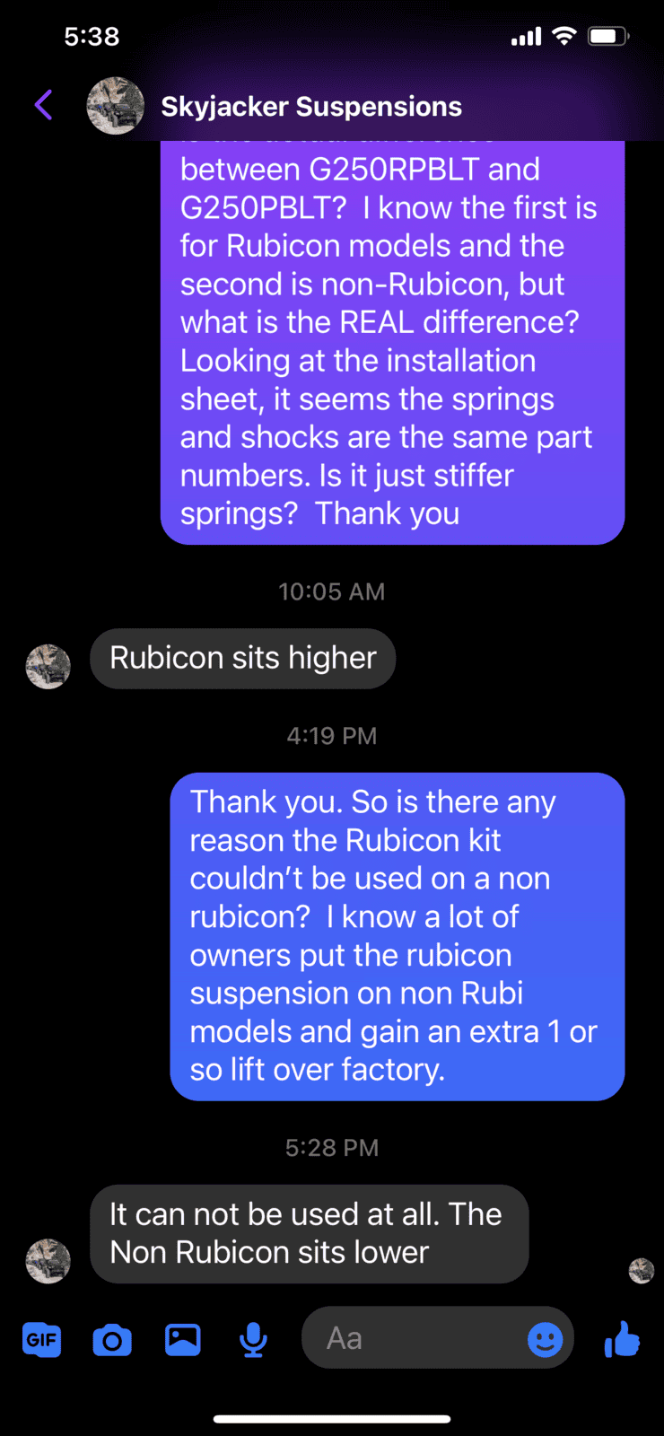

So Skyjacker on Facebook got back to me......

Thanks JJDustr340 for reaching out to them via Facebook.

Doesnt really leave me warm and fuzzy. Where as Rusty's seems to really know what they are doing and have a strong focus on Jeeps.
Agreed. While some say the factory Rubi springs are taller, some say they’re just stiffer, everyone agrees the Rubi sets higher because the springs. Not that “it’s just higher” as this particular Skyjacker service person seems to say.
It really confuses me that the parts lists show the same numbers for the springs in both kits. The spring should either be longer or stiffer in the Rubi kit and therefore a different part.
Edit——after looking more closely at the parts lists, the springs are indeed different for the Rubi kit vs Non Rubi kit. The weird thing is, both front springs for Rubi share a part number and both for non Rubi share a part number. Drivers side and passenger side should be different.
