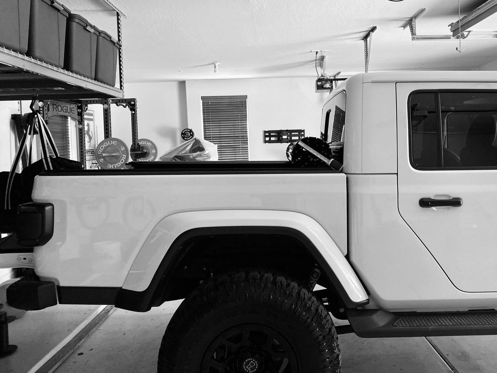

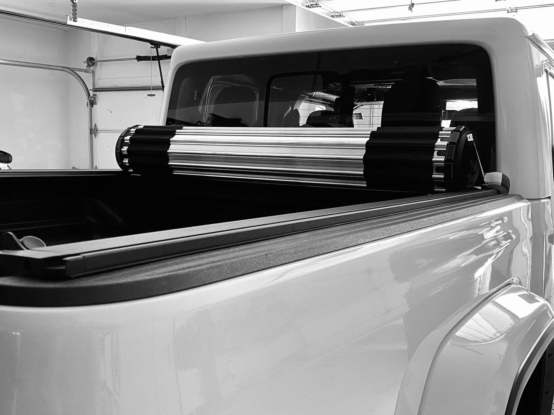

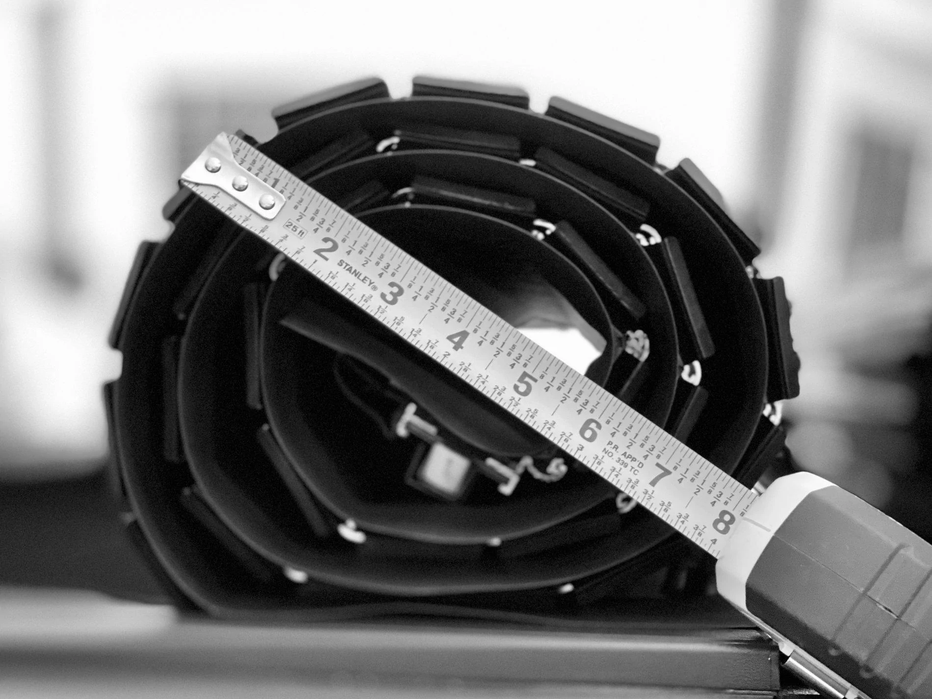

Good looking gladiator ! Do you know the height of the "roll" of BAK revolver.
I am trying to determine if it will clear my rack when it is rolled up.
Thank You
mzeblue
mzeblue
Gil
Dec 31, 2019
121
176
Arizona
Gladiator, E300
Good looking gladiator ! Do you know the height of the "roll" of BAK revolver. I am trying to determine if it will clear my rack when it is rolled up. Thank You
Looks like about 8” rolled-up. Pretty tight considering the rigidity you get when closed.

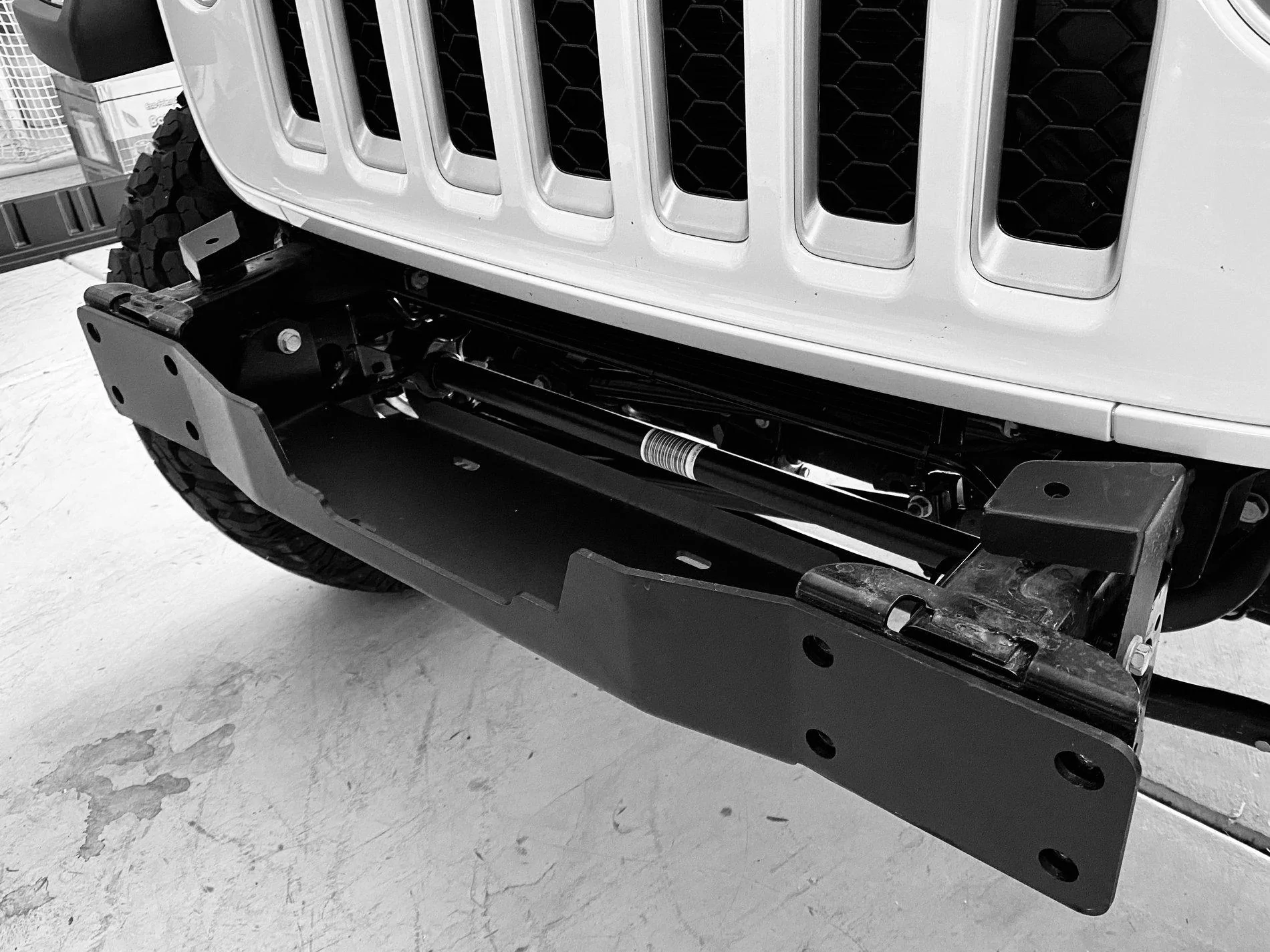

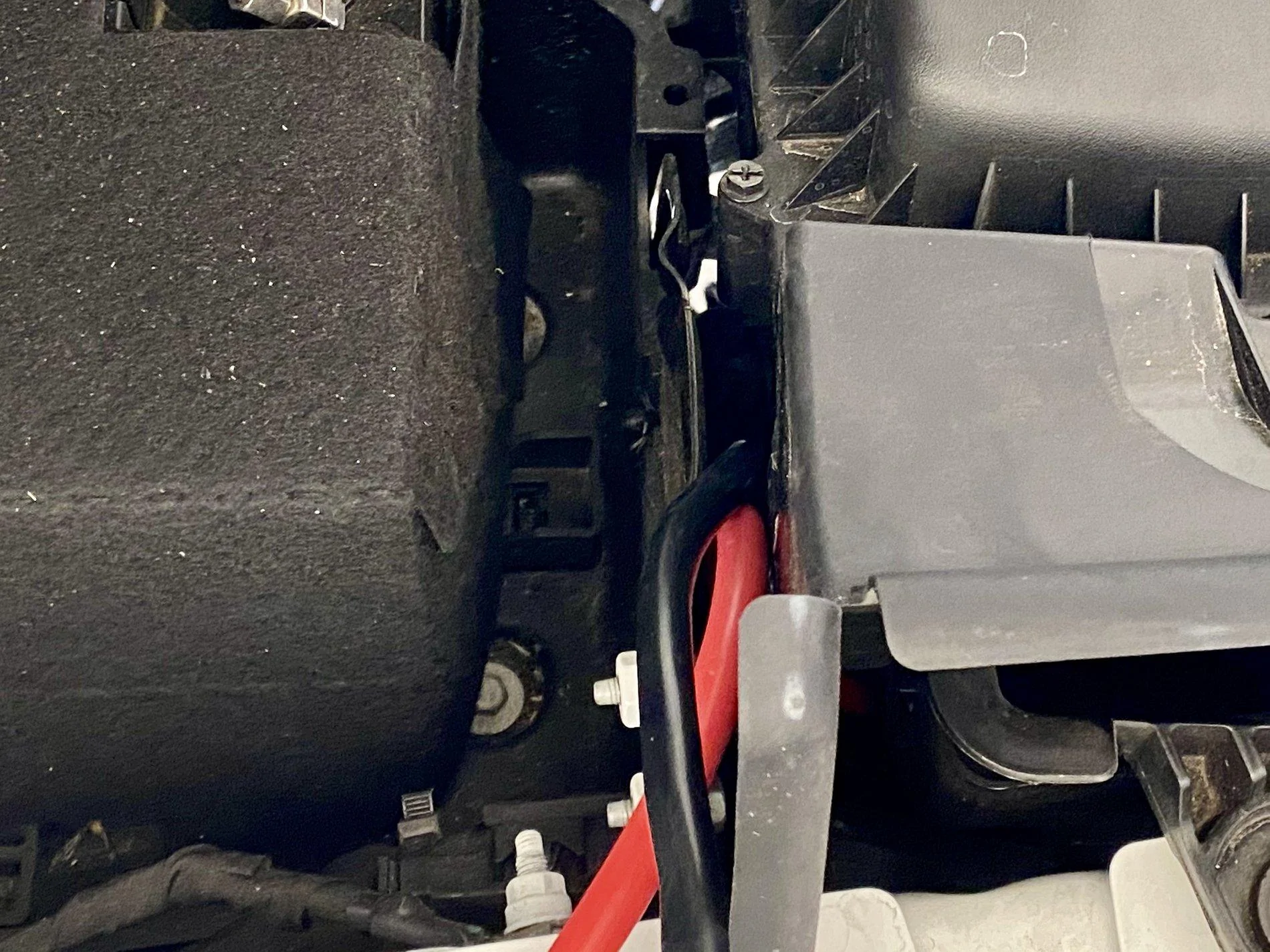

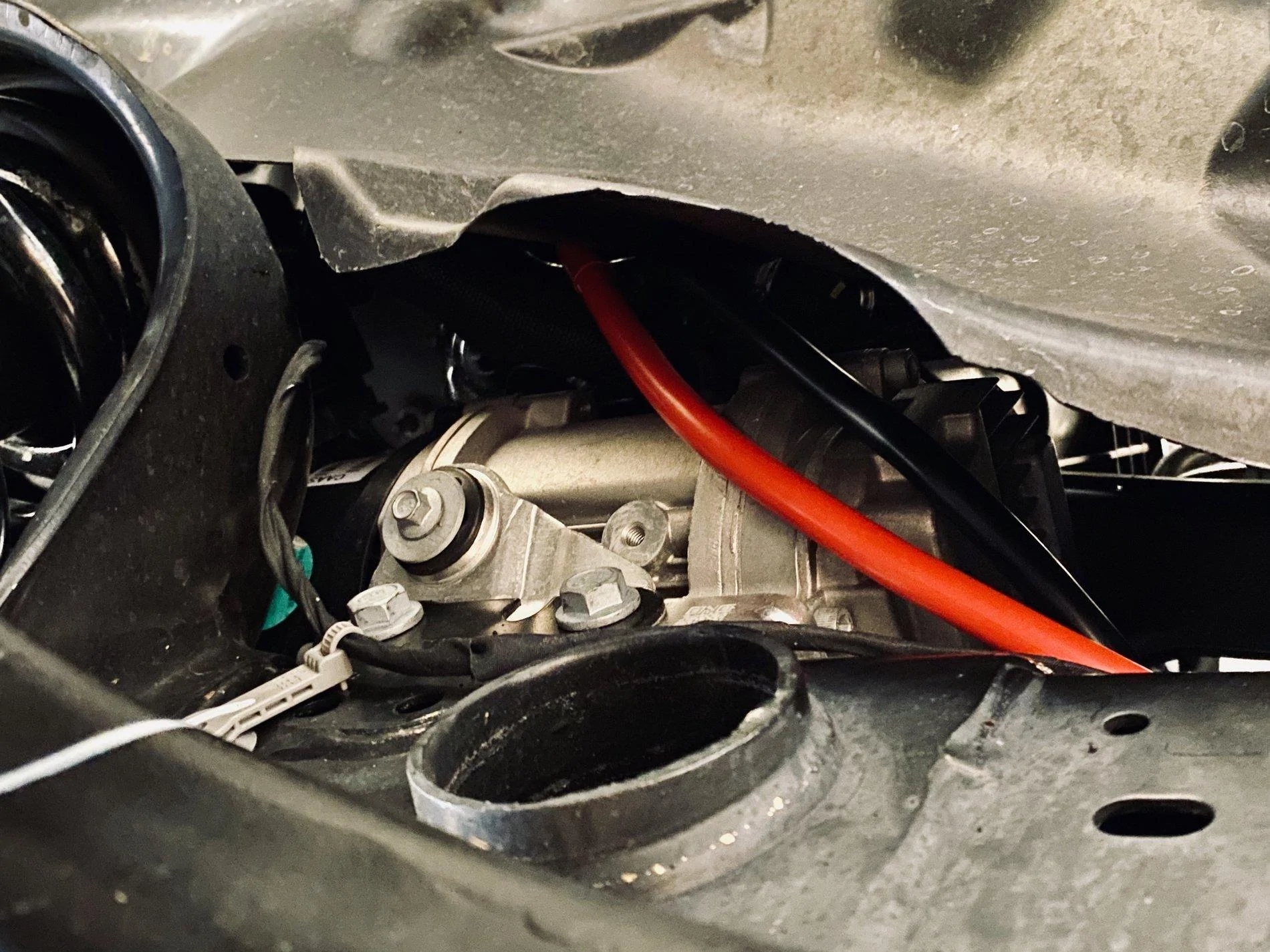

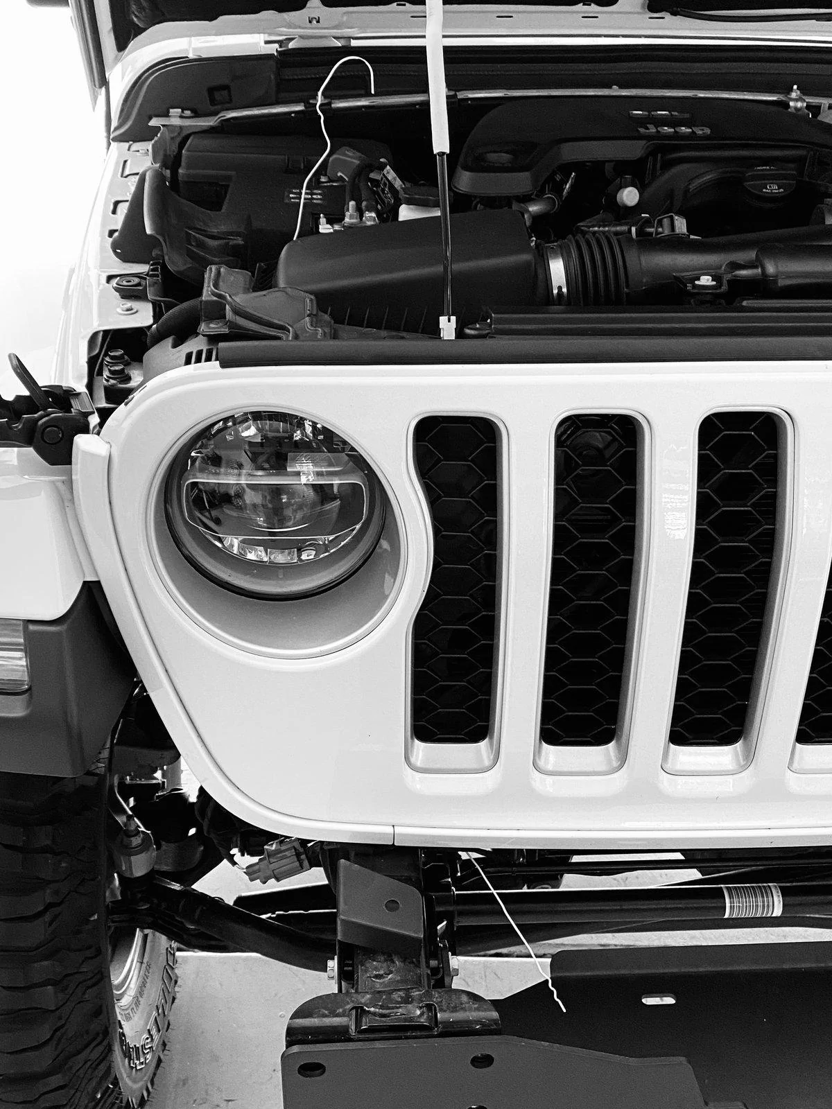

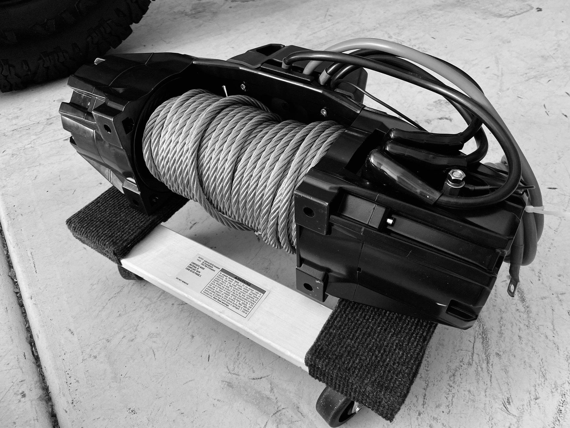

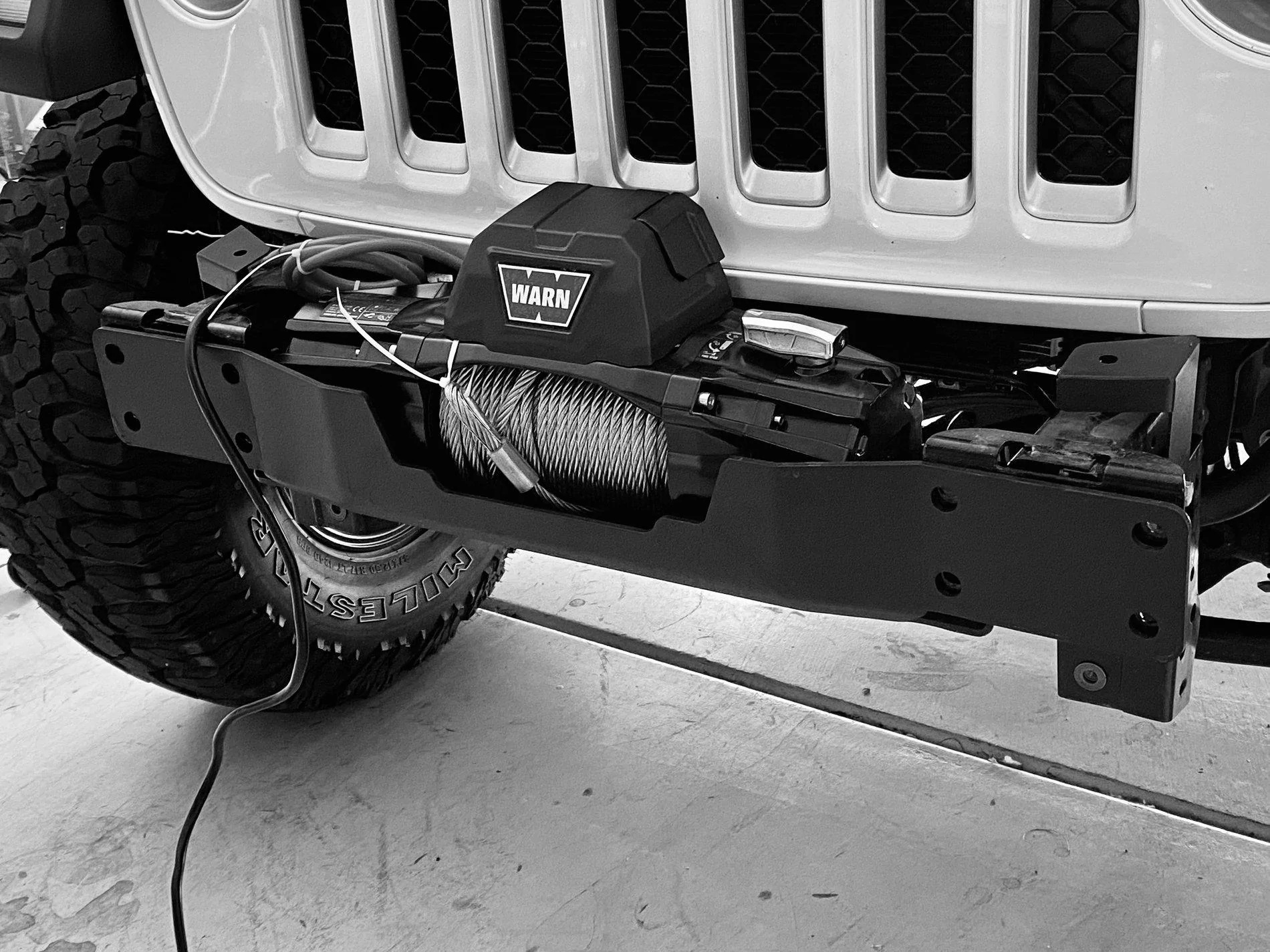

All this time at home has allowed me to finally get the VR10 installed. I followed the excellent video posted by JT Mods, with the main difference being that my Arcus bumper was already installed earlier in the build rather than all at once. I used a coat hanger to pull the positive and negative leads from the front to the battery area. I also used tape rather than hot glue to hold the square nuts in the VR10 housing prior to dropping into place.

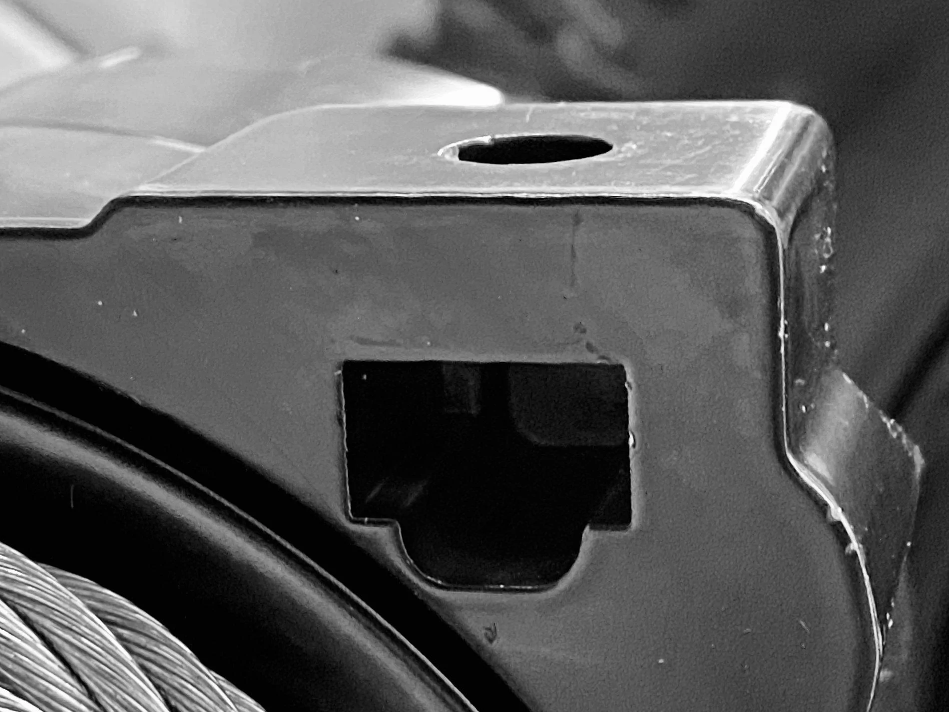

The end of the winch line is terminated with Warn Sidewinder. I did consider the Factor 55 Flatlink and Prolink - I liked all three choices equally, so it was a virtual coin toss.

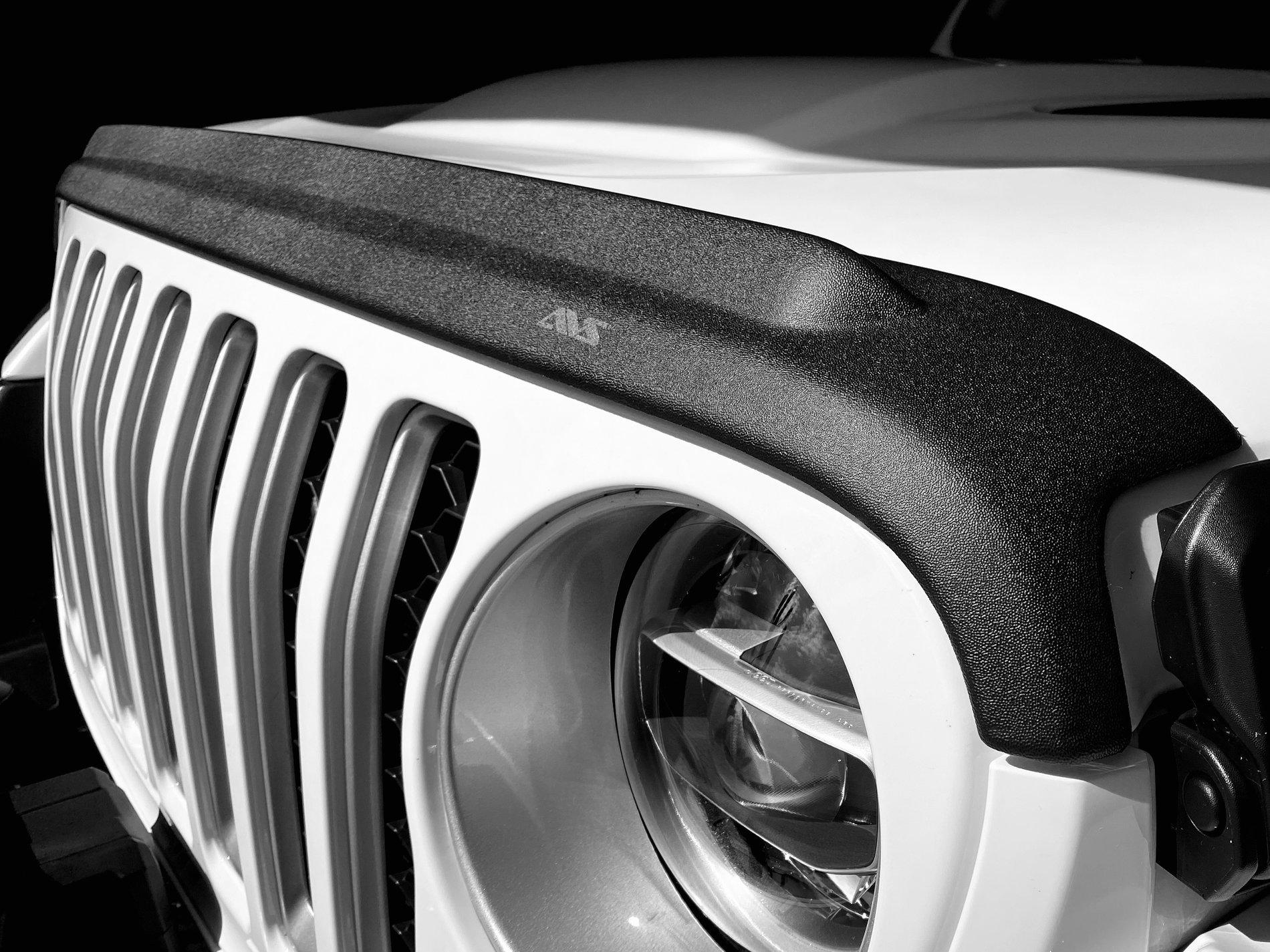

Just installed the Auto Ventshade 436148 Matte Black Aeroskin II Textured Hood Protector, which I bought on Amazon. Shipping was fast despite the prioritization of shipping resources to Covid response. It was a straightforward installation, but definitely take your time when centering and committing to affixing to the hood, because the double sided tape is super sticky.

Did you install that to protect your windshield from rocks? I’ve thought about something like that for mine for that purpose. Also, because it gets all splattered up with bugs so quickly...
Yes, I installed it in hopes to reduce bugs and stones pelting the windshield at speed. I also wanted to protect the front edge of the hood, as it was starting to show micro-chips - I touched those up before installing.

Sounds good, let us know how much of a difference it makes with the bugs. If its helping with the bugs, then its definitely helping to protect your windshield.

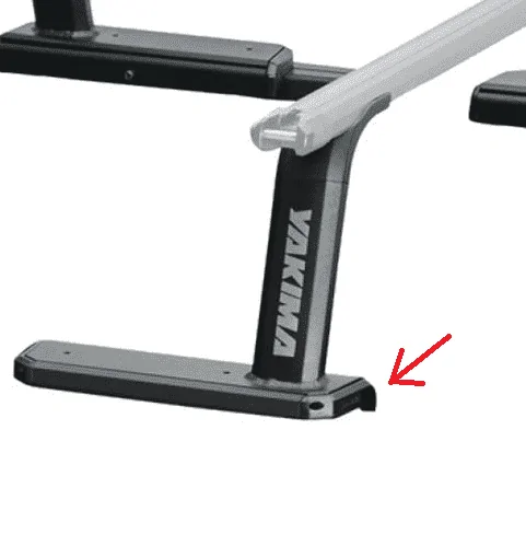

Are you considering putting a Yakima Outpost HD on your tslots? I'm very eager to see someone do that with a hard rolling cover, because that's what I want to do and mount a smaller RRT.

Looking at the Outpost, it appears the "feet" have a bend on the inside edge to wrap slightly into the bed. That would not be compatible with a cover installed.

I believe you'd need the Tonneau cover kit which has feet to address the lip on the outpost HD. Are you planning on putting a rack on? Just curious what your longterm plans are. I live in AZ as well and spent alot of time looking at a Bak or TruXedo Sentry/Armis covers but now I'm leaning back towards a rack with no cover. The way you set yours up I believe you could to that Outpost HD and your cover, pretty cool if that's a direction youre going.
