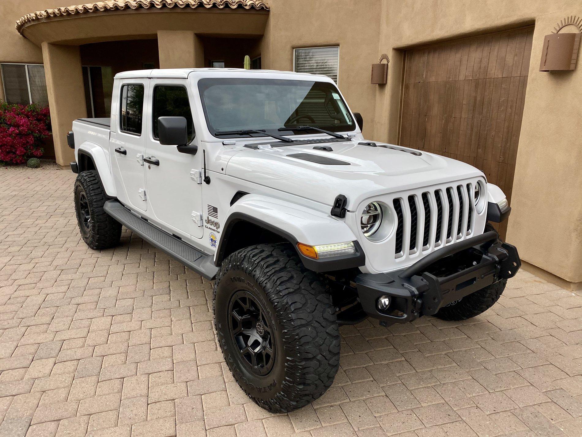

I’m a bit late starting my Overland build thread. I’ll start with the pic I posted in the show-off thread when I picked up the vehicle on New Year’s Eve 2019 from Airpark Jeep in Scottsdale.
123120: A late white Christmas on New Years eve...
010120: Not long after bringing her home, I picked up Rubi LE takeoffs from Whatexit? here on the forum. LetzRoll in Mesa, AZ installed the takeoffs and a Mini Tazer to allow me to calibrate to the new wheel height and disable the dreaded auto-shutoff.
010620: ...the little things matter too. Here is the rubber stubby antenna and monochrome flag decal - both from Amazon. (And, yes, I read about the proper orientation of The Flag prior to application.....)
012220: Today, I had the Mopar lift and 35” KO2’s installed (at Larry H. Miller, Avondale and Discount Tire, Scottsdale, respectively) after much reading and hand wringing over the level versus lift, 35 versus 37, and 3.73 versus regear discussions. The KO2’s are mounted on the LE rims, no offset from stock. I’m quite pleased with how it has turned out so far, particularly with the Mopar Lift and 35” wheels. I had planned on installing an earlier purchased Teraflex 1.5” leveling kit, but the rake to me seems less obvious with the Mopar lift, so will be returning the leveling kit. I don’t mind a little rake, though this may change after eventually replacing the bumper and adding a winch.
012520: Took our first drive off-road today along a short, relatively easy power line service road, Camp Creek OHV Trail. It had just enough hills, bumps, ruts and mud to make it fun and interesting for a first timer. We traversed the trail easily in 2WD, but mainly because I had a hard time shifting into 4WD and didn’t want to use monkey strength to force it. We are thinking Big Maggie Creek trail next, but avoiding the mine side....for now.
013020: Bestop Sunrider installed!! This ought to be everyone’s first mod, at least if your weather permits.
022020: Awesome work by pixeldecal.com to create a decal for my step father's U.S.S. Shangri La CVA-38 cruise patch. He would've been 75 today.

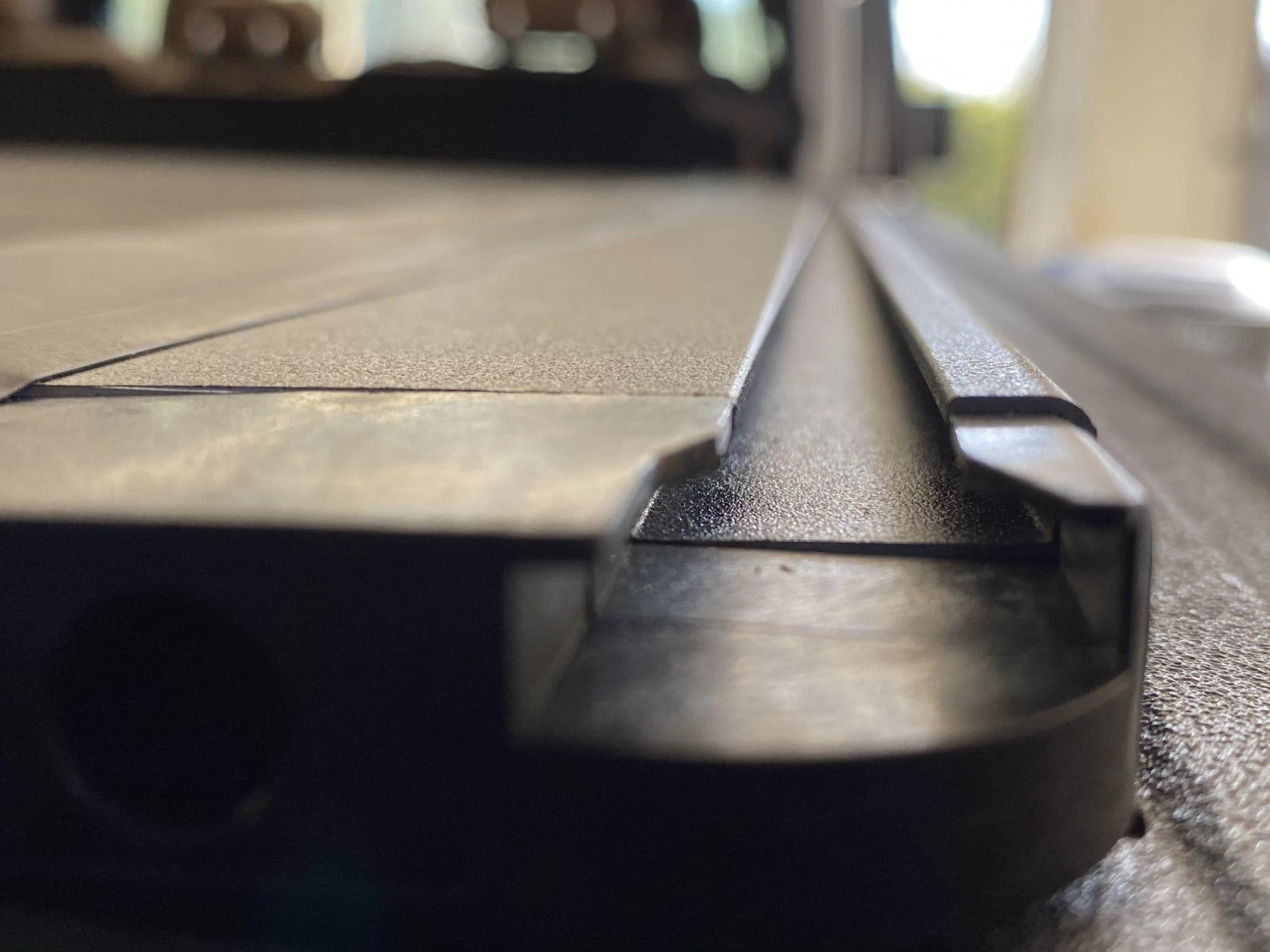

What’s interesting is this longitudinal channel shown below...I think it may allow install of a bike rack. I’ll confirm in the coming days.

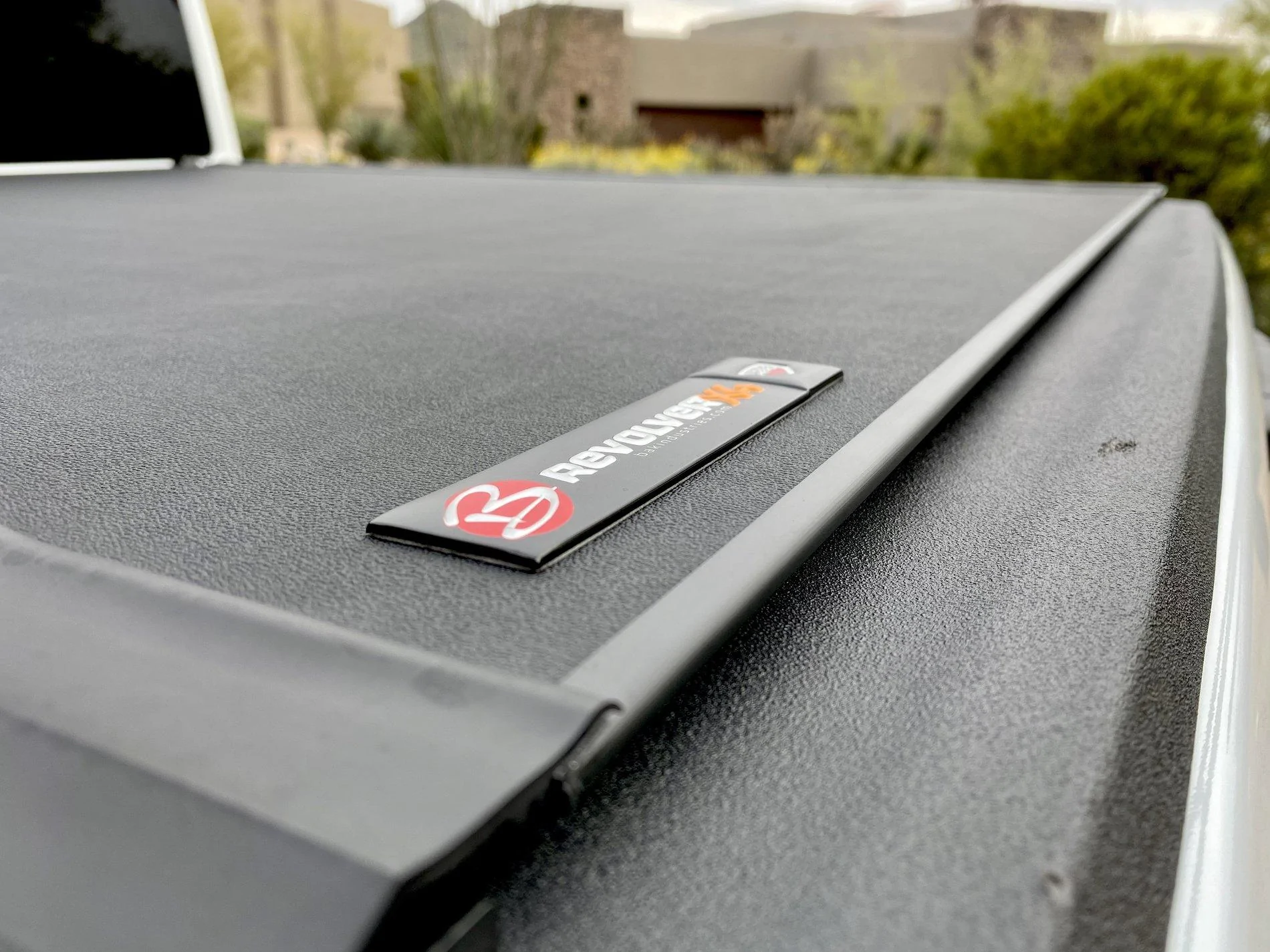

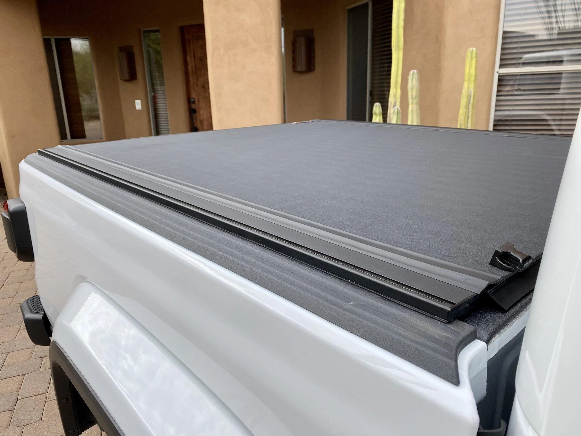

I bought the BAK Revolver X4 on eBay. eBay now informs sellers when interested buyers are watching and gives them an opportunity to send a coupon to get them to buy. That happened to me and I got an offer from the seller to reduce the price to $900 shipped after the item sat on my watch list for a few days. Not a bad price, in my opinion.
Jeep Gladiator Slow & Steady Overland Build 703CA250-F88F-4A32-983A-300916454663
Installation was straightforward. First step is to apply a provided seal that extends along a top surface of the bulkhead which engages the front edge of the tonneau once installed. There are two rails that are each attached to respective sides of the bed with four bolts: two in the back using the OEM tonneau latch attachment points (1st pic) and two in the front bulkhead corner (2nd pic). Downward pressure should be applied while tightening the bolts to engage the rubber seals against the side of the bed.
Jeep Gladiator Slow & Steady Overland Build 78EDC1CB-EC76-4078-9FF0-EE6DD37668A0
Jeep Gladiator Slow & Steady Overland Build 167106DF-EC3A-4F98-812B-B03B766D039B

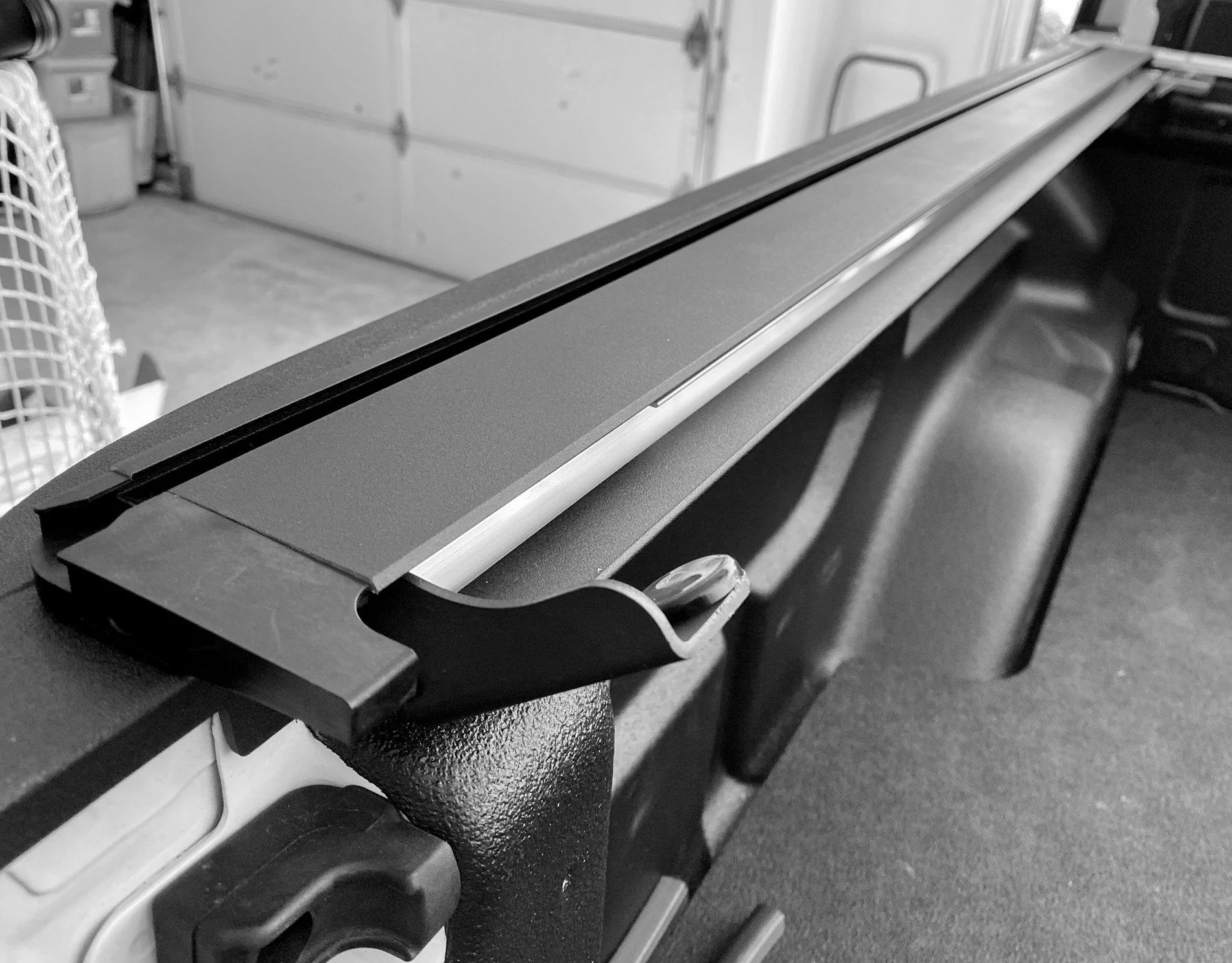

Below is the front driver side corner of the bed (obviously, the passenger side is the mirror opposite). I added a piece of excess seal to fill a curious gap between the frame and the top of the front bulkhead seal. In the foreground, you see the bracket to which the tonneau is ultimately fastened later in the install.
Jeep Gladiator Slow & Steady Overland Build 4BCBACB6-32B7-469E-BECA-0FFBBAD9BE12
In the pic below, the oddly angled lever is spring-loaded and part of the latching mechanism.
Jeep Gladiator Slow & Steady Overland Build 583636F1-1E7C-486A-9590-C5499DDC1101
Once the rails are installed, you place the rolled up cover toward the rearmost end of the bed and rollout forward so that outwardly extending bolts from the bottom of the front end of the tonneau extend through the aforementioned brackets on the earlier attached side rails. Now at this point, the tonneau is covering the bed, so you then have to roll the rear end of the cover forward to allow you to thread nuts and thereby cinch down each of the outwardly extending bolts from the cover to the brackets. Below, you can see the bolts holding the cover down; note the rearward bolt is used to attach the tether for securing and keeping the tonneau rolled-up.
Jeep Gladiator Slow & Steady Overland Build 801A8793-B5A2-4A32-B340-18228D739AAD
Then, you roll out again to test fit with the side rails and the latching mechanism. I didn’t take pictures of these steps, but hopefully the description is clear.
Jeep Gladiator Slow & Steady Overland Build 51FC8697-53AC-47C3-AFCF-BF893C02E264
I always think I’m smarter than the directions and as a result skipped installing the black spacers shown below which positions the rails more inwardly toward the bed center to ensure full engagement of the latching mechanism. Without these little gems, the latch only engages one side or not fully to both sides - either way, these spacers are not optional. I had to unbolt the rails and insert the spacers - an avoidable PIA.
Jeep Gladiator Slow & Steady Overland Build 209C2D36-AEE4-4941-82F2-BB4AC57C6555
Below shows the rear seal that engages the top of the tailgate. When latching the tonneau down. The seal compresses and seals against the tailgate.
Jeep Gladiator Slow & Steady Overland Build 36BA7D97-222F-4947-9393-A987F15854B2
Generally, since the rails are affixed to hard points on the body, so long as the rearmost edge of the tonneau lines up with the rearmost edge of the rails, then the tailgate will likely properly seal against the rear seal on the tonneau cover.
Jeep Gladiator Slow & Steady Overland Build AE8B529A-2605-42F2-84EC-7C6EF3DC9D5E
The instructions recommend using a heat gun or baking under the sun to smooth out the wrinkles in the rubber.
Jeep Gladiator Slow & Steady Overland Build B7AB2D57-FBDB-47F8-818E-2F806CB5855F
Finally, once everything is properly lined up and tightened down, the last step is to attach the rubber pads that prevent the aluminum underside of the tonneau from smashing the rear window, as shown below.
Jeep Gladiator Slow & Steady Overland Build F7FA8883-442F-4B90-A8A6-810CC66818EE
And, there it is.....took about 30 minutes to install and that includes fixing my mistake of not initially installing the spacers.

That Bak revolver looks great! I’m on the fence between this and the armis hard rolling. Are the rails on the x4 standard? That would be a Done deal for me, I plan to make an extra rack to go around the tonneau and if it has t-slots that would solidify an easy way to mound the rack. How sturdy does the mounting and frame seem to you?
mzeblue
mzeblue
Gil
Dec 31, 2019
121
176
Arizona
Gladiator, E300
I still have to determine whether that longitudinal slot along each rail will hold ends of a bike rack, such as a Thule or Yakima. I’ll update as soon as I confirm...I suspect it does because I cannot imagine any other purpose for those slots. I have no worries about whether the system would support the weight of a bike rack and a couple bikes....assuming the slots function like I suspect they do.

I've got the X4 on order, and now I'm confused -- and really concerned. No other photos I've seen of the X4 show that raised rail, rather a much more flush fit (which is what I'm looking for) just like their Bakflips. Unfortunately, I've seen no advertisement showing the X4 on an actual Gladiator.

So is this rail, which looks to raise the cover 1/2 inch, a part of the X4 cover or is that another/optional accessory?:
What they advertise:
Pretty sure it must be raised due to the inward step along each bedside of the Gladiator, as opposed to the Tacoma or Colorado, which have straight bedsides.
Steven (Capercrew02) sent me a video that showed some broader views and angles and it looks fine. Your zoomed-in, close-up, detail views were very informative, but somewhat exaggerated the issue and kinda freaked me out. As I told him, I ordered the X2 back in Feb, but Bak has been having supplier issues for that cover material, so just this morning I changed my order to the X4 which is in stock. It does look like they borrowed that channeled rail from the Retrax and if it can be used for some kind of rack, I'll probably come to appreciate it more so in the end.
I had a Bak folding tonneau on my Ram and really, really liked it. After much research I have no doubt that this design is a cut above all folding covers or any other rolling cover.
