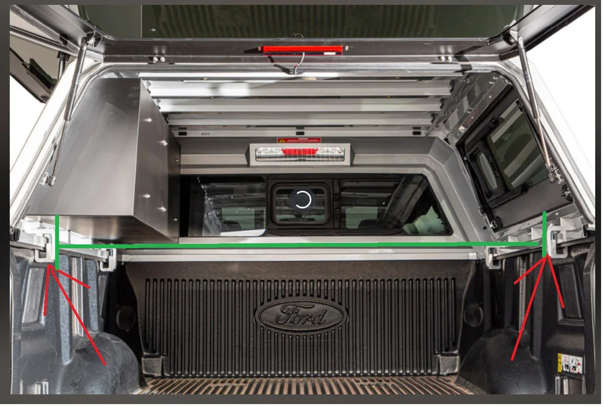

My smartcap is on the way & I am currently working on an in-bed platform before it gets here.
Could someone please provide me the width between the clamps that hold the topper to the bed? I need the green line measurement below.
Thank you!

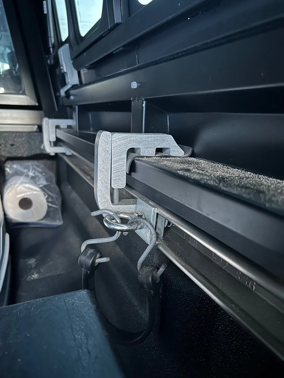

52 1/2” but I am using stainless electrical strut, but I am against the cap. Mine is a 2021 model, I think I would not commit to an exact fit until it is here …..Jack

This is perfect thank you. I made the shelf platform 54" so its about 1.5" clearance with the factory rails on either side
I just needed to see approximately how far in i need to cut the relief slot for the center clamp as that's the only one that interferes with the platform.
