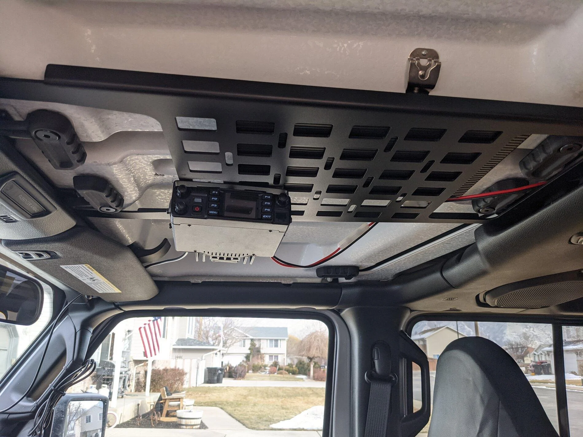

I have a 2021 Jeep Gladiator Sport and I wanted to mount a ham radio. So I ordered an Overhead MOLLE Panel from JcrOffroad and mounted it tonight. Unfortunately I've had nothing but trouble ever since.

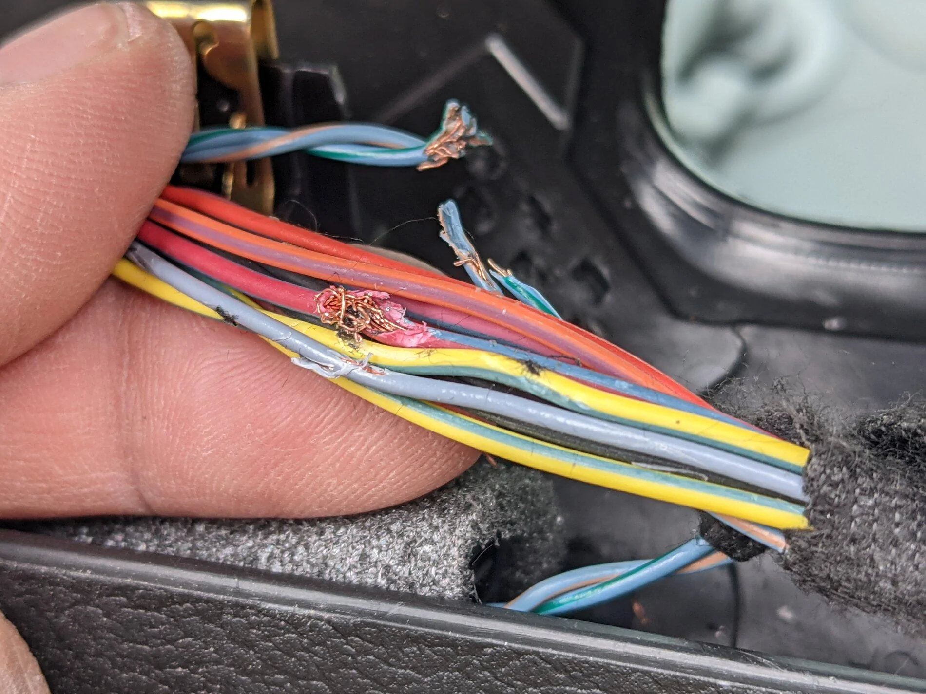

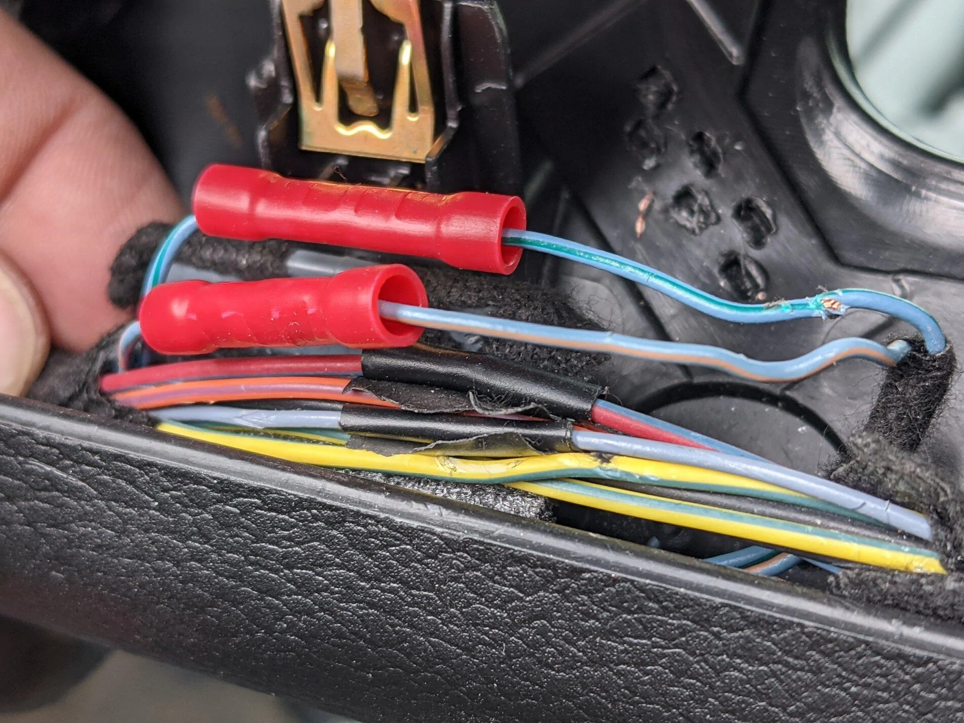

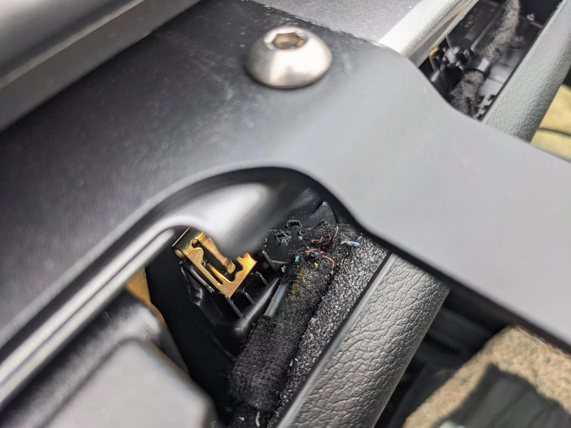

I eventually discovered I had accidentally drilled through some wires. I did my best to splice the wires back together, but the same symptoms persist.

That twisted pair is the CAN bus wiring... that's not so simple to fix in many cases because it is super sensitive to interference and you might need to replace the entire harness. Fortunately, that top harness just runs from a-pillar to a-pillar and is about 30-60 minutes to replace so it's very do-able on your own.
edit: there's a few part numbers on BAM Wholesale so you'll need to give them your VIN but it looks like its under $60. It's #1 in the top section of this page.
You also might have shorted something out but personally, I'd throw that $60 at it and hope. If that fails, I'd be picking up a Blue Driver or some other OBDII tool that will let you read body modules and see what codes you're getting. They won't pop the light because they're not emissions related but they'll be stored in the body modules.

Despite popular belief, CAN bus is very robust. Most networks operate with a relatively low speed between 500Kbps and 1Mbps (though more modern CAN-FD supports up to 8Mbps, which may be used in the JT).
I highly doubt a few inches of untwisted wires affects signal integrity to the point of failure. The relatively low signal rate combined with differential signalling is why CAN bus is used for medium-long distance communication in vehicles -- it is very resistant to noise and fault conditions.
The twist helps to make sure both of the wires are subjected to the same ambient electromagnetic noise (ie: two antennas twisted together will pick up effectively the same radio waves). The CAN bus transceivers can then filter out this noise signal (referred to as common-mode noise) since it is present on both of the wires. Any time you see a twisted pair of wires (ethernet, etc) the concept is the same.
A few inches of missing twist, especially when the wires are still physically close together, is probably negligible for most CAN networks. It may degrade the signal on high speed CAN buses (>1Mbps) but I still doubt it. Not saying it's ideal, but an eye-balled repair of a twisted pair will likely work just fine for years to come.
I also doubt any damage would be done to ECUs connected to the CAN bus in the event of a short to ground or 12V. Every CAN bus transceiver chip I have ever worked with has built-in protection for precisely these scenarios. Automotive electronics are required to be built to a high degree of immunity when it comes to common faults like shorting to 12V or ground.
If anyone ever does this again my recommendation would be:
  • Cut the wires back to where there's no damaged insulation. Use some spare wire of the same gauge to extend the wires if the harness would shortened too much by doing this.
  • Place some heat shrink tubing of the appropriate size over the cut wires (don't forget this part or you'll be redoing the next steps...)
  • If repairing a twisted pair, twist the wires together manually, trying to approximate the number of twists-per-inch of the intact factory harness.
  • Strip the wires 1/4" or so and twist them together. Apply solder so the joint is properly wetted. Use some rosin core electronic solder and a basic $20 iron. Make sure everything is super clean! Wipe any dirt/oil away with isopropyl alcohol. Trim any sharp protrusions from the resulting joint that could pierce the heat shrink tubing (see a NASA-grade wire splice method here).
  • Shrink the heat shrink tubing over the joint. For a waterproof repair, marine-grade heat shrink tubing is also available -- the inside is coated with an adhesive that melts and seals the repair when the tubing is shrunk. Harbor Freight even carries it.
As long as your solder joints are good everything will work as it did before.
Source: I am an electrical engineer that works with CAN bus systems on occasion.

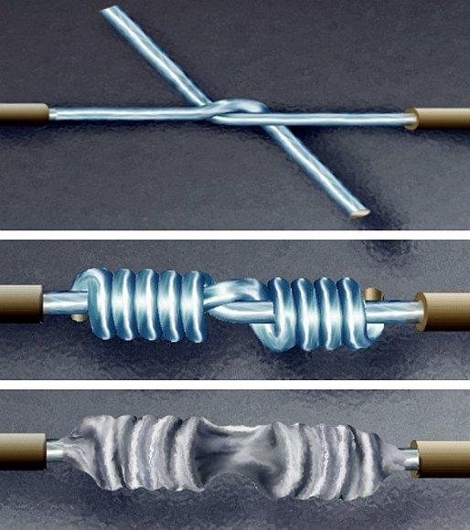

And to add more fuel to the fire ? on the right way to splice a wire let's look at NASA's spec for solid core wire anyway:
Jeep Gladiator SOLVED: Broke my Gladiator by drilling into wires western-union-or-linemans-splice
Some commenters on my post about using a washer as a soldering aid noticed my sloppy splicing technique and were kind enough to educate me about the so-called “Western Union splice,” aka the “Lineman’s splice,” which is the preferred method for twisting solid-core wire leads together for inline electrical connections.
Developed during the heyday of the telegraph, the Lineman’s splice is designed for connections that will be under tension. It is commonly claimed that, properly made, a Lineman’s splice is stronger than the wires of which it is composed. In any case, it is a time-proven method, and, coolest of all, one of NASA’s Required Workmanship Standards. To wit, in a NASA-approved Lineman’s splice:
  1. The conductors shall be pre-tinned.
  2. There shall be at least 3 turns around each conductor and the wraps shall be tight with no gaps between adjacent turns.
  3. The wraps shall not overlap and the ends of the wrap shall be trimmed flush prior to soldering to prevent protruding ends.
  4. Conductors shall not overlap the insulation of the other wire.
Though the Lineman’s splice was originally used without solder, today soldering is common. And NASA insists on it:
  1. Solder shall wet all elements of the connection.
  2. The solder shall fillet between connection elements over the complete periphery
    of the connection.
This material comes from page 84 of NASA-STD 8739.4 (PDF), which is a great reference if you’re interested in best practices for interconnecting cables and wires.
