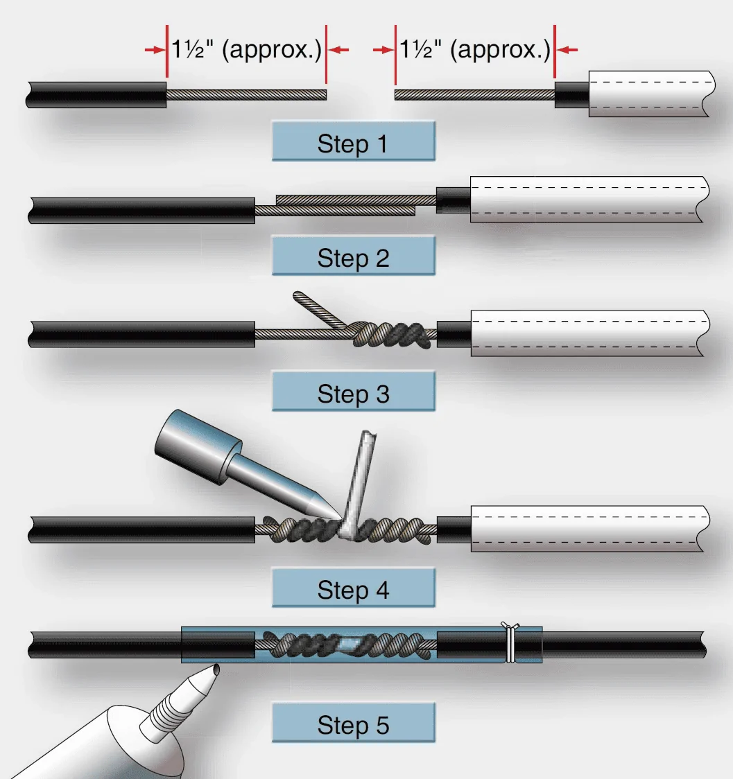

The Navy likes solder. The Air force like crimps. I'm not surprised they are dirrerent. :)
Here's how (aircraft specs). I've never seen a solder joint like this. Everybody seems to think the more solder, the better.
And if you are really OCD:
AC 21-99 Aircraft Wiring and Bonding (aircraftspruce.com)
Happy New year to all!
That looks like the Western Union joint I was taught in electronics classes............... It's physically very strong.
more isn't better. I hate gobbed up solder jobs. That joint minimizes heat to the insulation and will be very strong and will conduct just as much if not more than the gauge of wire being joined.
You run good quality heat shrink over that and you have a tight, small joint like I used for my car harnesses and repairs.

Couple of thoughts. Id have to guess the navy likes solder due to the salty environment? I'd guess crimps could corrode easier if compromised?
Also, I thought another nice splice I learned about was called a line man's splice. I've used those with good success.
A few good YouTube vids of that method for the wiring snobs to watch. I'm a proud member.
Yeah, we had a Navy guy in the shop - a true believer in 'the bigger the blob the better the job' ?
40,445
53,880
Big blob indicates not just too much solder - but not the right heat in the right place. Solder will "soak" onto the wire like water on paper.
I'd hate to think of your guy soldering water pipes! Yikes. Solder will actually rise up to follow the heat.

Oh, By the way, as an unbiased neutral observer, in AUTOMOTIVE APPLICATIONS, crimping wins!!!
Bottom line...^^ this right here^^. You will RARELY EVER see a soldered splice in the “field” of an OEM automotive harness nowadays. There’s a situation for everything, but the proper type and material of this type of splice, with the correct w crimp and heat shrink is what is standard when an OEM harness is built.

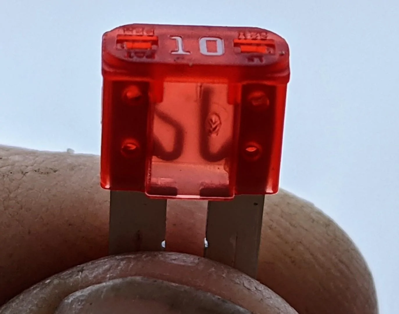

SOLVED

- Windshield wipers run and cannot be turned off.
- The horn still works, but all other steering wheel controls are unresponsive, including turn signal, windshield wipers, cruise control, radio volume and controls, and the up/down/left/right/OK buttons.
- The service engine light is on and says something like "service traction control system".
- An OBDII scanner reported something like "communication lost with steering column control module."
Causes:
- My drilling into the wire harness severed CAN bus wires (blue twisted pair) and likely shorted it to at least one other wire (red with a blue stripe).
- The shorted wires blew the 10 amp micro blade fuse number F89, which powers both the steering column control module and overhead console.
Resolution:
- Disconnect the positive terminal from both the main battery and the stop/start battery.
- Repair the damaged wires with a clean solder splice and heat shrink tubing. Maintain same twist rate, and ensure the CAN bus wires are of equal length after the splice.
- Check for blown fuses and replace the 10 amp micro blade fuse number F89. Notice the windshield wiper blades finally stop moving and all the steering wheel controls work again.
- Clear the engine failure codes with an OBDII scanner.
