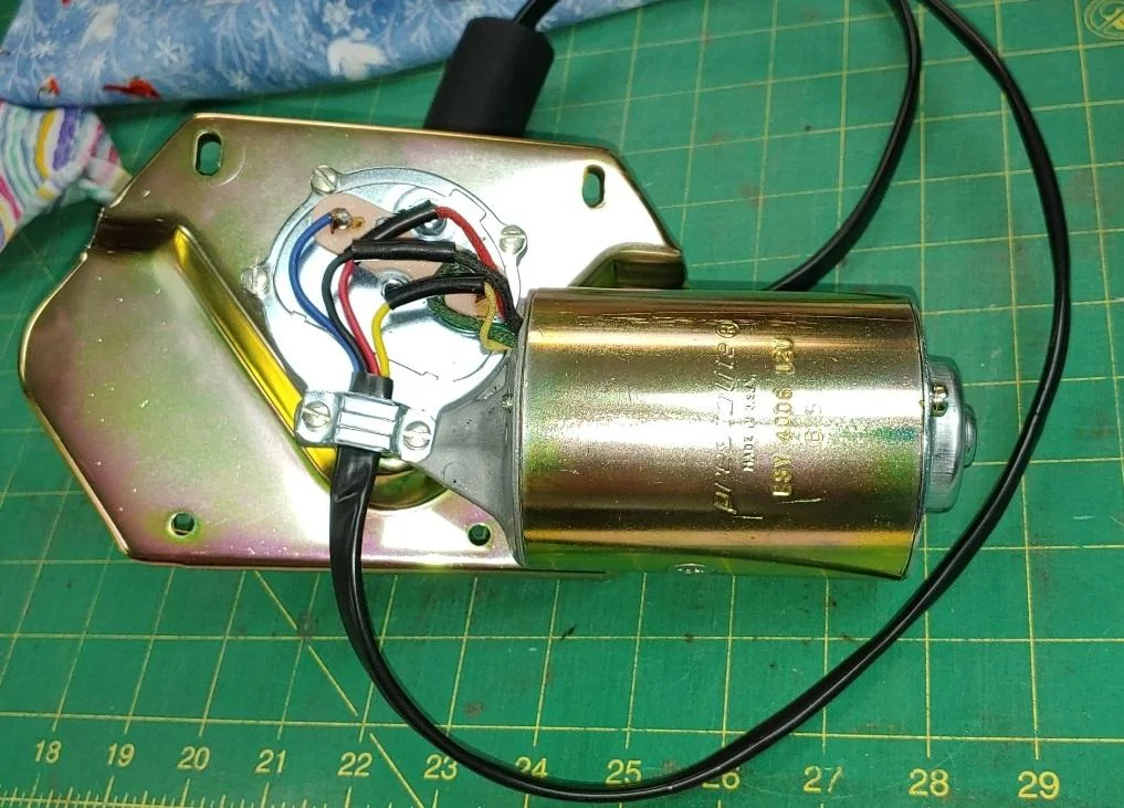

Solder joints - millions of these motors were produced by Prestolite for various cars and trucks over 3 decades. No failures. But the sleeve spreads stresses out over some distance.
And I put them back together the same way - >

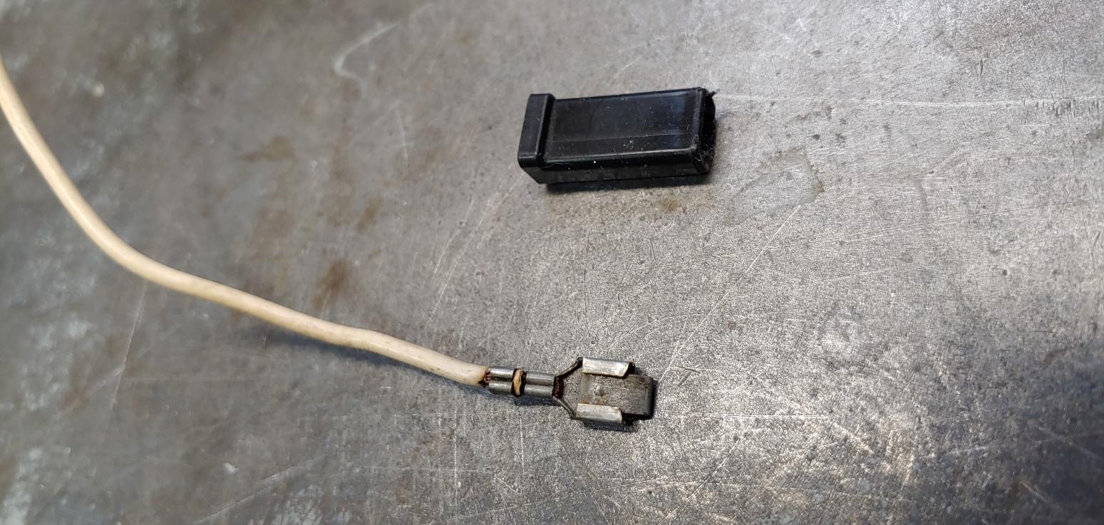

Jeep Gladiator SOLVED: Broke my Gladiator by drilling into wires 20200515_103853_HDR
Below - crimp is good 40 years later but the wire failed upstream due to flexing and stress. Copper strands are broken. A sleeve or these days, heat shrink, could have prevented this, so if using crimp, I recommend some form of stress relief. I have dozens of examples of this. The crimp joint is great! No voltage drop, but the wire still broke - so try to mitigate that if crimping.
This is an example of a good sealed crimp.
