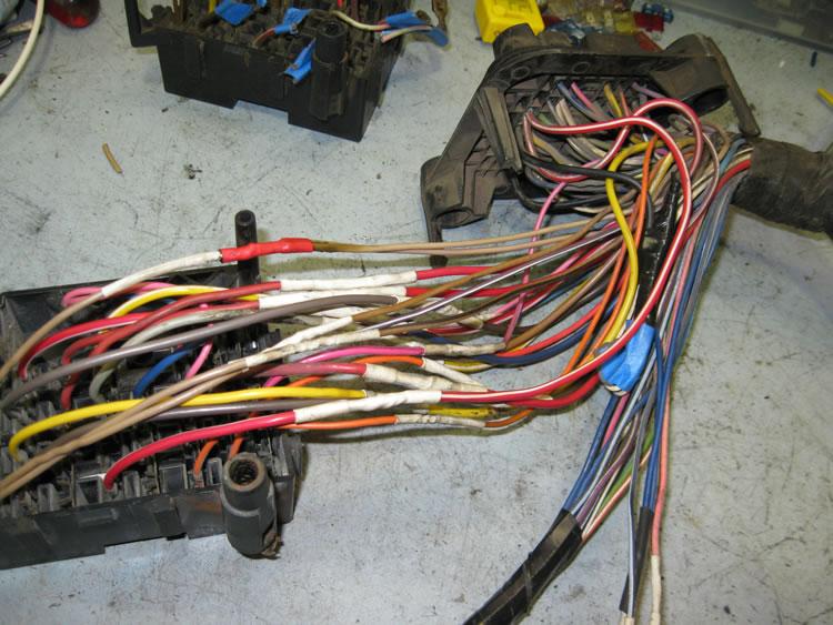

Jeep Gladiator SOLVED: Broke my Gladiator by drilling into wires 20200425_162330_HDR
Jeep Gladiator SOLVED: Broke my Gladiator by drilling into wires sx4-088

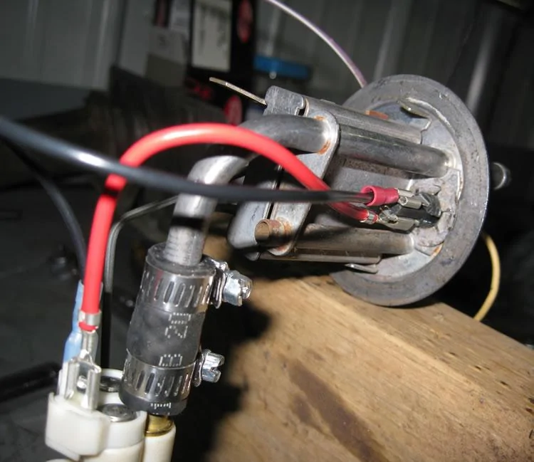

Jeep Gladiator SOLVED: Broke my Gladiator by drilling into wires sx4-pump-027
