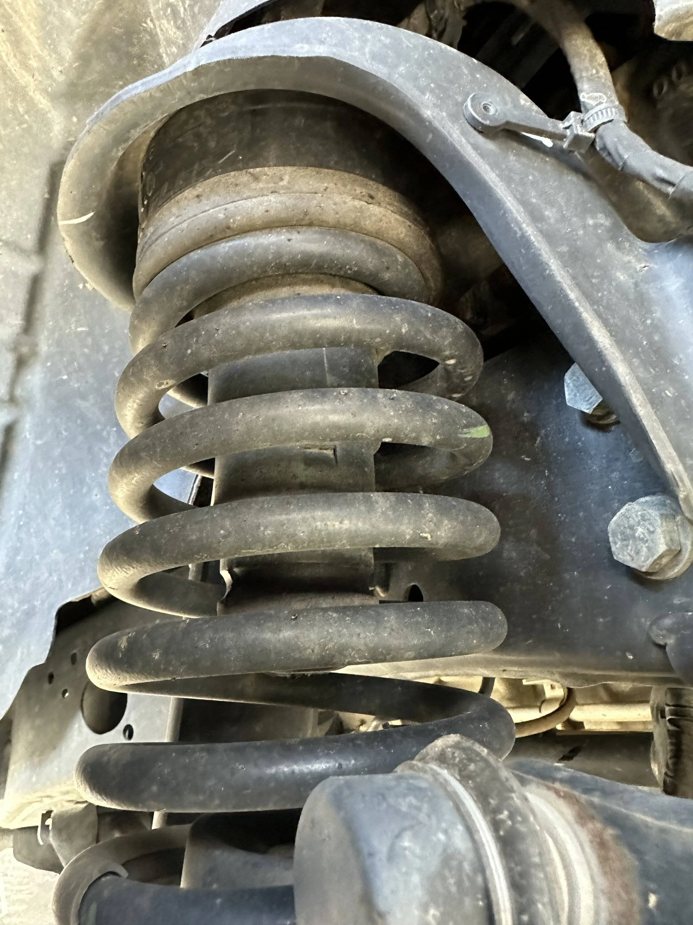

Would that significantly change the break over angle at all ( Couldn't find a JT pic lol) ?
Jeep Gladiator Spacer Lift – Questions – Geometry – Australian Spec 1699050203442

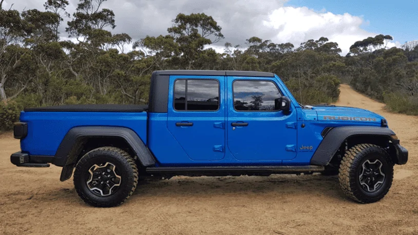

I know that was a lot. So I will at least share a pic of her on the trail
Jeep Gladiator Spacer Lift – Questions – Geometry – Australian Spec 1699050215114
