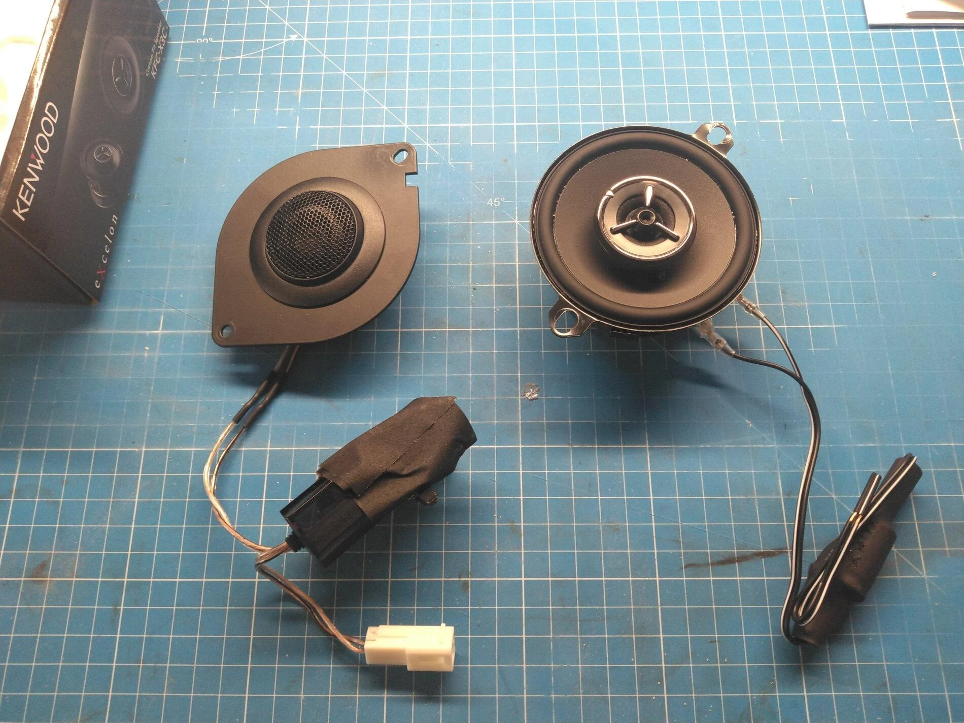

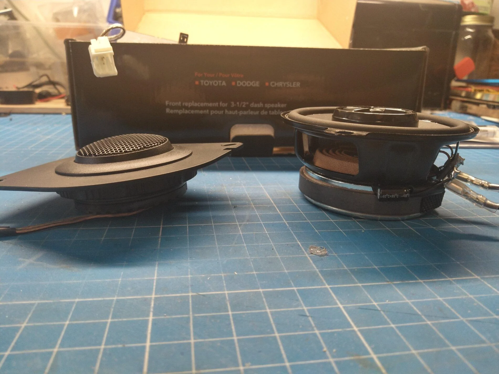

One the left in these images are the SPR-10TW 1" Tweeters that came with the Alpine PSS-23WRA kit. On the right are the Kenwood KFC-X3C`s I am replacing them with.

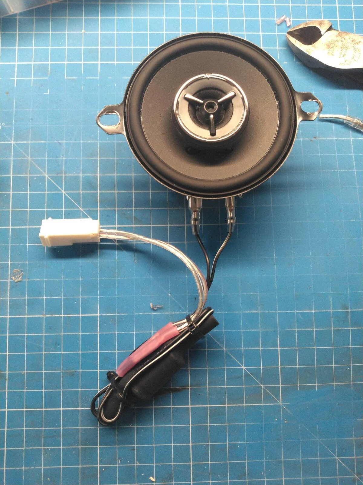

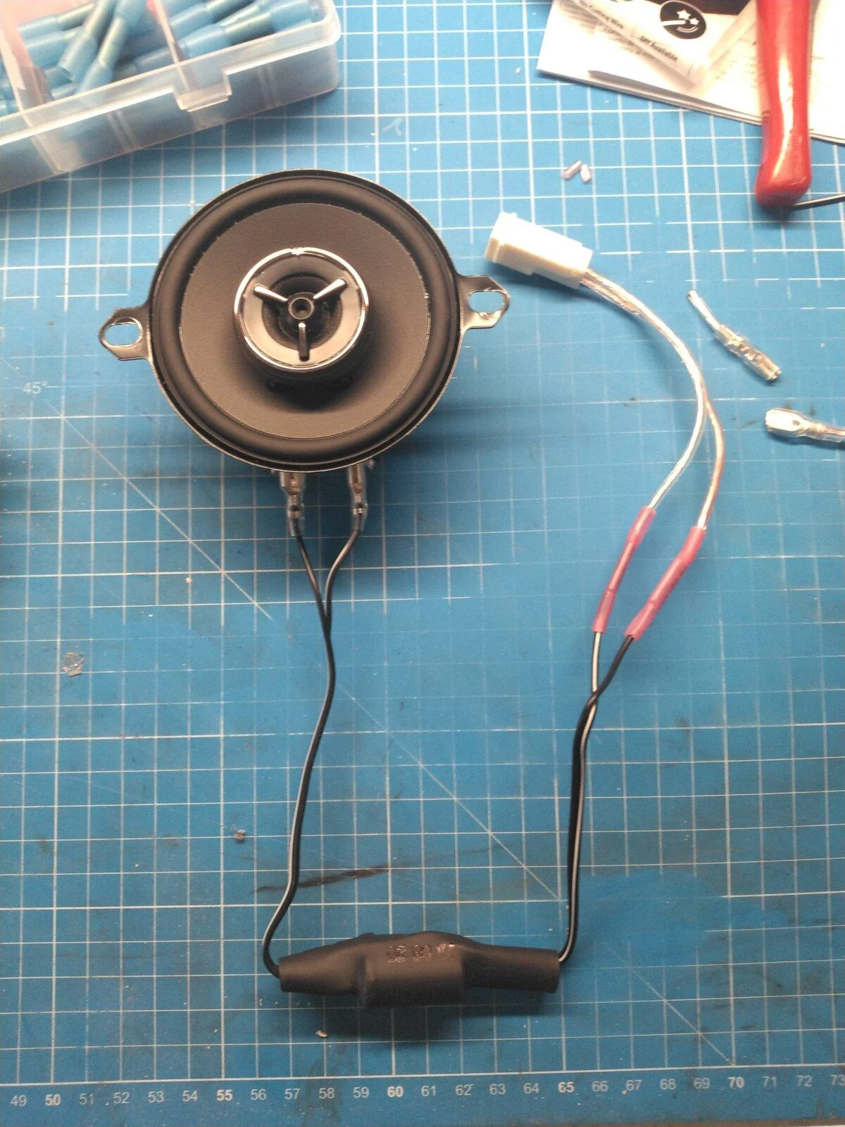

I re-connected the crossovers that came with the Kenwoods and used some butt connectors with heat shrink to connect the Red Wolf harness adapters, then bundled them up with zip ties for install:
Took them out for a spin, works GREAT. Putting the crossovers back on made the crackling go away. The sound from the front end is much fuller now, its not imbalanced towards the sound bar. Front end produces more treble and can handle more bass. The Alpine kit was a huge step up from stock, but this is the icing on the cake. Think I am pretty happy with my sound system now. Time will tell if I end up screwing with the sound bar.

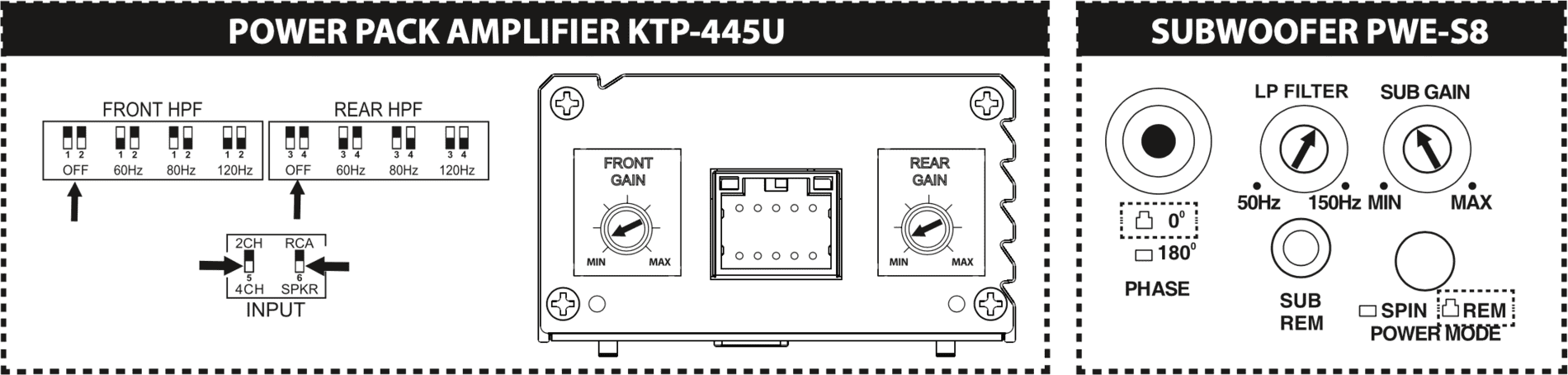

I have the 7" U-Connect system, and I installed this Alpine subwoofer / amplifier setup, it came with a pair of 1" tweeters to go in the dash corners near the base of the a-pillar trim:
https://www.amazon.com/gp/product/B07K43KGPF
Took her out this morning - immediate improvement in the sound quality, before it felt like the sound bar was carrying all the weight and the dash was playing backup. Now it feels much more "full" in the front.

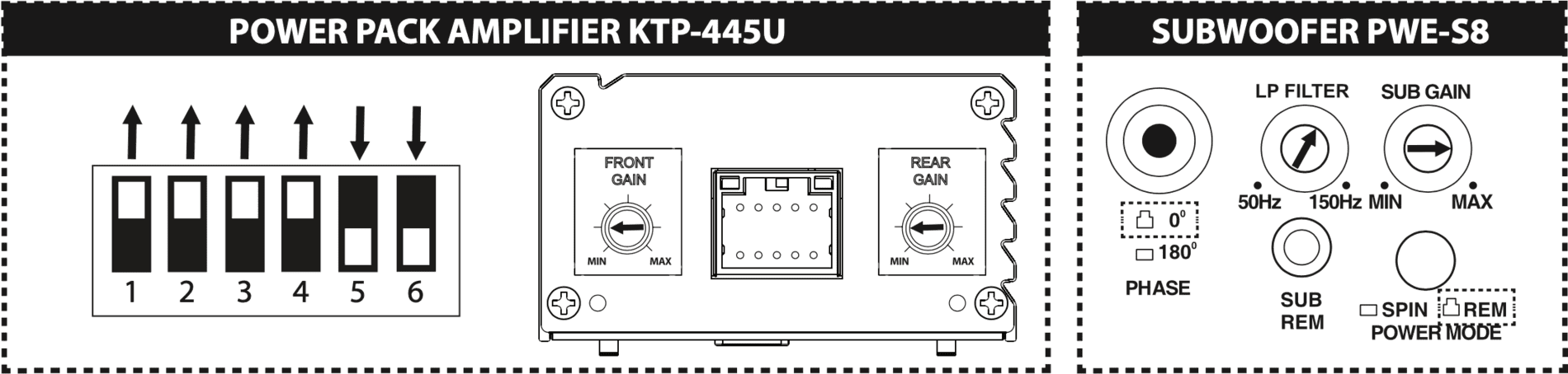

Removing the crossovers was definitely a miscalculation though. If the volume goes over 25 out of 38, they start cracking like mad. That was my own mistake. Pulling the Kenwoods out after lunch to re-attach the crossovers and reinstall, hoping itll pan out.
Also something to consider is how did you set-up the Alpine Amp. The older user manual that came in the box had the Front, Rear, and Sub Gain set too low. Might not apply in your case since you're using Kenwoods.
Old Amp Settings

New Amp Settings
Old Amp Settings

New Amp Settings
Jeep Gladiator Speaker swap Screen Shot 2021-02-06 at 5.08.24 PM
This is really interesting. I set mine to what it said in the manual and since then I havent screwed with it. Left it as-is and then dialed things in with the head unit EQ. Ill have to go back and double check whether mine is set to the old or new recommendations.
Setting according to the old User Manual my Alpine front Tweeters on occasion would crackle. Then read a review on Amazon that said the gains were set too low. Downloaded the revised User Manual directly from the Alpine Website and the gains were set higher.
This may not apply in your case since your dash speakers are the Kenwoods and you reinstalled the crossovers. Just something to tinker with.
