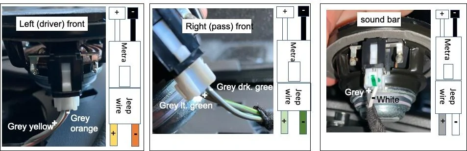

JTR 8.4Uconnect. I swapped both upper front dash and both soundbar 3.5" speakers with four Kenwood eXcelon KFC-X3C 3.5" Mid Range Speakers for Chrysler/Toyota/Others, 50 RMS Max Power (Pair) using the metra 72-7902 adapters. The sound is noticeably crisper with more depth from the front than with the factory 3.5".
Sharing a couple of things I learned if it helps anybody. The metra adapter wiring (polarity) was aligned correctly with my factory wiring harness in the dash and in the soundbar, meaning I did not need to flip the wires in the metra adapter (as is the case for many JL/JT owners) to maintain the existing polarity. Here's a wiring diagram I created, keep in mind the 8.4Uconnect uses a different factory wiring harness with differently colored wires than the other system levels.

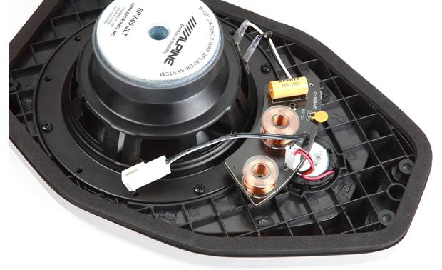

Trying to see if I can bypass the crossover in the Alpine SPV-65-JLT...
Update on the Crossover Bypass
At first listen it did sound better over stock so I ran with it for three months. Then just for Shits & Giggles I checked all the polarities on all my speakers in my JT. Turns out the polarity on the Alpine tweeters in my upgraded soundbar was flipped in relation to the rest of my speakers. Not sure if bypassing the crossover caused the flip but it was easy to fix.
Cut Tweeter Wires
Flip Tweeter Wires
Crimp Tweeter Wires
Shrink Wrap Tweeter Wires
DONE
Now these speakers sound great.

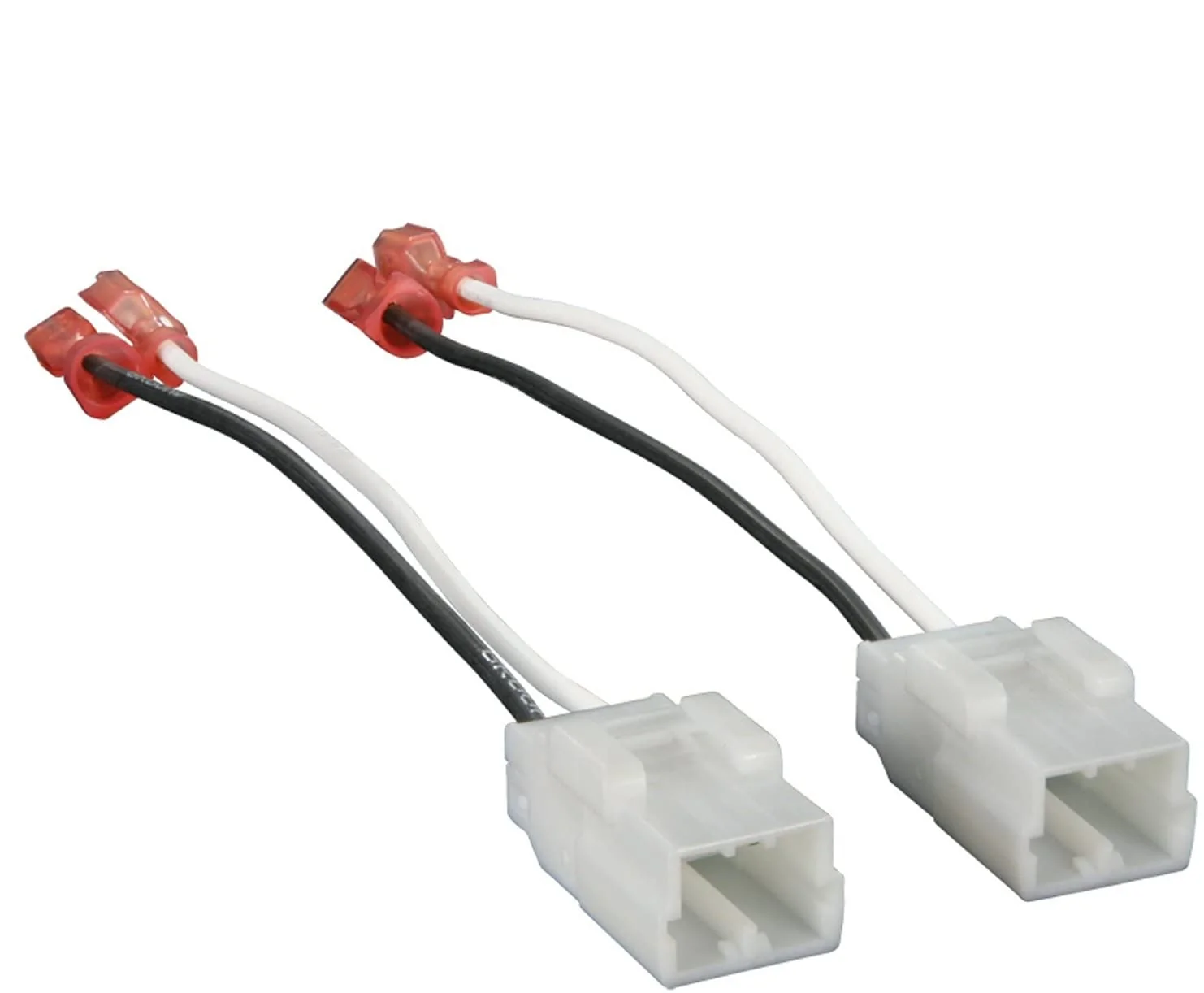

I did the upgrade and used the Metra adapter to bypass the crossover. It works great. You'll be very happy with the improved sound.
Check the polarity on the tweeters. I had to flip my wires after bypassing the crossovers.

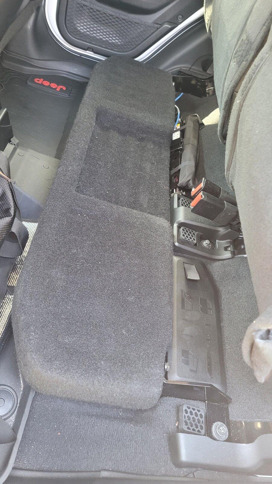

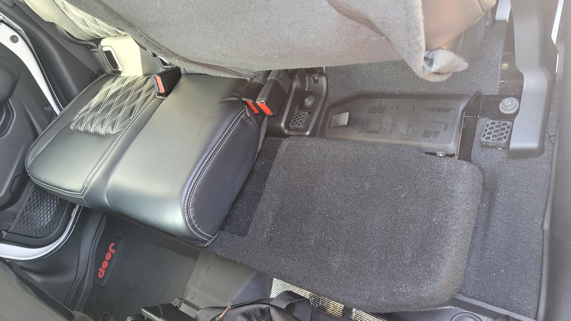

Get the upgrade pods to fit the 6.5" speakers for both the dash and soundbar. Night and day sound quality. The jl twin 10" sub below the seat is spectacular and retains the factory look.
Can you show where and how you mounted the amps?
I have the JL vxi 600 mono and 800/8 and the JL mounts for under the seats but I’m not sold on the location. Thinking I’d prefer them behind the back seats somehow.
Thanks. Yes, I did notice that the polarity was reversed. I couldn't tell the difference in sound quality after I changed it. Likely because the dash top speakers aren't low enough in frequency to be noticed when out of phase with the other speakers.
After the replacement speakers not sounding quite right and after reading your post, I went back and double checked. Sure enough, the Metra adapters were wired wrong, flipped. Swapped the pins in the connector by unlocking the catch with a pick. I should have caught that at install, but didn't.

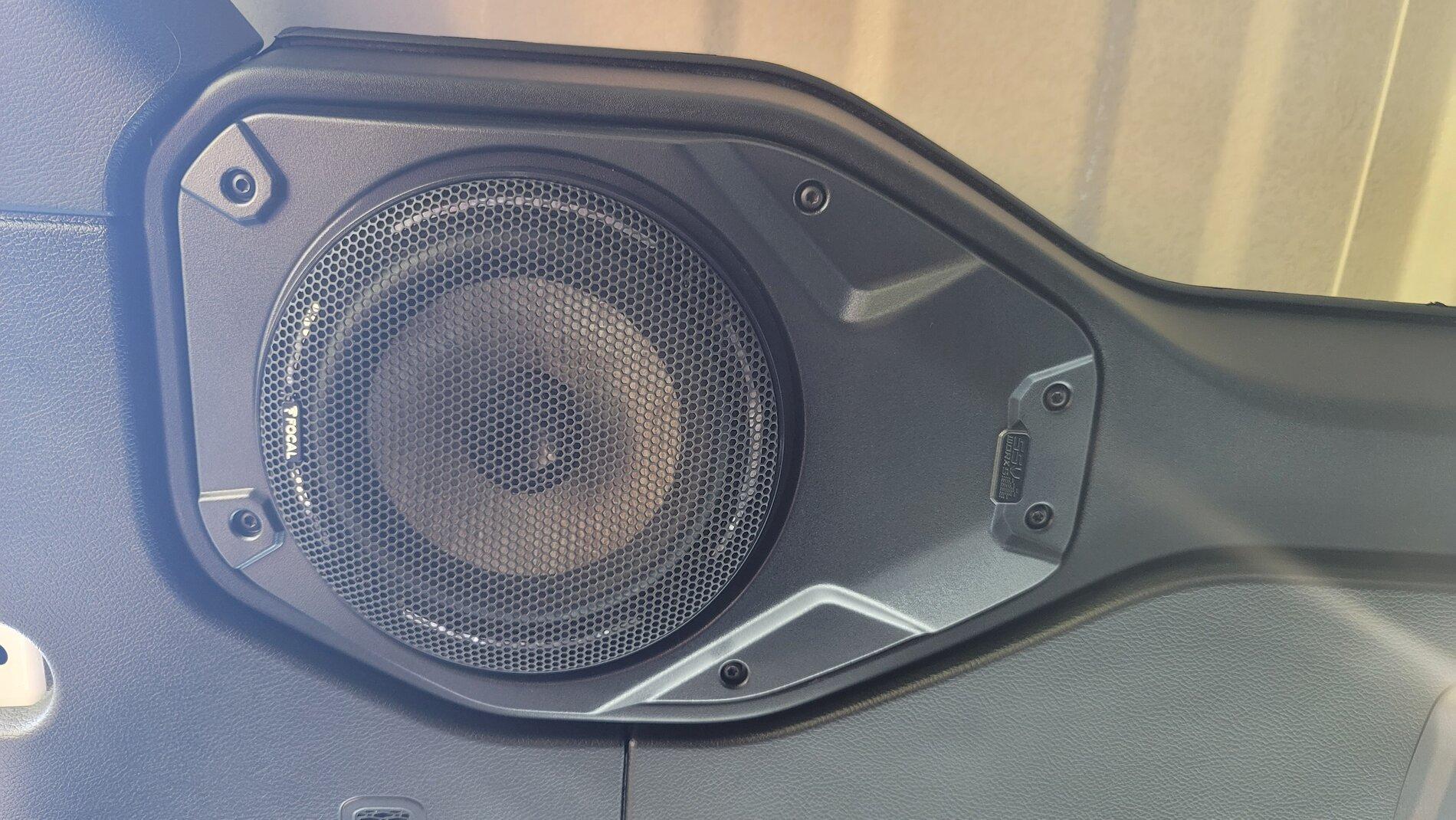

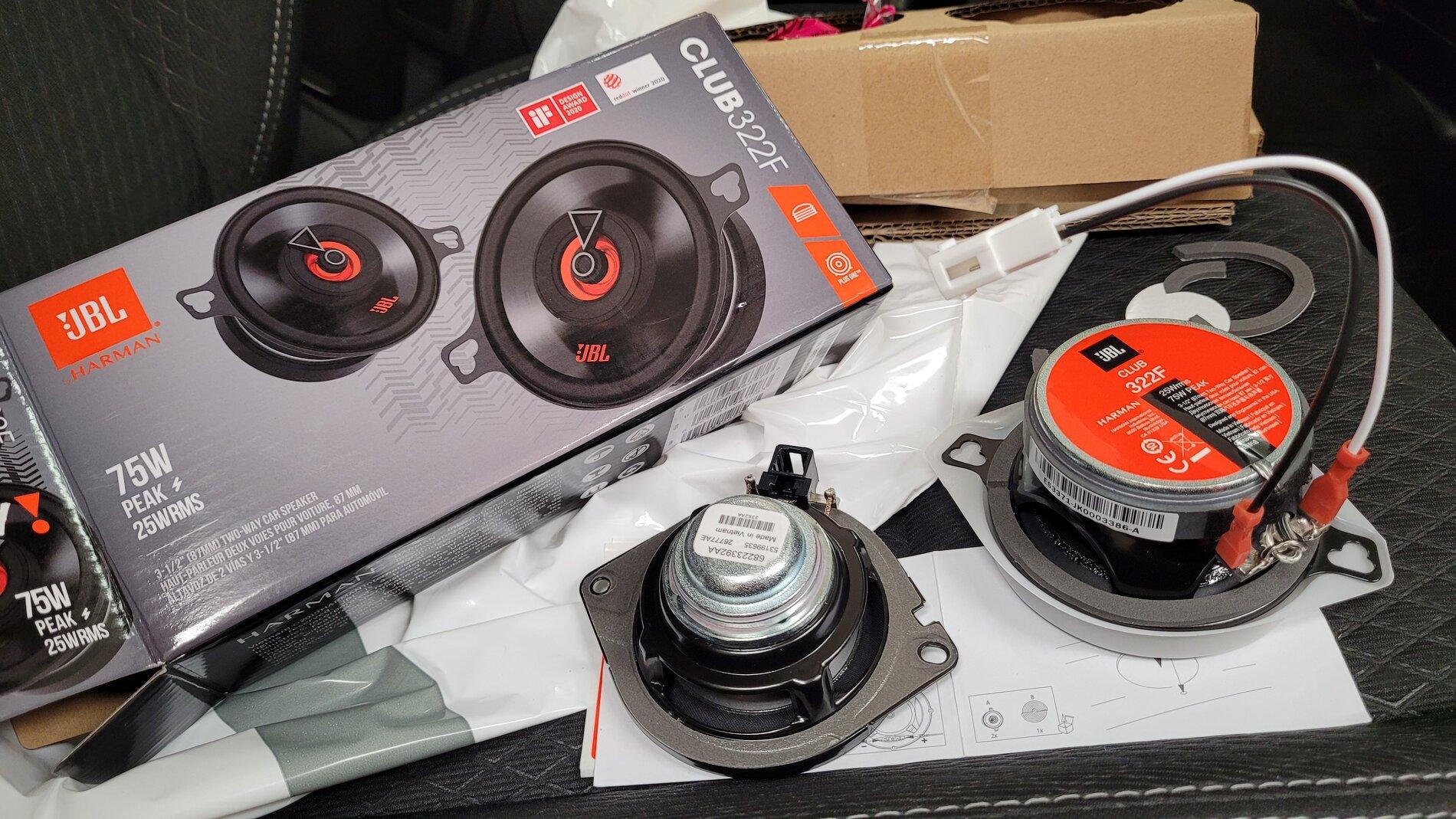

Replaced dash speakers. Definitely "brighter". Stopped by Crutchfield in Harrisonburg VA to pick them up. Had to bend the tabs to fit, tight fit for both sides especially left side.

Jeep Gladiator Speaker swap 20210503_181120
I had JBL home speakers many years ago and LOVED them, but I replaced my dash speakers with these last month and I am disappointed. Honestly, at this price point I should not have expected big results.
They are an improvement, and I agree with the "brighter" comment, but I was expecting more.
