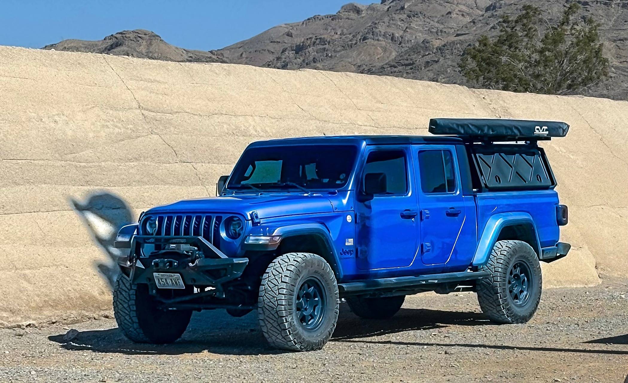

That Sport S is very capable. On 33s stock height was good but I would get hung up a little. I did a 2.5" lift and it did better and had a better ride. I went with the 35s and it does great! It also has a much better ride.
Jeep Gladiator Sport S Capability 2024-04-13 10.15.39-1
