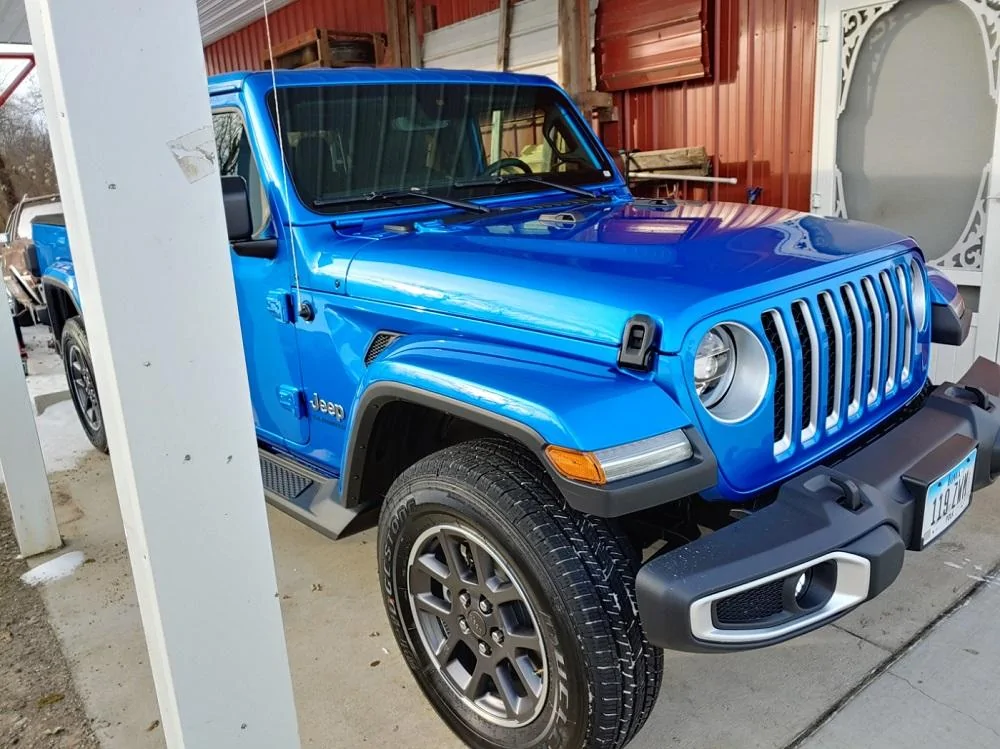

Maybe this is obvious to everyone else but I thought I would share this if it even saves one other person from taking the splash shield and fog covers off just to realize the lights they ordered don't find. My Diode Dynamics SS3 fogs came in and I realized after I had everything apart that the brackets I needed were clearly the Overland/Rubi 4 bolts. After about 5 minutes of searching around I realized the Sport S (but not the Sport) when ordered with the max tow package gets the Overland bumper. Another positive for the max tow package but frustrating if you are not paying attention when order stuff... like me!

I bought the same fog lights for my Max Tow. I had to contact Diode Dynamics directly to find out which bracket to get.
It took a little back and forth but they told me to order the "plastic bumper (non sport)"
I ordered through XT but they are also going to swap mine out for the correct ones.

Mine is a 2021. If you have the bumper with the silver bezels you need to get the "plastic bumper non sport". If you have the all black plastic bumper, you need the plastic sport. I would send a picture of your bumper to diode dynamics and ask them which one to order.

Sounds like you need to do the Overland (non-sport) option.
I have a steel bumper on my Overland - but ordered the Overland kit because the bumper came with adapters to use my stock fog Overland lights in the steel bumper. That saved me about 50 bucks.
Anyway, this is the Overland bumper - sounds like Sport S with max tow gets this bumper -
Jeep Gladiator Sport S Max Tow Fog Lights (Overland Bumper) jt-rf
