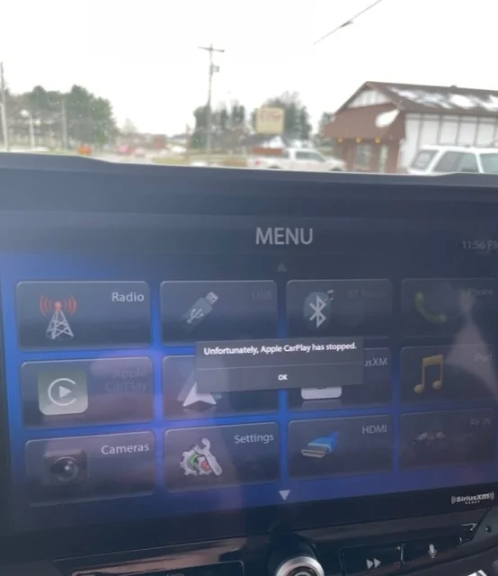

Has anyone ran into this issue with the Stinger High 10? It gives me this error and will not go away. Tried different phones, tried nothing hooked up, tried to disconnect battery to reset, nothing works. If you hit ok it just pops back up. Not able to use anything....

I recommend installing the latest firmware/system update. This should get that message to go away. I have attached instructions on how to update. You can find the latest updates here: https://stingeroffroad.com/collecti...tainment-kits/products/rb10jw18b#new-firmware
Feel free to shoot me a message if you have any issue or give us a call at (727) 732-3114
I have been in contact with someone via email as well and shared the same thoughts as updating the firmware. Issue is the message doesn't go away so you can't access anything. Can't push the home button, etc. As soon as you hit ok it pops right back up so I can't do any updates, check system. reboot, etc.
I was able to install the updated firmware and so far, so good! It was a bit tricky as you had to hit the ok button and immediately hit the button you wanted to navigate so took some time to get through the screens, enter code, etc. Greatly appreciate your help!
