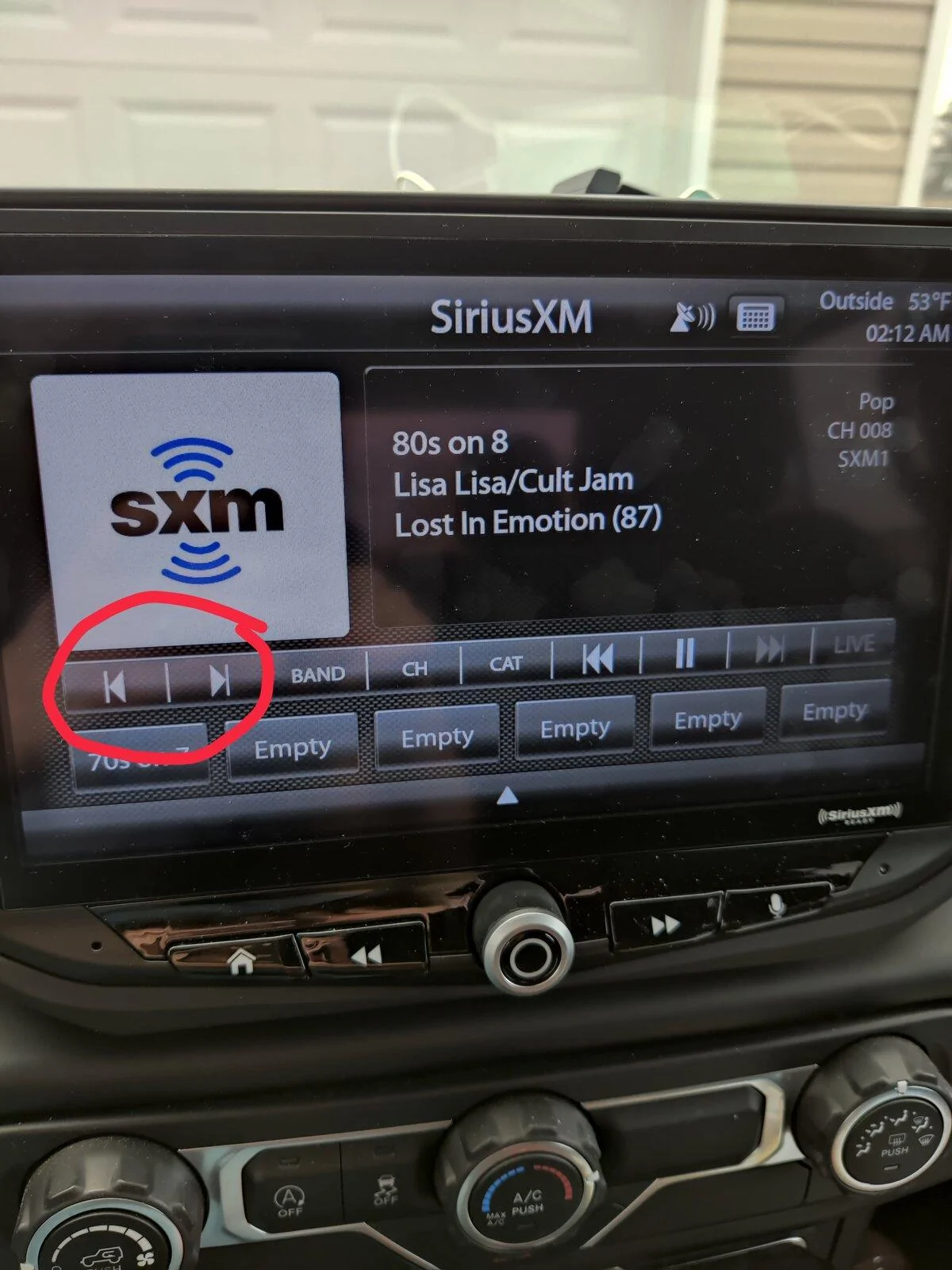

On another note. I find it annoying that the steering wheel controls cannot be programmed like factory unless I'm missing something. The left had up and down switches through presets and the center changes band. On factory that was channels up and down while the middle button cycled thru presets. I'm not so worried about the cycling thru presets. But I would like to channel up and down on SiriusXM. But don't see the ability to assign to a button. Anyone able to do this? Or can this be an option for a future update?

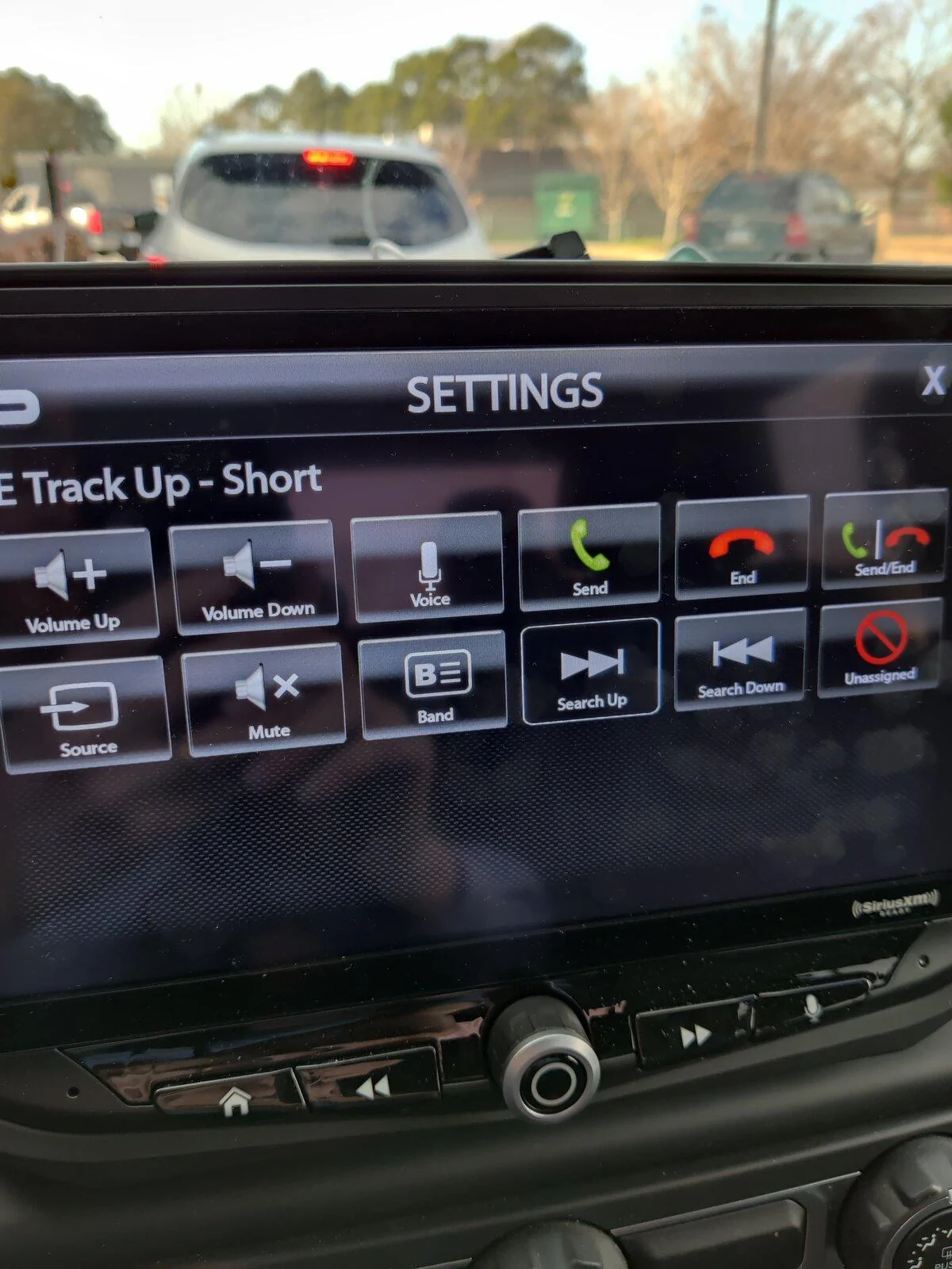

I'm gonna have to call you on that one. Because I can't for the life of me figure that part out.
Tortfeasor
Jason
Mar 17, 2021
North Carolina
2020 Jeep Gladiator
Attorney
Hey Jason,
Happy to hear you got it updated! The steering wheel controls should function the same for XM as they do for FM. They can also be customized to control a ton of different options by programming them within advanced settings using the installer passcode include with the manual. Call back if you have any questions, we are happy to help!
These are the only options I have for button assignments the track up and down goes up and down my preset list. If I press and hold on FM radio it will seek to the next station even though it's unassigned in the settings. Pressing and holding in XM causes it to change channels very quickly but I can't simply go up one channel. I tried assigning the track up and down to a long press and leaving the short press unassigned to replicate the behavior on a long press but it does not work.
