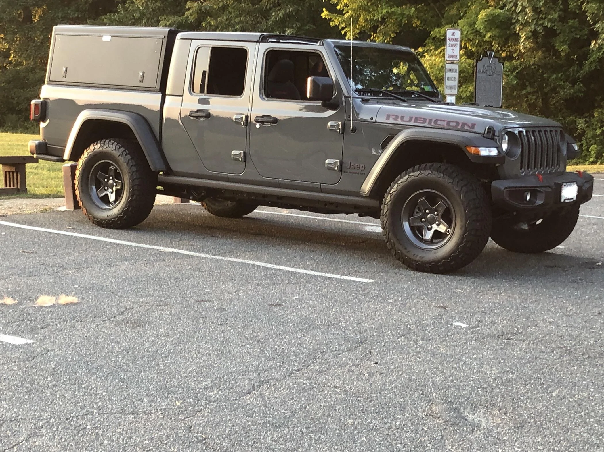

The only way you wont notice the difference (even just going to 315/70-17) is if you’re just not a very observant person.
The negatives…as already stated…are cost and weight. As I alluded to above, it will be a bit more sluggish on acceleration, but it’s not a deal breaker, in my opinion. I kept my JTR take-offs and I’ve yet to think “I sure would like to go back to my stock wheels and tires.”
My two cents…the JT is a land yacht. Anything under 315/70-17 look puny. That’s really what the JTR should have come with stock, in my opinion.
I would go with some BFG AT 315 70 17, it’s a light weight 35 and you can find some for a reasonable price
That’s what I went with and I’m very happy with them, but I can’t say that I found any that are reasonably priced.
Some 315/70-17 pRon.

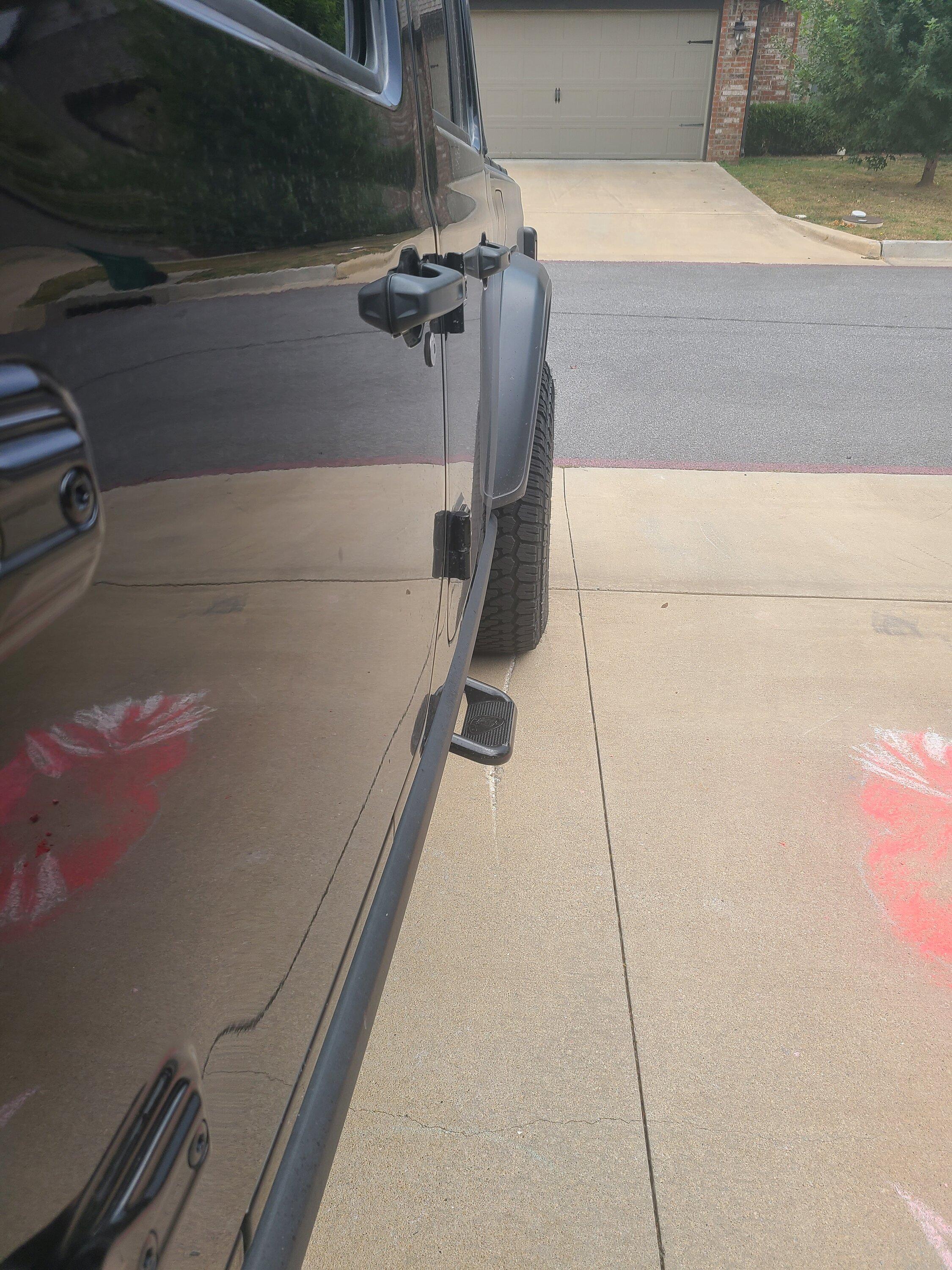

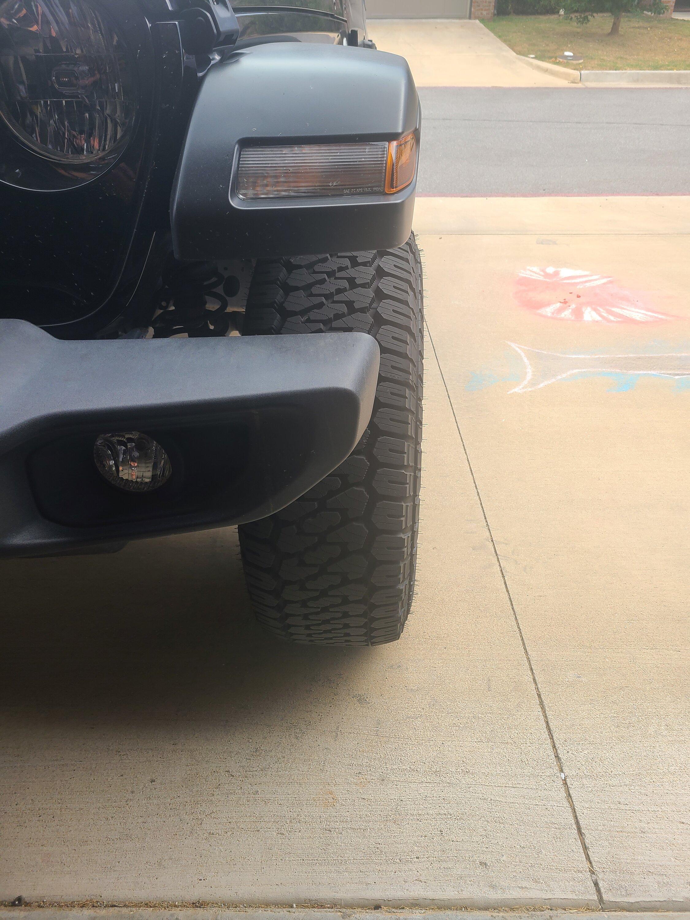

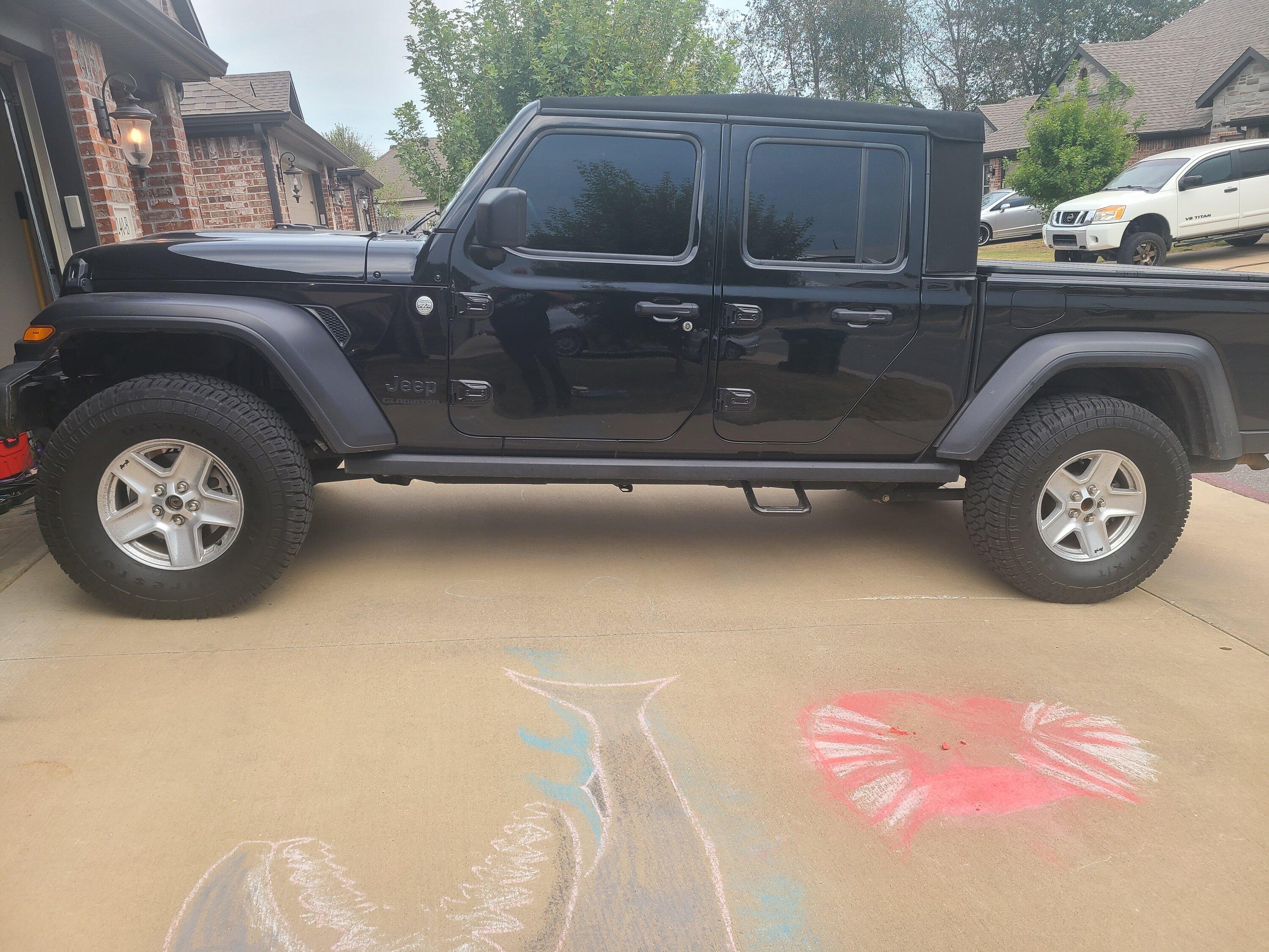

These are actually 315/70r17 on factory wheels.

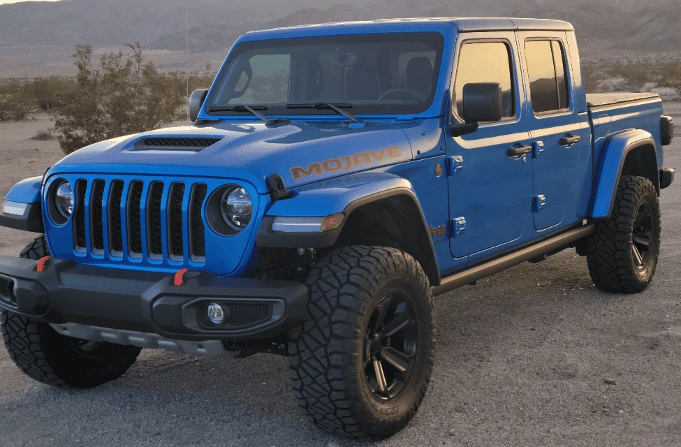

I have 33x12.50R17 Nitto Ridge Grapplers on Quadratec Recon wheels. I went through the same dilemma as you. I chose the 33s in a wider more aggressive tread pattern due to pulling a teardrop trailer. So happy I did. I didn't have to adjust anything. And it rides better than stock, especially pulling the trailer. Good luck with your decision.

Tires look nice. Fill in the wheel wells perfectly.
Hey, what are those side steps on your JT? I would like to get a set for my front doors. :like:
Thank you.
The step is modified to fit my jeep. My daughter is tiny and couldn't get in by herself without it. The box says "Carr Hoop II". I think these were designed to fit a full size Dodge pickup.
