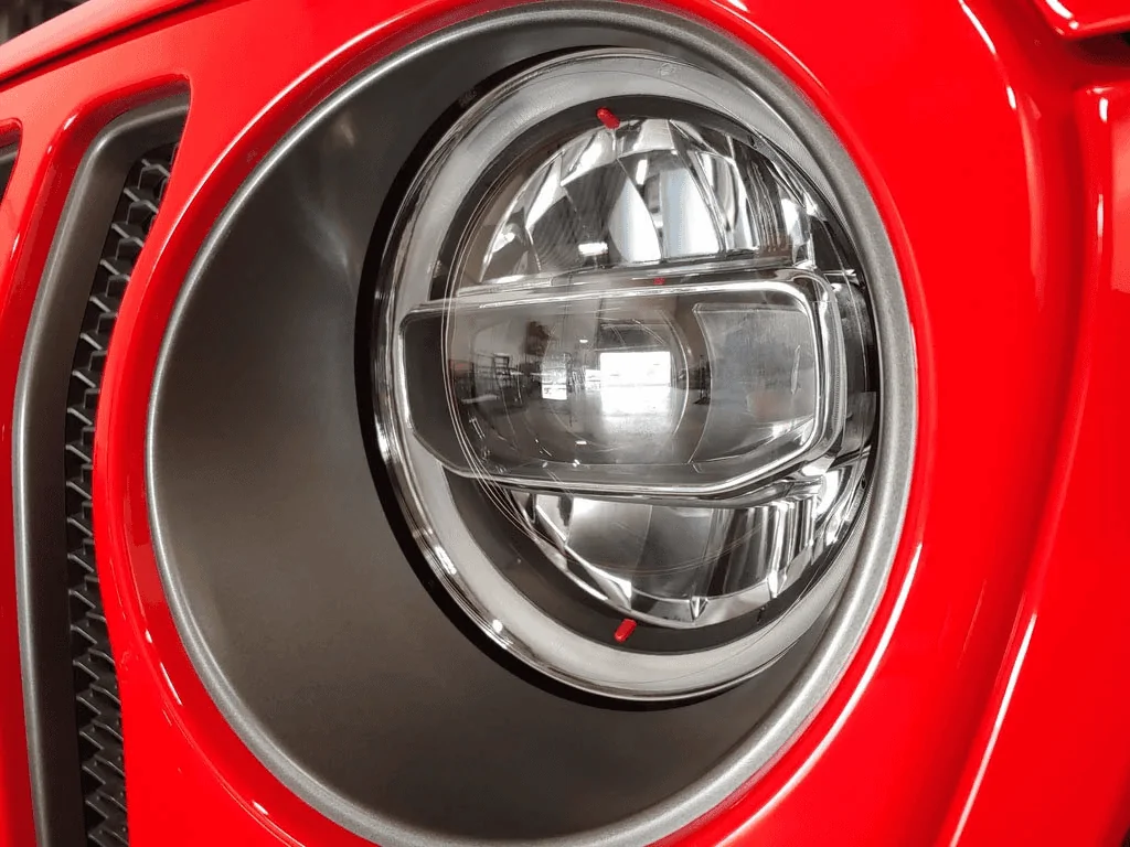

I replaced the halogens on my Sahara with the Mopar LEDs.
This was my experience:
  1. Got the LED headlamps from BAM Wholesale for $900, including shipping. It was the best price I found for a new set.
  2. The headlamps installation is plug-and-play; however, the halos are not. The kit comes with all the necessary wiring and instructions, but it is a bit involved: you need to run the wiring harness from the headlights, along the passenger-side fender, under the auxiliary battery and through the firewall, to a box behind the passenger kick panel. I took it to an audio shop; they took care of the install for $280.
  3. You then need to activate the halos. You can have the dealer do a reflash for $100, or buy a Tazer Mini for $329. I did the latter because I want all the other features.
  4. Total for the Mopar LED headlights, with the installation and activation of the halos: $1,500
Afterwards, I found these LED headlamps by DV8 Offroad: https://www.quadratec.com/p/dv8-offroad/led-headlight-pair-wrangler-jl-gladiator-jt They look identical to the Mopar headlamps but costs 1/3 less. Also, Quadratec claims these are true plug-and-play, unlike the Mopars that require all that additional installation.
If I were to do it all over again, I'd skip the Mopars and get these instead.
Jeep Gladiator Stock LED Headlights 1608791715191

What box did the halos have to wire to? I thought it was just to a fuse in the fuse box.

You will definitely need to go through the firewall.
The halos wiring harness plugs into the BCM (Body Control Module), in the passenger footwell.
