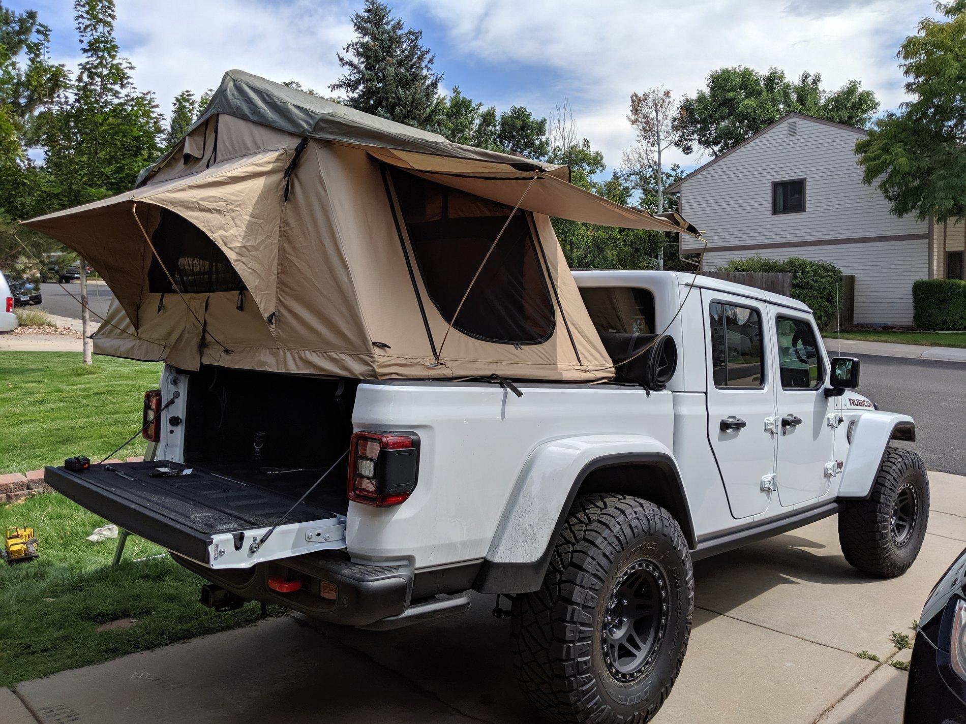

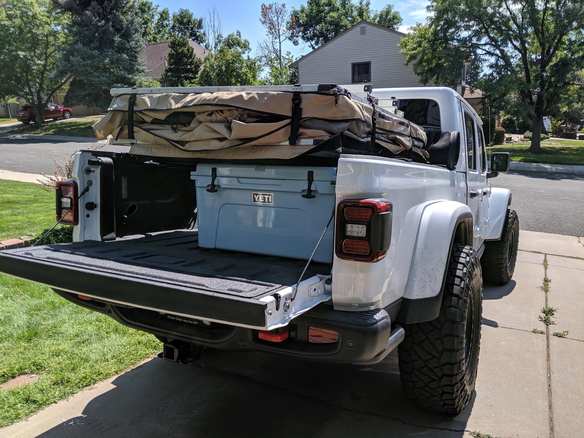

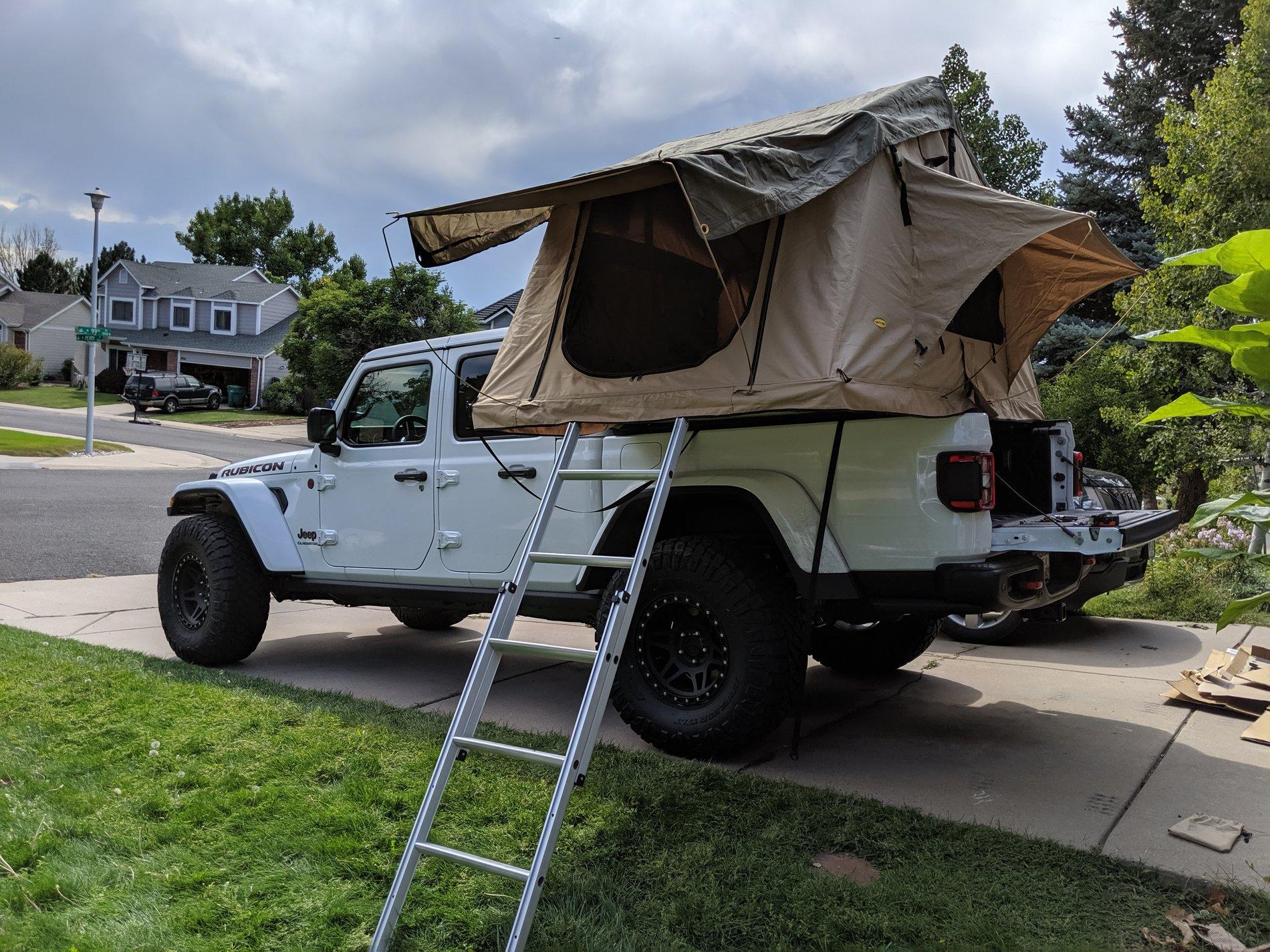

I used clips from the smittybuilt rooftop attachment clip bag. Look on 4wheelparts or approved vendors for them. They slide in the rail and then I drilled holes in the cross-rail built to secure it. Works perfect and solid..
ARB has a set too... Part Number: ARB815118
Any chance you have a pic or a link?

Those bed rails are pretty rad. Love the height at which the collapsed tent sits now.
Yes that was my goal get it low as possible keep it out of the trees and make it easier to put on take off. And I can leave the rails and still roll the cover flat.

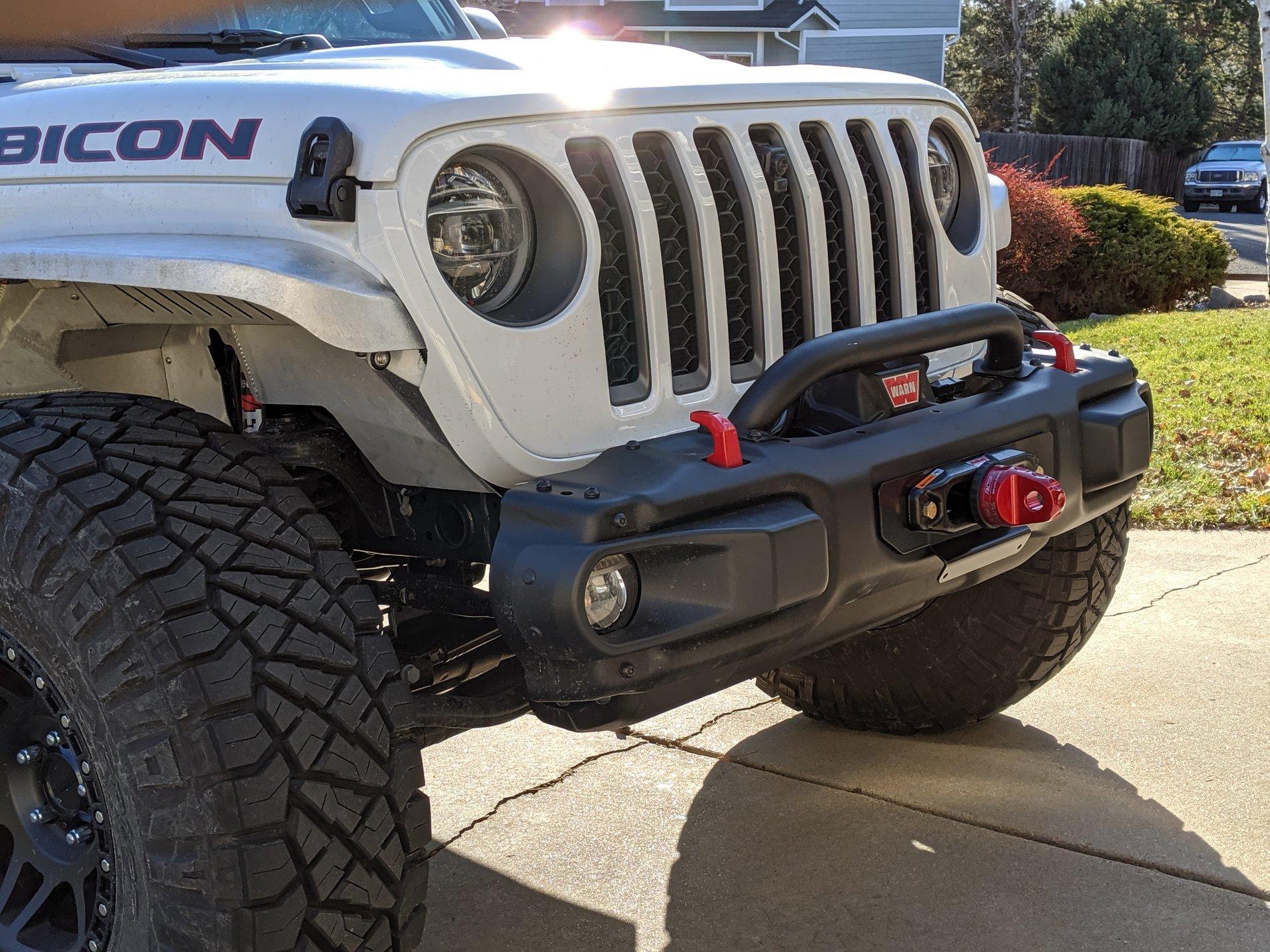

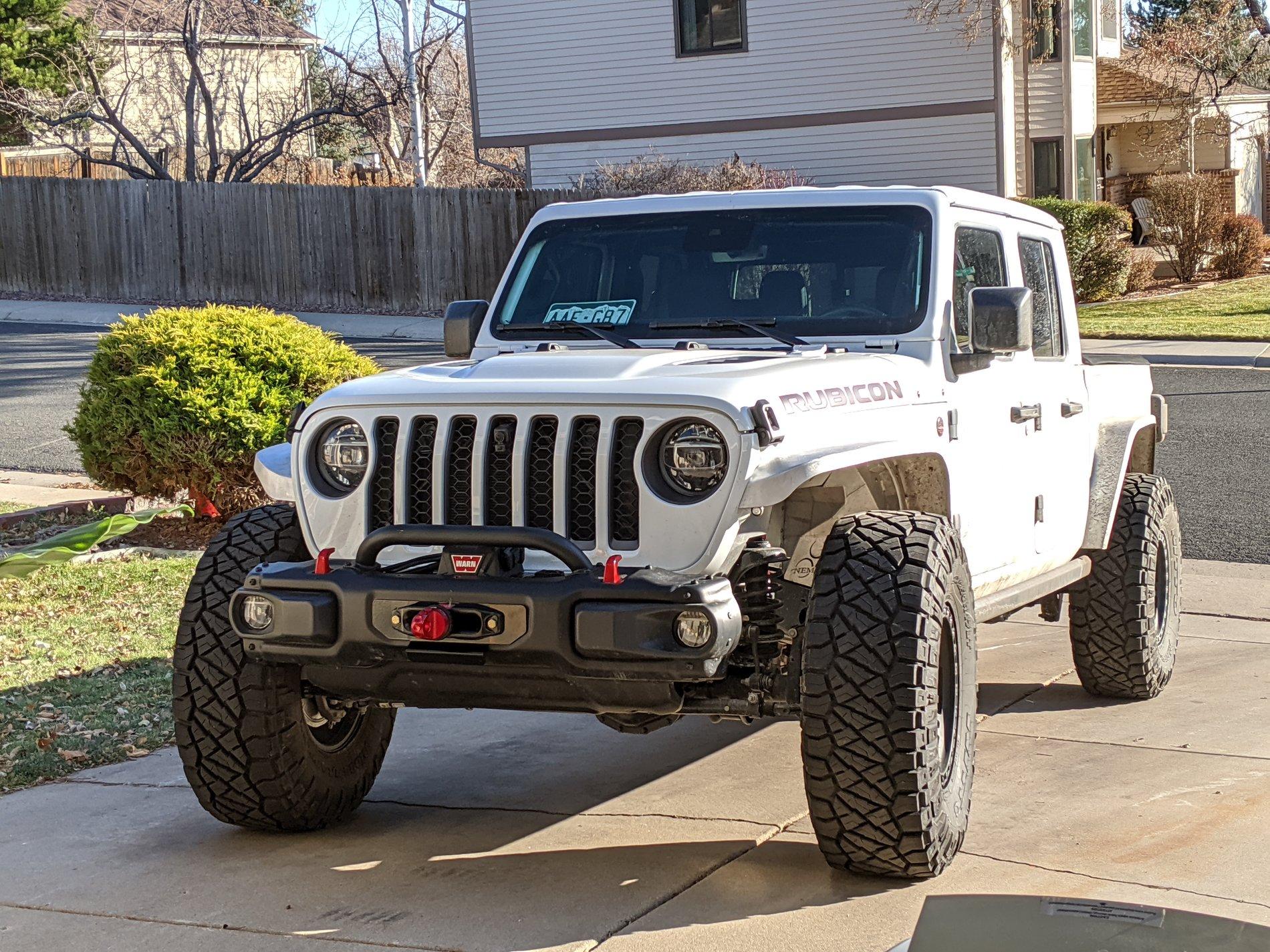

Nemesis flares and winch installed. I need to do a leveling kit now with the weight. I'll add a full lift later after they get some more testing in. What leveling kit is everybody going with. Love to bump it up 2.5 inches

Metalcloak has a 2.5 lift available.

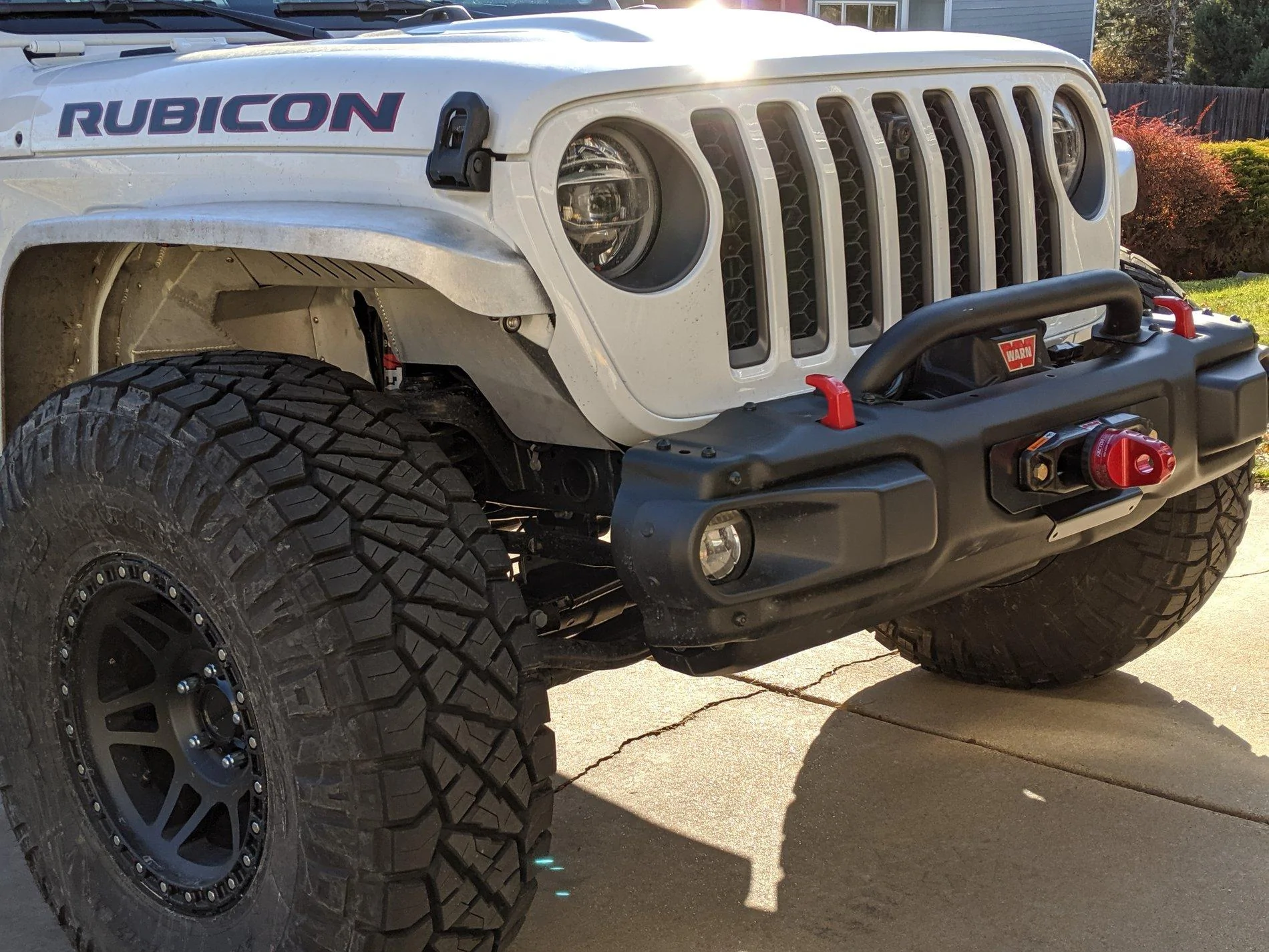

Any problems with rubbing... with your stock fenders and stock height, with the 37s?

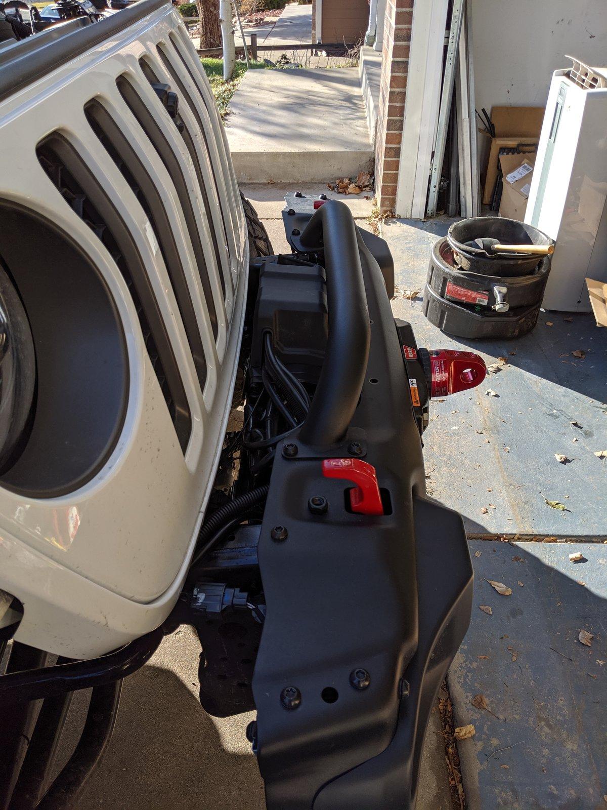

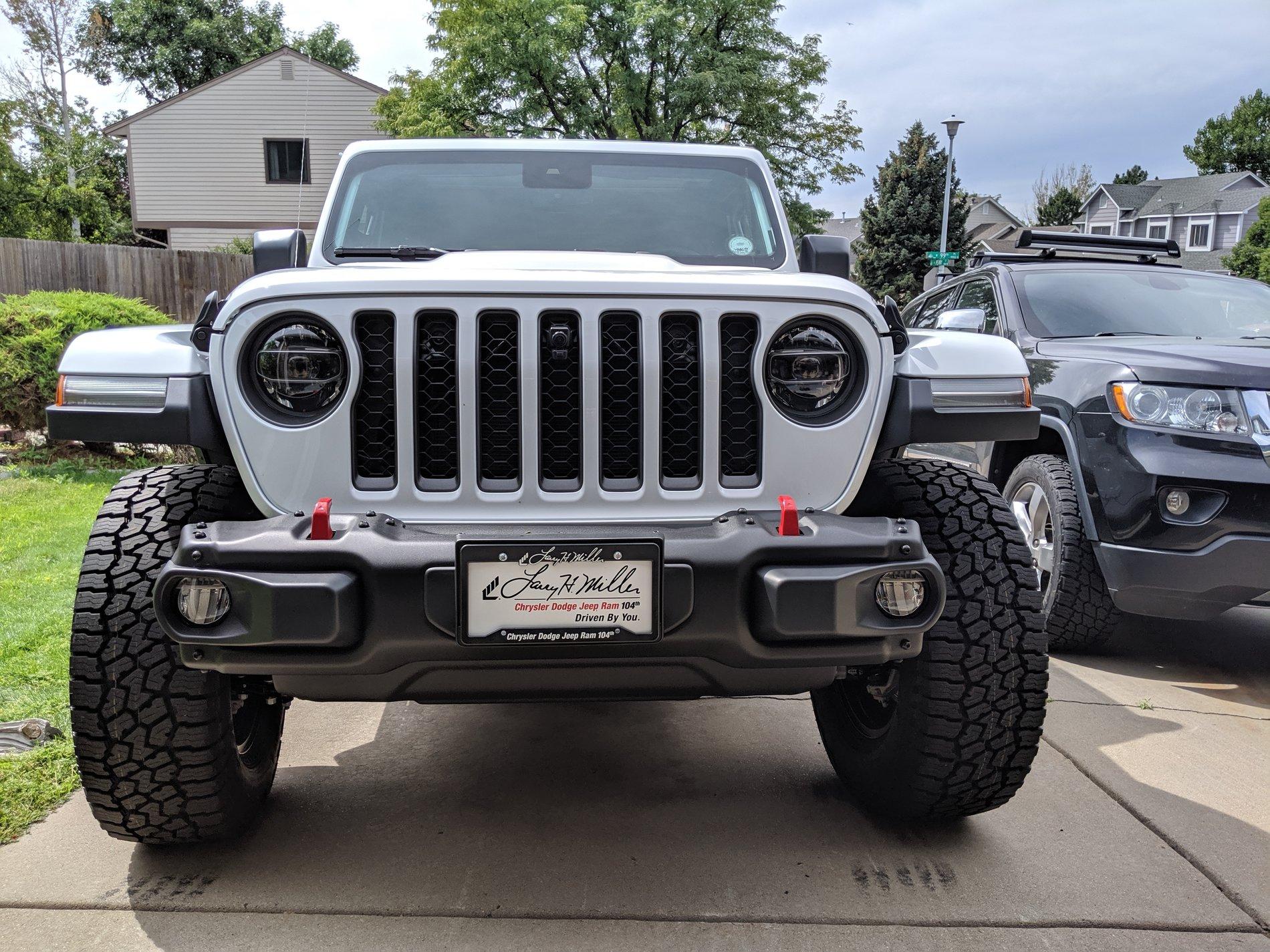

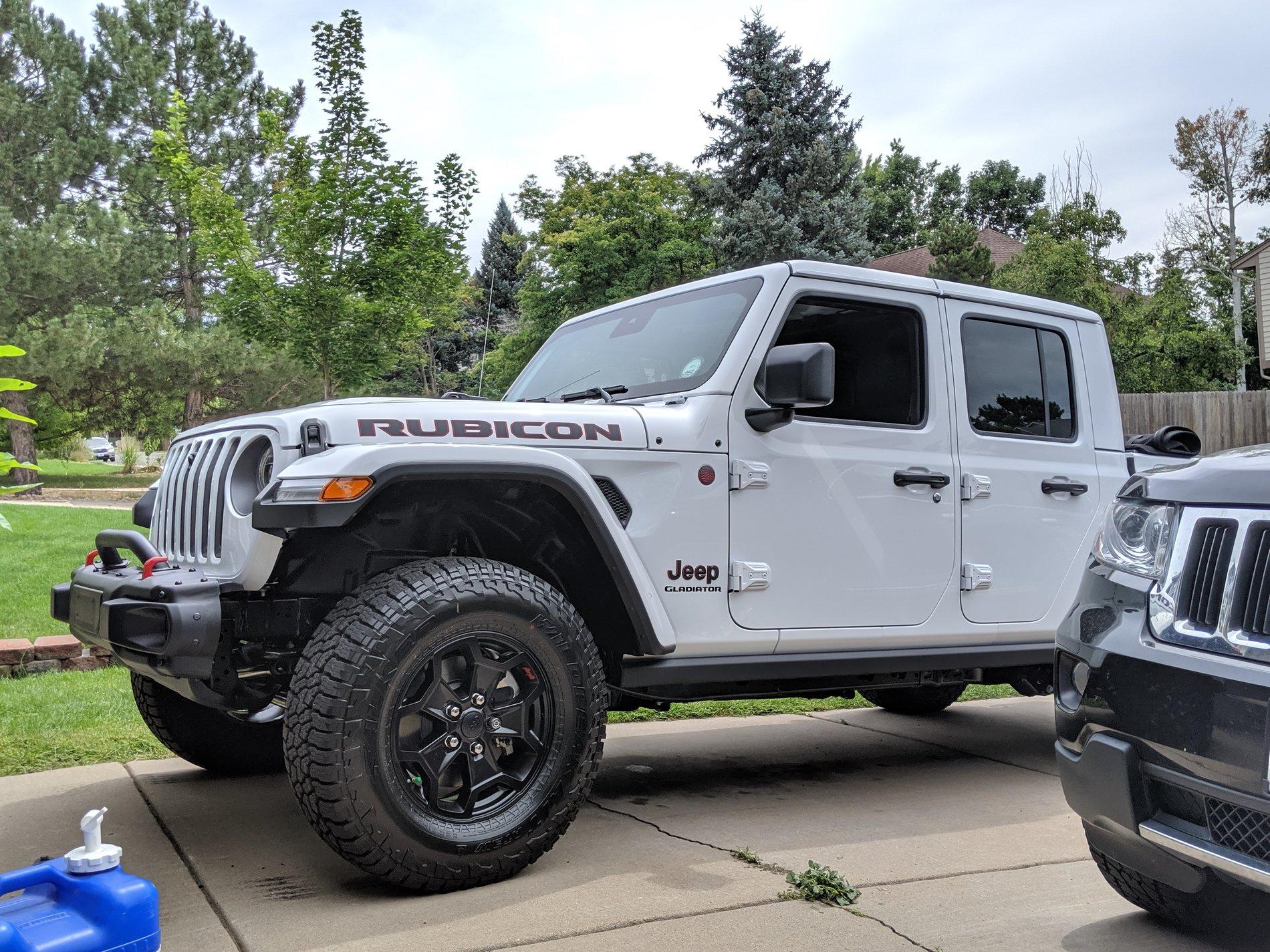

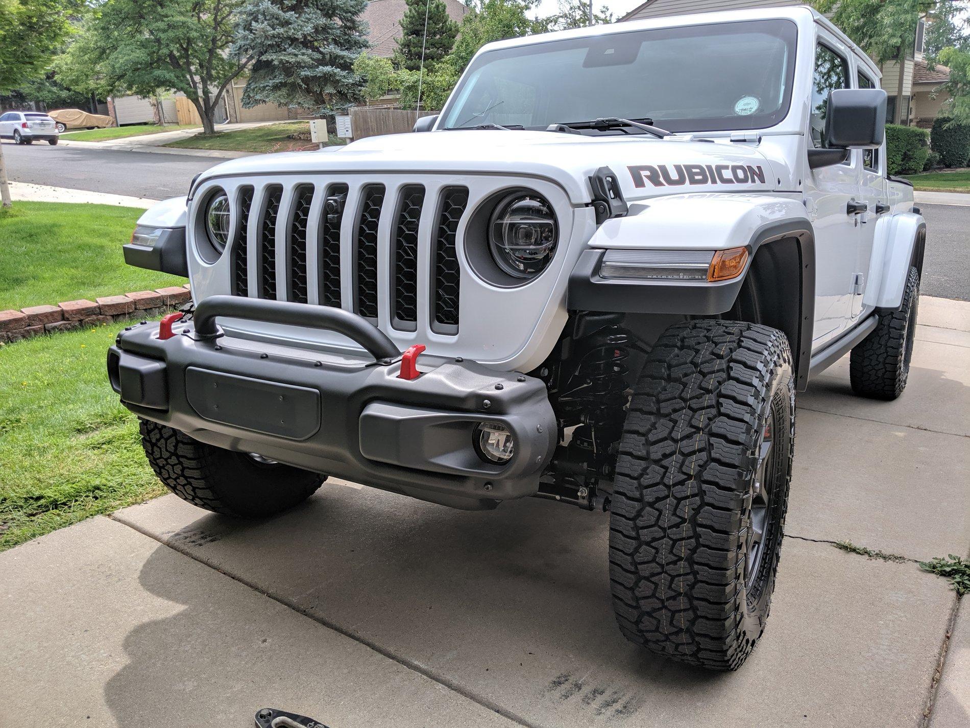

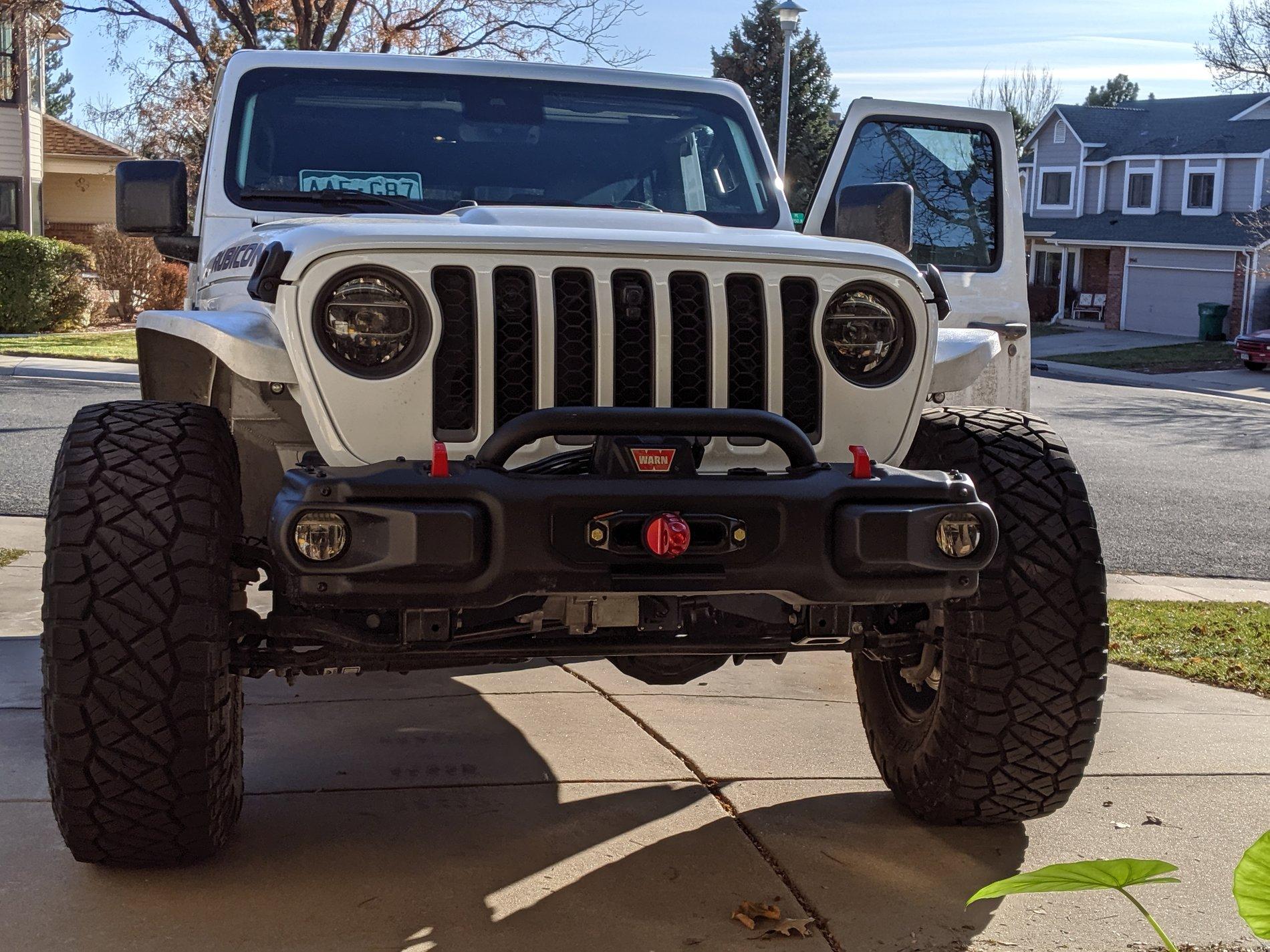

First Order of business!!! Get this bumper stubbified asap.... Pissed the dealer drilled holes in my plate!!! Winch going on anyway. Hopefully it covers it.

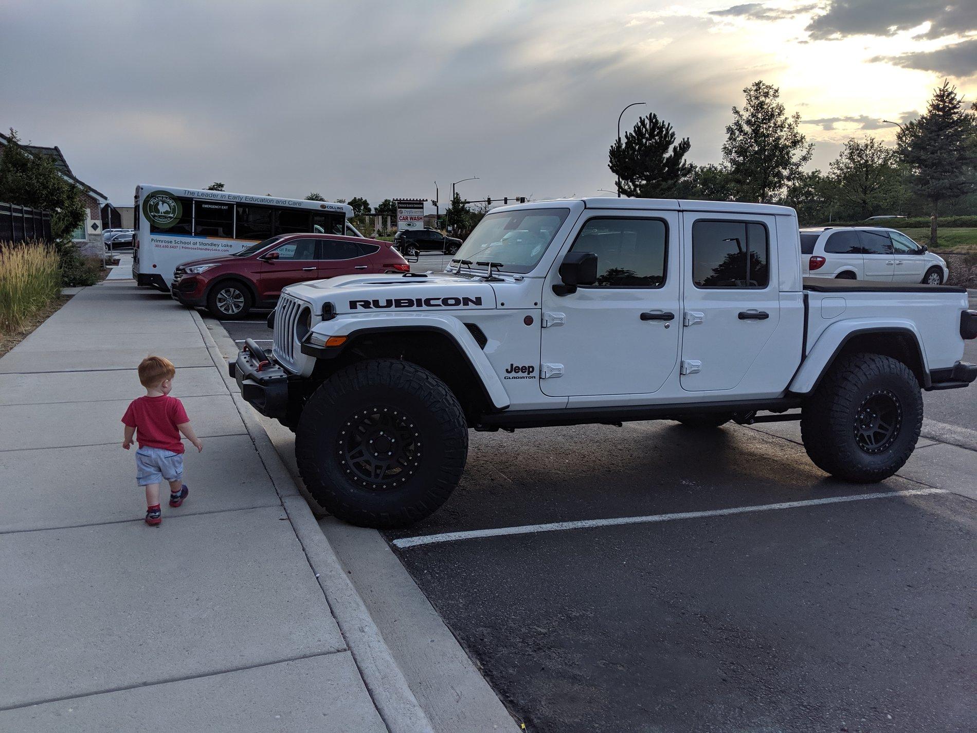

Kiddo Aprroves very much....

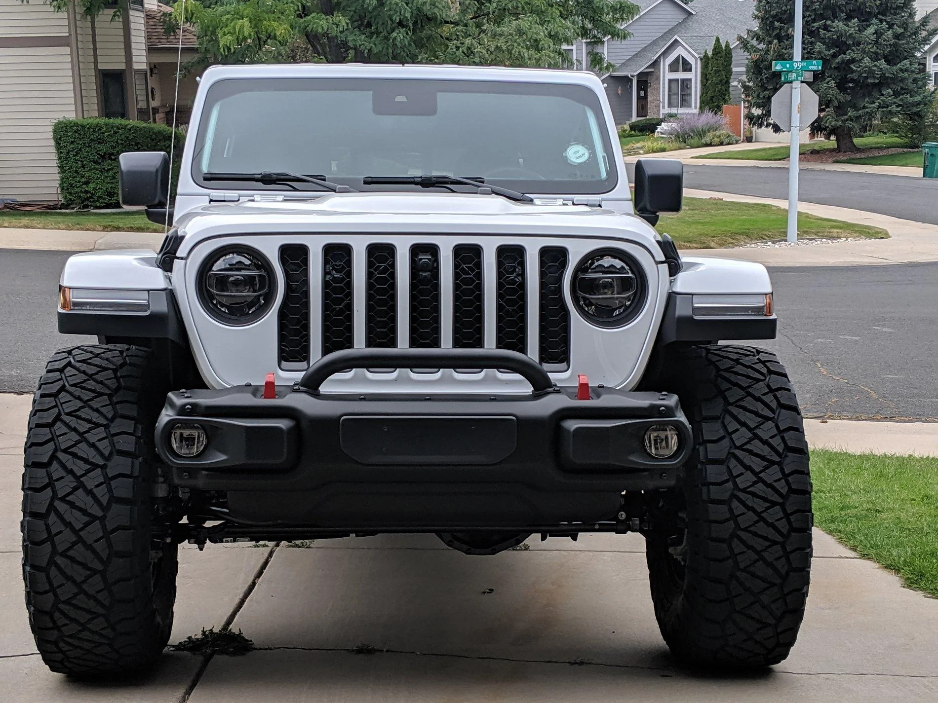

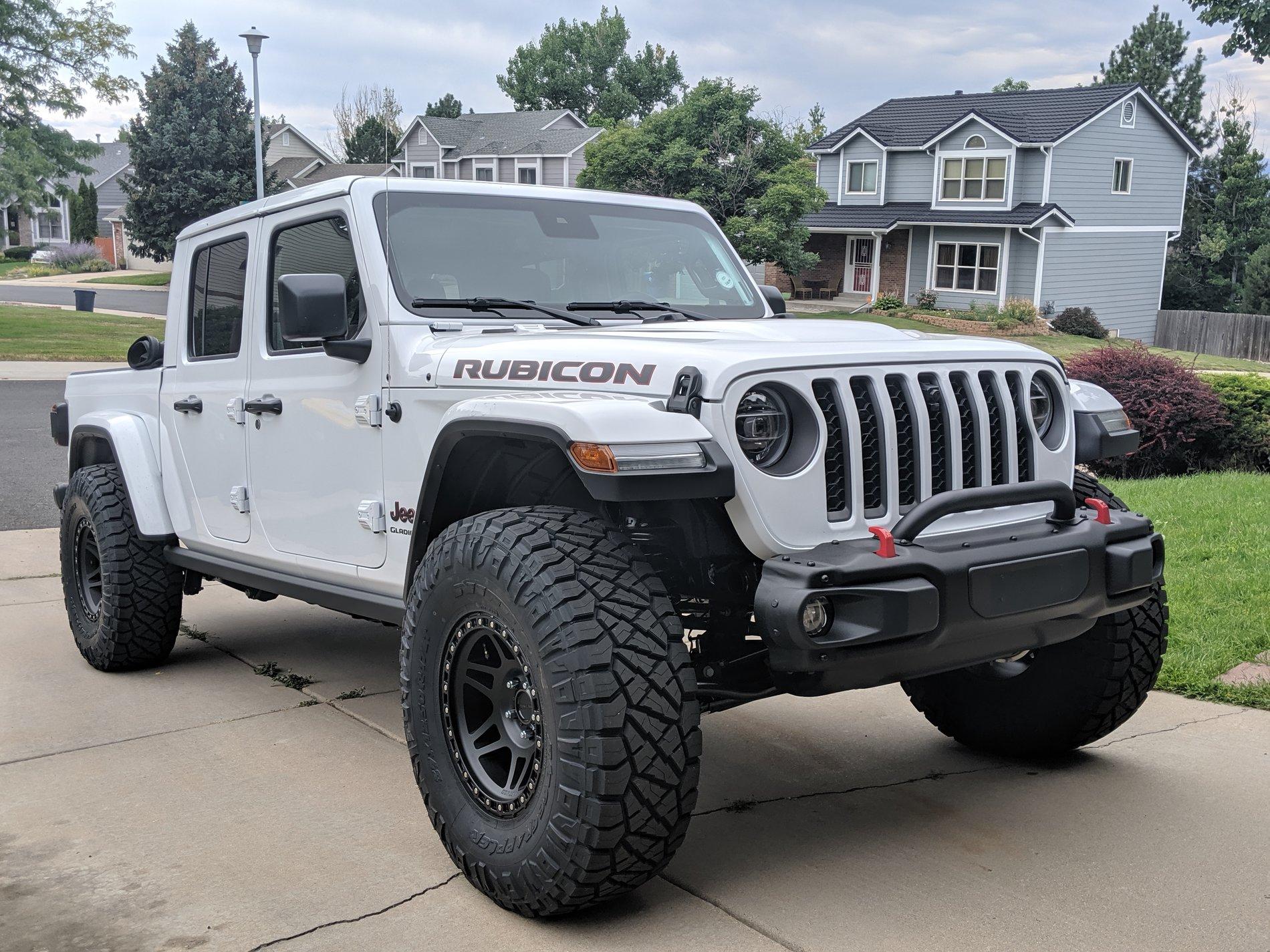

Mopar Bull Bar added. This is all day 1 of owning. Stock nope....

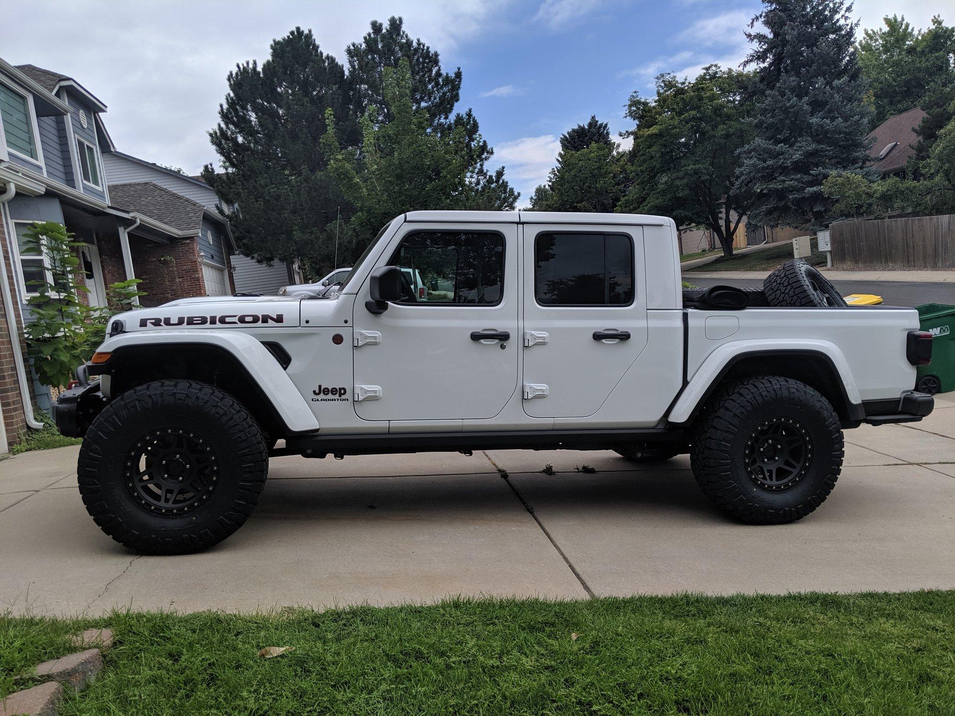

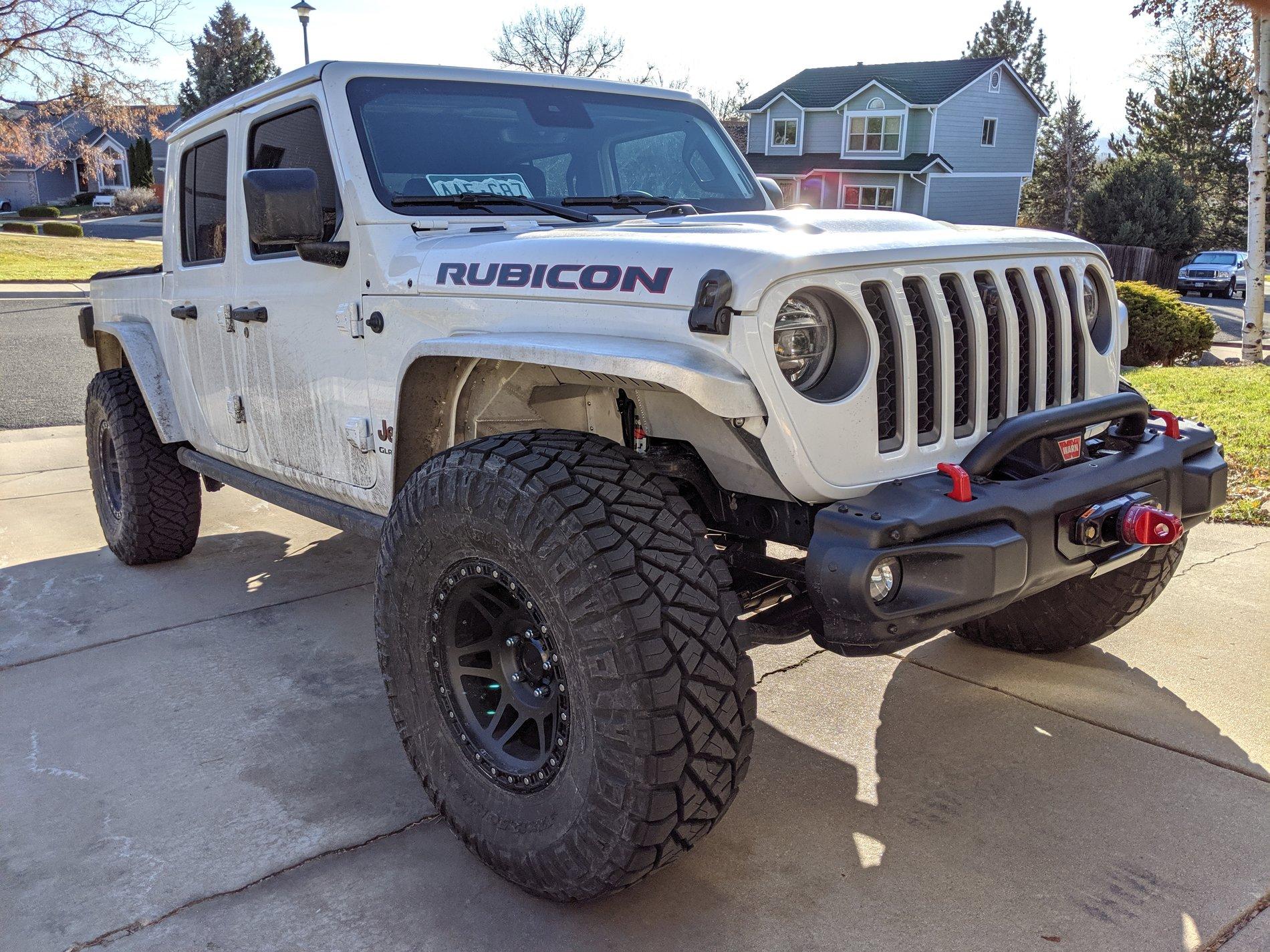

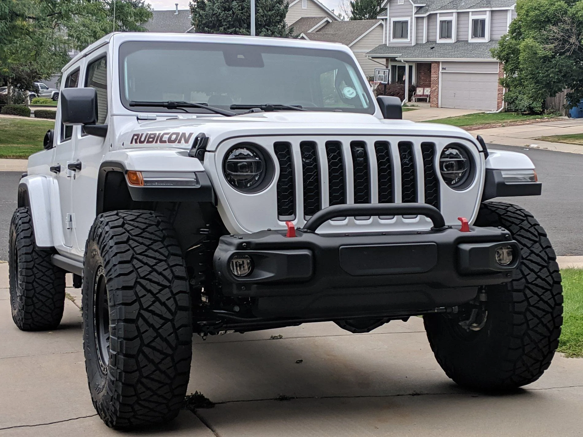

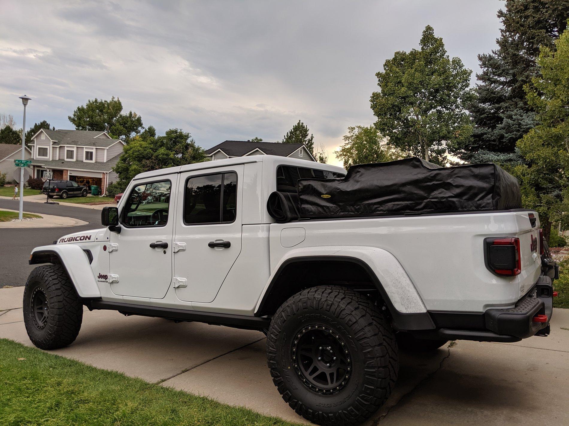

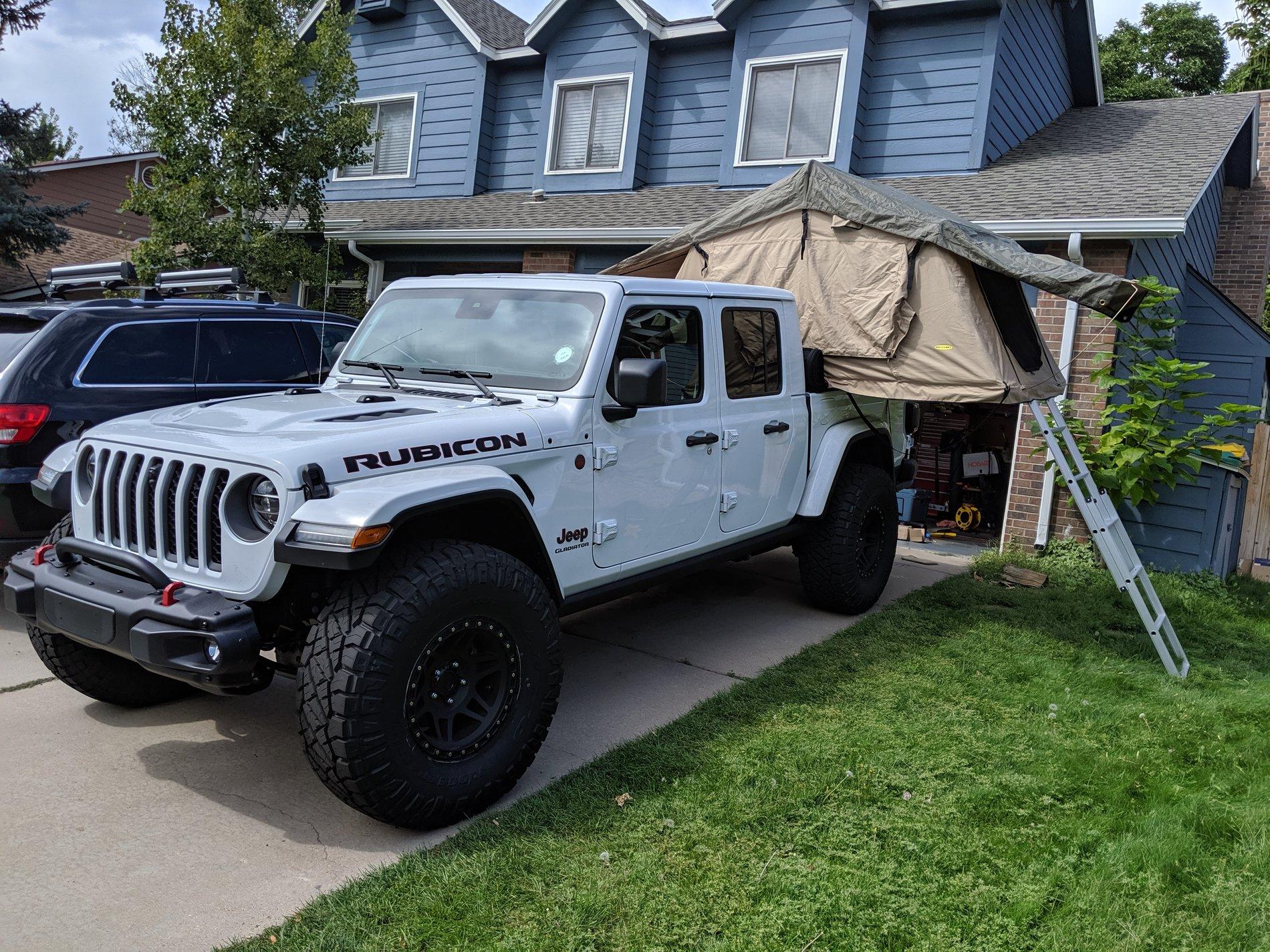

Even on the factory 285's these trucks look like ass. Had to dress her up in some real shoes to match the dress.
  • Method 312's on 9inch wheels
  • 37 x 12.50 x 17 Ridge Grapplers
  • The extra lift the rubicon springs provide with higher fender clearance allows 37's stock. Lift may come later after I wheel it a bit see how it works. I love low COG jeeps and big tires. The off Camber stuff isn't as sketchy when your not as tall.
  • Next up Winch install, floor mats and sill guards. Most likely flares down the road once I see how they look and maybe new bumpers but these work fine for a while.
