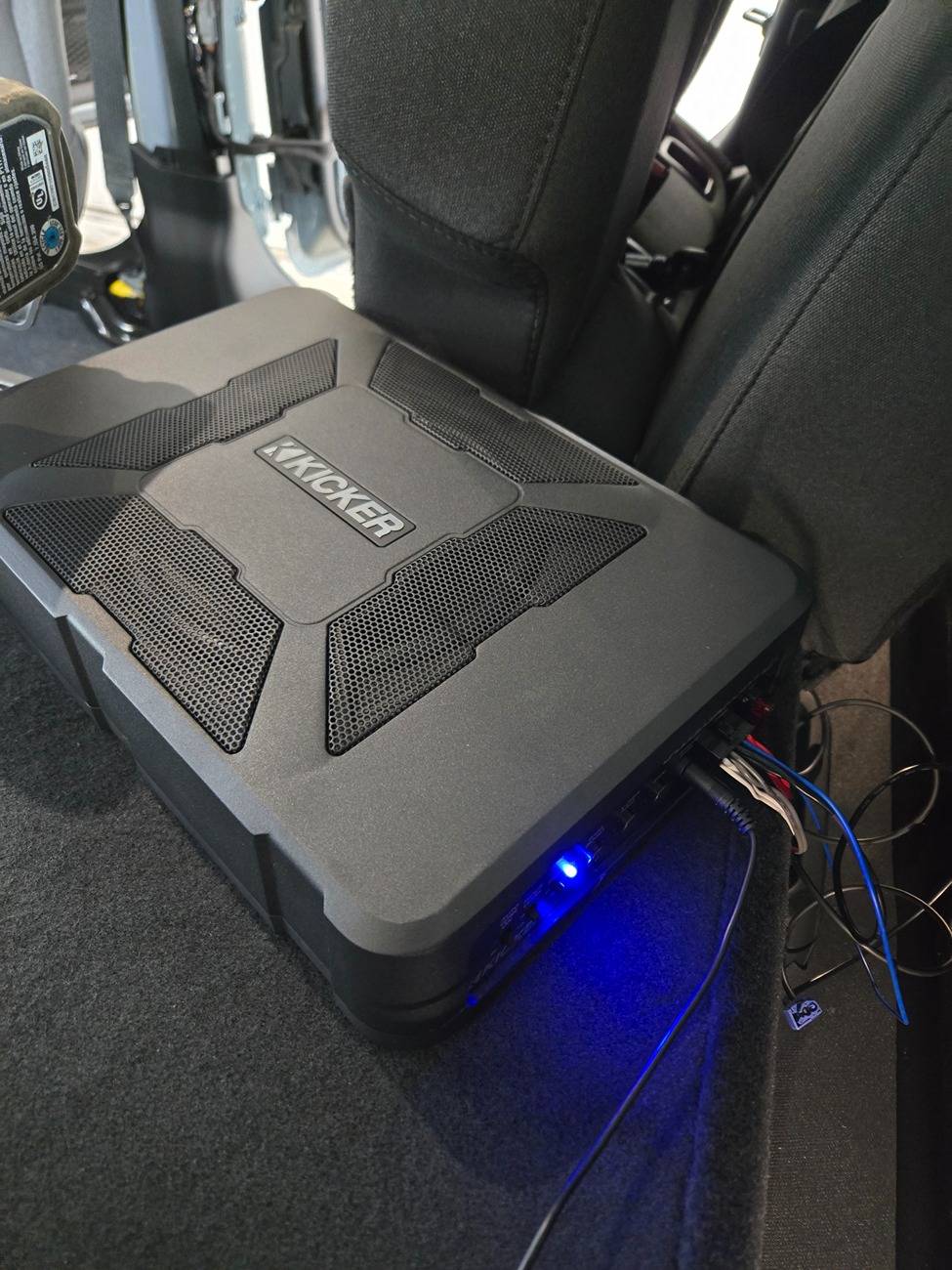

Yeah I missed the bass too, didn’t want to lose space and didn’t want to go nuts with a custom box.
Wiring was super easy, just ran power, If you have the aux switches you don’t even need to go to the battery. If you have the aux switch package, there’s wiring for the interior behind the kick panel and you can just connect directly to the 40 amp wire. If you don’t have it then you have to go through the firewall and go to the battery directly. Ground is pretty self-explanatory. The remote wiring is not necessary. The sub turns on when it has an audio signal and turns off when the audio signal is gone. As for the speaker wiring, I just tapped into the orange and orange and black off of the original sub, you don’t have to pull the entire back panel. You can pull on the passenger side pocket after removing the screws and it will just pop out the wiring for the stock sub is right there.
And that’s all there is to it, my friend.

I installed my HS10 lastnight. As mentioned above, it is the easiest install ever. Yes!!! It sounds amazing.

Yeah both going at the same time.
I had the Premo Alpine setup in mine as well, still have the head unit but I replaced all the cheap speakers and added the HS10.
Just pop the pass cubby out, there are 2 little covers covering the screw locations (hard to miss) unscrew and just pull hard on the cubby, it will pop out with some force. It’s just held down with clips. Once that’s off you will see the Alpine sub and the only wiring harness that goes into it. You’re going to want to tap into the orange(+) and the orange/black(-). Run your power, set your ground and you’re all set.
I think I found the area you're talking about to access the factory subwoofer wiring (#4 - 6-pin connector) without having to remove the entire wall trim.
Im thinking the (left) connector smaller one the DarkGrn/Orange (-) and Gray/Orange (+) ? See last picture I marked up.
So did you just attach both the positive (left/right) to the positive and then (left/right) negative to the negative wire of the sub since theres only two?
