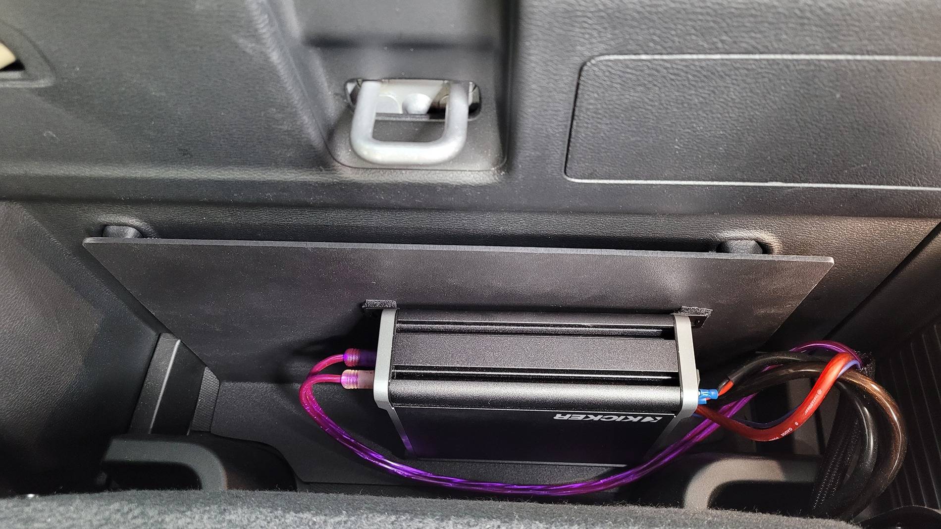

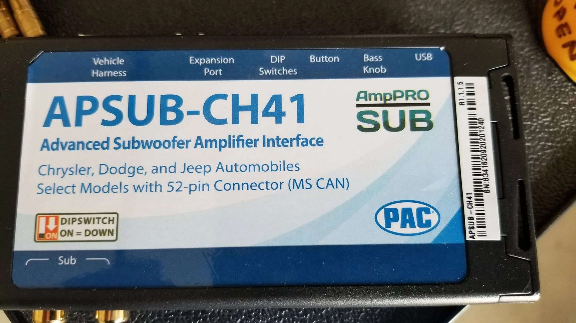

I installed a PAC, and have had it in for over 3 years. No problem whatsoever. I also have the Alpine premium (really not so premium) and 8.4" head unit.
Jeep Gladiator Subwoofer Install With Factory Premium Audio 20210212_133752
I installed a Kicker 46CXA8001 amp behind the rear seat.

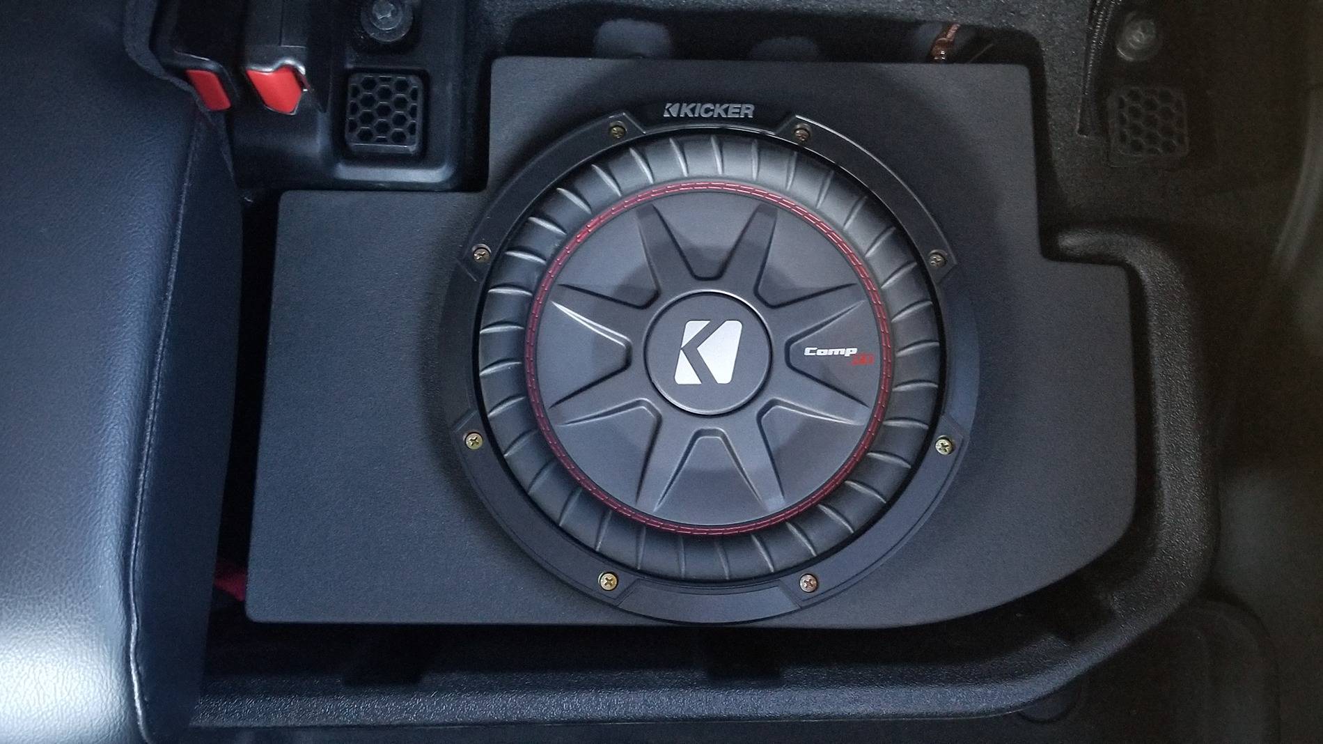

I didn't want to give up all the underseat cargo space, so I came up with my own small enclosure for a 10" Kicker sub. I know there are other great combos out there, but I've been very happy with my set up. I also changed out all of the other speakers as well.

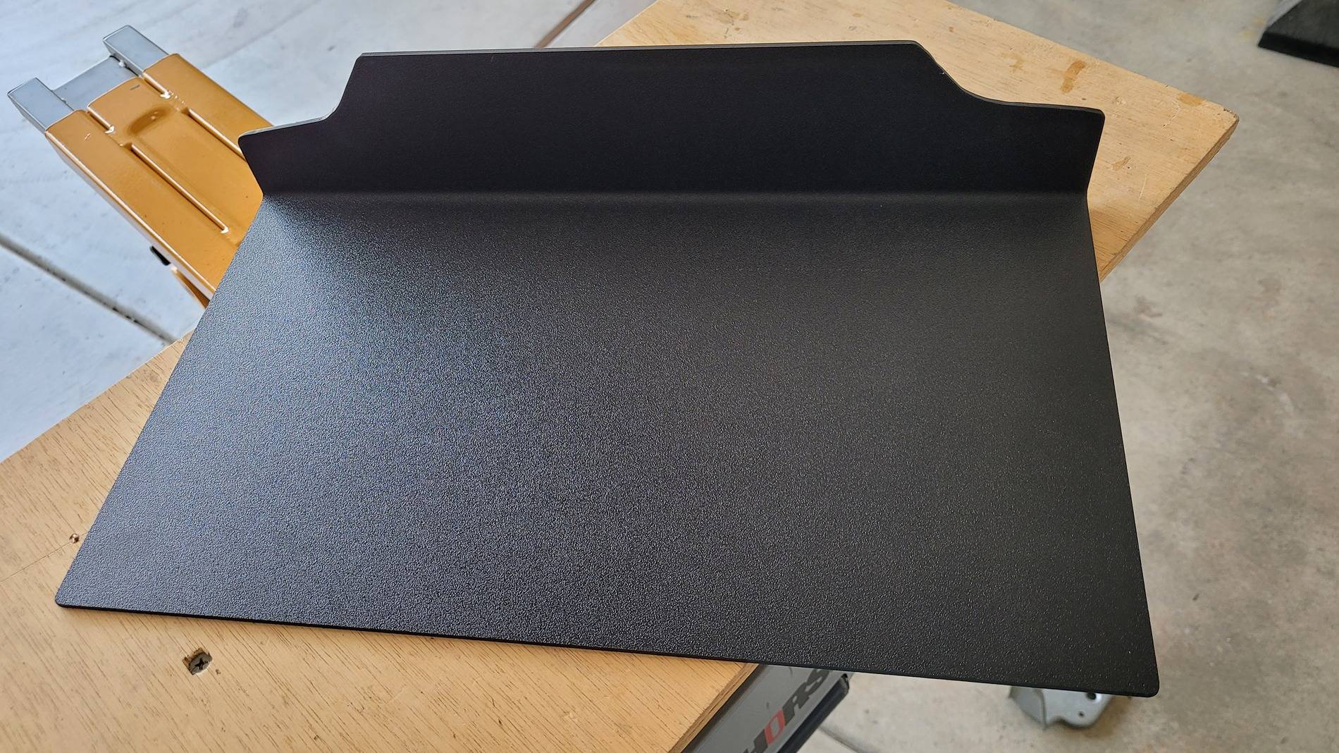

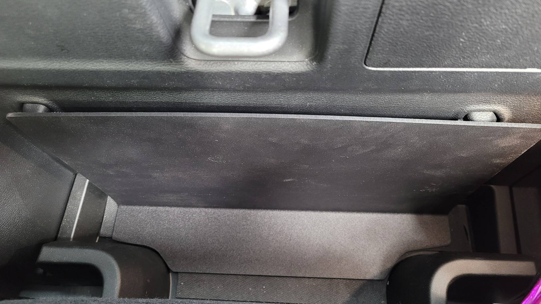

Did you make the plate that your amp is mounted to? That's where I am going to put mine if I can't find a good way to mount it under the driver seat.

Yes, I made the "plate" out of a piece of ABS. I used a heat gun to bend the 90 degress. Then, I just trimmed it to fit. I think I used some adhesive strips on the back to attach it to the cargo pocket frame. It does a good job of not tipping over.
