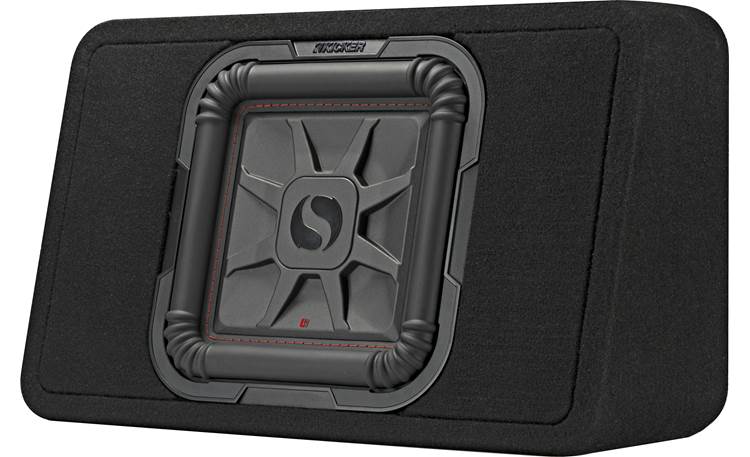

Trying to plan for system when I get my new Rubi next week ! Does anyone know if the box with dimensions below will fit BEHIND driver rear? I may just squeak it out but there is so many diffent things here and almost confusing info. I have alpine sub and would like to not remove panel as its a lease. thank you!
Kicker L7T 10 inch
  • dimensions: 20-1/4"W x 12"H x 7-1/4"D1 x 4-3/8"D2
Jeep Gladiator Premium subwoofer upgrade. g20646TL102-F
Kicker L7T 10 inch
I thought about going that same route but with those little black boxes on the back wall, I wasn't confident it would fit. ended up making a custom box with two of these subs in 10".
I wonder if it could fit under seat if I remove cubby. I am pretty sure on pass side it may depth wise but that 7" bottom depth may be too lard at the front of the seat height

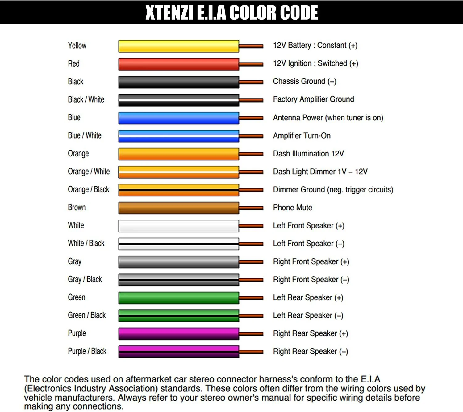

I want to replace the factory subwoofer with Kickers new HS10 powered subwoofer. However i think i'm going to have trouble due to the fact that the factory subwoofer has 6 wires going to it. Does anyone understand the wiring of the factory subwoofer? I imagine i can't leave those wires disconnected either because i'm sure the head unit will know it's not connected? The HS10 is small enough to put behind the drivers side of the rear seat but i wanted to hide it behind the panel if i could.
Color Coded Wires should be standard across all automobile manufacturers.
Jeep Gladiator Premium subwoofer upgrade. 81QSd7bVncL._AC_SL1500_
