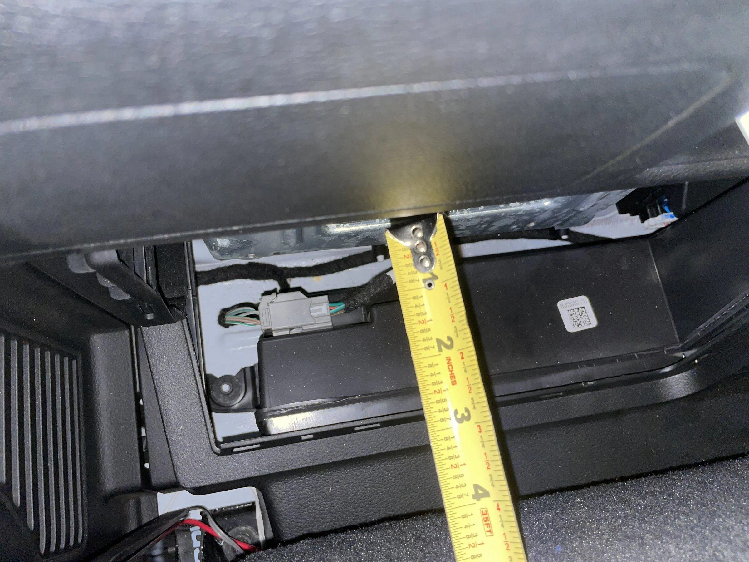

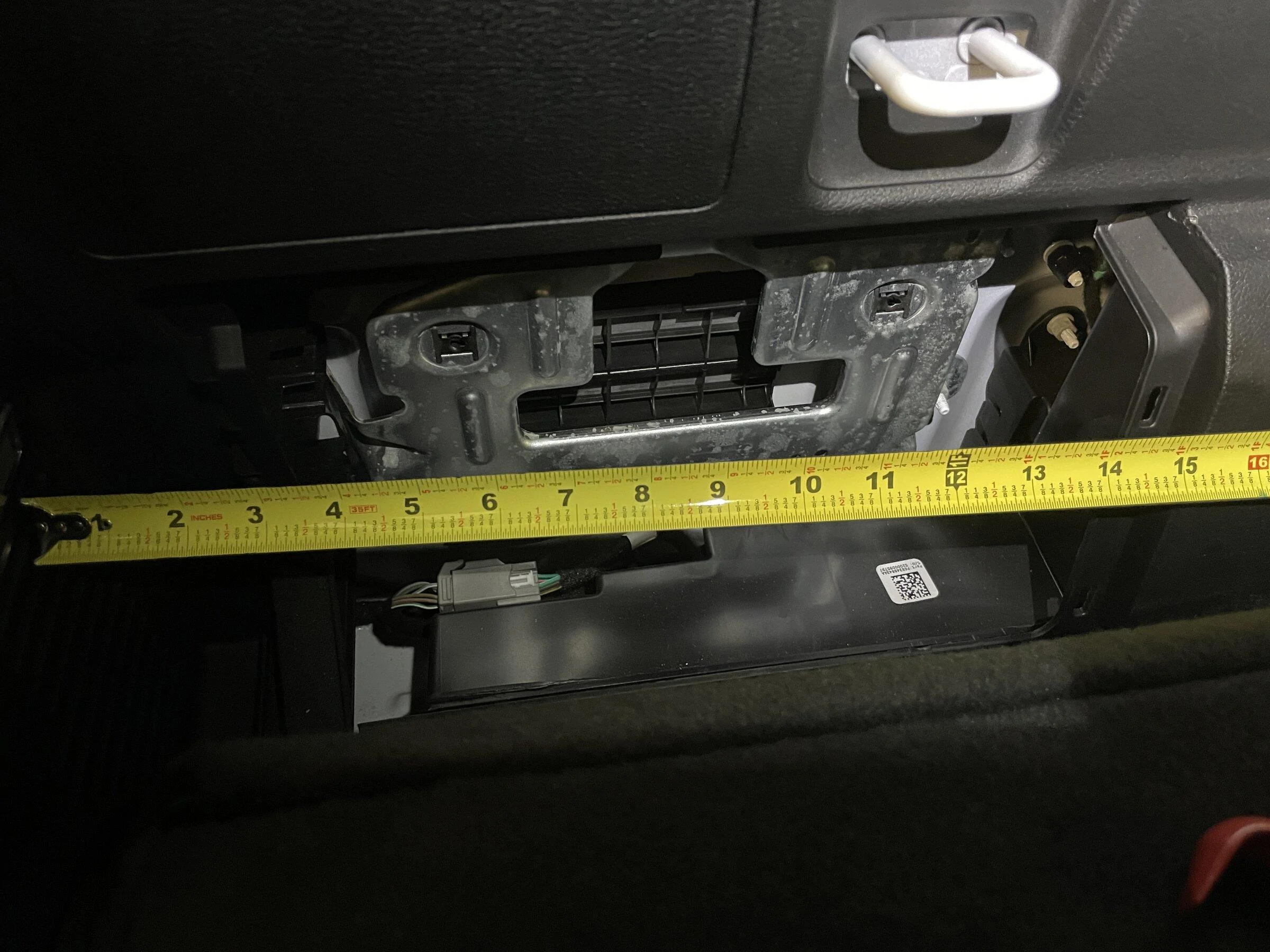

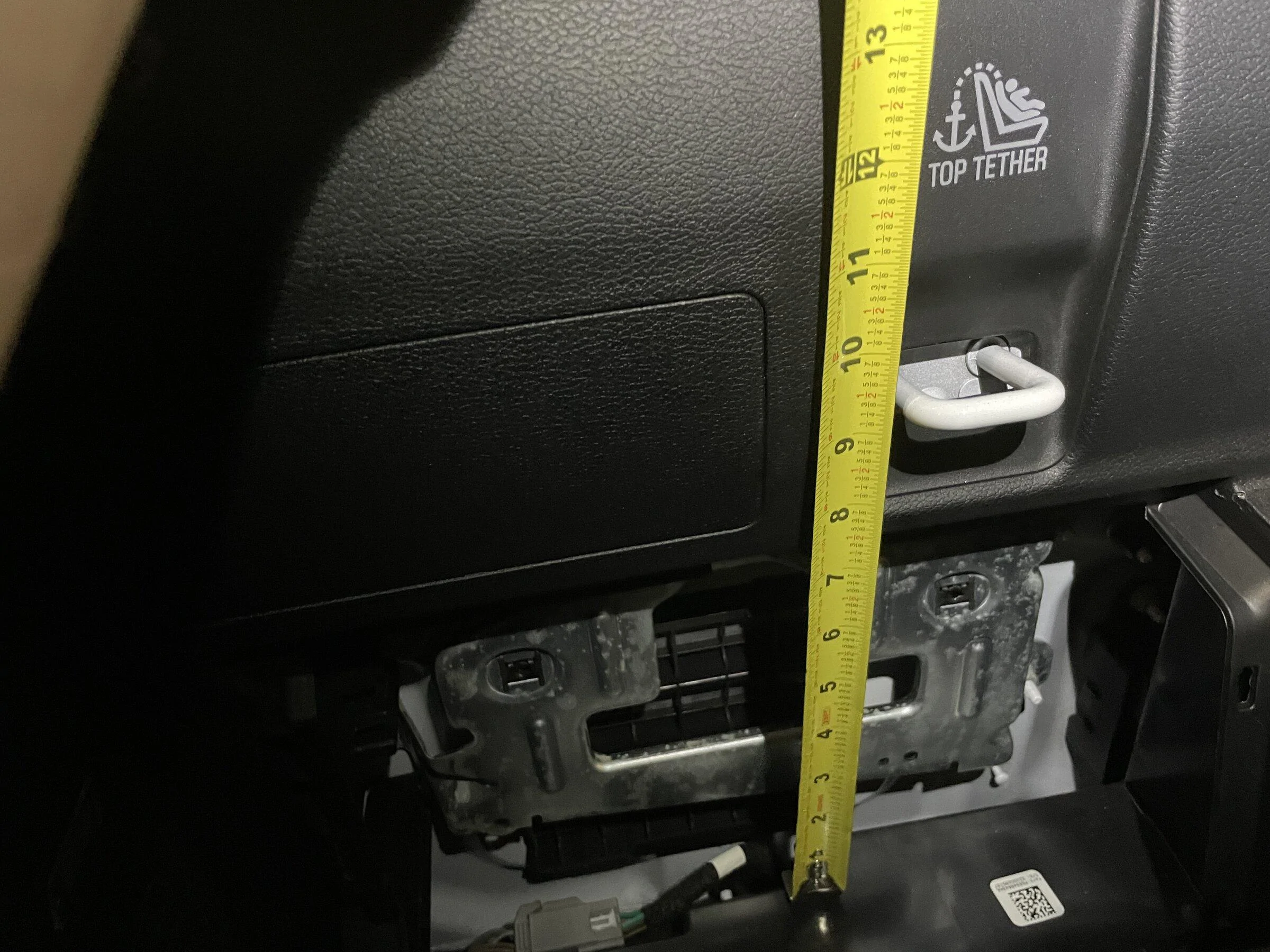

I am looking to build a single sub enclosure for the JL 12W3 on one side and an amp rack on the other side to hold two Xtants. I need my storage under the seats. Do you know the depth behind the seats?
If you remove the panel, it’s 3.5” right at the top below the baby seat yea there’s and the seat back. There’s 8” of so at the bottom. I can share actual dimensions tomorrow.

Yes, please do. I plan to start building a box in the next week or so and knowing what height, top depth and bottom depth worked for you and still allowed room between the sub and the seat back would be a big help. I also would love to see your finished product.
48" wide
12" tall
3.75" deep at the top
7.25" deep at the bottom.
I did have to basically make two truck boxes connected to one longer rectangle if that makes sense. There are three feet for the seats that I worked around so my box tucks under the seats.
I also recessed both subs so they are flush with the front panel and I have two panels on where the subs mount.

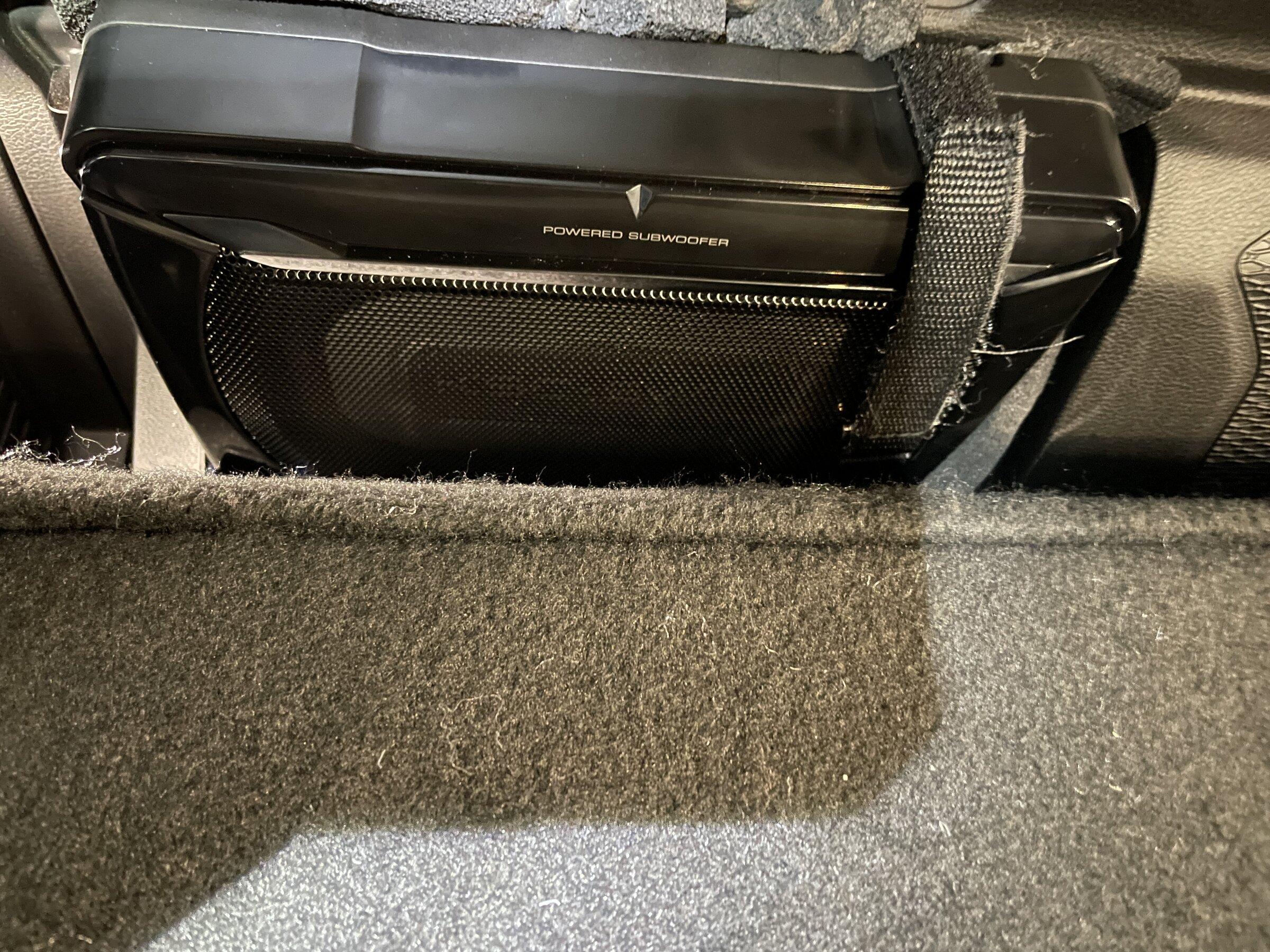

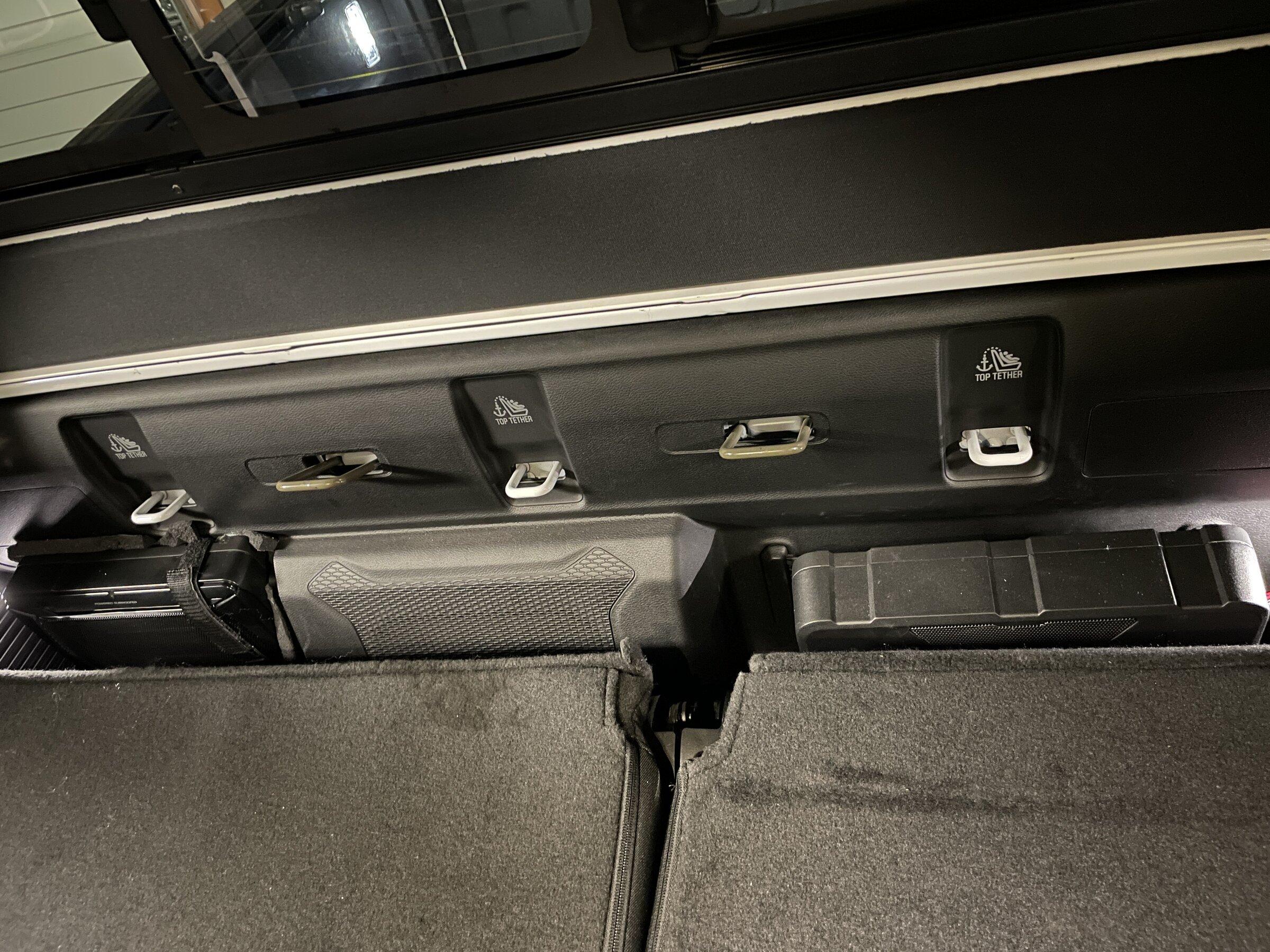

My current setup:
-MB Quarts MBQJ-STG6A (replaces 6 speakers, dash/knees and soundbar with the Pac Audio Ampro)
- OEM sub still running
- Kicker HS8 (behind the rear driver seat resting in the storage tray)

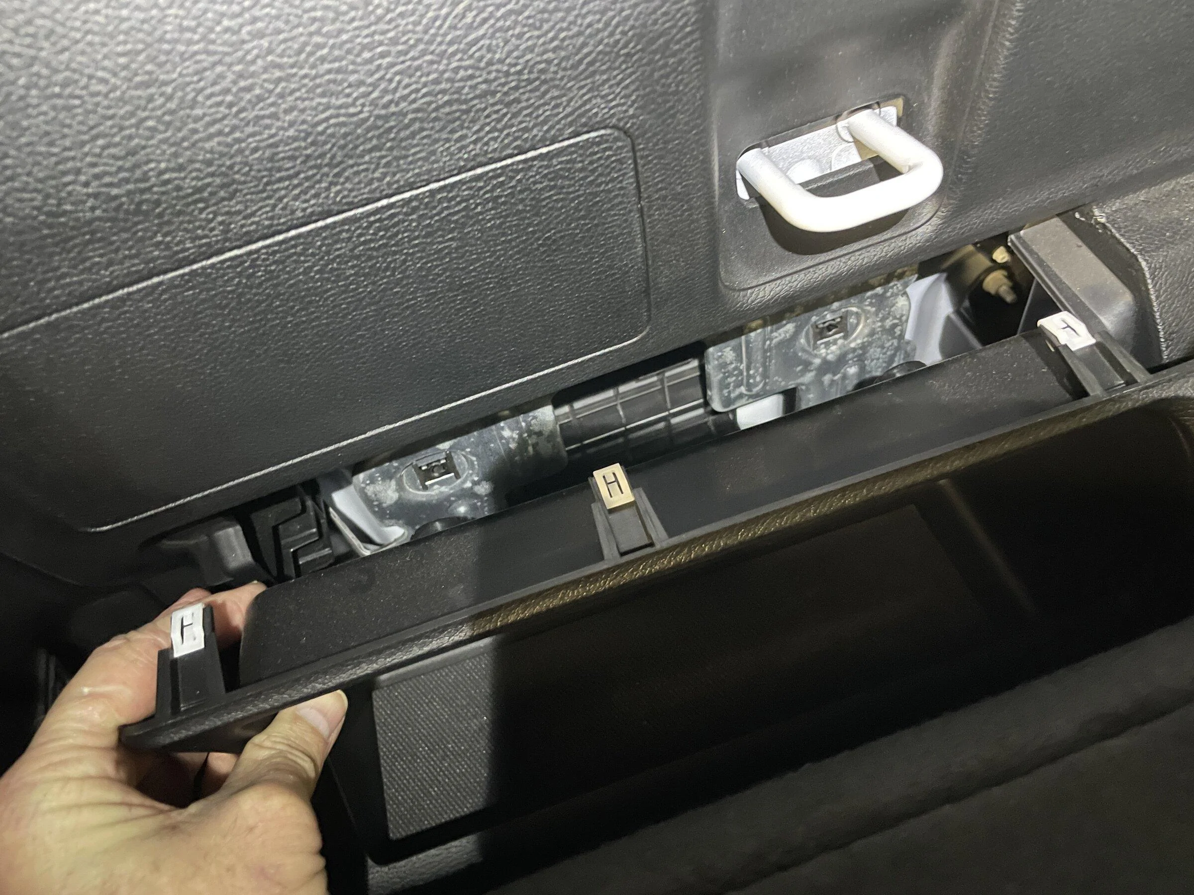

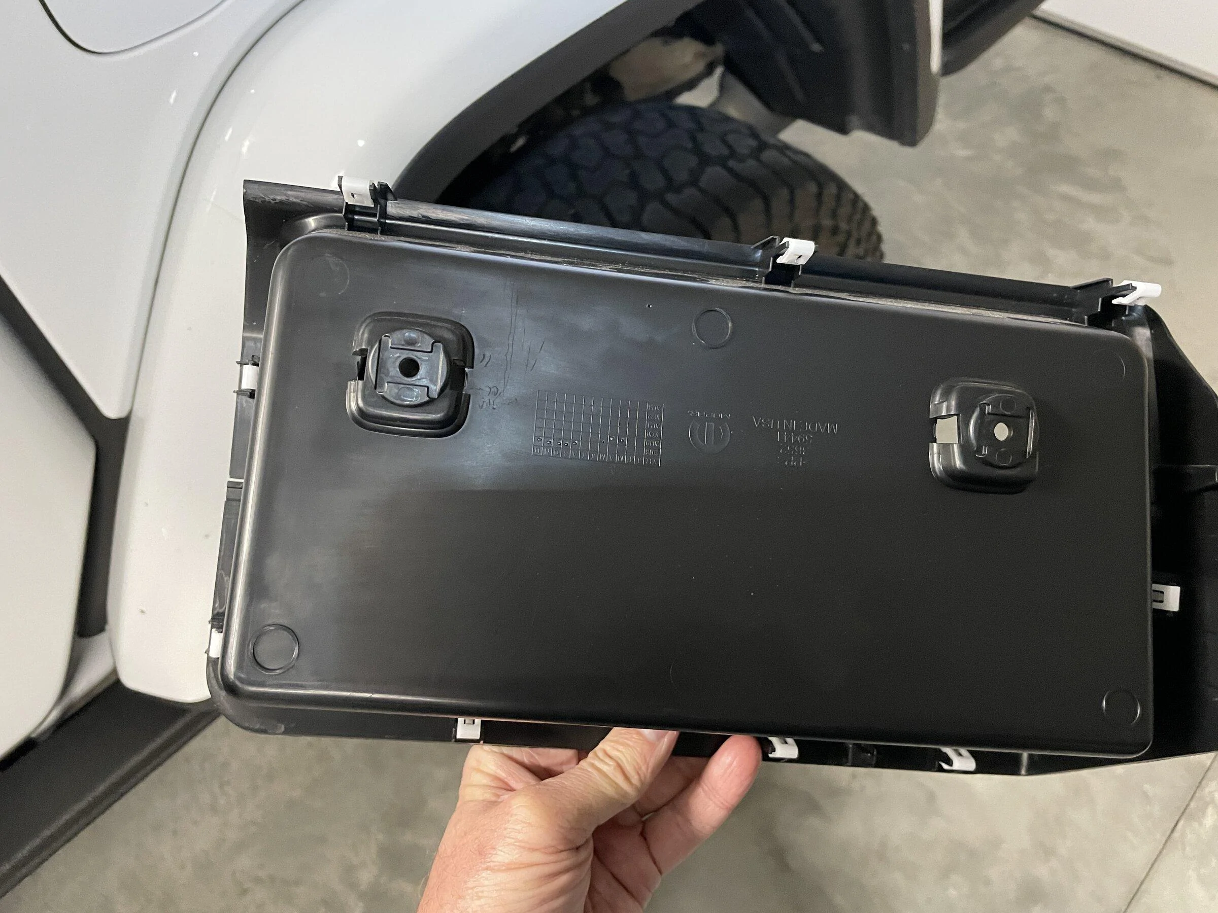

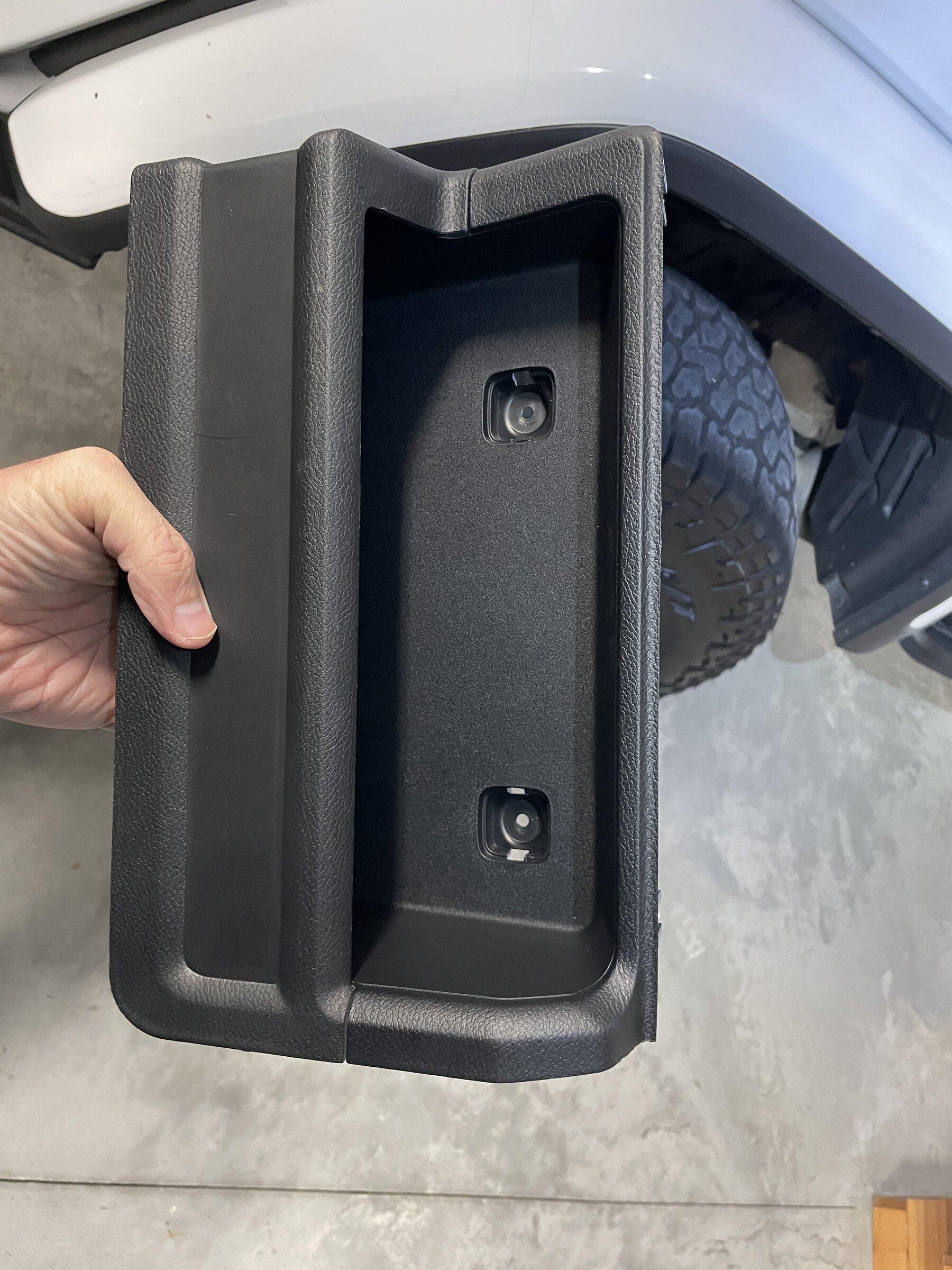

So after adding to MB Quarts kit and as great as it sounded, I felt the need for more base balance. I wanted to continue to retain my under the seat storage and the only option was to find something behind the passenger rear seat in that small storage tray (made for a Bluetooth speaker option). Well after a one week search nothing would fit subwoofer wise in the little tray and disappointment set it. Then I thought if just the storage tray was removed, it might fit.
Special thanks to forum member JSPEED for checking the back of his removed rear panel before I attempted the removal of the small tray behind the rear passenger seat. He said he thought it would work.
So sure enough, the little tray removes by removing to 2 screws, be very careful with the trim snaps to get to the screws. Then used a trim tool to pop out the small tray. This gave me a little more room, but the only subs I could find that would still fit was a Pioneer and Kenwood 8 inch amplified.
I went with the Kenwood based on reviews and size for fit.
https://www.amazon.com/dp/B00BO8O9XQ?ref=ppx_pop_mob_ap_share
Also needed some sub signal splitters from the Ampro to the Kicker/Kenwood subs.
https://www.amazon.com/dp/B005DL2OV...abc_89HSY2MAFPZZE8AE8SPZ?_encoding=UTF8&psc=1
Well, it worked out with much improved bass balance and everything fit nicely. If I didn’t have a rear underneath storage box and amps under the seat, I would have gotten something a little larger, but I kept my storage and still got great base now with 3 subs (OEM, Kicker & Kenwood).
Thought I would share if anyone else’s was wanting to try to fit something like amplified subs behind the rear seats.

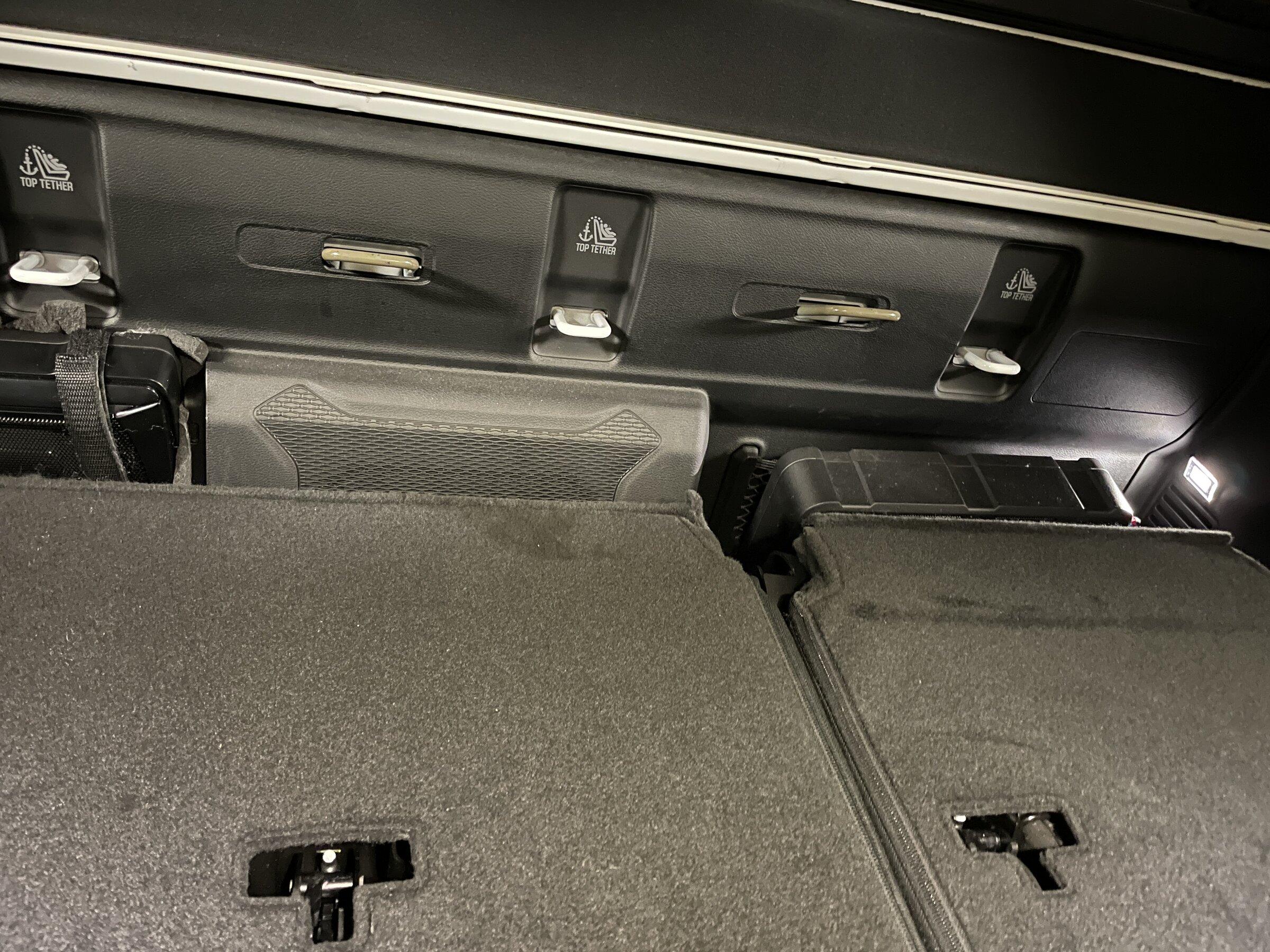

BTW i forgot to mention be very careful pulling off the rear interior panel. There are several hidden clips along the top just under the rear window and i broke all but one trying to remove it. I was pretty careful and even used my trim tools but they broke anyway however i didn't have a clue what held that panel in place so it was easier for me to break them lol. Now you know so be careful and take your time.
i added some pics. There are 4 bolts that need to come out and the rest is clips. The clips i was talking about under the rear window are the ones where i'm pointing and circled. The clips on the sides come off easy.
