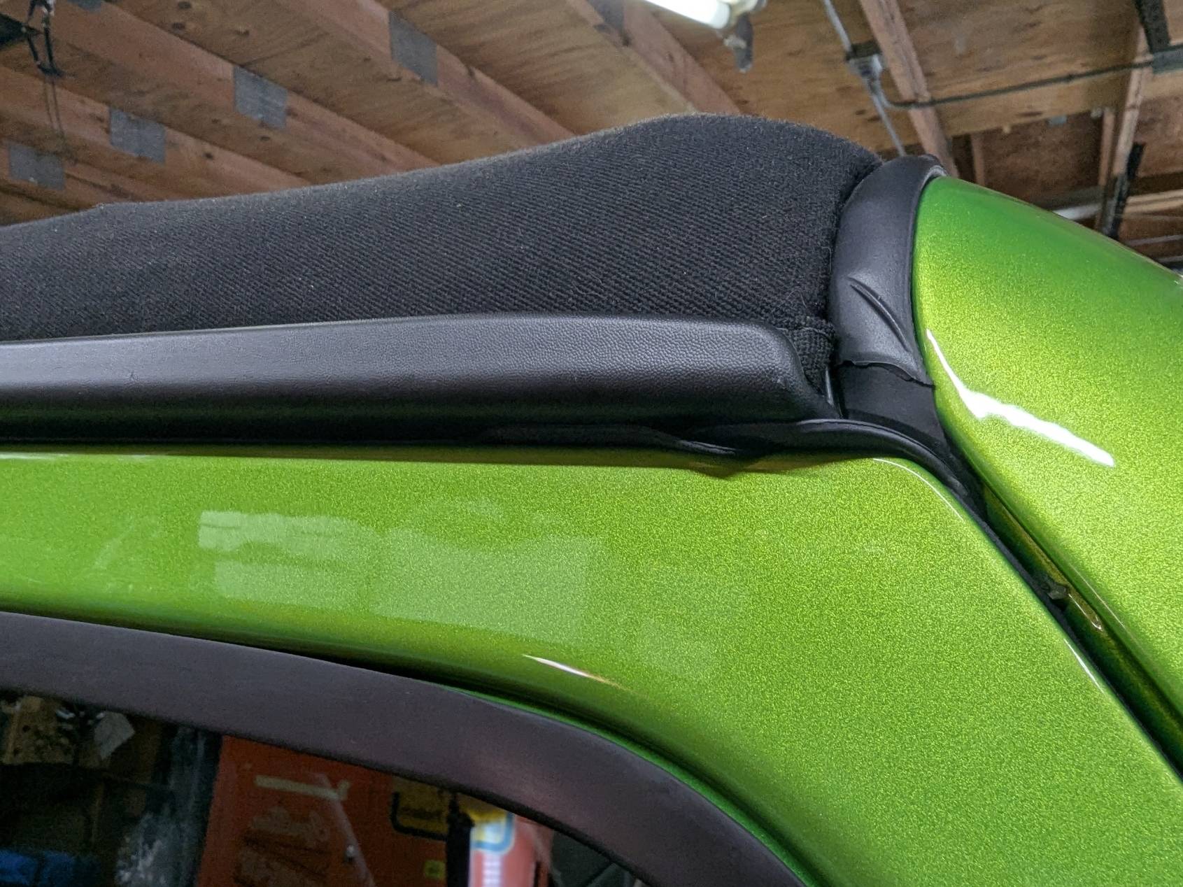

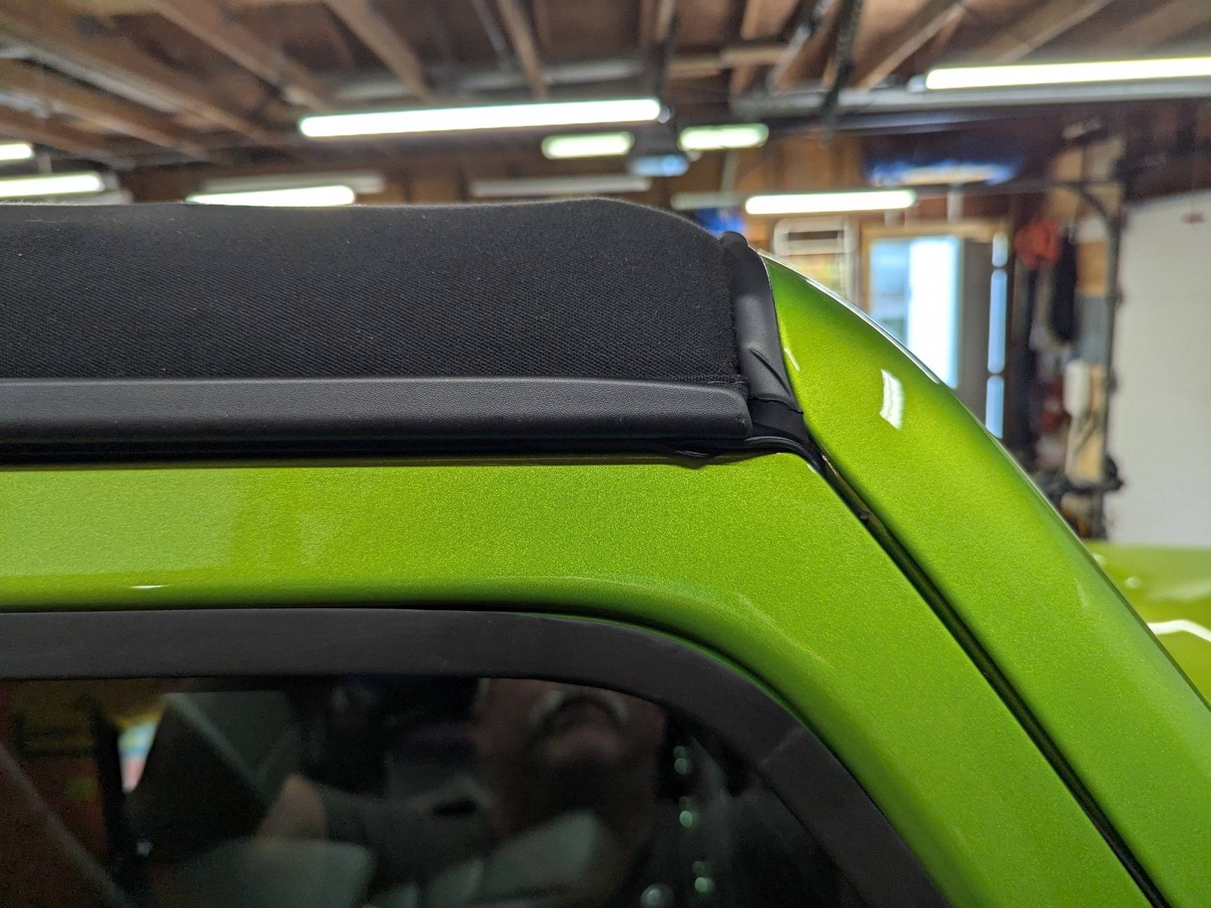

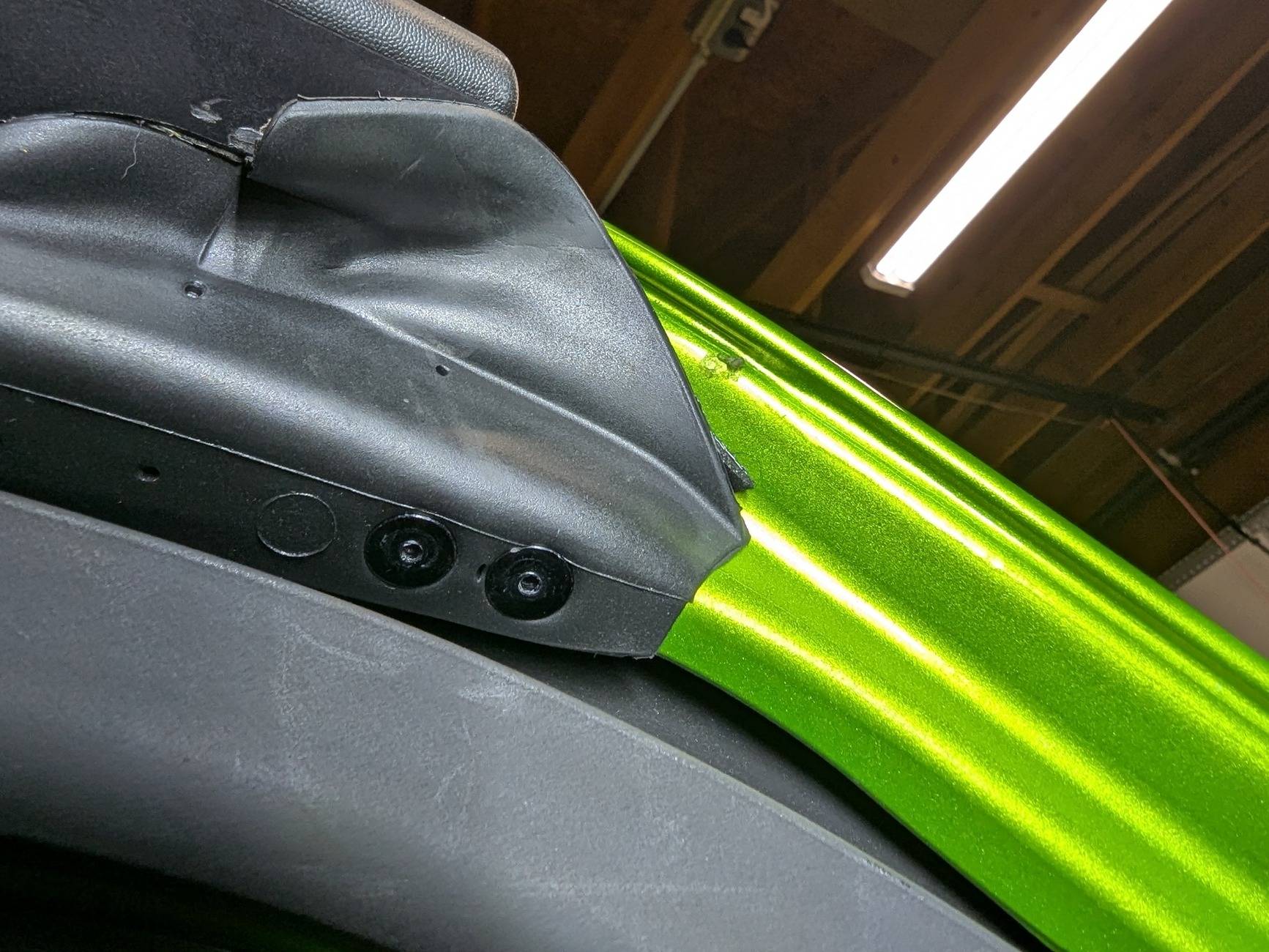

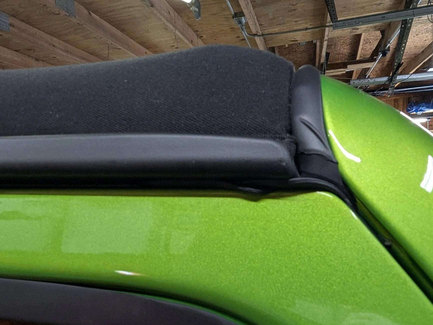

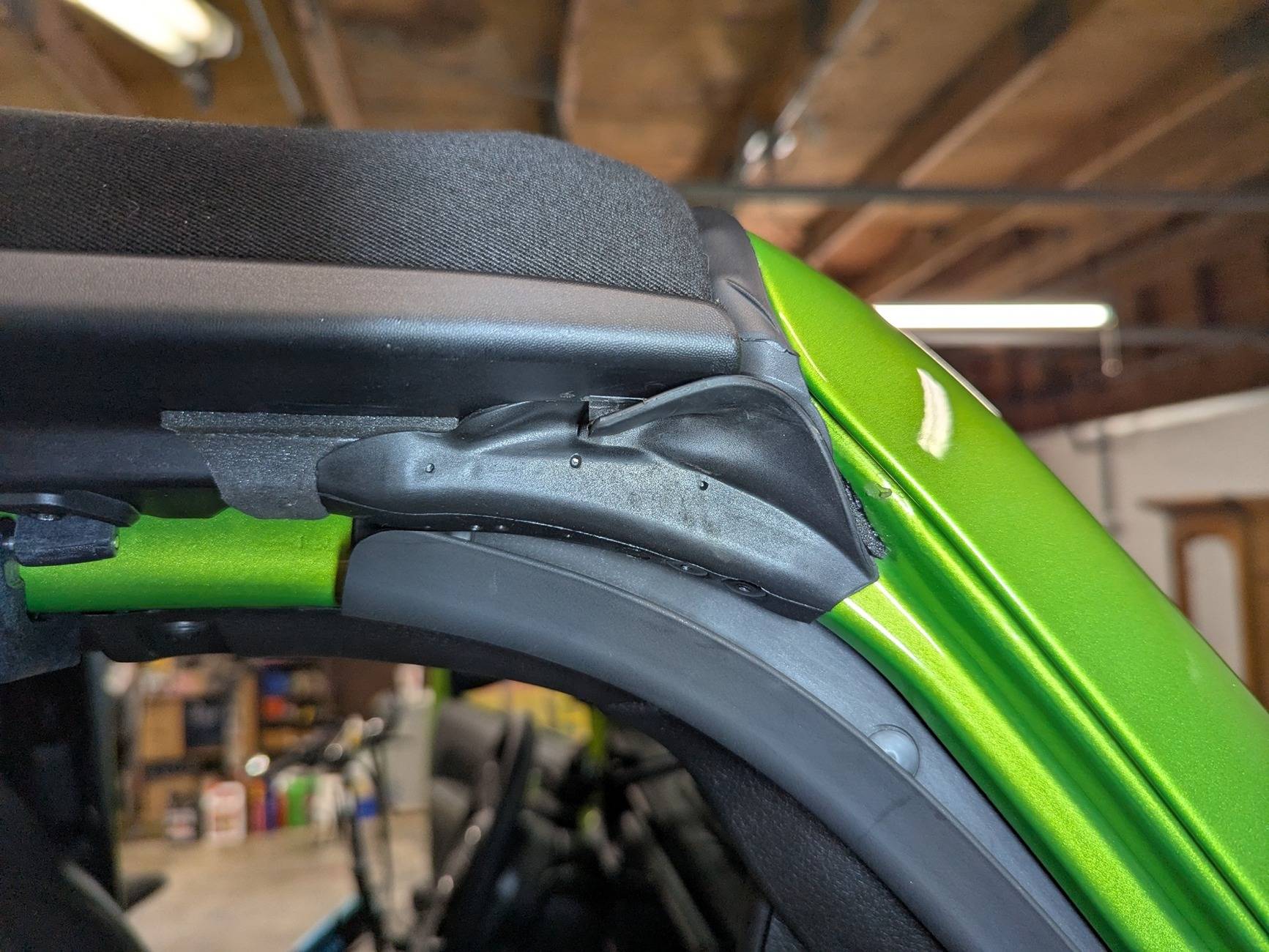

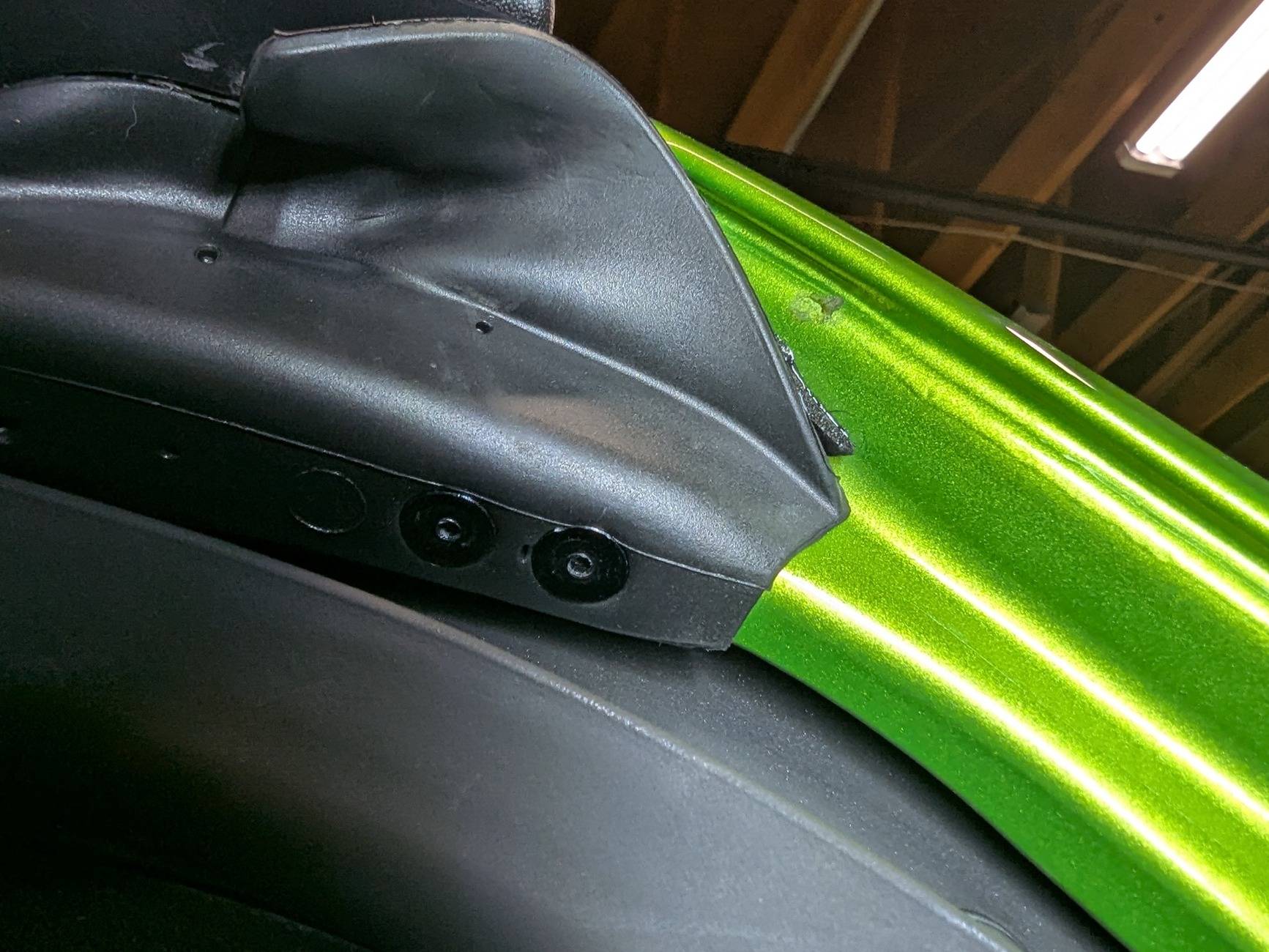

Another clamp, modified another 2mm, arrived today. Sweat band installed around my head, grabbed a cold bottle of water and went out and swapped that right side clamp.
Now I'm REALLY baffled!! I don't see any difference at all. Ugh, that's WEIRD! I should at least detect some difference - maybe the heat has made me blind?
For review - this is the left side with the modified clamp - acceptable (actually pretty good). Some seal deflection but the door works normally, seal isn't pinched or distorted, it will work as Jeep intended -
Jeep Gladiator Sunrider owners - MY mess-up, or theirs? left wth first replacement clam

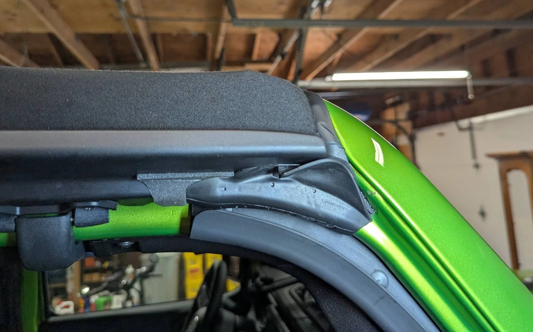

Now the right side with the first replacement clamp (same modification as on the left above - about 2mm height change) -
Jeep Gladiator Sunrider owners - MY mess-up, or theirs? riight with first replacement clam
Now the right with the 2nd replacement clamp - this one should raise the front of the right side of the top by 4mm, but I don't see any 2mm difference! The seals touch the sunrider side rail in the same way as before. What the heck? Not possible? How can that be?

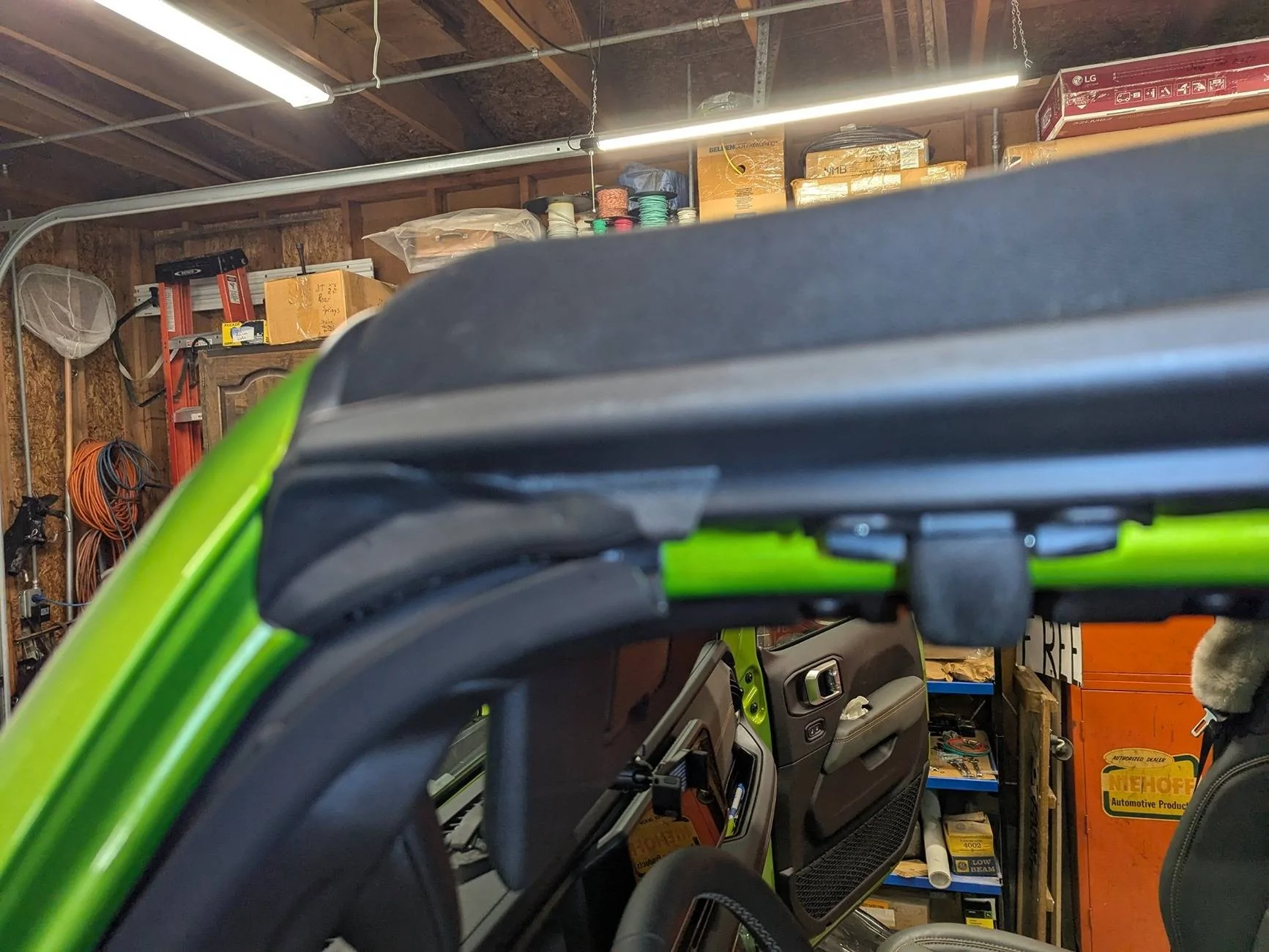

I used feeler gauges of sorts to measure the gap between the top of the door and the bottom of the sunrider rail - I detect no difference, but that can't be, can it? Should be 2mm more.

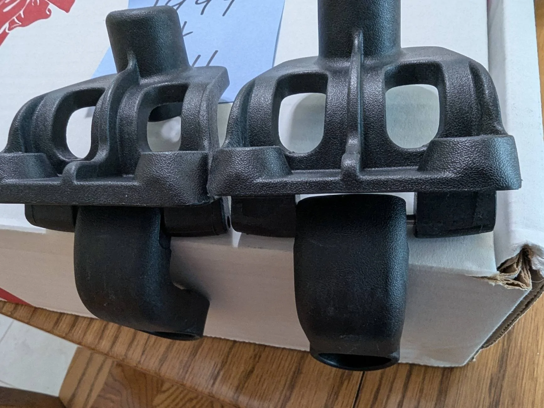

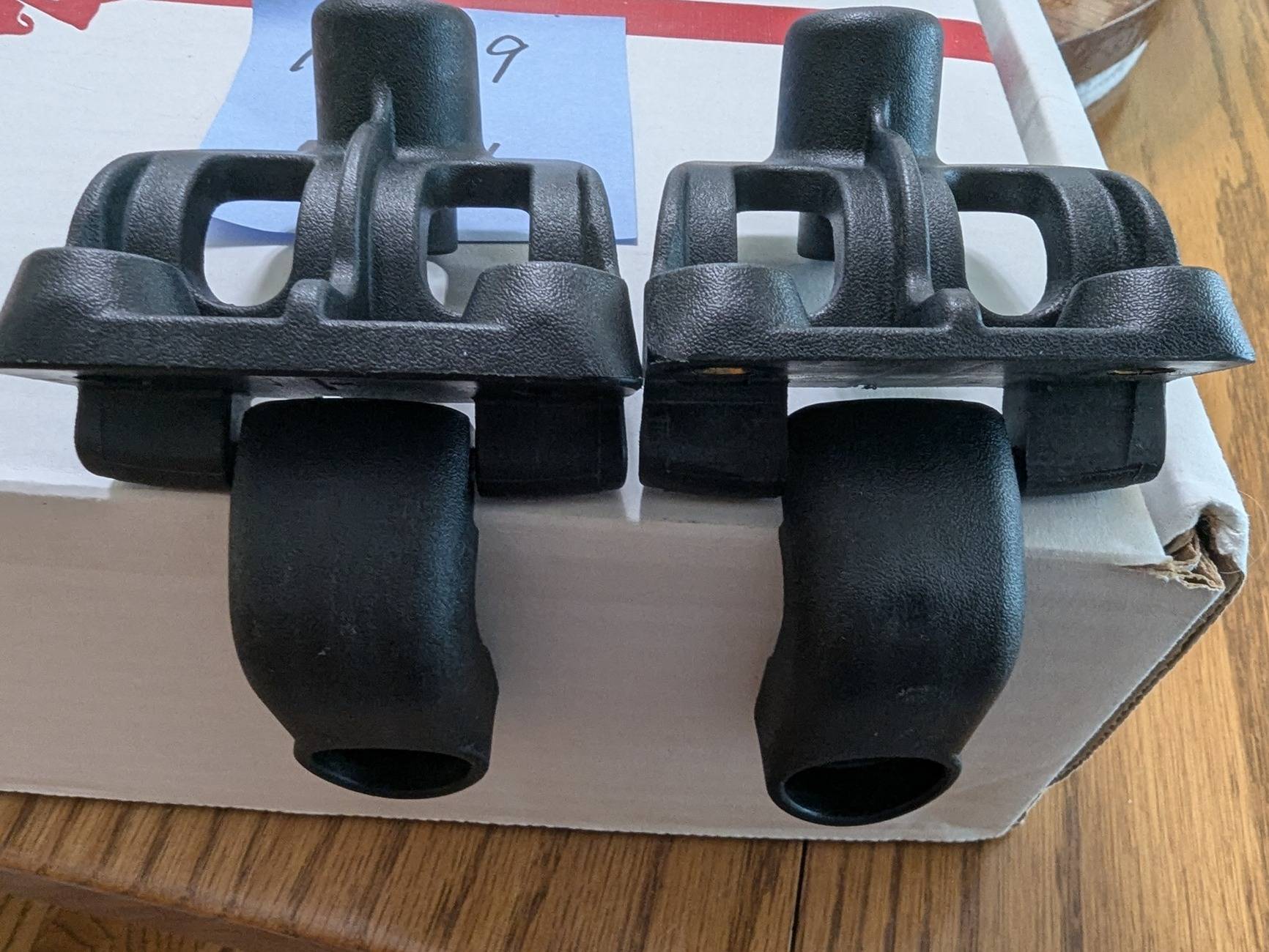

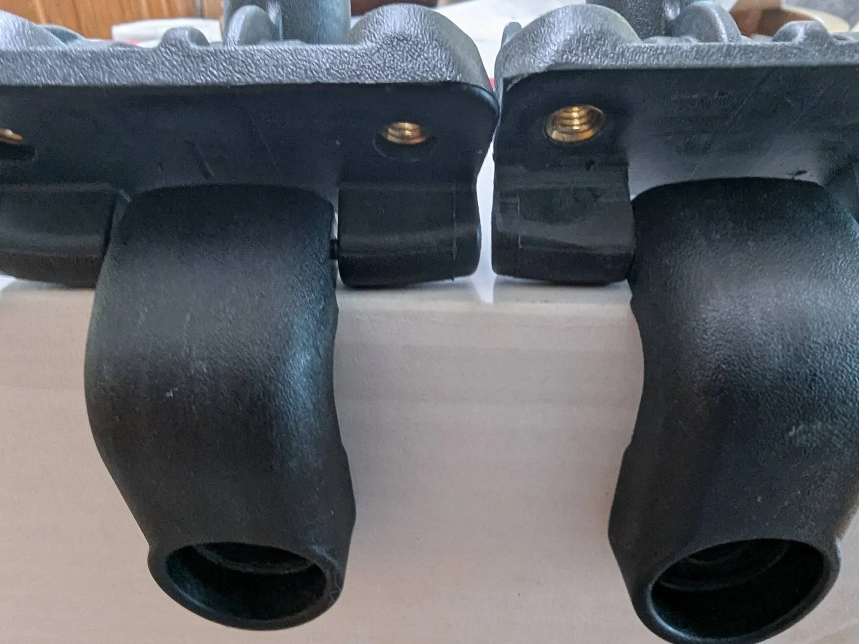

Do you have the original and the +2 inside the house from that side? I'd like to see where they changed them.
40,514
54,034
The one on the left here is the original that the sunrider came with.
The one on the right is reduced 2mm to pull the side rail UP since the rail attaches to the botto edge that you see facing you in the photo.
Left - original // right - modified 2mm to raise the rail​

Thats a pretty obvious difference, is the +4 you have different from that +2? Can you put a layer of fuzzy velcro on the +2 and gain another mm?
The one on the left is original.
The one on the right is the 2mm shave to pull the rail upward.
They actually reduce, not add to. Any spacers would pull the sunrider rail down because the rail screws to the underside of the clamp.
