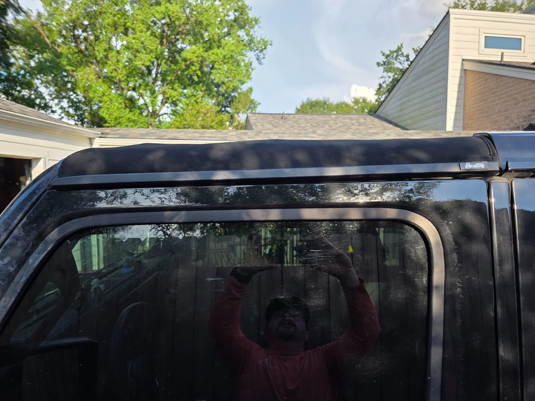

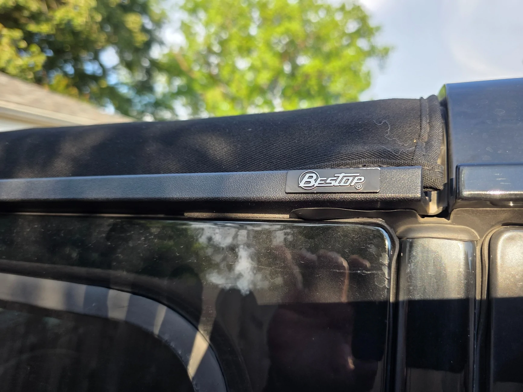

Bestop sent me some new latches that pull the front down more. The original had almost no resistance. You can tell they pull it down a little more, but not a lot. Like you said.... pull it too much then it will pull the front sides down. I still get the air noise from the front. I was thinking I might try some 1/8 flat rubber weather stripping under the front edge. Here are some pics of how the sides of mine sit. I tucked the muckets so you can see the spacing. I know it is hard to tell on black, but it is about 1/16 lower in the front.
Jeep Gladiator Sunrider owners - MY mess-up, or theirs? 20250810_182720
Jeep Gladiator Sunrider owners - MY mess-up, or theirs? 20250810_182726
Jeep Gladiator Sunrider owners - MY mess-up, or theirs? 20250810_182706

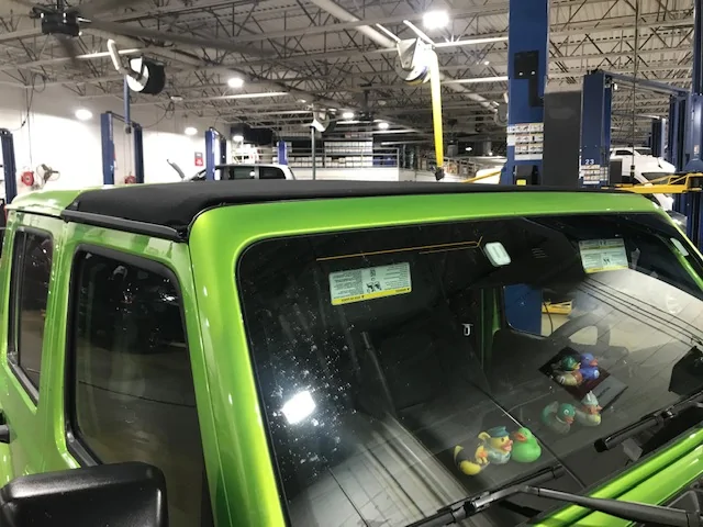

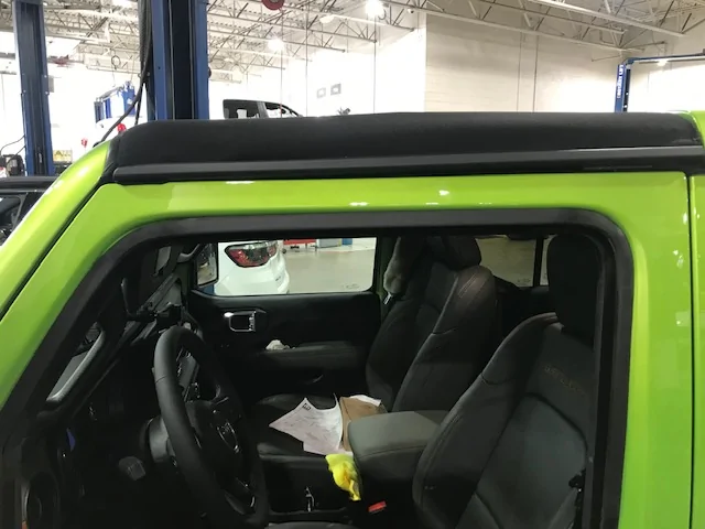

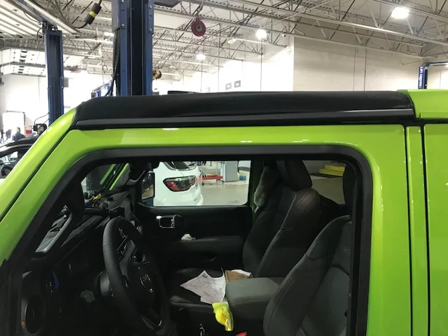

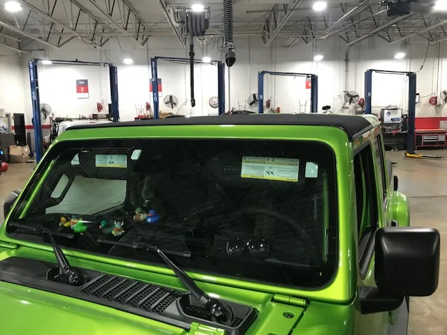

Yikes! Service advisor just sent out pictures of the NOS (new old stock) sunrider they found and the fit is far WORSE. In fact, the right front edge sticks up while the side rail gap above the door disappears going forward and the left side looks like the rear end of the rail is sticking way above the roof rail. The right side also doesn't seem to fit well at the rear. It's worse than the one my JT came with.

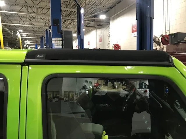

Here's what I discovered -
When Jeep said "the old part number" - the meant the old part number with the Jeep label on it.
So it was a Jeep labeled sunrider, and it comes pre-assembled and it fit horribly. Almost worse than my original.
I asked what's next.........
Service advisor says STAR is done, they say "it's an accessory problem" and it has to go through the accessory people.
Well - hold on here - Jeep literally INSTALLS the tonneau cover at the factory, isn't that an accessory?

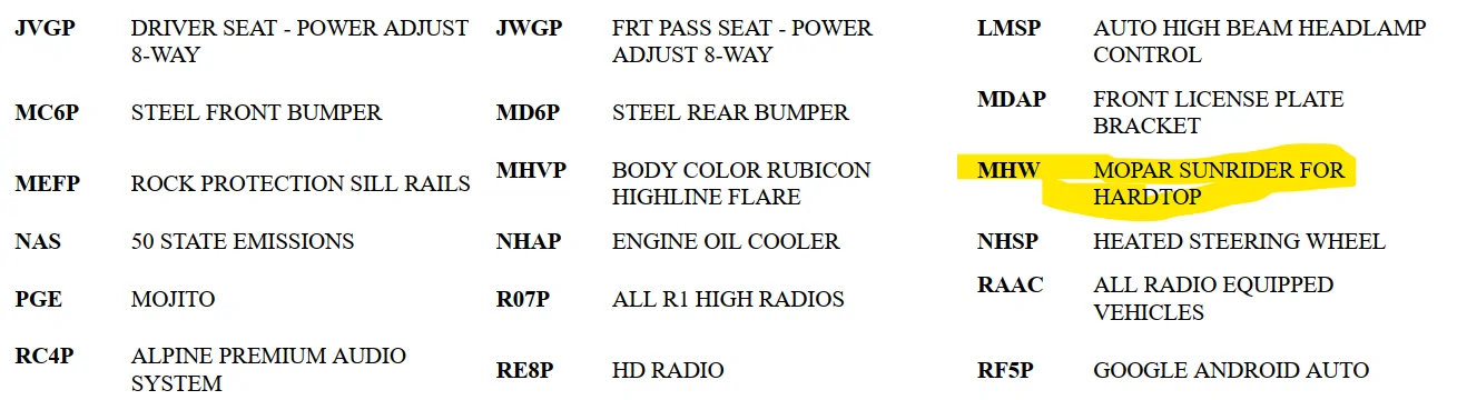

To get the sunrider, you have to buy the rail package OR the tonneau cover. And it's sold with the next vehicle as part of the price on the window sticker and it's on the build sheet.
What if these came installed at the factory? What would they do with a fit like this? They need to consider that thought.
Jeep Gladiator Sunrider owners - MY mess-up, or theirs? 1755203473686-i9
It has a sales code and comes with the Jeep.
So - Jeep is still ultimately responsible.

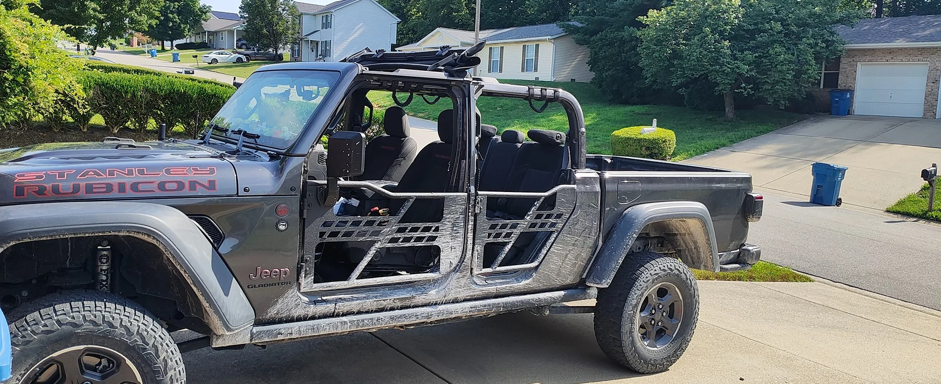

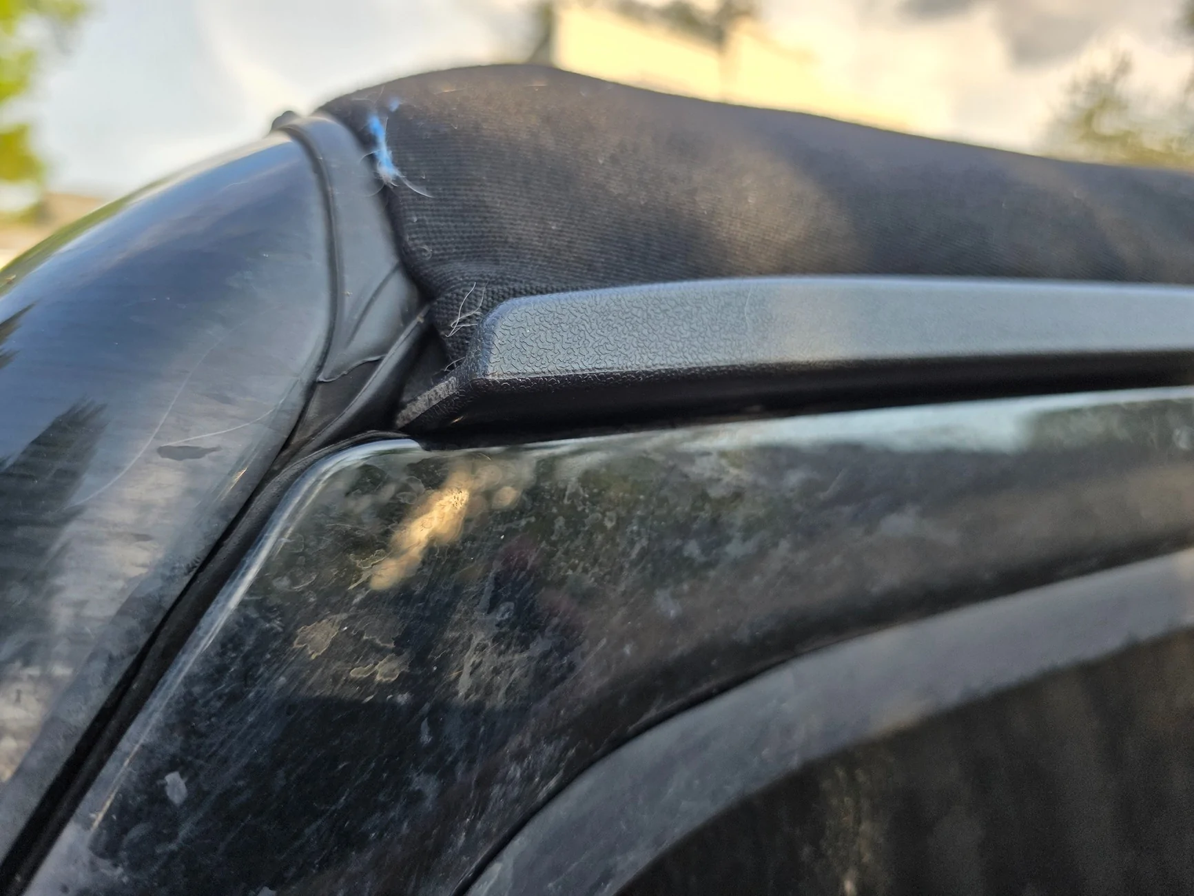

My '20 Sunrider fits perfectly on my Overland (ordered 5/19, delivered 7/19). No leaks even going through a car wash. Installation is very easy. Must be some slight changes in model years of the JT vs. Besttop products.
As far as getting one's hair all tussled and tangled from the wind, I have found that driving with the top open, all four windows PLUS the rear slider open, really helps in that vein. One gets more of a 'flow through' vs. a whirlwind inside with the rear slider open.
4 windows down is decent, 4 + back slider kills the buffeting or the thunder pounding in your ears, just like you said, flow through. I put my sunrider on my '22 gladiator, just needed a little wiggling the first time. Had it on and off several times, no leaks. Currently have it on, without the back shell and no doors without problems. It could use a shim of some kind on the back bracket, it does have a bit of a gap where the back shell fills the space on the roll bar. Now that I've done it a couple times, I can get it swapped out solo in 10 minutes.
Jeep Gladiator Sunrider owners - MY mess-up, or theirs? IMG_20250722_094418778
