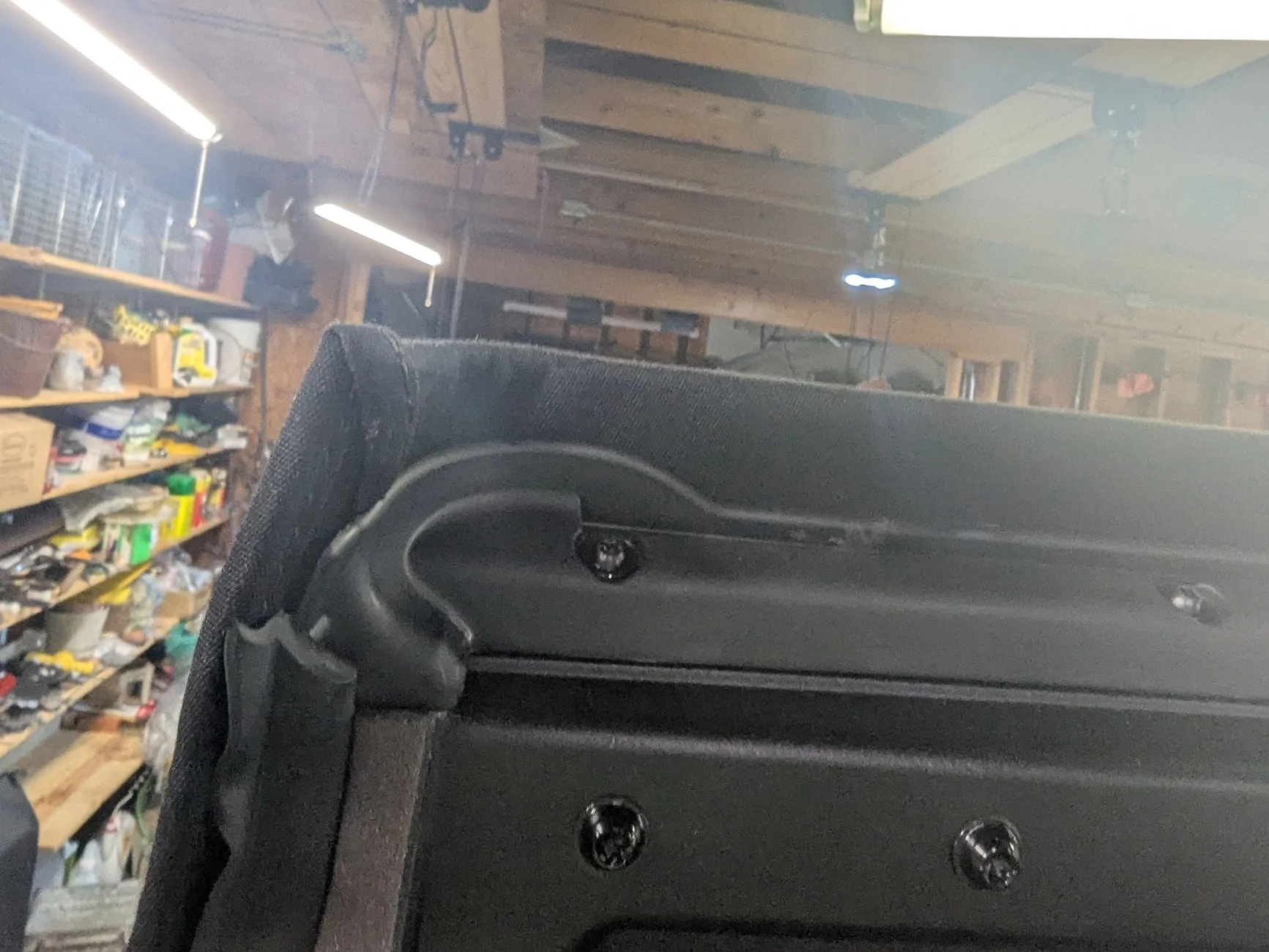

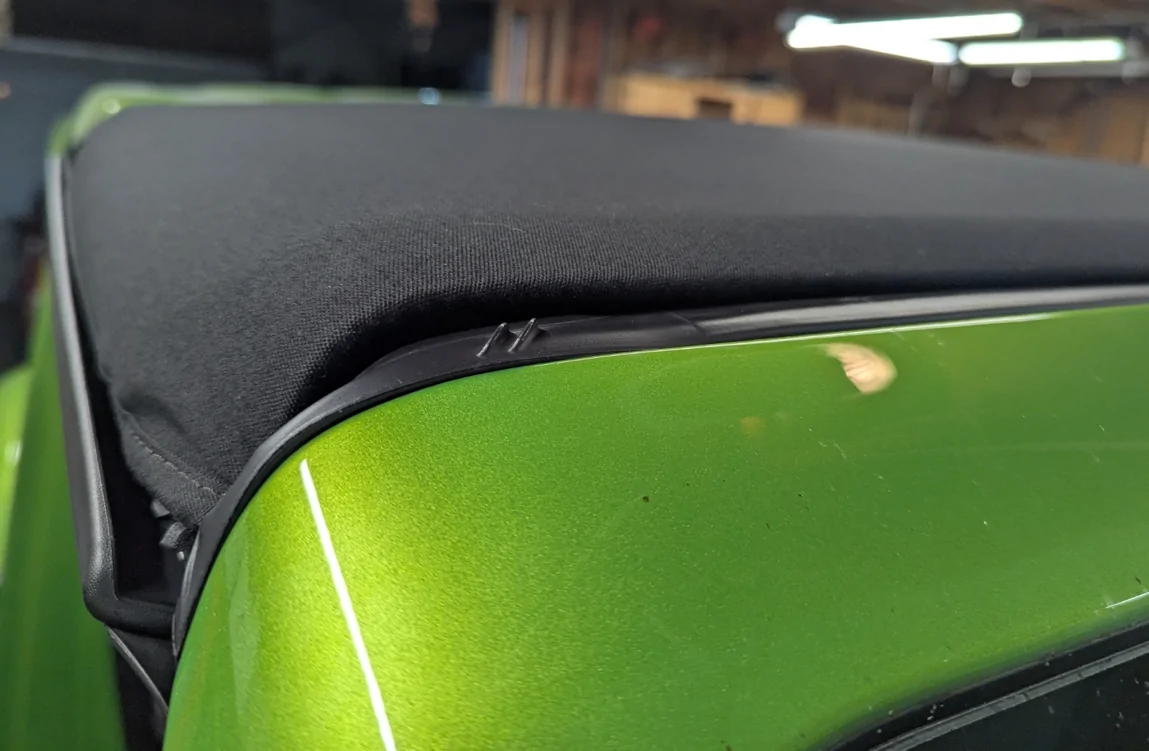

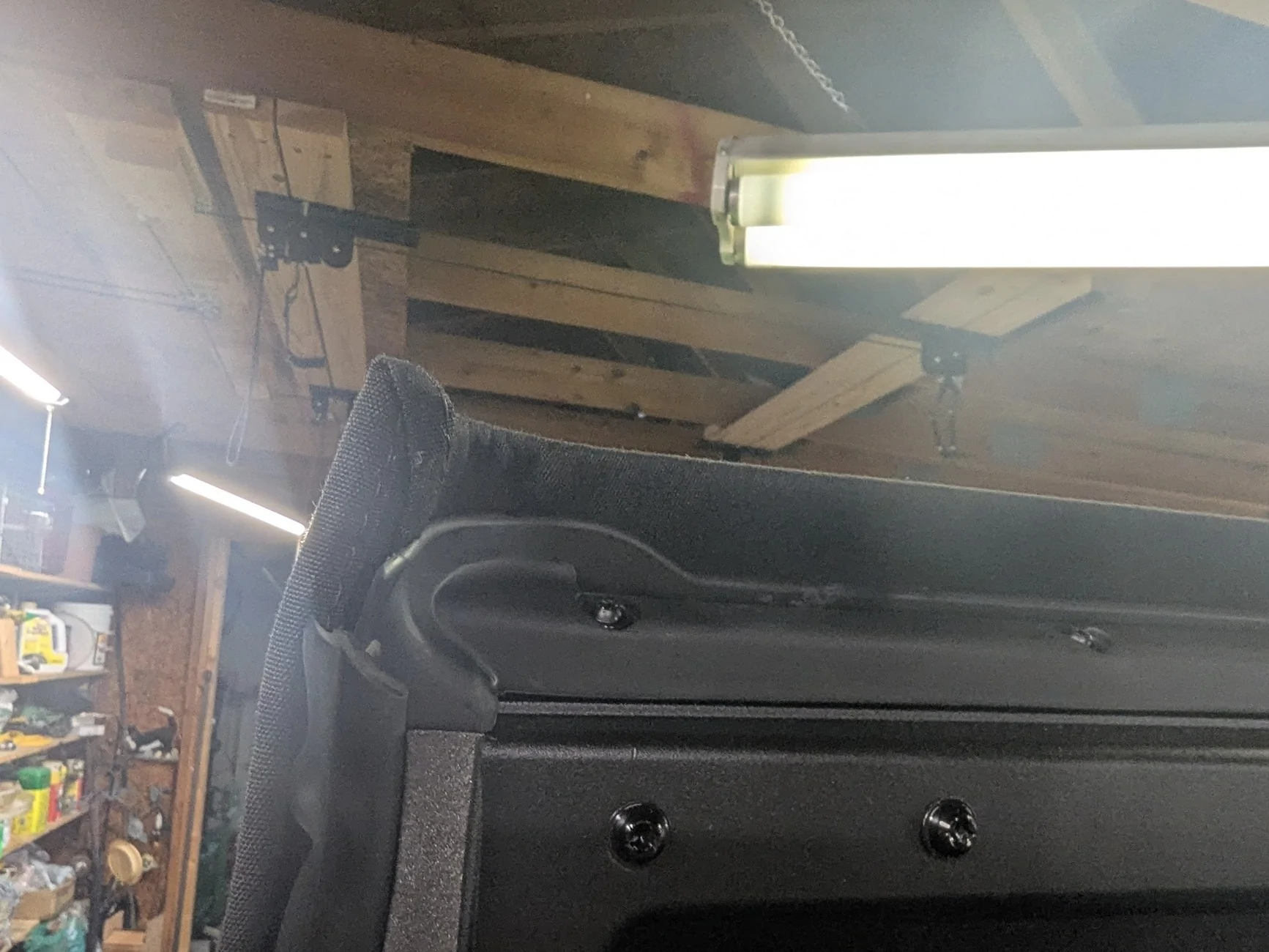

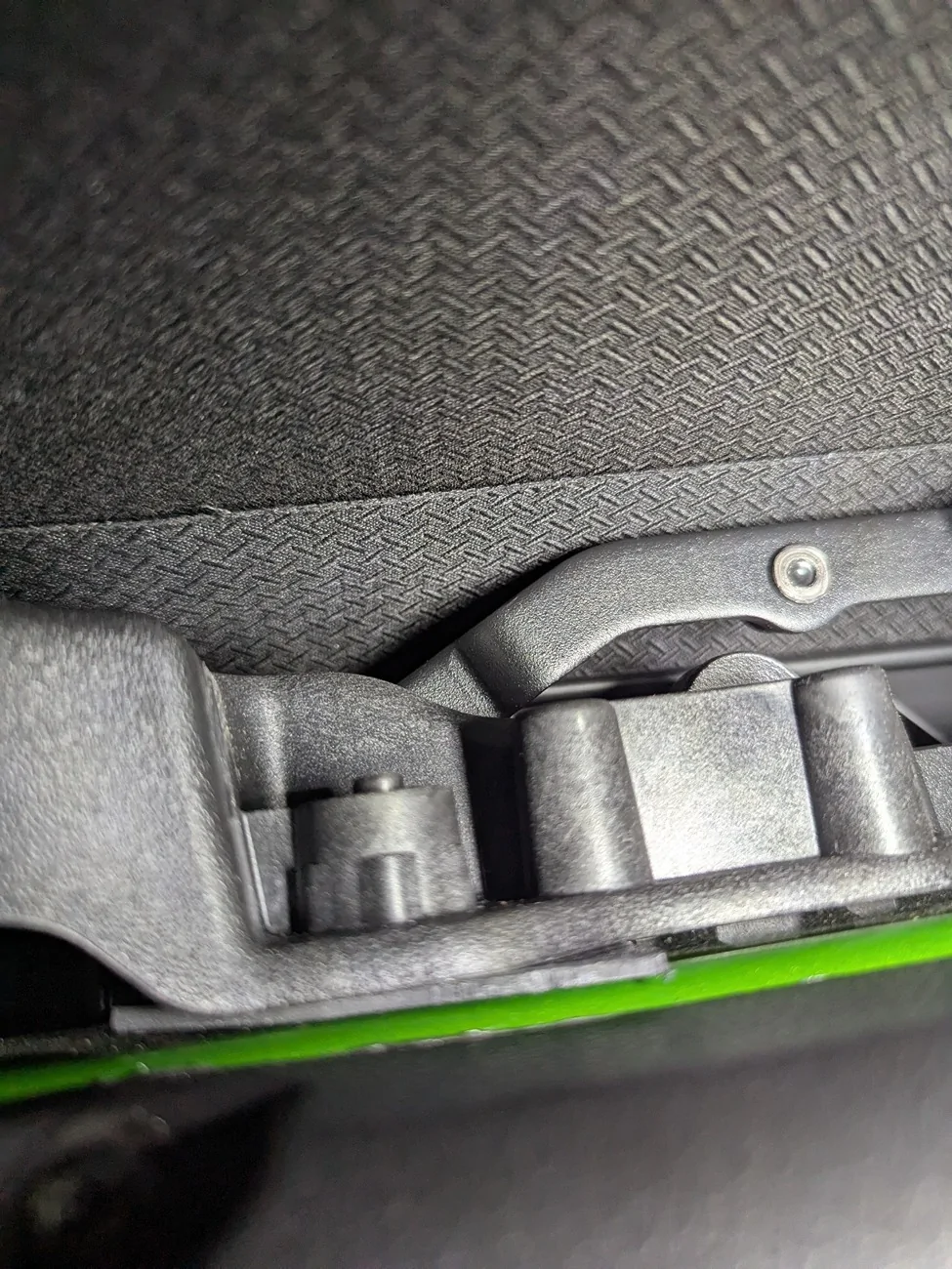

I had thought that, but then - why does one fit not too bad on the left and could actually be solved on the lift side with a slightly modified clamp, and it sits way too deep on the right -I definitely think he has an issue with his JT, not the assembly with the THREE different Sunrider tops that have been tried on his Jeep.
I wonder if these THREE different tops have been tried on other JTs. or JLs. There's something else going on with the assembly of his Jeep.
and the third top sits waaaay too deep on the left, but sits too high on the right?
So my original - too low on right, about right on the left
This 3rd unit - too low on the left, way too high on the right.
If it was the Jeep, would not all of them sit too low on the right but not so bad on the left?
And this one sits way high in the left rear.
My other sat so deep on the windshield seal it crushed it.
This one doesn't even touch the windshield seal on the right.
I'd expect the all to be about right on the left, way too deep on the right if it was the truck.
If it was a door issue - and one fit too tight, one fit too loose, is it the vehicle - or the doors?
