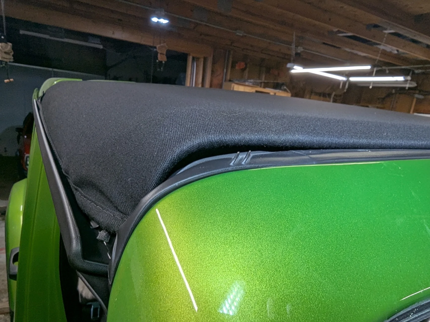

@Bestop - it's WORSE than the dealership let on!! And worse yet, they left this really nasty one on my truck instead of putting the original back on with your test parts.
@JeepCares - you'd better be letting the dealership know this is ON THEM and you should contact them to make this right and make sure they still have my original. No delays crap. If they no longer have my top - GET IT.

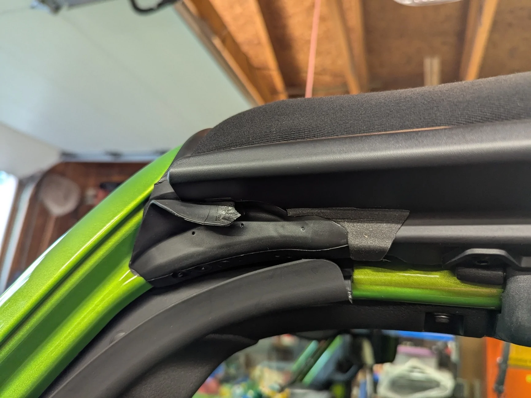

There's more to this story.. I don't know why I didn't catch this instantly, but instead of putting mine back on - they let the third one - the worst of them all on my truck.
So I'll be going back to the dealership on Monday insisting they put my original back on it, and if they don't have it - they WILL find and put it back on.

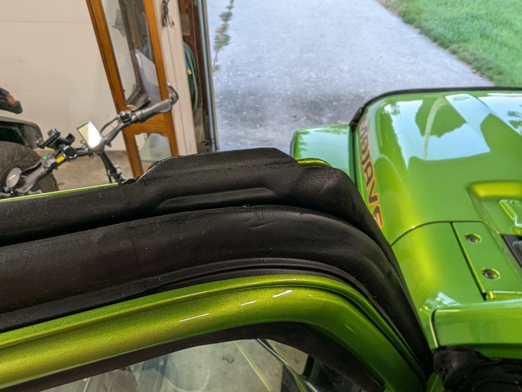

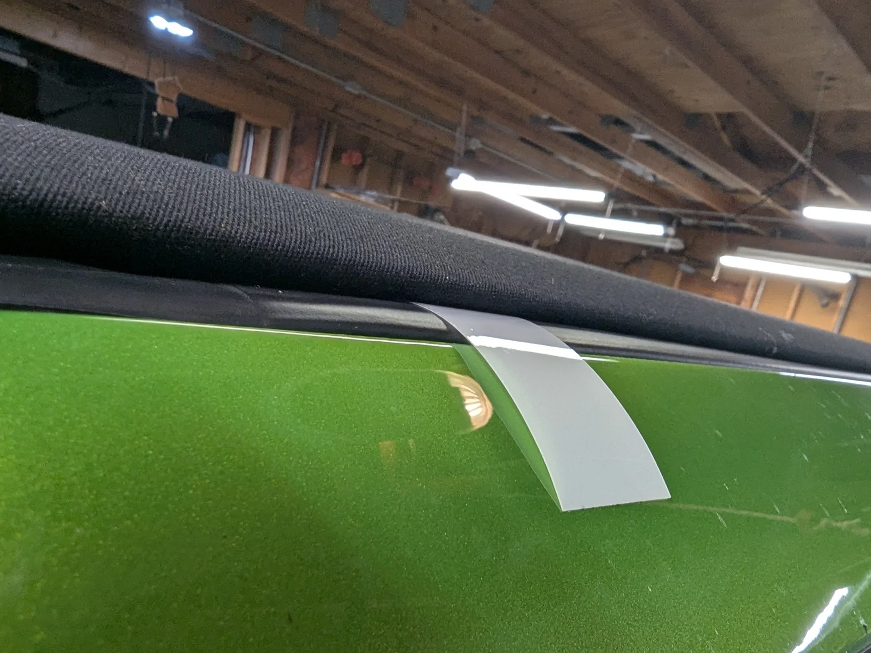

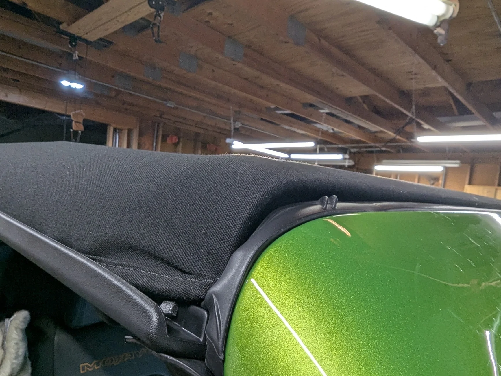

For one thing - this one LEAKS LIKE A SEEVE and has horrible wind noise. You can easily slip folded paper through the right front area between the top and the windshield. In fact it doesn't even rest on the windshield seal AT ALL on the front front corner.
And now the left side rides on the top of the left door - cutting the left door seal.
They kept my top and kept the test/experimental mounting pads that Bestop sent to me as well! They kept the mounts, shims and bolts.
Now I'm not only having to battle Jeep, but Bestop and the dealership!

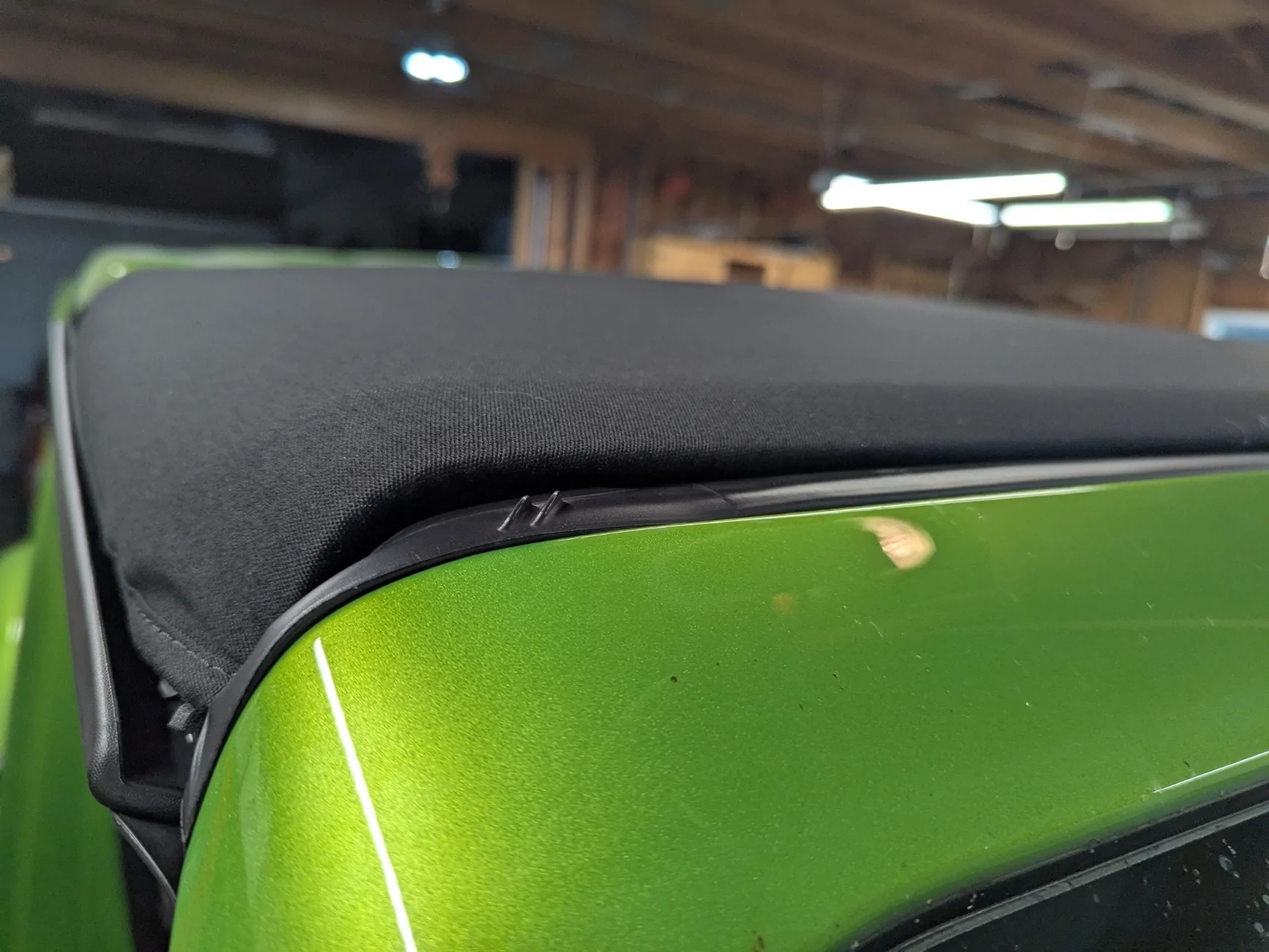

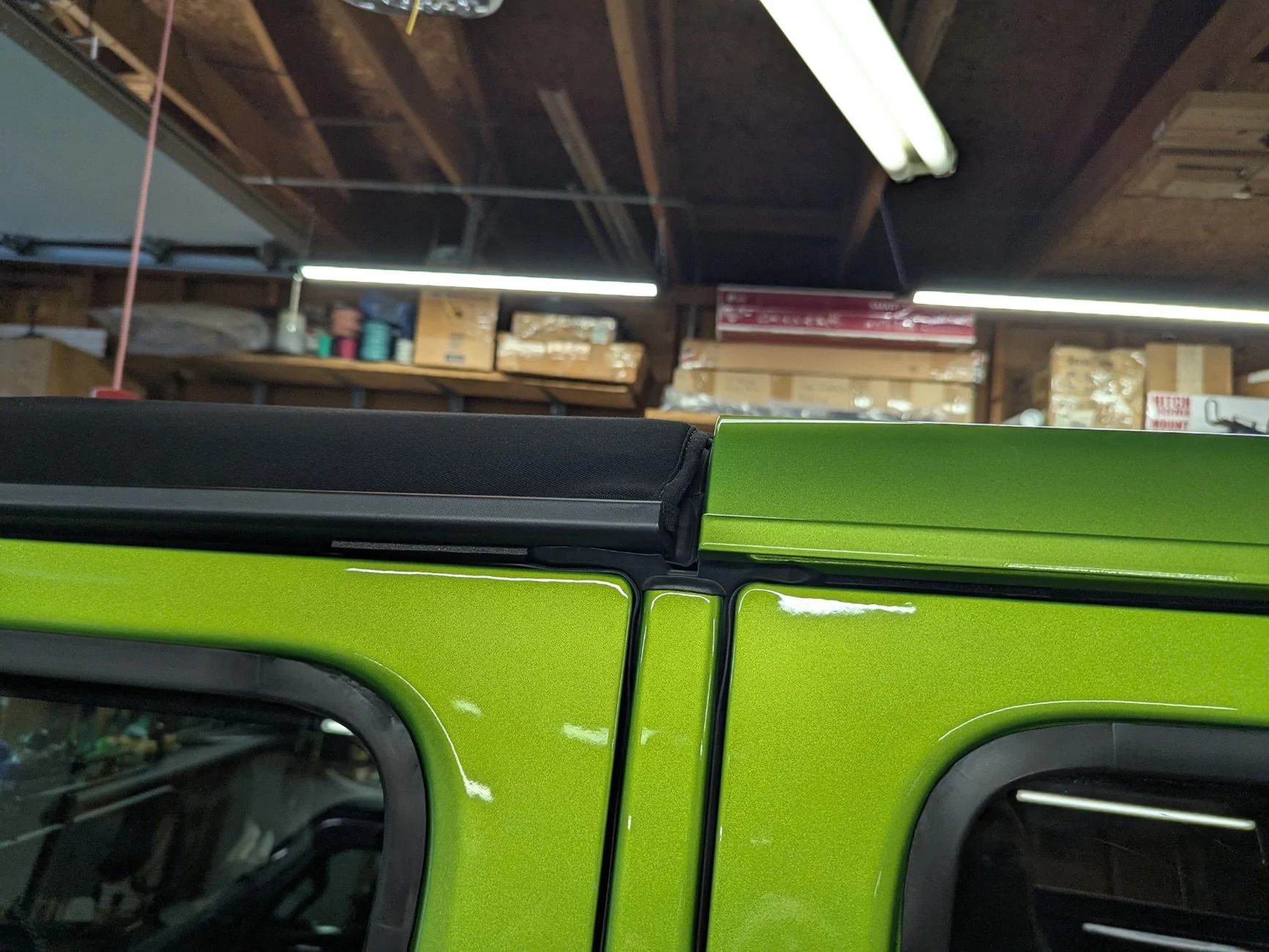

Jeep Gladiator Sunrider owners - MY mess-up, or theirs? PXL_20250817_004522701
Left side rides the door, cutting the seal more than it was already.

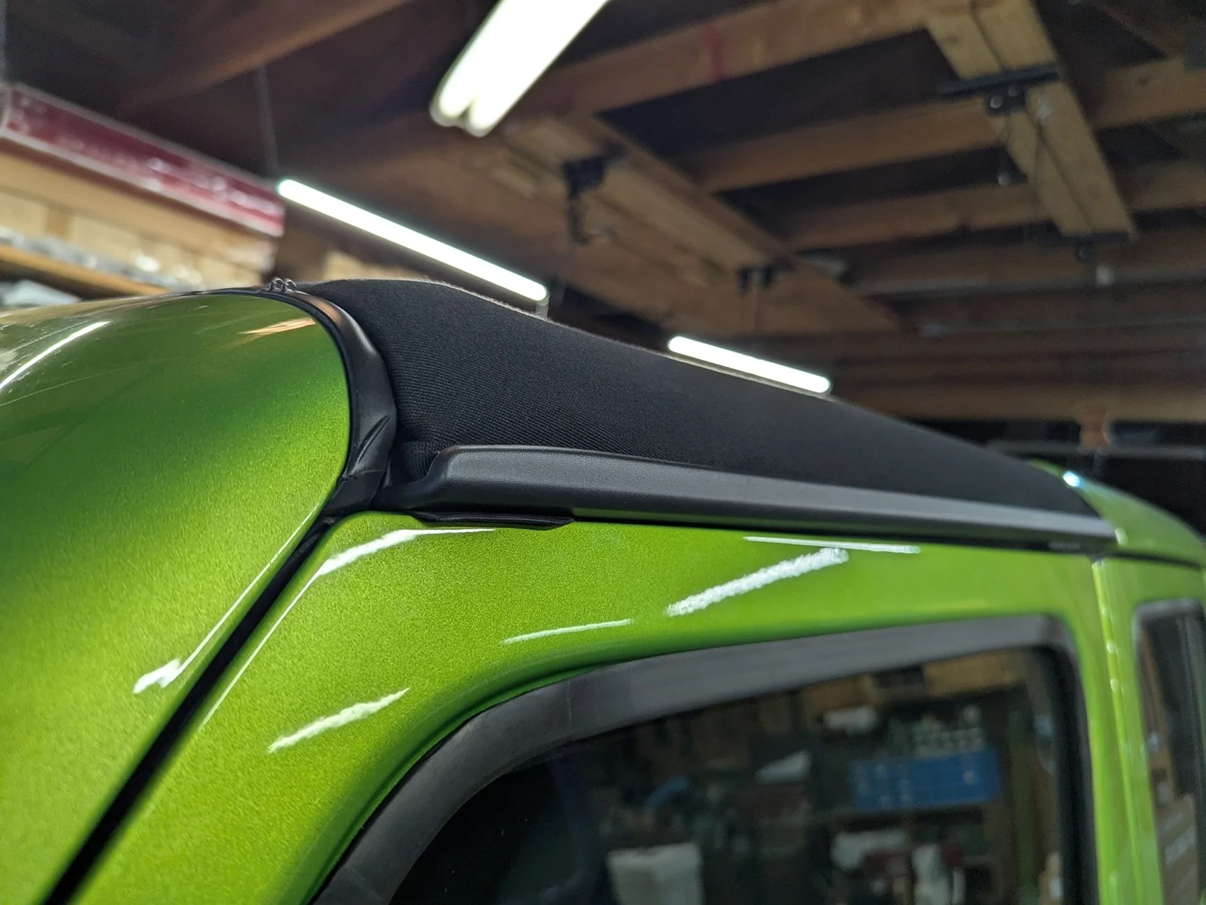

Jeep Gladiator Sunrider owners - MY mess-up, or theirs? PXL_20250817_005158923
I had the left side of the other one sitting pretty good, really - with the Bestop experimental/test mounting pieces - but not any more with this one -
Jeep Gladiator Sunrider owners - MY mess-up, or theirs? PXL_20250817_004541682
Rail rides a little low as seen here below - and yet there's literally a GAP between the sunrider and the windshield seal - a gap you can slide things through, paper, coins, whatever, and IT LEAKS WATER! (rain)

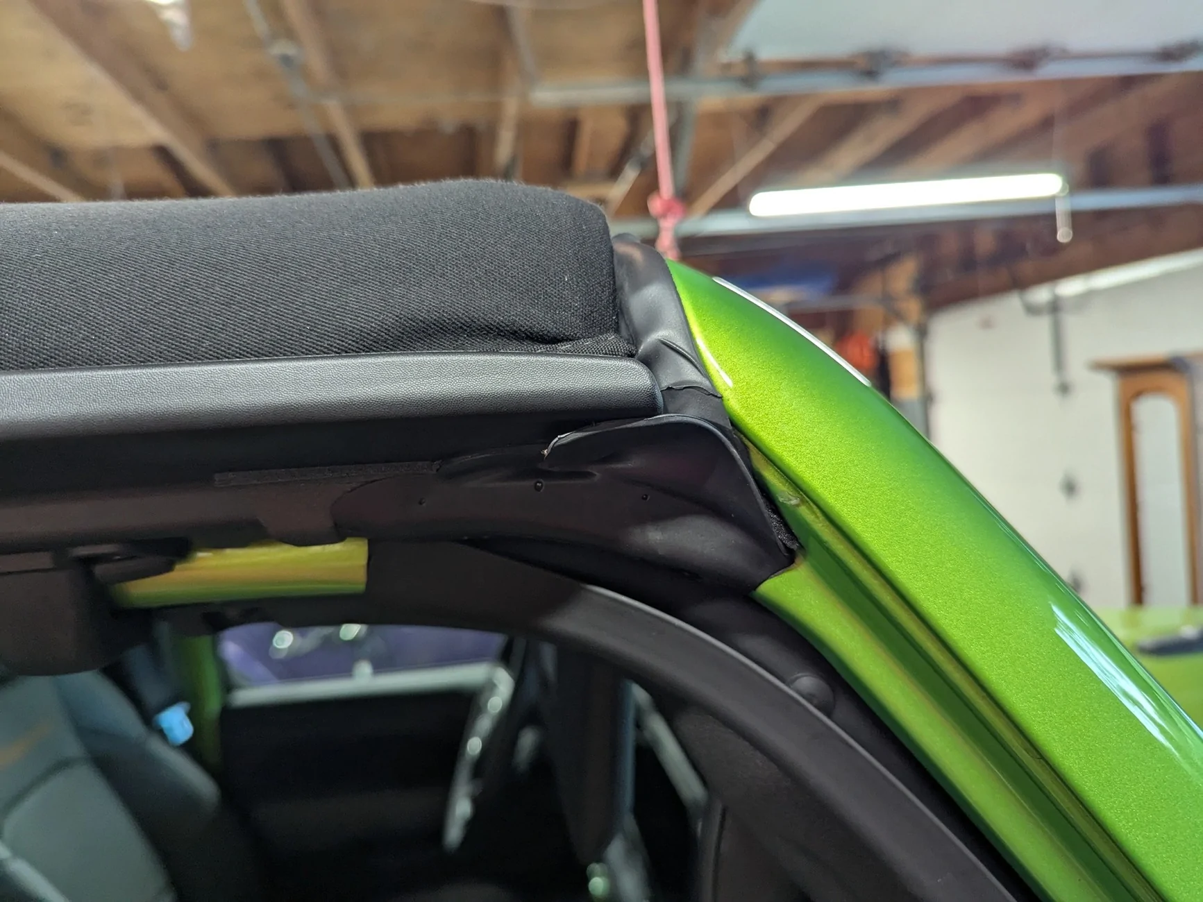

Jeep Gladiator Sunrider owners - MY mess-up, or theirs? PXL_20250817_004646367
Jeep Gladiator Sunrider owners - MY mess-up, or theirs? PXL_20250817_004722562
Jeep Gladiator Sunrider owners - MY mess-up, or theirs? PXL_20250817_004727116
The front of the left rail rides the door
Jeep Gladiator Sunrider owners - MY mess-up, or theirs? PXL_20250817_004531634
Jeep Gladiator Sunrider owners - MY mess-up, or theirs? PXL_20250817_005012884

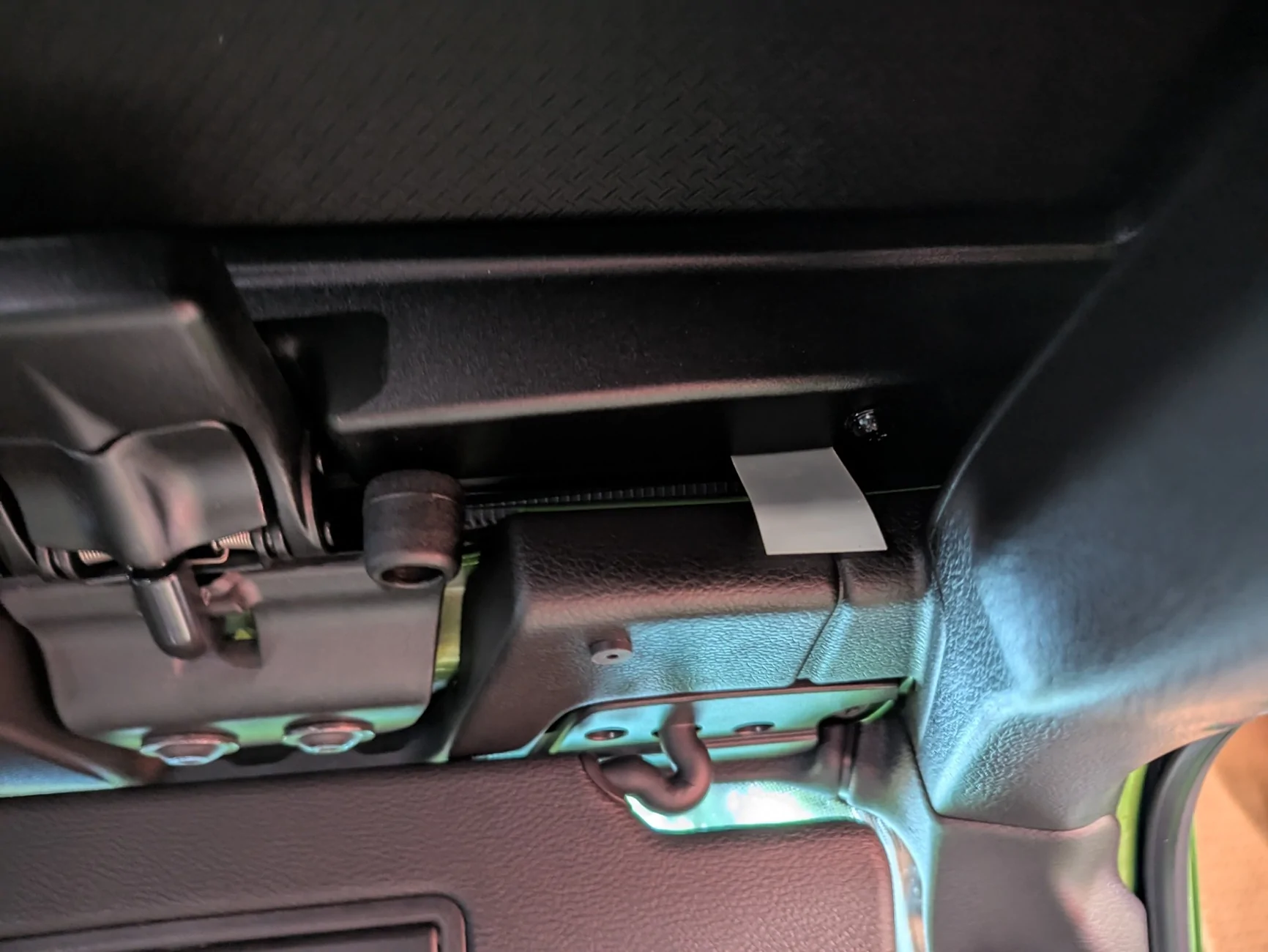

I slid this in easily - and folded a piece of paper and slipped it right in with NO resistance (above and below pics)
