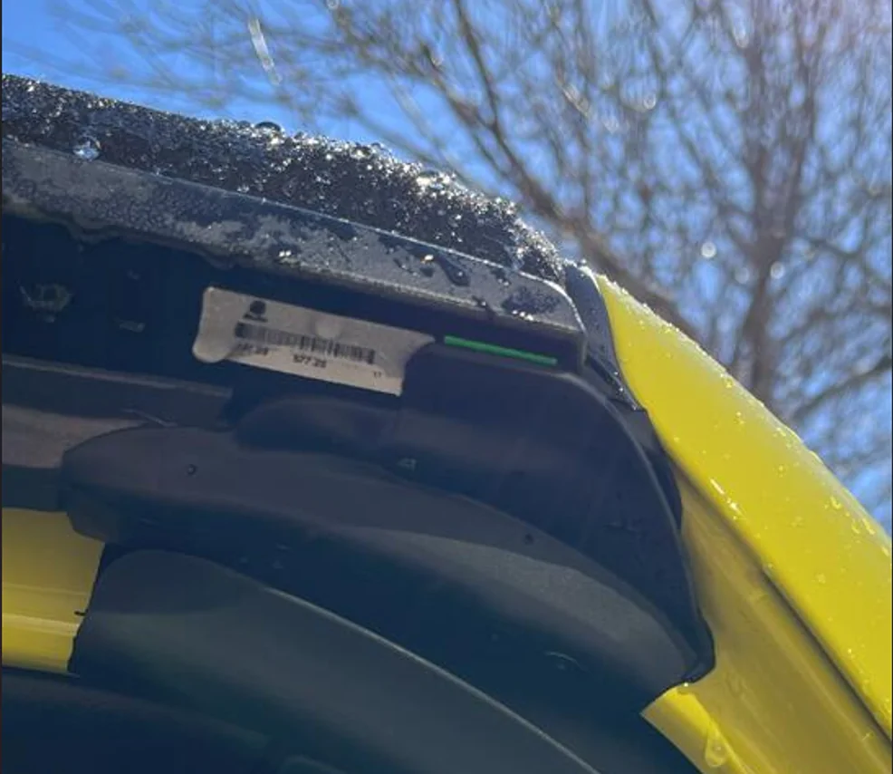

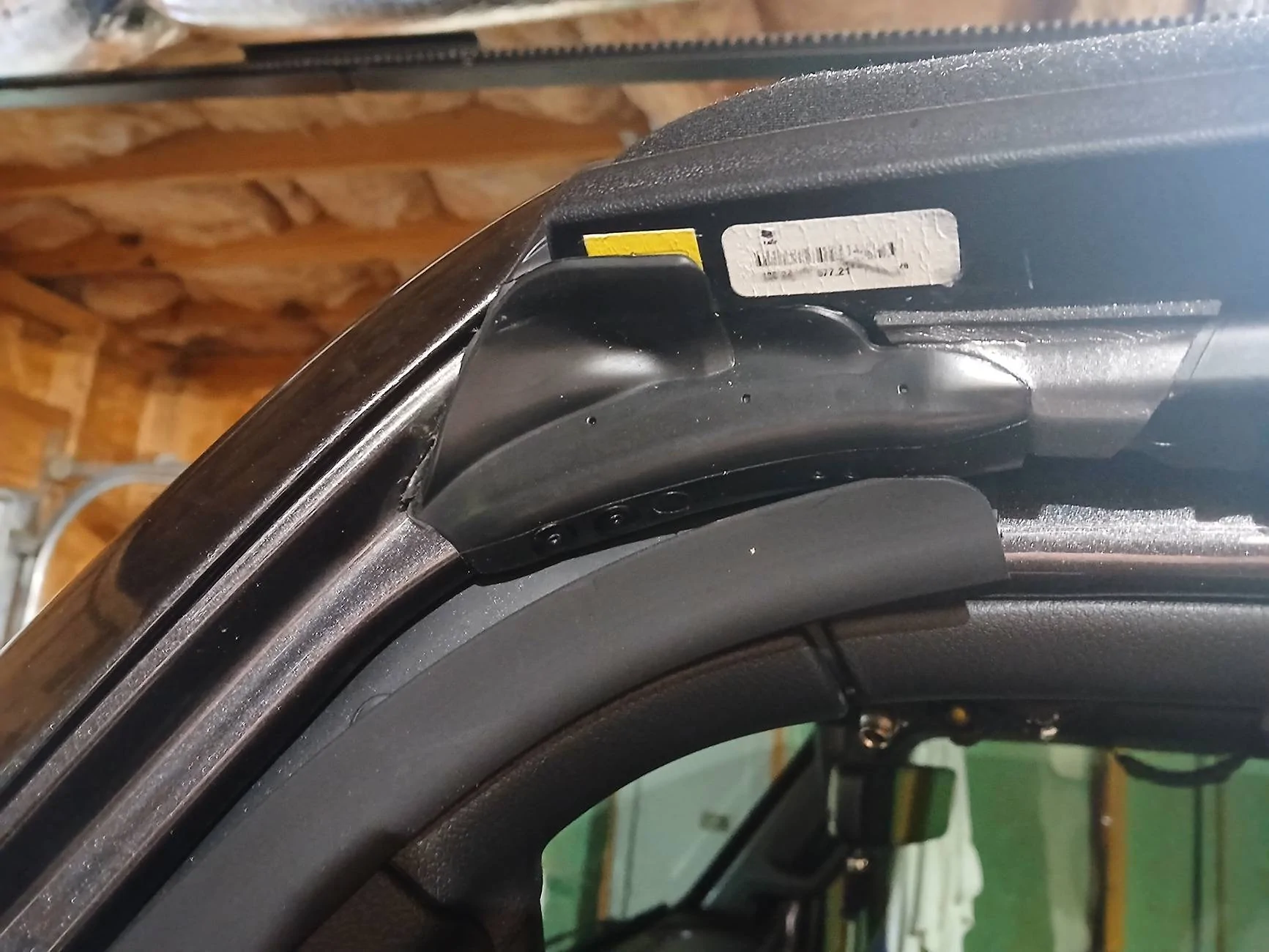

Seems that someone who says theirs is working perfectly isn't 100% straight on that - they've done the hack that Bestop says to NOT do..............
I found a quote in another post where they talk of the issue they had, used the hack, and called it good.
I talked to Bestop, as have others, and Bestop sent along a photo saying this is the proper fit (see below - the one that's wet), don't tuck that seal, it's not correct.
So much for "my top is perfect.".
Bestop says - THIS is correct- the pictures, anything else is not - They sent this photo of a correctly fitting install, with the Sunrider drip rail parallel to the top of the door. Even their engineer told me that - it should sit parallel and not push down the seals. And that's what they are striving for now - a correct fit.
So if your Sunrider, either MOPAR or Bestop, doesn't fit like these, and the drip rail isn't nearly parallel to the top of the door, it's not a good fit according to their own engineer and customer support.
Please don't tell me you have a perfect fit if you have opted to tuck the seals. You have accepted an incorrect fit and done what Bestop support says not to do, and should not be needed.
If you want to accept that, it's your Jeep. Please, though, don't tell me it's perfect.
Bestop engineering apparently agrees with me.......... they are jumping through crazy hoops to help!
This is correct -
Jeep Gladiator Sunrider owners - MY mess-up, or theirs? 1755628236925-2q
These are how they should fit.

Well, guess what the tolerance is for that roll structure........3 to 5 mm.
Hmmm, took 5 mm on one side and 3 to 4 on the other to make it sit right on mine (but clamping still an issue)
I'm seeing a reason some fit perfect while others, either brand, do not.
Bestop is shooting at a moving target!
