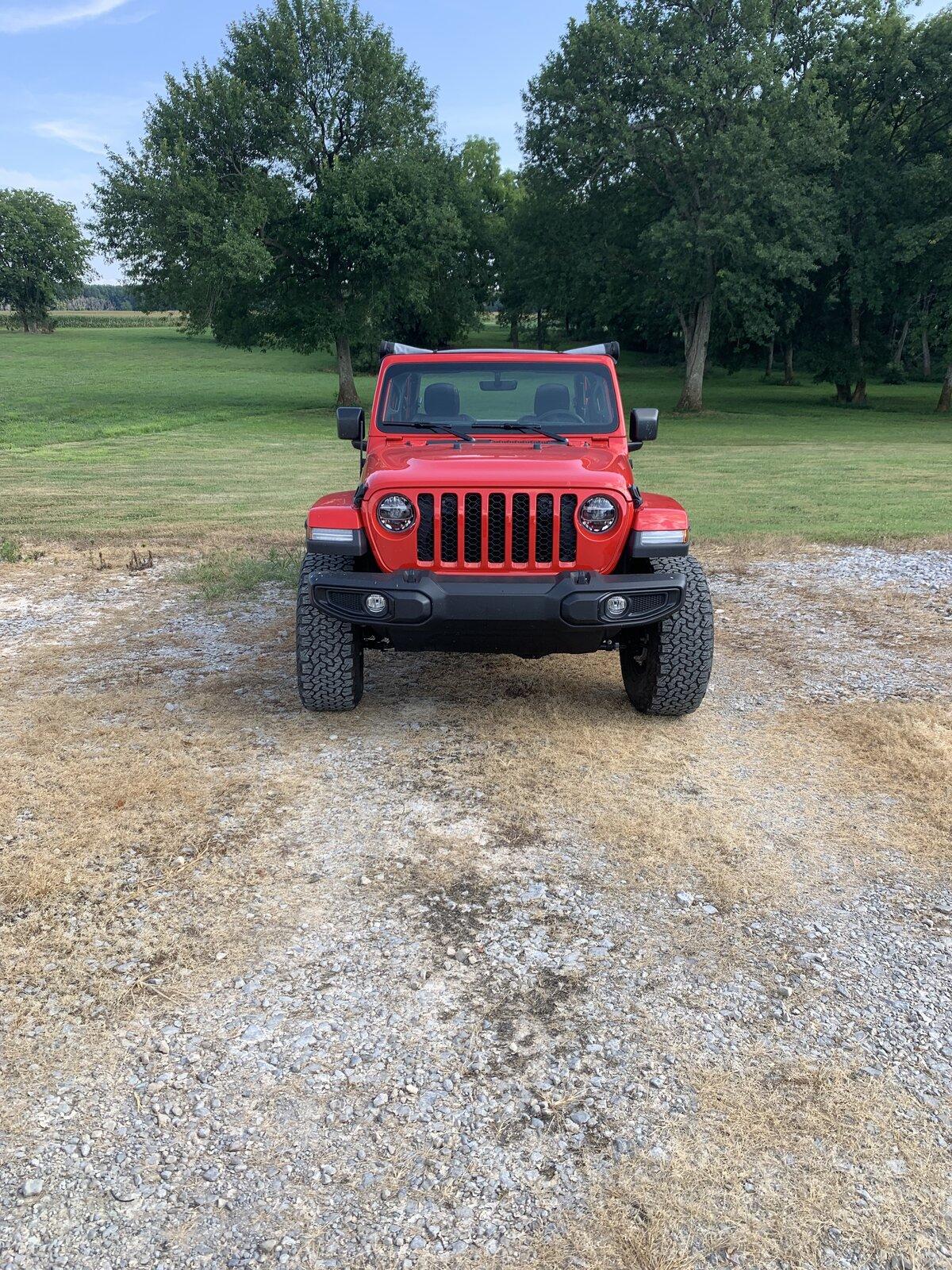

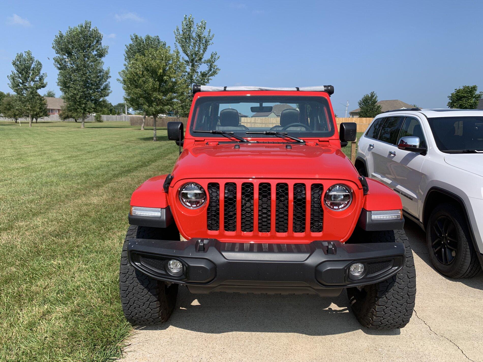

Thanks for sharing and getting us pics and a vid, really appreciate it. Any way you can get us a pic of it head on? It doesn't look quite as bad as I imagined.
Here you go

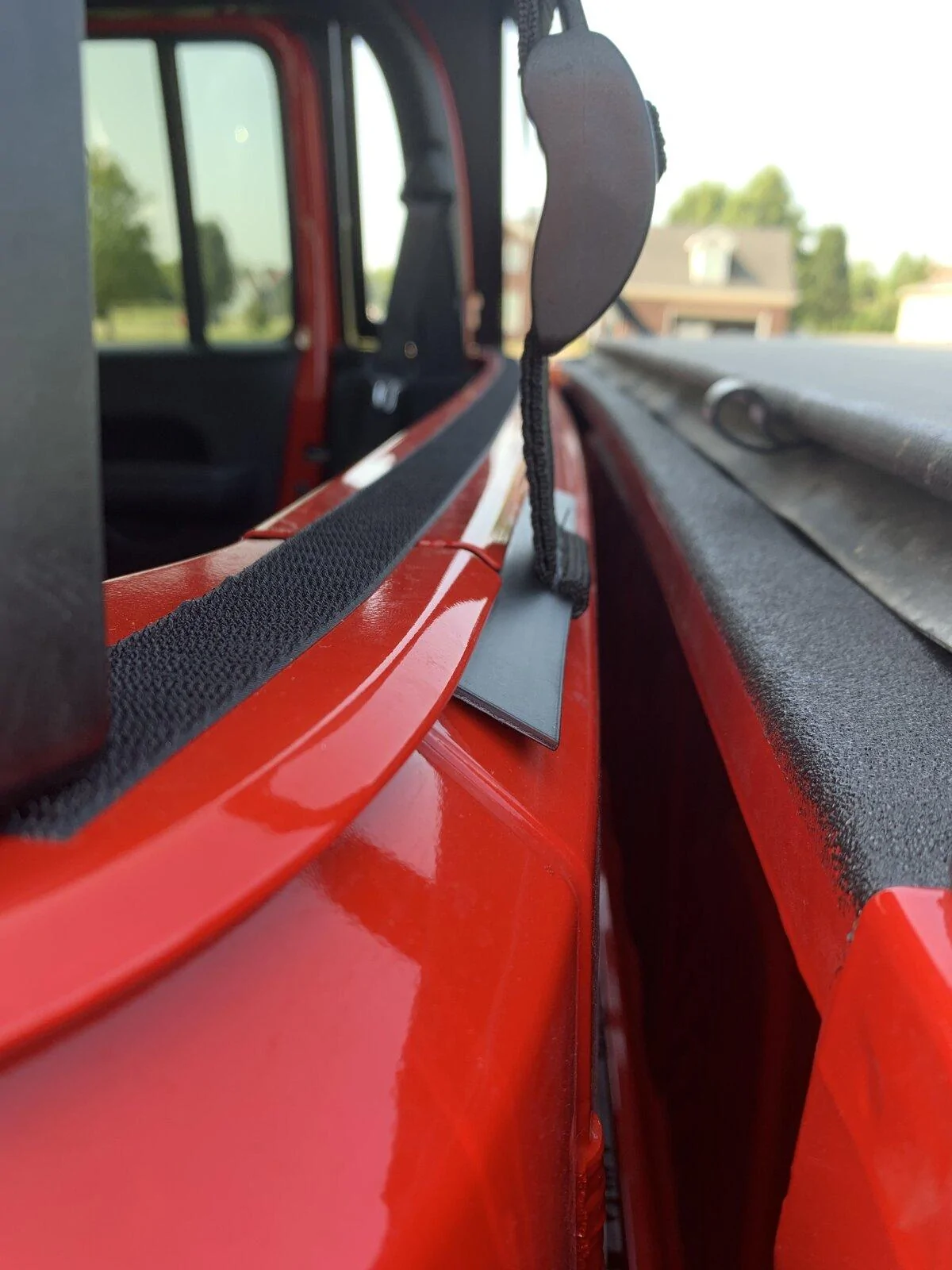

I got home last night and unrolled the top and sinched it down using safari buckles… my first thought is that maybe these plastic lips are too long? If they would go all the way in and were against the metal maybe they would be less prone to pull out with tension on them? Just a thought I had wanted to see yalls thought
Here’s a pic to support this theory
That is a good thought. I remember a YJ top I had that seemed to have a similar issue. I cut it down with some improvement. ??‍♂
