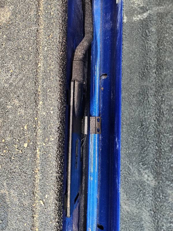

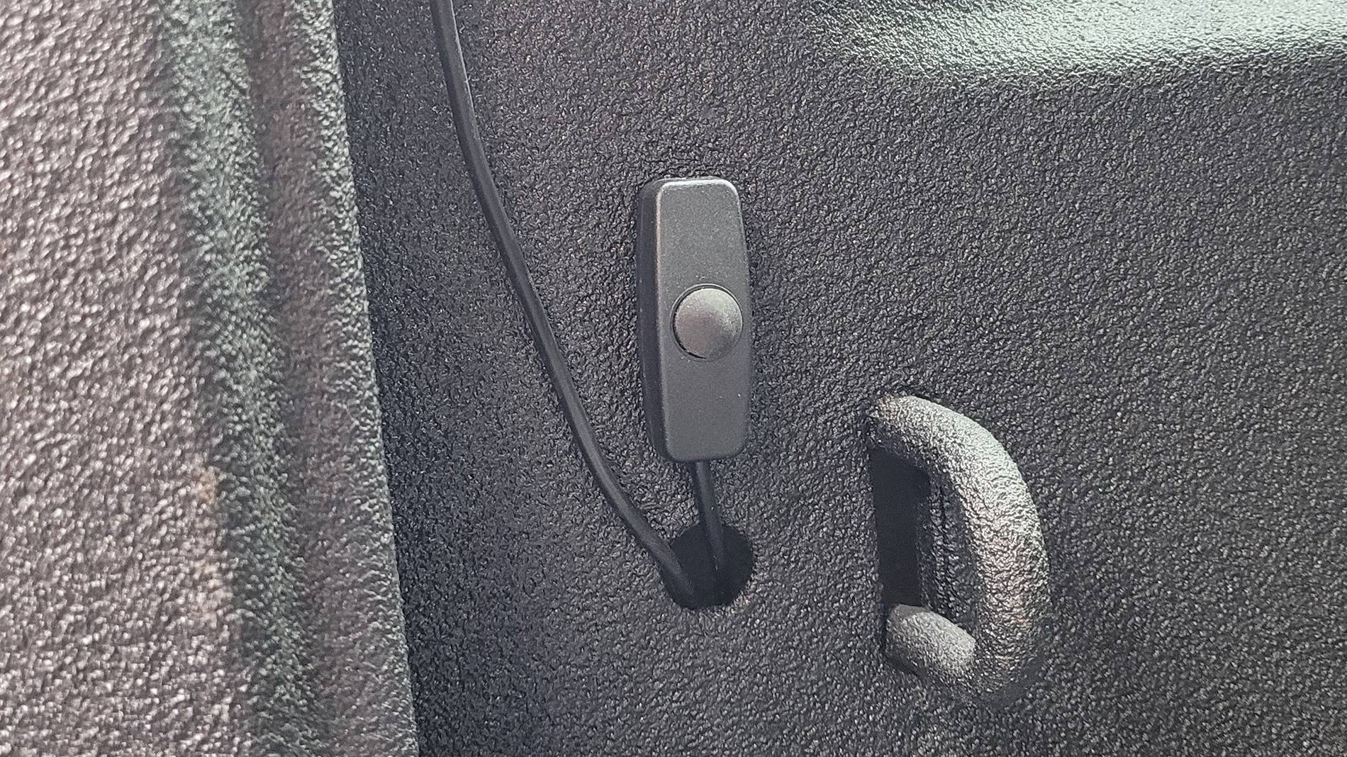

Magnet switch is installed by the plastic cover

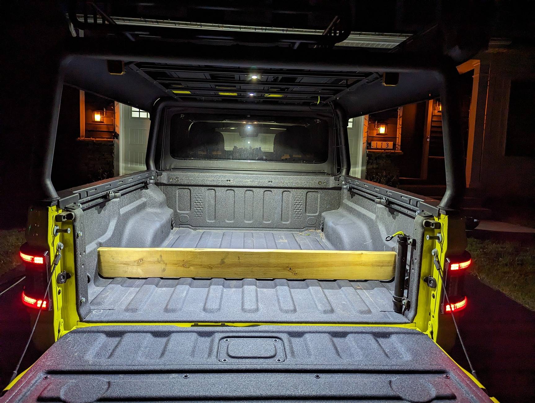

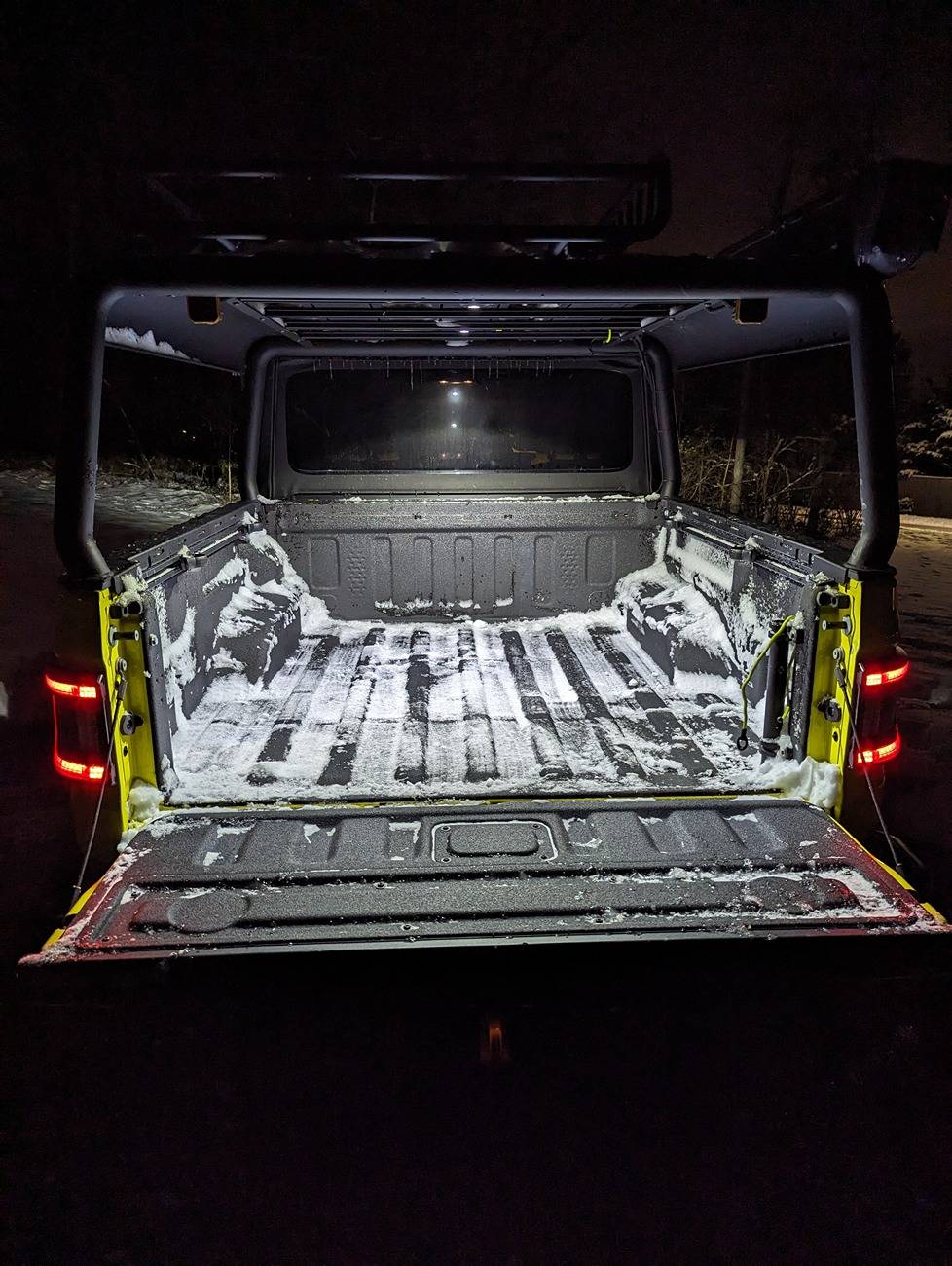

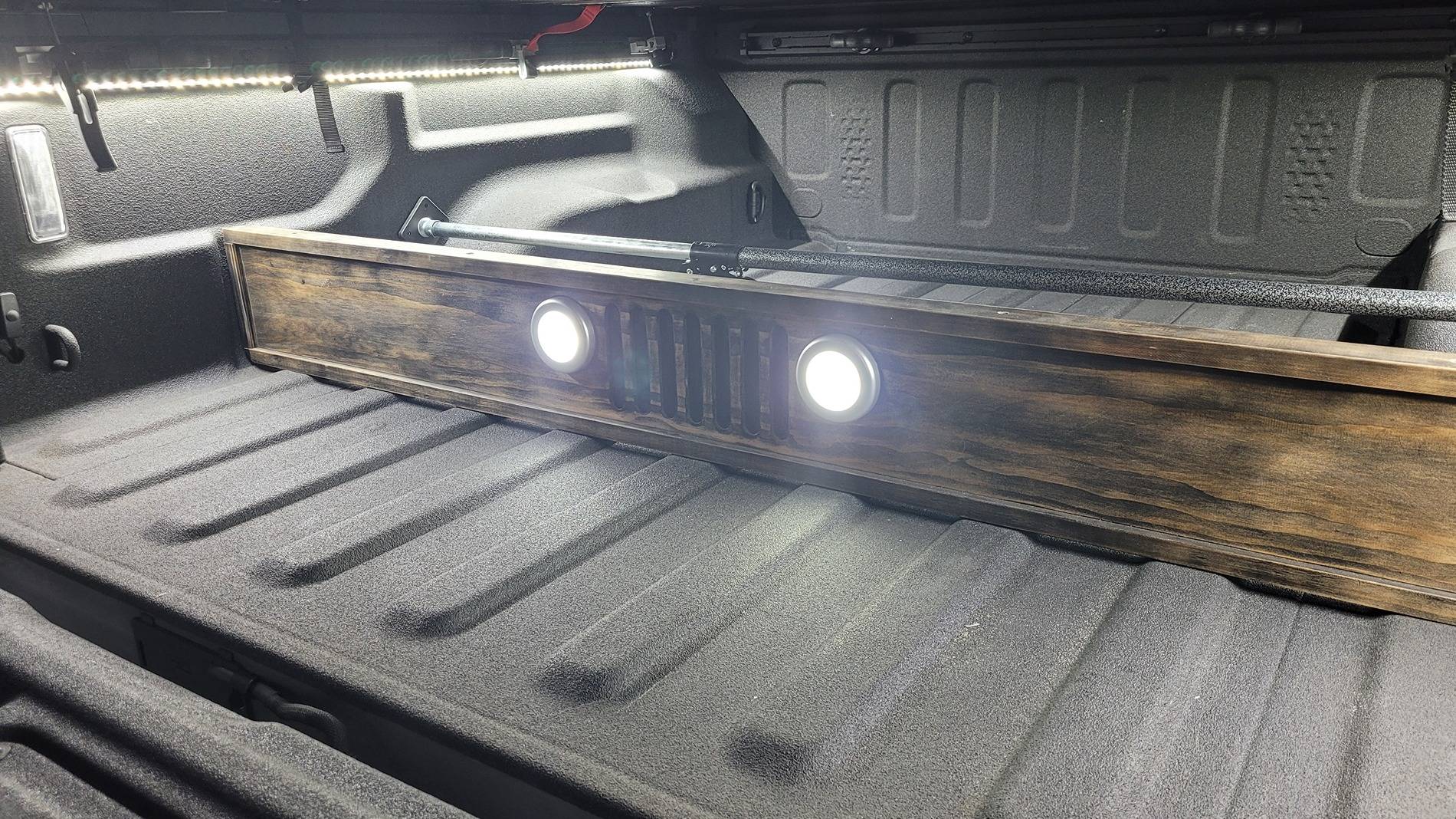

Thanks for the ideas and tips here. Here's what i went with
Magnetic Reed Switch,Wired Door... https://www.amazon.com/dp/B09ZTP1S4Q?ref=ppx_pop_mob_ap_share
Nilight - TR-05 2PCS 60 Inch 180... https://www.amazon.com/dp/B07KXR799K?ref=ppx_pop_mob_ap_share
Used a fusetap to f97. Super clean install very happy with it. I may design some way of moving the magnet so I can kill the light with the gate down but for now I'm happy (like driving with a larger item and gate open)

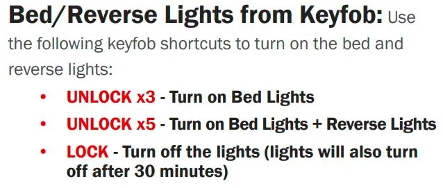

Idk if it’s been said or not but if the vehicle is running then you can hit the button in the cab to keep the lights on.
if it’s off you can leave a door cracked to keep the lights on.

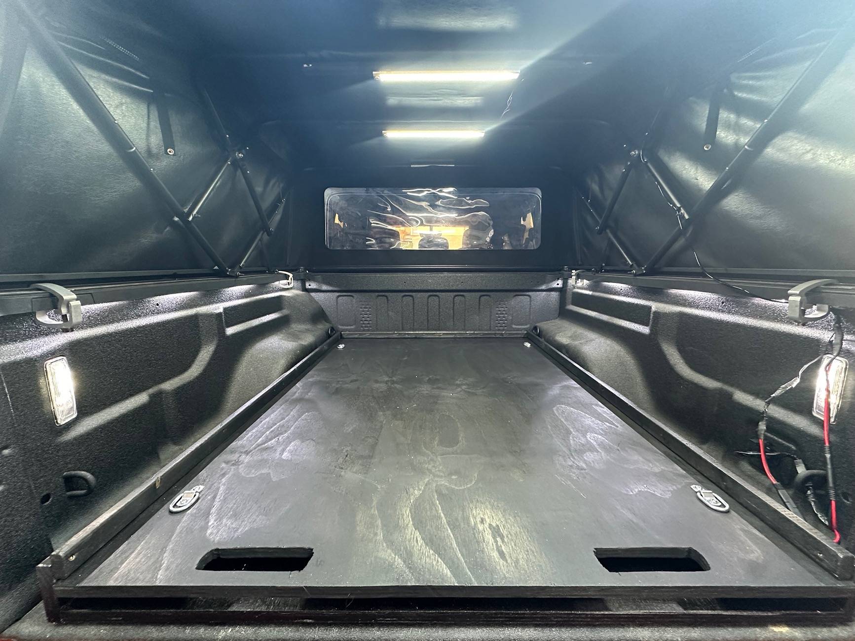

Electrical Foreman

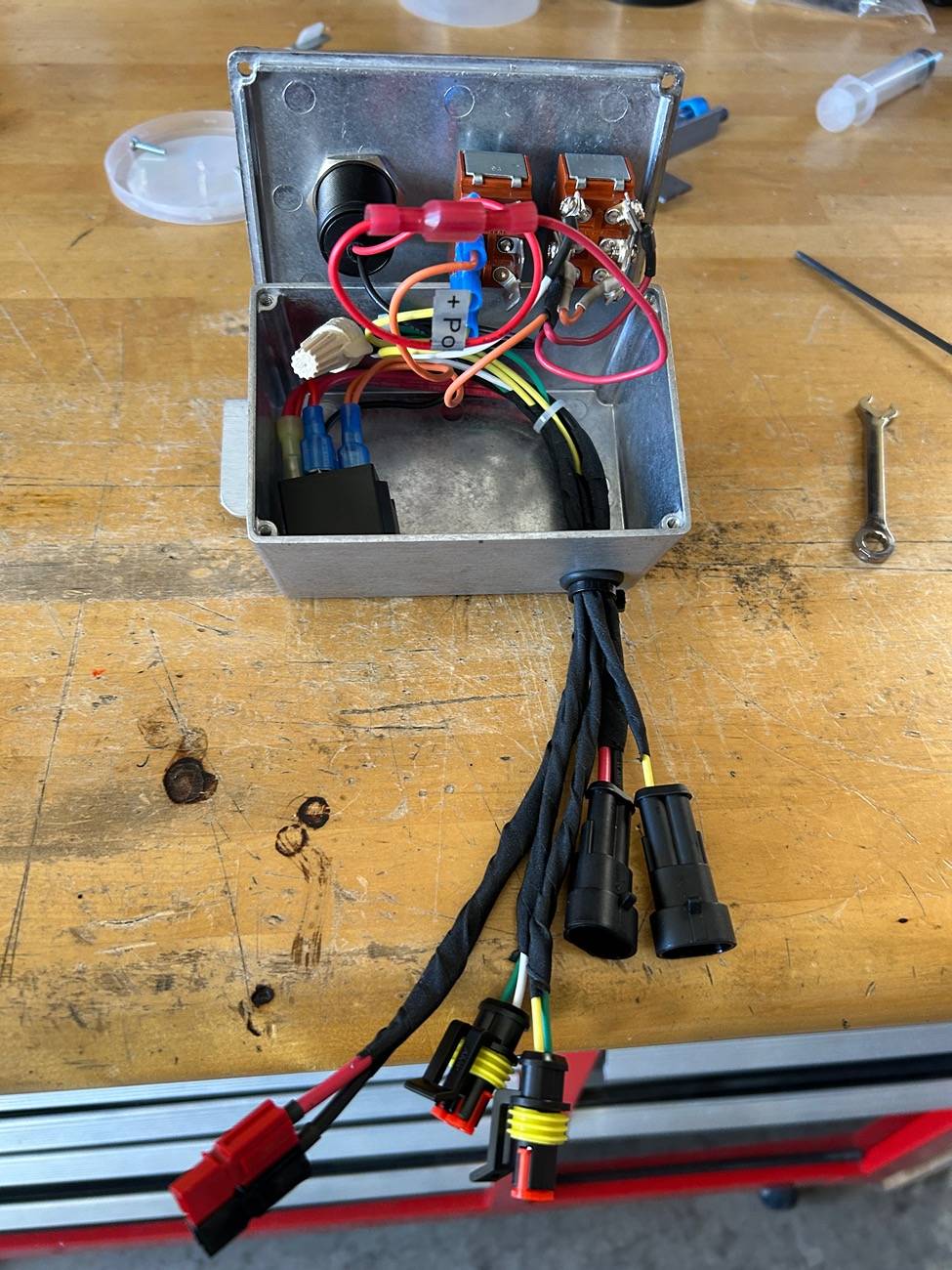

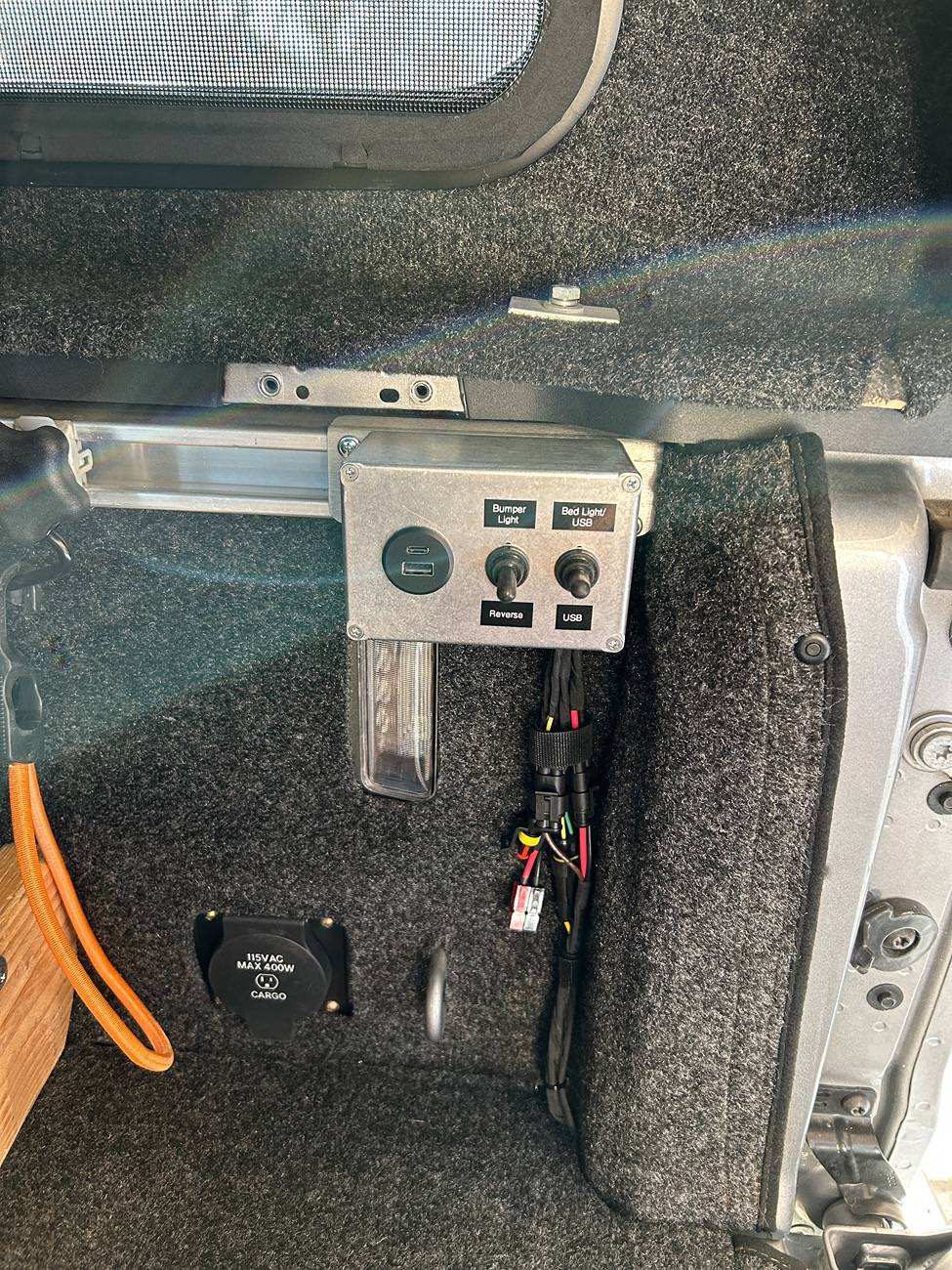

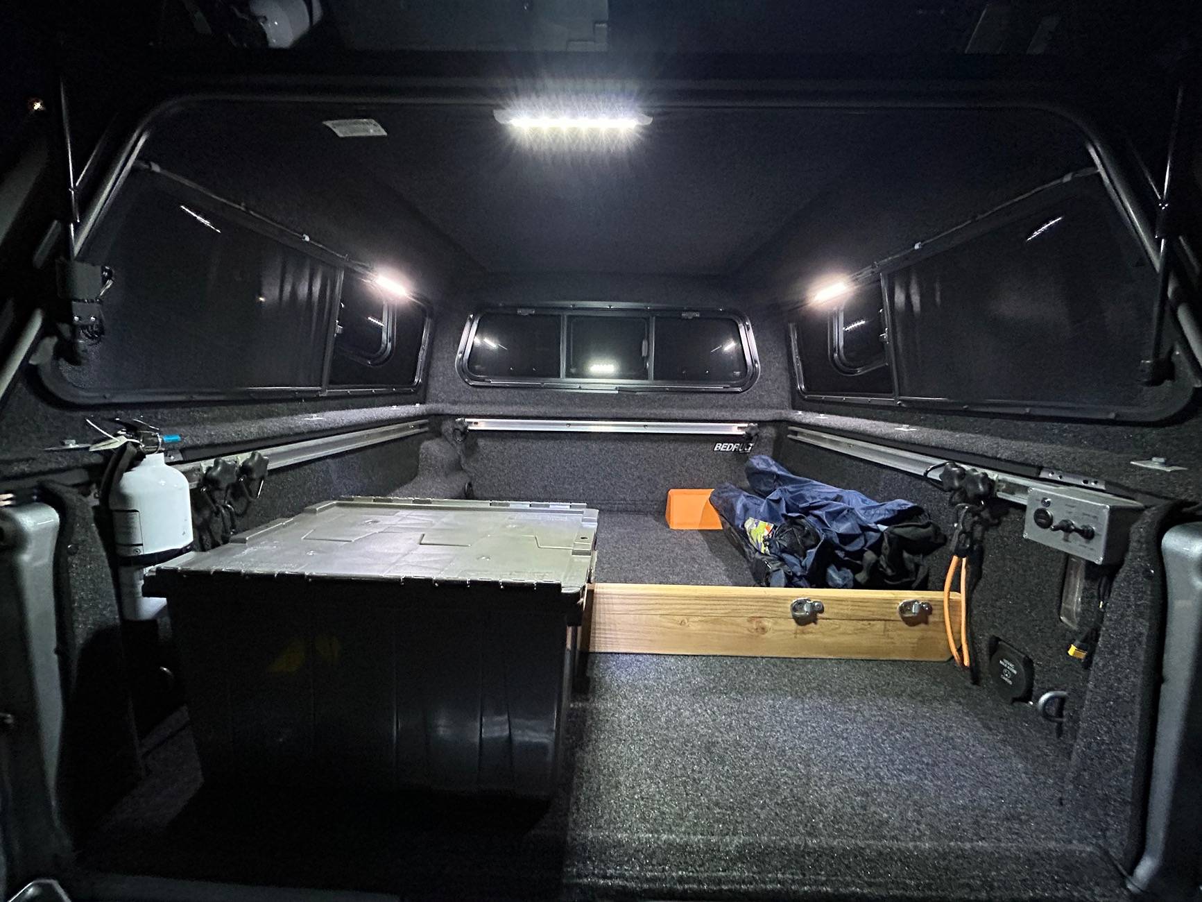

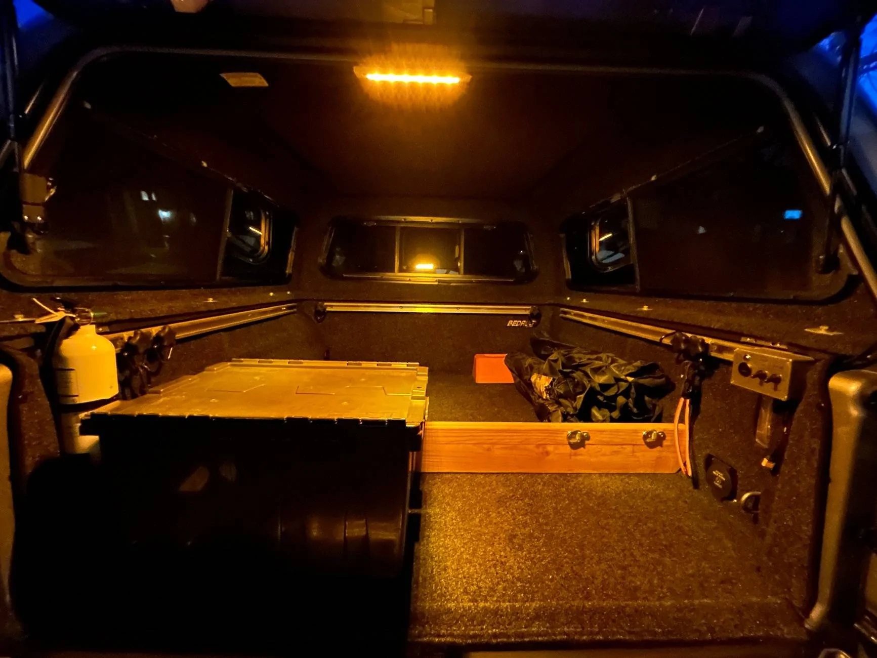

If you want to build your own switches. I used some waterproof 40 degree down lights meant for RV exterior lighting, dual colors amber/white. Amber attracts fewer bugs as i sleep in the bed when camping. Anything that ties into the stock bed lamp will comes on when lock/unlock doors.
Jeep Gladiator Switche and Bed light upgrade? IMG_0129
Jeep Gladiator Switche and Bed light upgrade? IMG_0108
Jeep Gladiator Switche and Bed light upgrade? IMG_0130
Jeep Gladiator Switche and Bed light upgrade? IMG_0109
