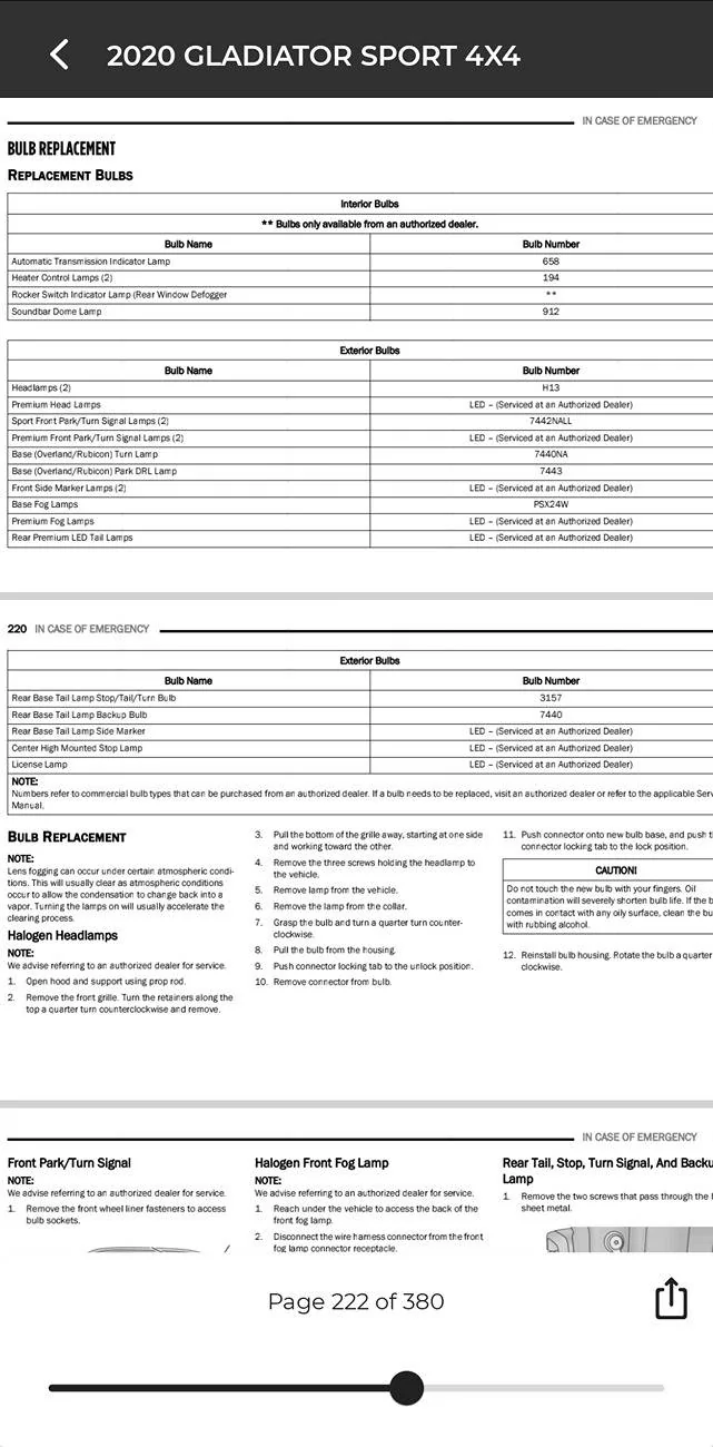

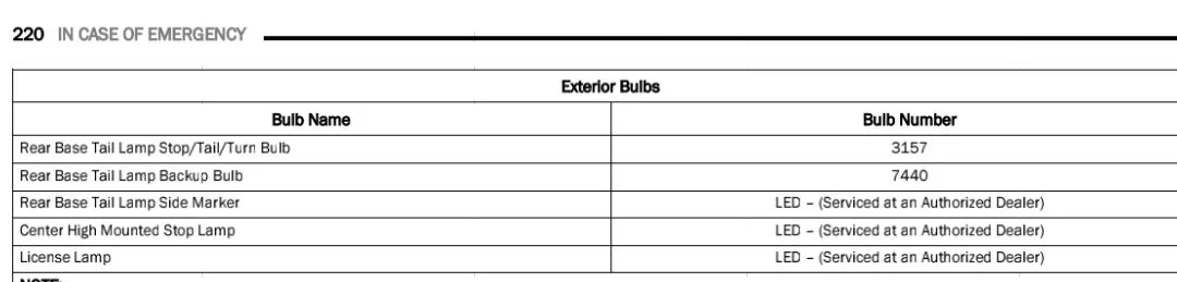

FYI, note to this thread the "3157" bulbs. I had the bulb burned out situation that bulb didn't fit. 7443 is the correct one. Hopefully it will save someone the problem and they get right one first time. I'll add a picture from owners manual of this page for reference "note" it's wrong I don't want anyone else to be trying to fix burned out bulb in f###ing freezing rain. Especially on a 20 some hour day.
Jeep Gladiator tail light out Screenshot_20241201_190316_J
Jeep Gladiator tail light out 20241201_191055
I clipped the picture to highlight incorrect bulb info, backup light is correct.
