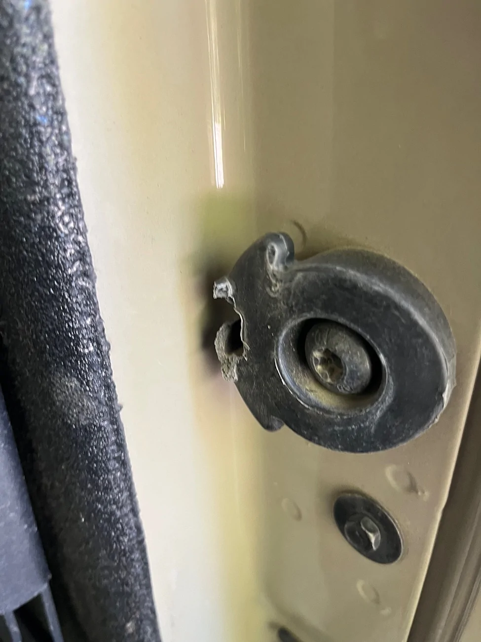

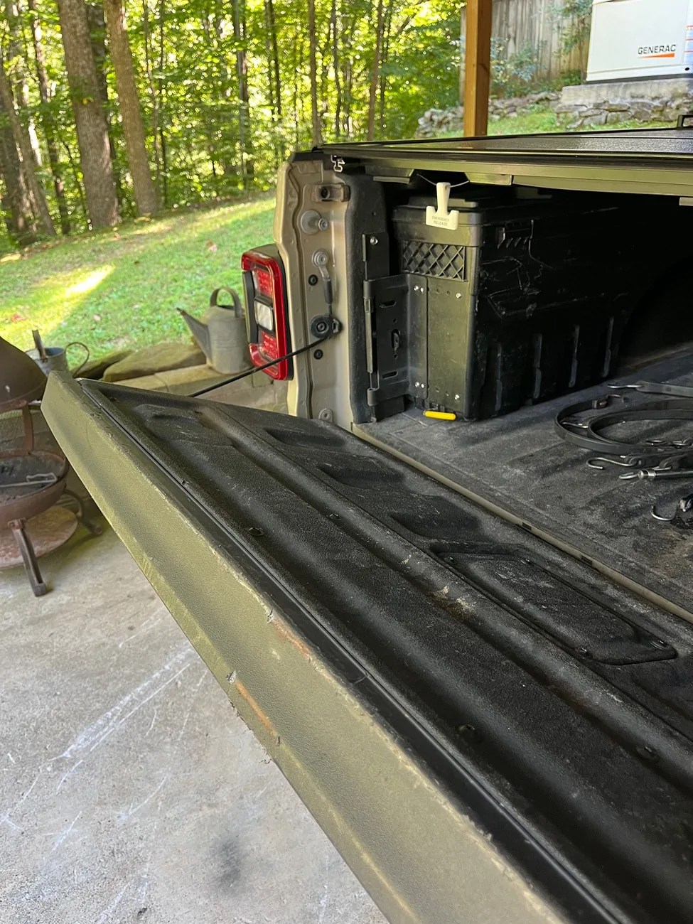

Does anyone know if they make this part in metal not plastic and if not a mopar part number for the plastic piece.

Sorry, I don't have the answer, but wondering if you still have the broken tab. Might be able to just epoxy it. Seems partially hollow, so I would guess that it could potentially be even stronger then the original. Not sure though.

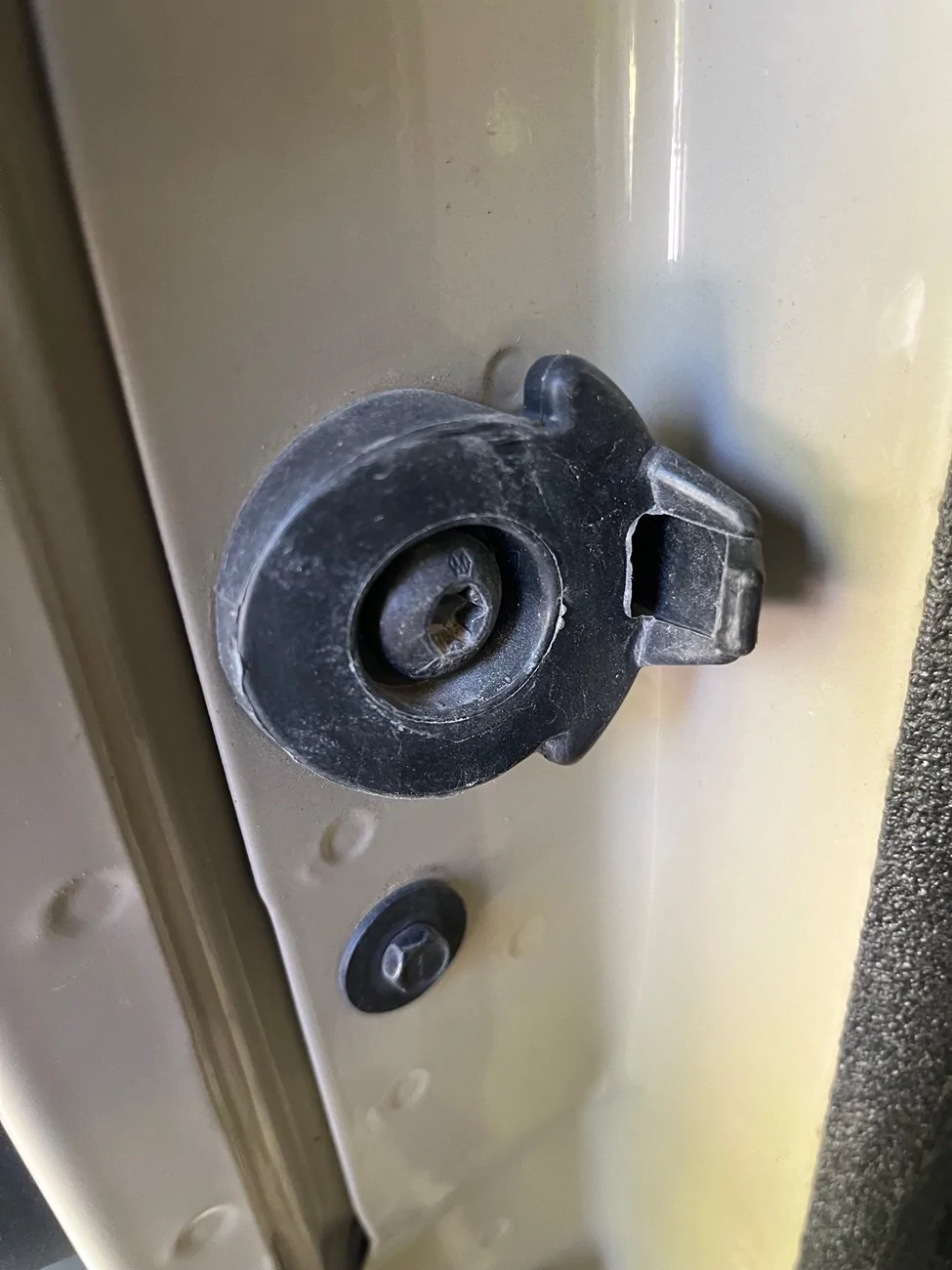

Appears the cable didn't get back into the slot it was supposed to go back into - you have to push it firmly all the way back against the side opening, behind that piece.
Same thing would happen with a replacement, otherwise.
Never seen one break like that before.

The stock ones will take a heck of a lot of weight and use............ IF the cable is properly locked into place behind that part. A lot of folks have hauled plywood, sheetrock and more, so I'd expect replacements to last a long time.
The only time I'd see a need for anything "tougher" or different is if the stock parts are taken beyond their limits.

I did not get it all the way back in slot so it was my bad. Thanks for epoxy idea and the other options. Thanks again
