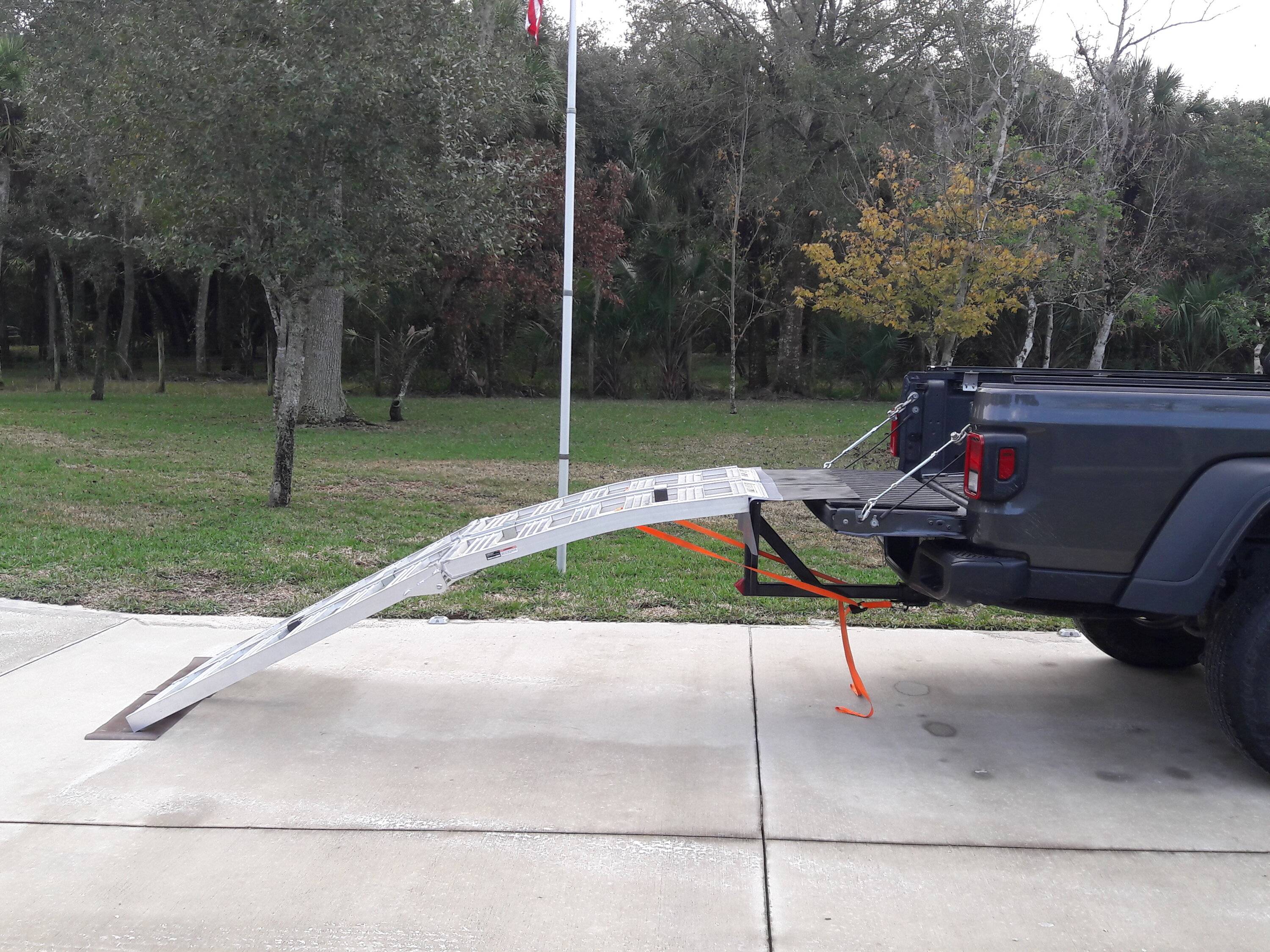

Looks like the carabineers aren't in line with the turnbuckles, which will tend to bend the biners. They may or may not not actually fail, but you might have trouble unscrewing the links.

Biplane,
You just lift the tailgate release and they pop free! Never had a problem with my Frontier using them. And there only there as a secondary stress support (I don't trust the engineering reports that the OEM straps are rated at 500lbs each (as was the same for all my Frontiers). Never could tell if they were talking Static or Dynamic loads.

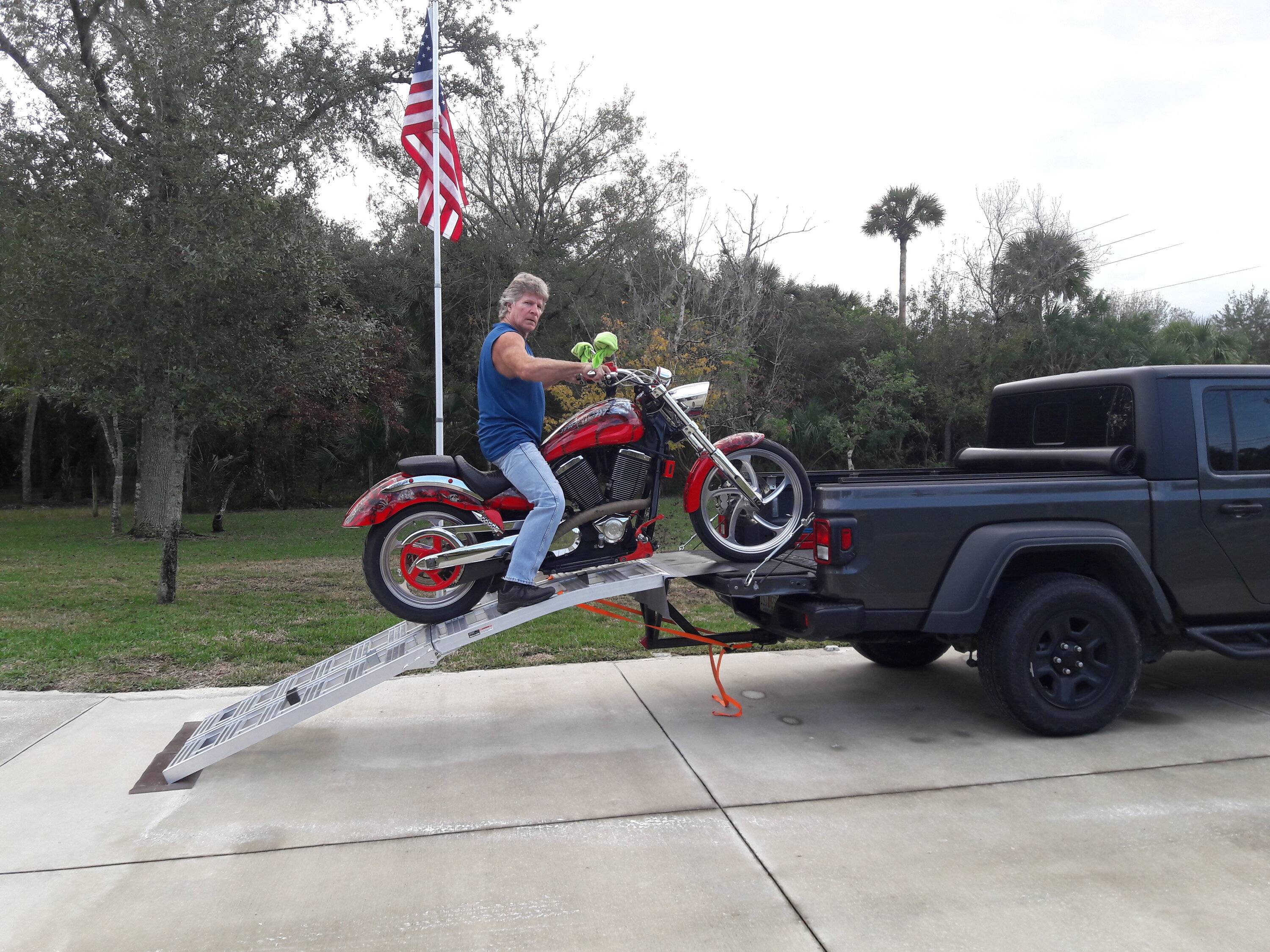

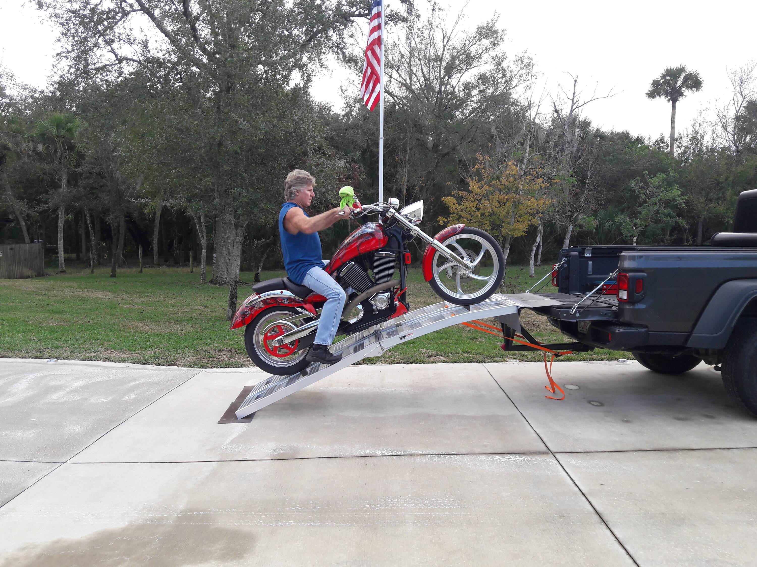

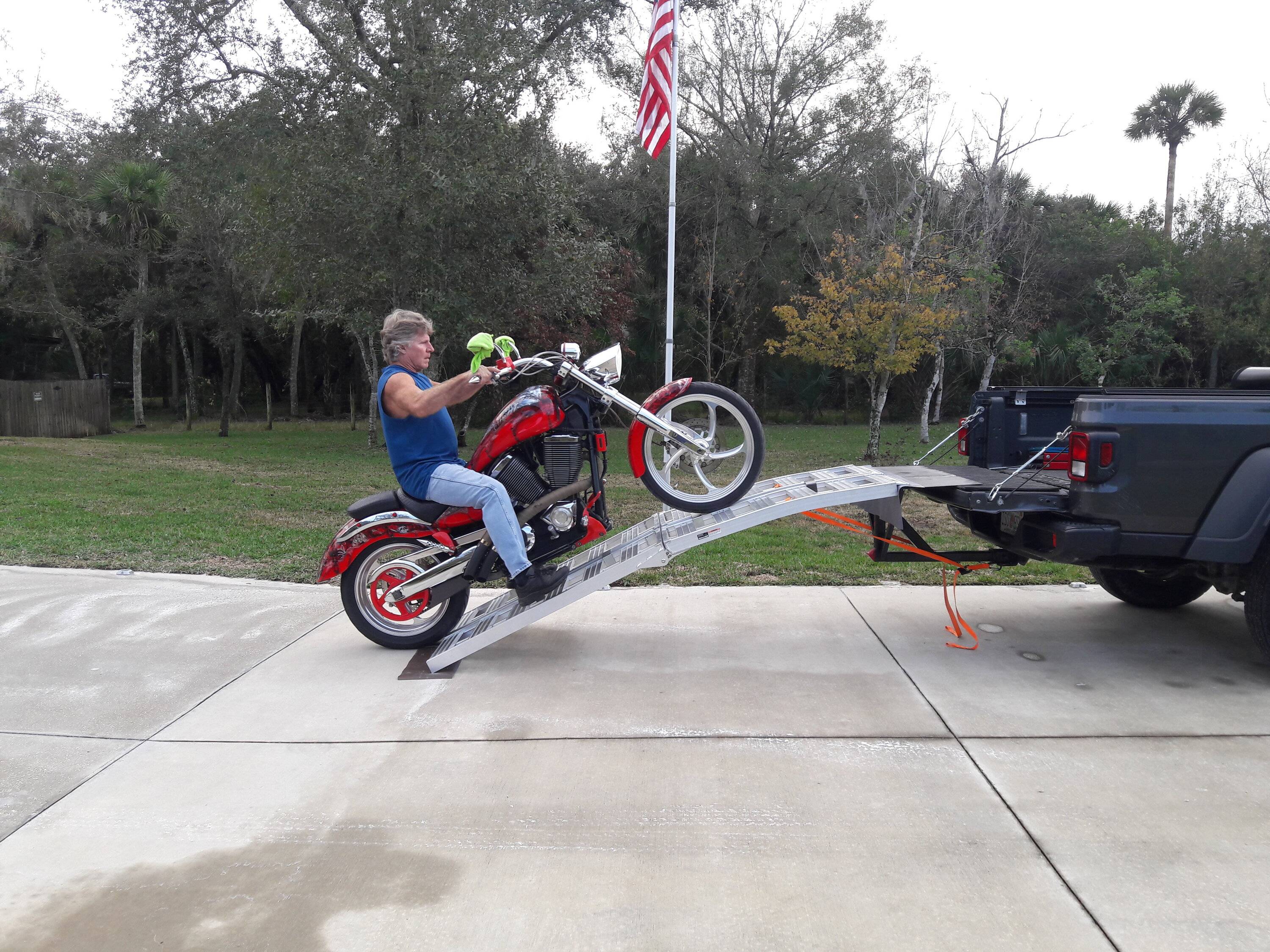

For those of you a bit timid about loading I had G/F take some pics of key points of the loading. As you can see your feet can be on the ramps all the time and you can "walk" your bike up. I just ride it up but I've been doing this a long time and with a dirtbike as well. Oh and the ramps are 8' long.
Jeep Gladiator Tailgate extension for Motorcycle (Metric cruiser- '05 Victory Vegas) in the Bed! Ram
Jeep Gladiator Tailgate extension for Motorcycle (Metric cruiser- '05 Victory Vegas) in the Bed! Ramp1
Jeep Gladiator Tailgate extension for Motorcycle (Metric cruiser- '05 Victory Vegas) in the Bed! Ramp2)
Jeep Gladiator Tailgate extension for Motorcycle (Metric cruiser- '05 Victory Vegas) in the Bed! Ramp3

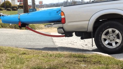

I mean the departure angle of the Gladiator
going from a steep driveway onto the street for example.
Yup, I was REALLY surprised when I grounded out my extra long hitch (for tailgate down towing) one time.
When I needed a bed extender for my Kayaks I went with a curved design so I would not ground it out so easily.
Jeep Gladiator Tailgate extension for Motorcycle (Metric cruiser- '05 Victory Vegas) in the Bed! 1627663650345-png
