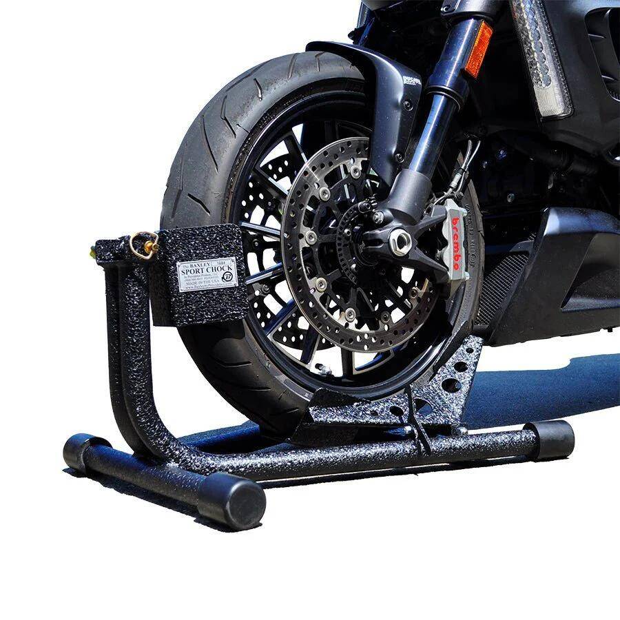

Place this up against the back of the bed, tie the bike down from the lower triple clamp to the points in the corner of the bed. The bike won't fall over and the stand will hold it up while you tie it down.
Use a ramp that becomes a bed extender to keep any other stuff from falling out.

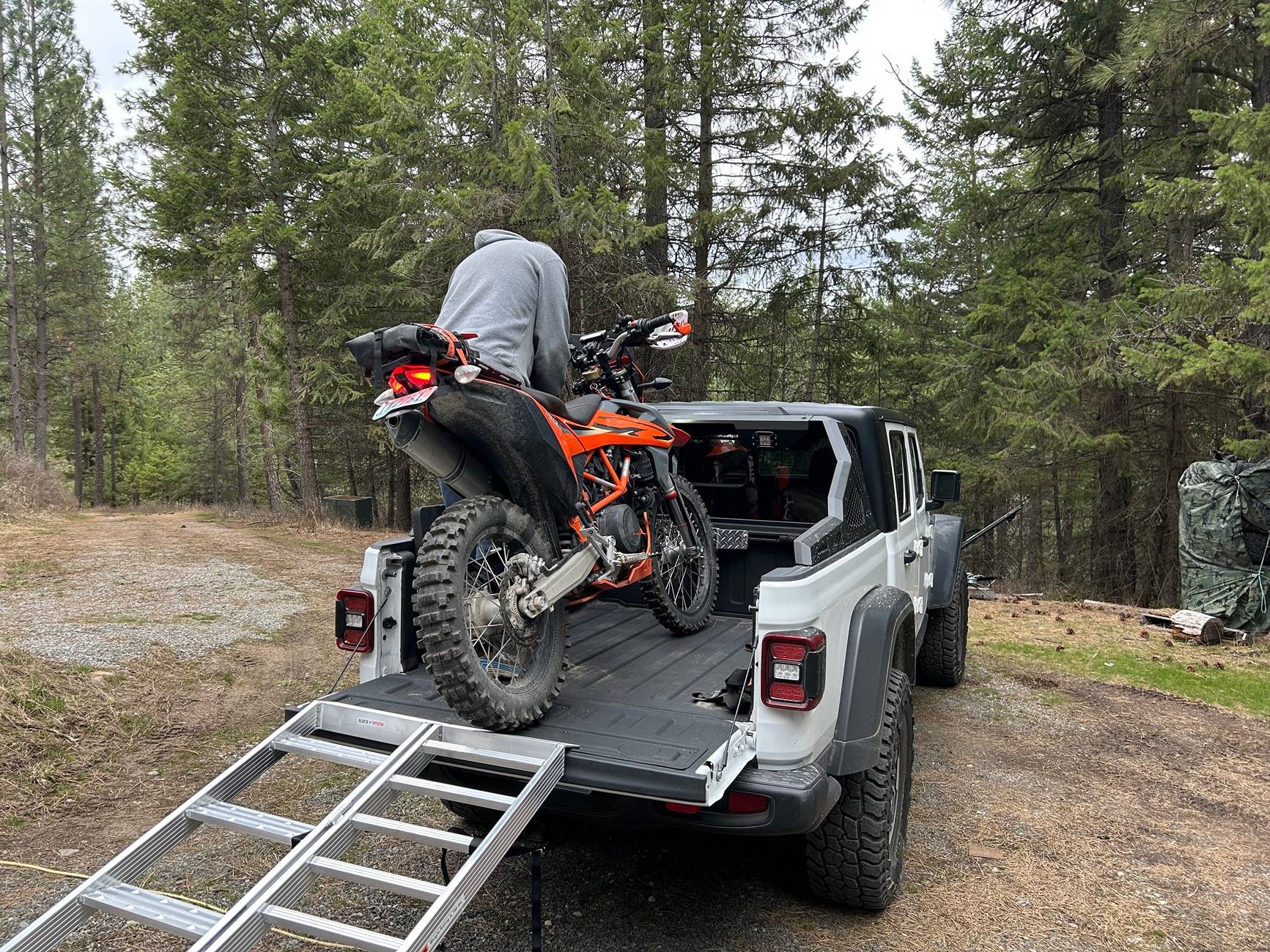

Like you, I switched from big adventure bikes to my KTM 690 after riding my 1090 on the Washington BDR in 2024, as I realized I would not be able to pick up the 1090 by myself on the trail if I went down.

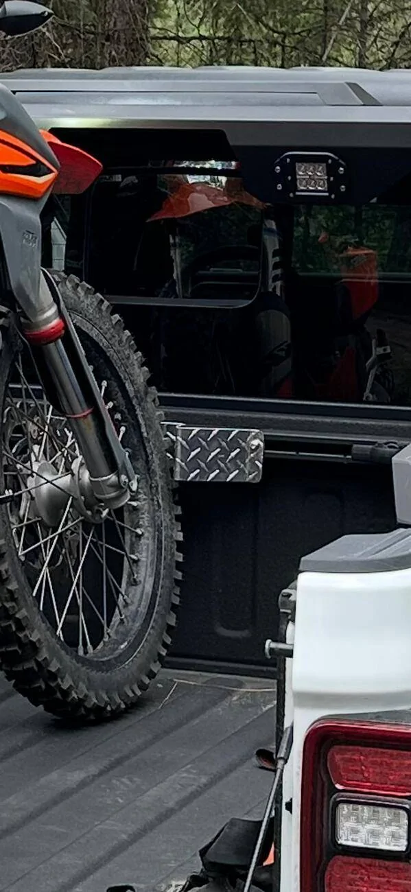

I have trail rails, so used a piece of scrap aluminum and created the wheel chock in the picture that bolts to the front trail rail. (See picture)

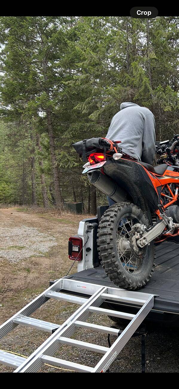

the bigger issue was getting a ramp that made it easy to get the bike in the bed, and found the ramp in the picture that has steps on one side and normal bike rails on the other. This ramp easily handled an 890 and 690 at the end of the Utah BDR earlier this year. It’s expensive, but almost eliminates the risk of dropping my bike while loading.
next issue was the steepness of the ramp since my gladiator is lifted with 37 inch tires. I use RV stackable leveling blocks to build a little ramp for each front tire that lowers the tailgate to reduce the steepness of the ramp. I use a small ditch or little hill if available, but the leveling blocks work on flat ground. If course, I don’t try and push the bike up the ramp, I just drive it up the ramp while walking up the steps.
