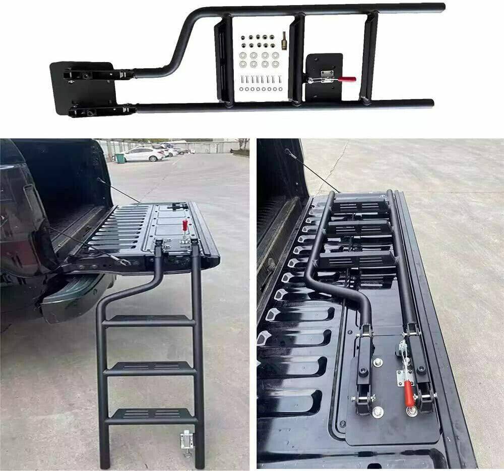

Tailgate steps. has anyone installed something like this? Opinions?

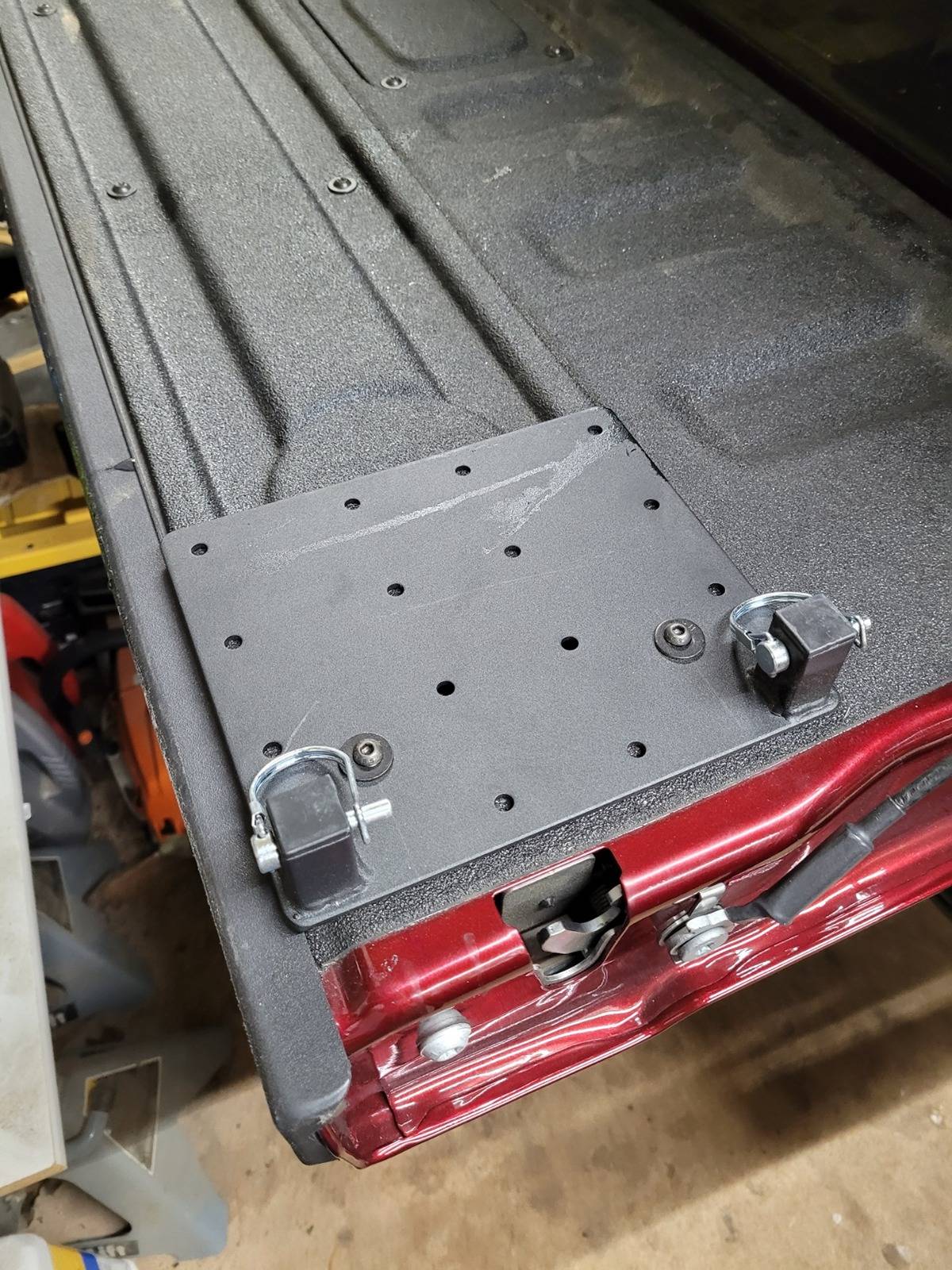

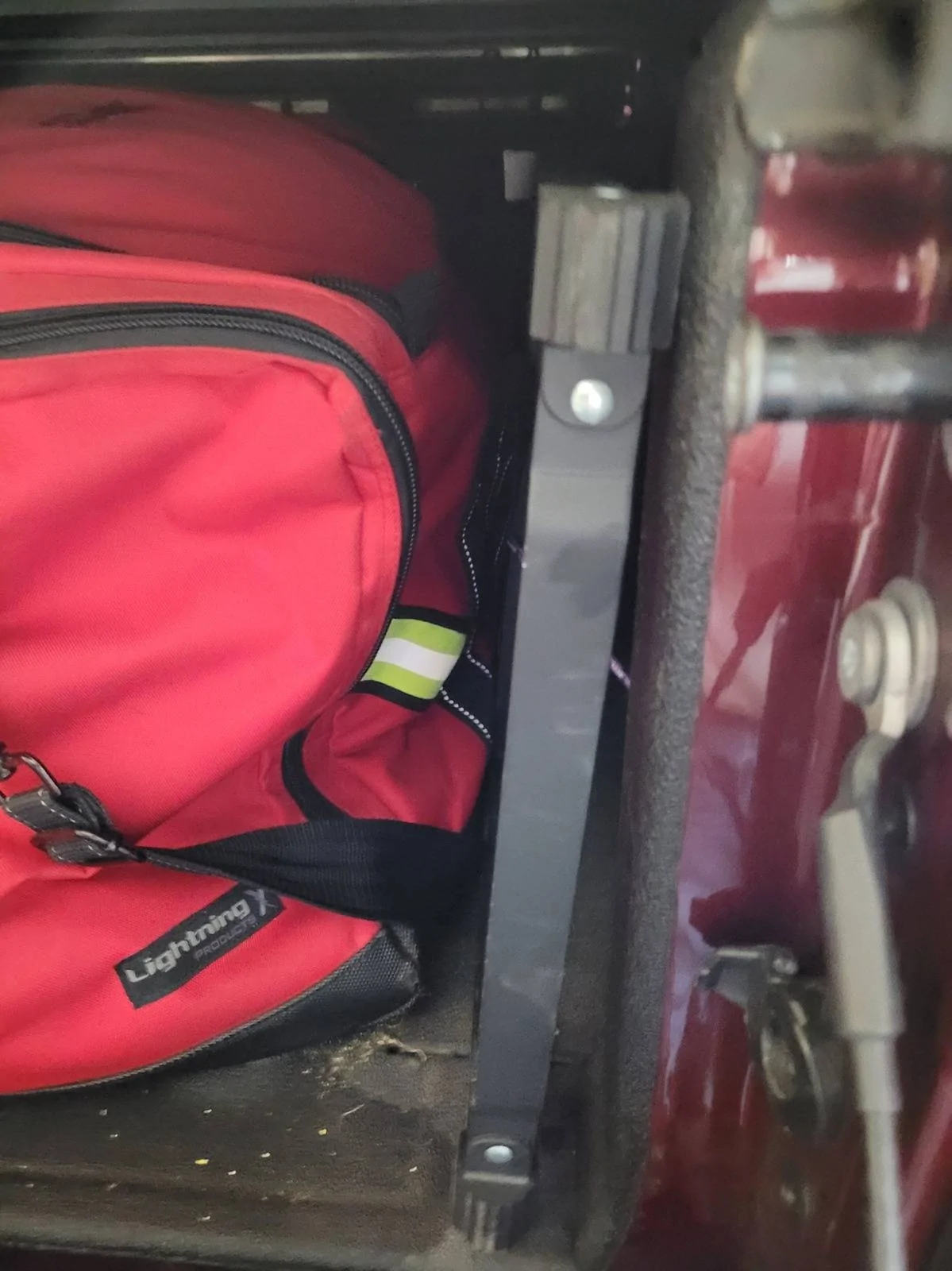

I have. I installed the Harbor Freight steps. I redrilled the mount and bought longer screws so I could reuse the factory holes in the tailgate. I made up spacers to go under the mount so the plate wouldn't flex when screwed in. I found that I did not need more than 2 bolts. The mount is solid and it's not going anywhere if you set the ladder up correctly. I strap the ladder to the side of the bed and pull it out when I need to get up in the bed. It works well. I did have it attached but with the way we use the bed, it sometimes got in the way of stuff in the back which is why I keep it detached.
Jeep Gladiator Tailgate steps. has anyone installed something like this? Opinions? ladder mount
Jeep Gladiator Tailgate steps. has anyone installed something like this? Opinions? Ladder stowed

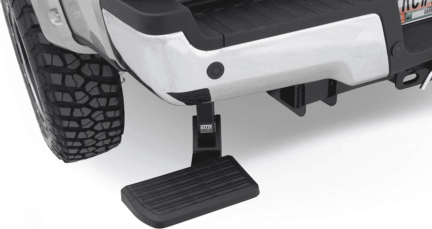

I do not have one like that - I bought the AMP Research Step (stock photo below - not my rig)
I love mine I also wanted to save the tale gate space to put a box/storage update.

Ouch. $329 for the Amp step.
I love the idea, can't get past the cost. I'm into the HF ladder for $50 including the hardware I got from Lowes to use the factory holes.

Ain't no way its worth that without being motorized

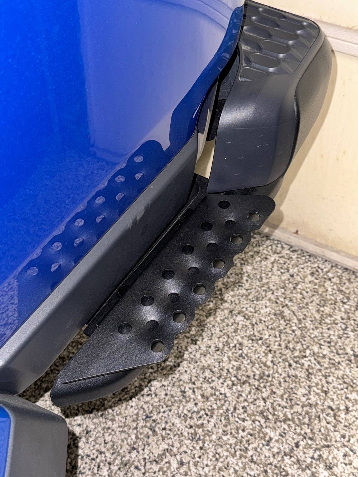

For $68, I installed these from M.O.R.E Offroad.
They just bolt up to the rubi rail.
I looked at all the others and nothing would work for what we use them for.
Jeep Gladiator Tailgate steps. has anyone installed something like this? Opinions? IMG_0594

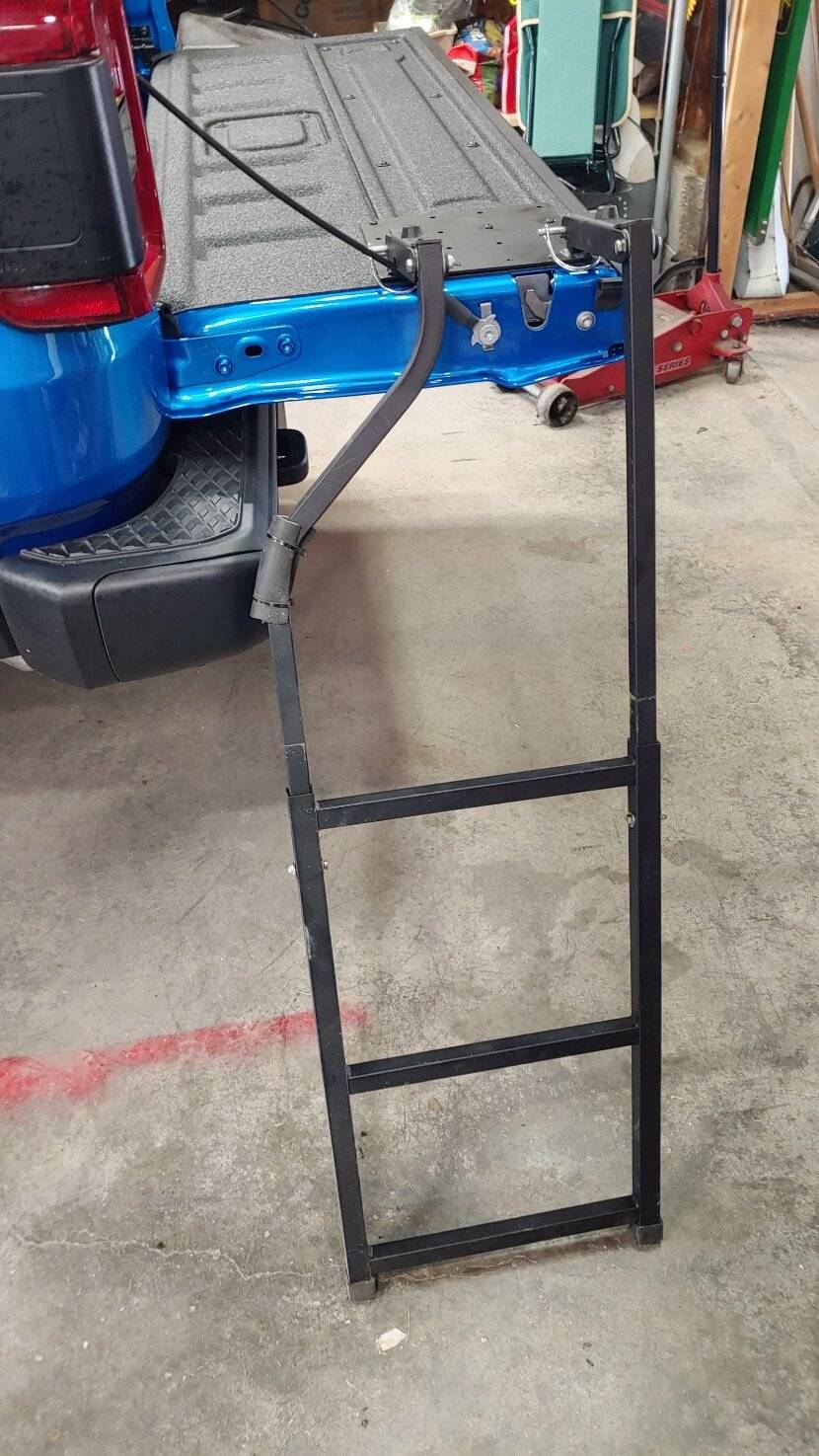

Just installed mine yesterday ?

+1 for the amp research step.
There is a Realtruck group buy thread where you can message them and get better prices. I got mine for 265 + tax w/ free shipping
