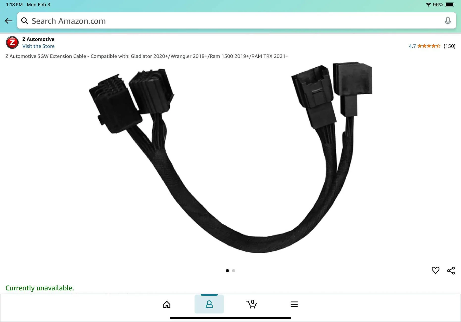

I’ve never had any communications issues with the extention cable……
I’ve only had the Tazer for about 9 months and have had it out a couple times.

Did you get the one from Z Automotive or did you get a generic one from Amazon or somewhere else?

I have the Z Automotive extension cable. Had it a few years now . No communication errors. My last update was when rhe pin code for theft prevention came out.

You're the second one to tell me they got it from Z Automotive. It's almost 3 times as much as some I've seen but sometimes you get what you pay for. Appreciate your input.
It’s a Z Automotive cable.

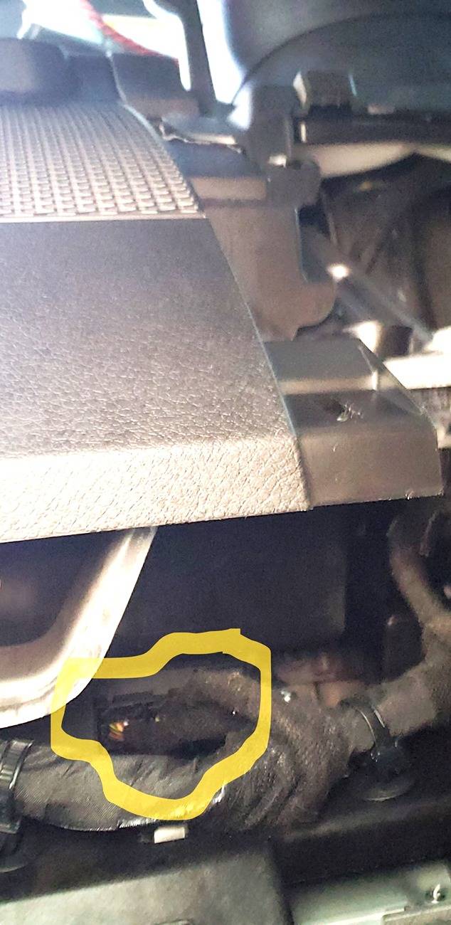

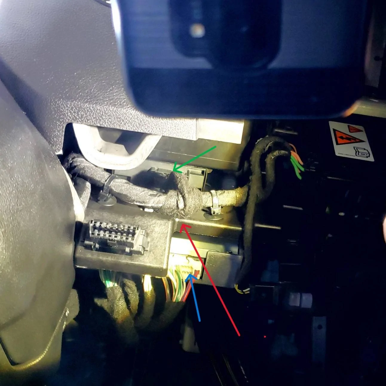

Here is what I did on my 2024 JTR X package:https://www.jlwranglerforums.com/forum/threads/extension-cable-for-tazer-needed.138946/post-2900946
In the 2024+ with the premium sound system, they added/changed the location/or size of the aluminum bar up there that makes access up there a real PITA (red arrow). Earlier model years are much easier (though still a PITA) to get to those SGW connections.(green arrow) Blue arrow is not the SGW connector (I think it is for the premium sound system amp)
SUGGESTION: wear mechanix wear 0.5mm gloves or something similar when doing this.

In the 2024+ with the premium sound system, they added/changed the location/or size of the aluminum bar up there that makes access up there a real PITA. Earlier model years are much easier (though still a PITA) to get to those SGW connections.
That sucks. Looks like its really tucked up in there and hard to get to.
