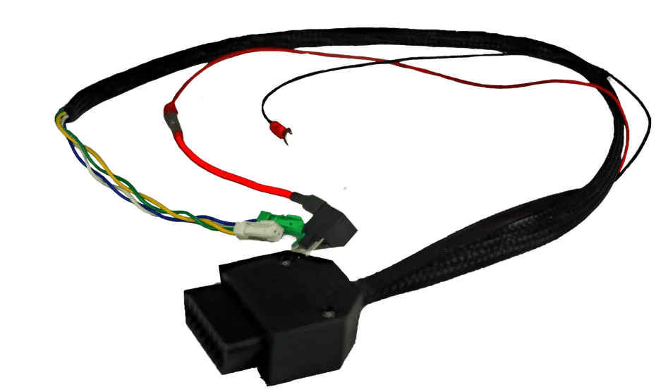

Joe @ ZAutomotive, a few weeks ago, posted on Facebook, that though he no longer sells the original Tazer JL, he will in the near future, be selling a limited supply of refurbed, original Tazer JL's... and that they will be sold at a very reduced price..
Actually if I was purchasing now, I would prefer the original Taser JL. Because you can use a Double Bypass harness instead of having to use a Bypass Module and having to plug/unplug the SGW all the way up there under the dash (other people and I agree it is a PITA).
Jeep Gladiator Tazer extension cables available...Stop chewing up your knuckles! double-by-pass
https://www.zautomotive.com/product/double-bypass/
Remove the glove box on the JT/JL and there are two Star Boards. Plug the green plug of the harness into the connector that has the green plugs, plug the white connector into the connector that has white plugs. Any available slot will work on both connectors. Then supply +12 Volts to the red wire and ground the black wire. This is a secondary OBDII port that bypasses the SGW.
This secondary OBDII port can be used with the original Tazer JL but with limitations of not being able to communicate with the radio, so the Live Functions; Navigation In Motion and TurnCam won’t work (maybe some other radio dependent Live Functions I'm not aware of.)
Oh, the Good Stuff!
Plugging an OBD adapter (like OBDLINK MX+) into this secondary OBDII port, 2018+ Dodge/Chrysler/Jeep vehicles can communicate with alfaOBD (and Jscan?) without the need of a Bypass Module.

Oh, the Bad Stuff!
It won't work with The Tazer Mini
