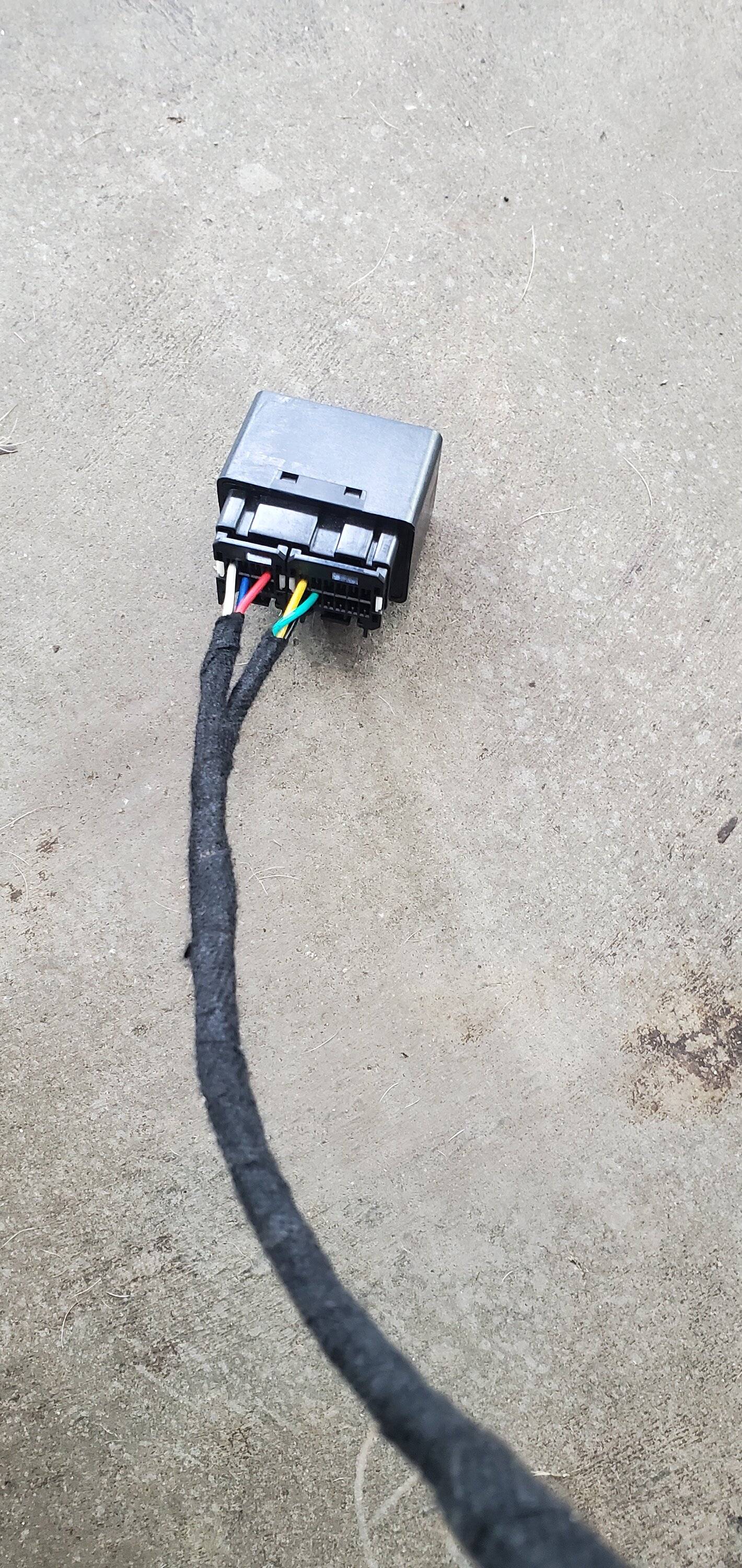

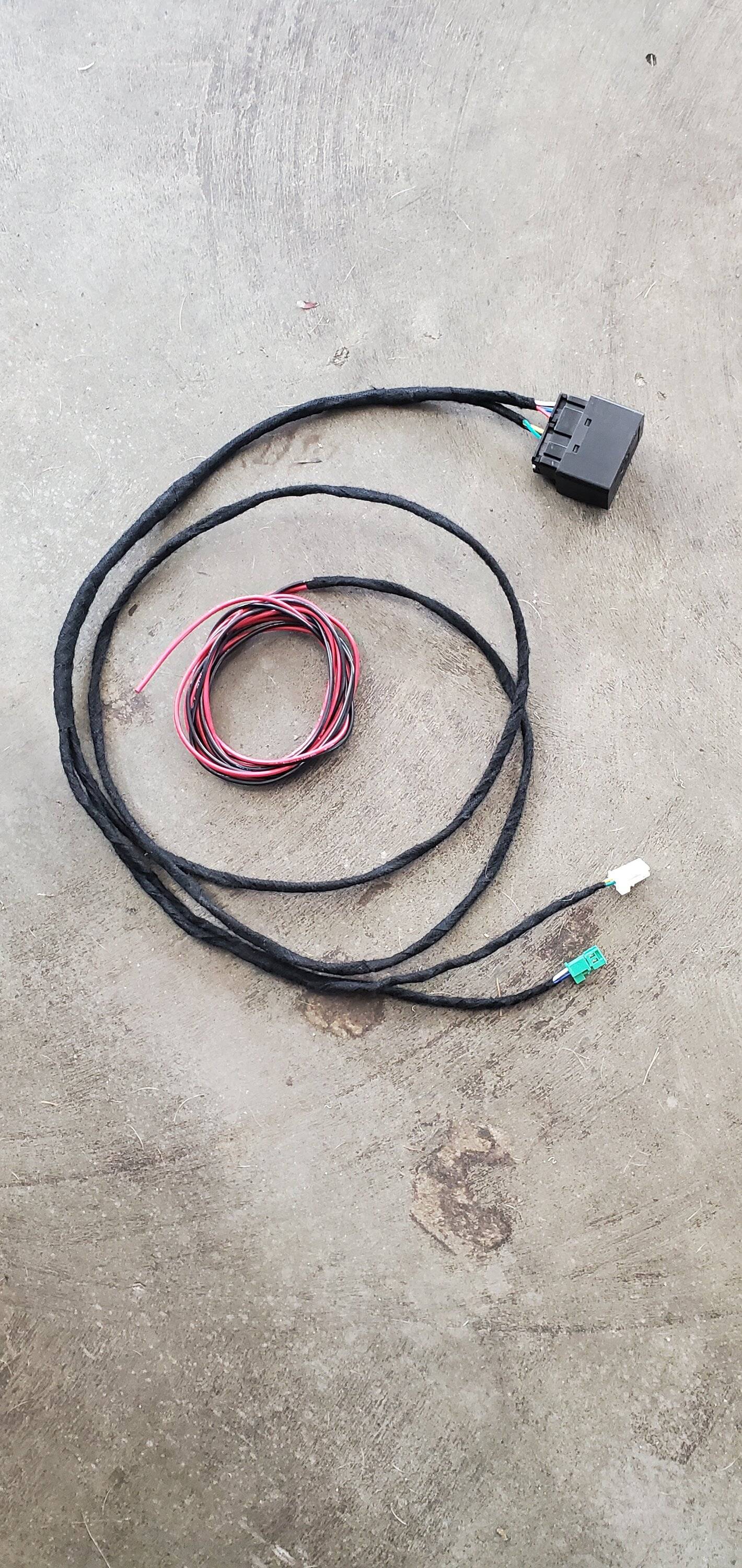

So made the harness off of Jimmy's pictures and instructions and installed it. It works perfectly. The SGW is plugged in, no bypass at all. It is hidden, so no thief will find it to unplug it.
Thank you again Jimmy!
I will start a separate thread with more info on this and the other pin lock options.

I am a stickler for looking factory... I used Tesa tape just like factory.
The connections are Soldered and heat shrunk.
There are a few star connector blocks in the jeep. There are some behind the back seat behind the panel... no theif will have the time to take all that out to get to the Tazer. You could also put it under the center console and run the wires to the star connector blocks behind the glove box.. a lot of options.
Only thing I don't know is what would happen if you left the Tazer in while the dealer programs the truck. The SGW is plugged in, so they should be able to program the truck.

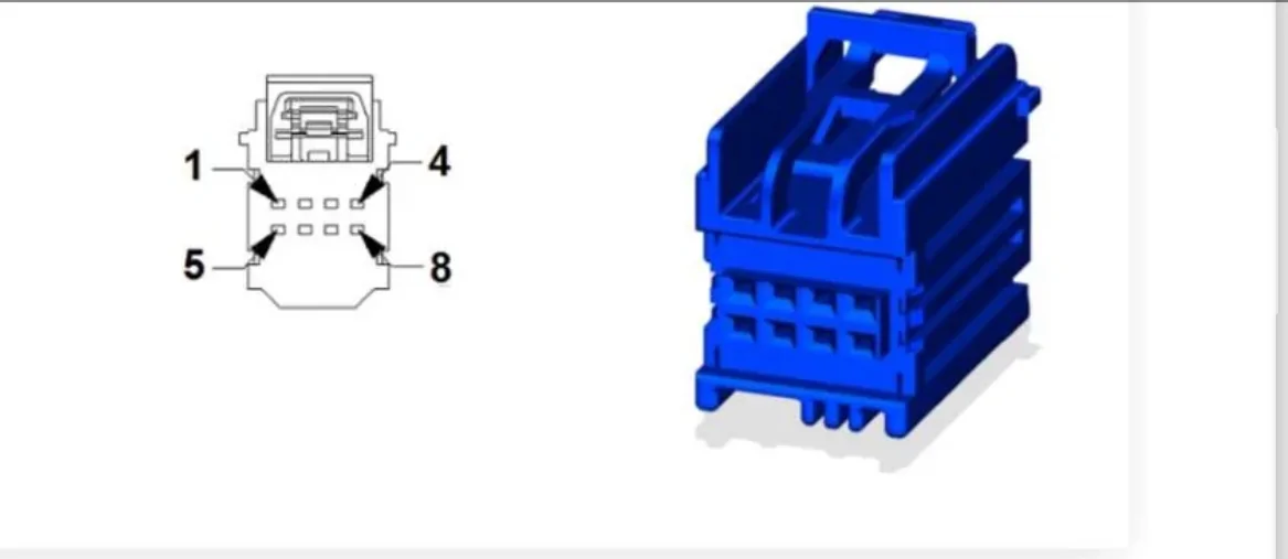

What is this 8 pin connector and where can you get them?

I just bought a sgw extension cable and cut it up, that is where I got the plugs that go in the Tazer mini… I know you can get the plugs and pins from somewhere (I couldn’t find them) but for me buying the extension cable was the easiest.
Amazon has the extension cables
Yeah, that's what I did...was hoping for the actual mopar connector, but Ill take what I can get. Thanks man! :)
