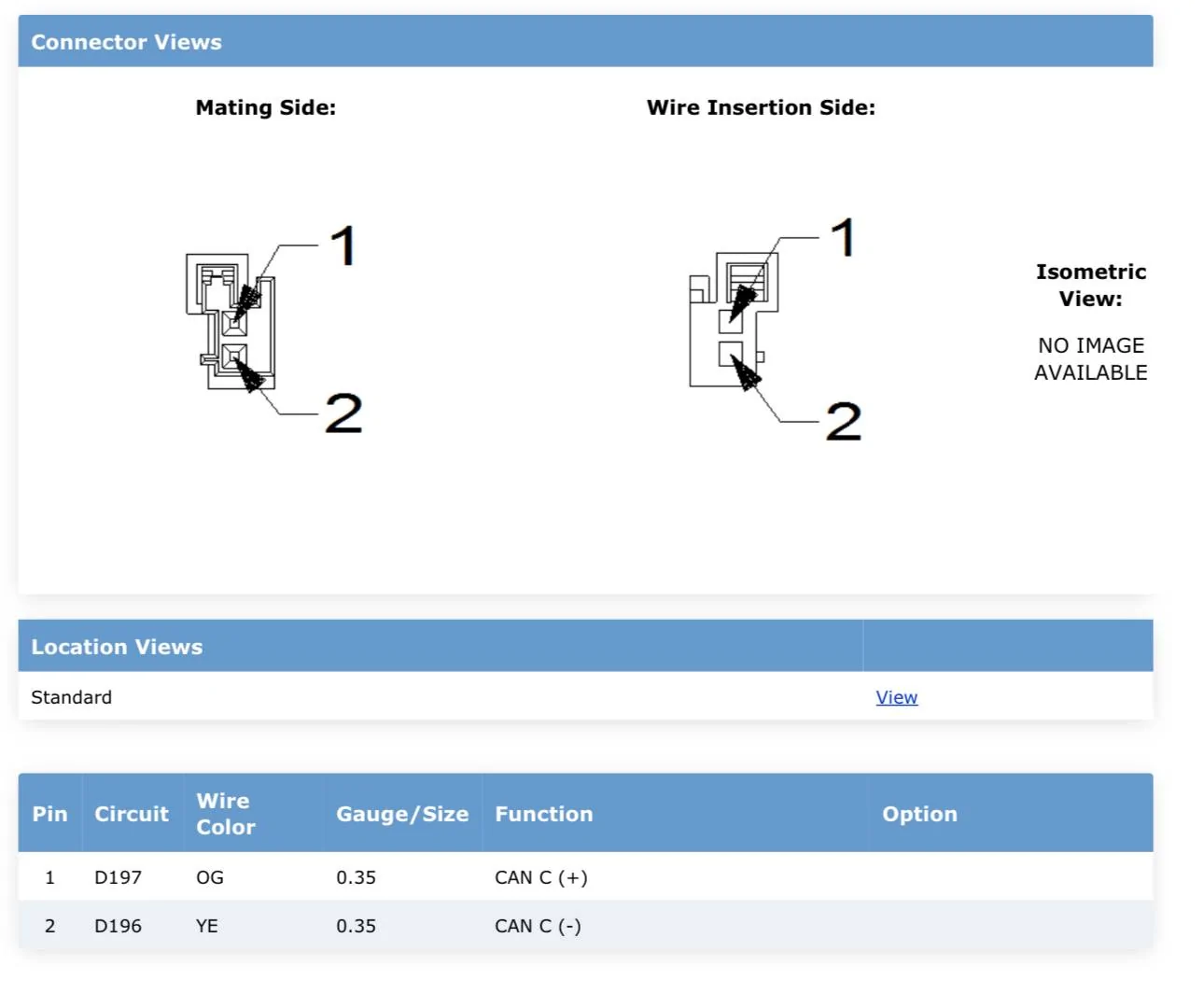

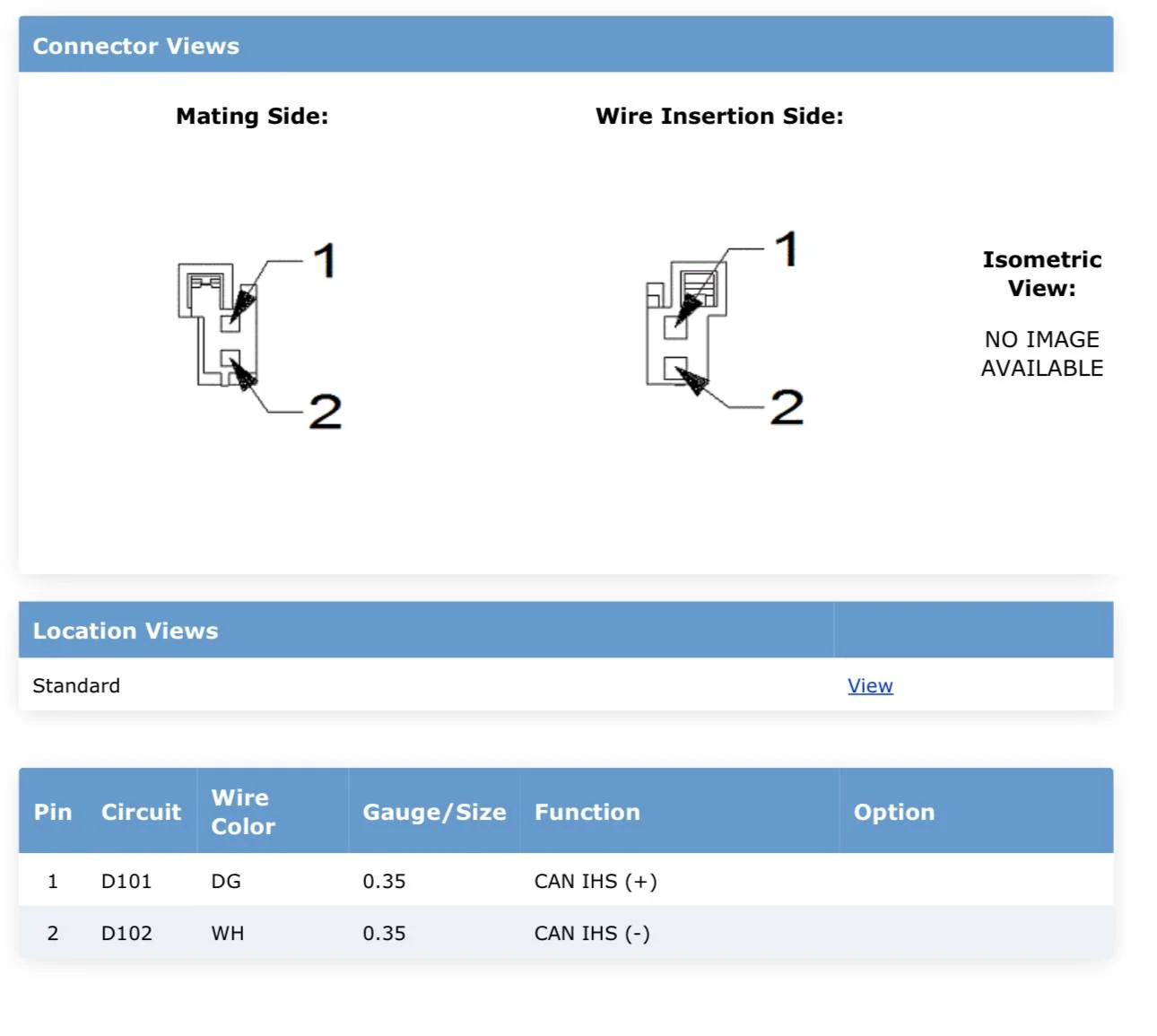

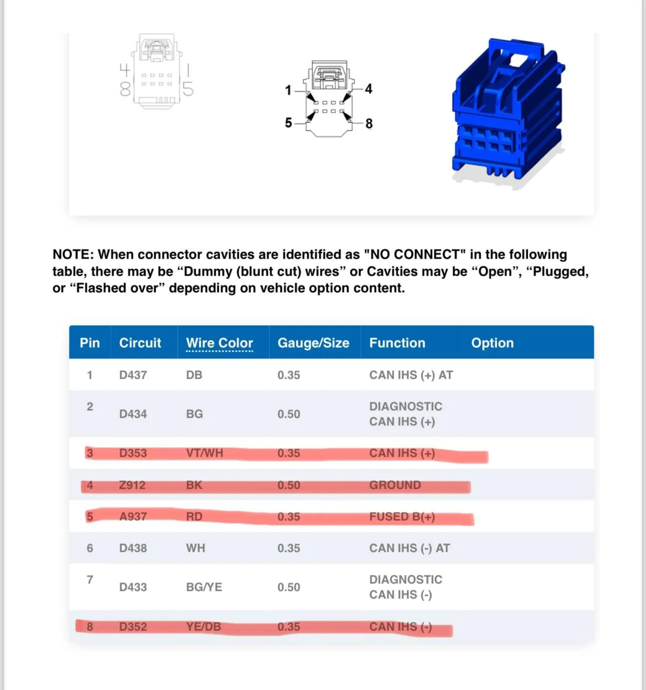

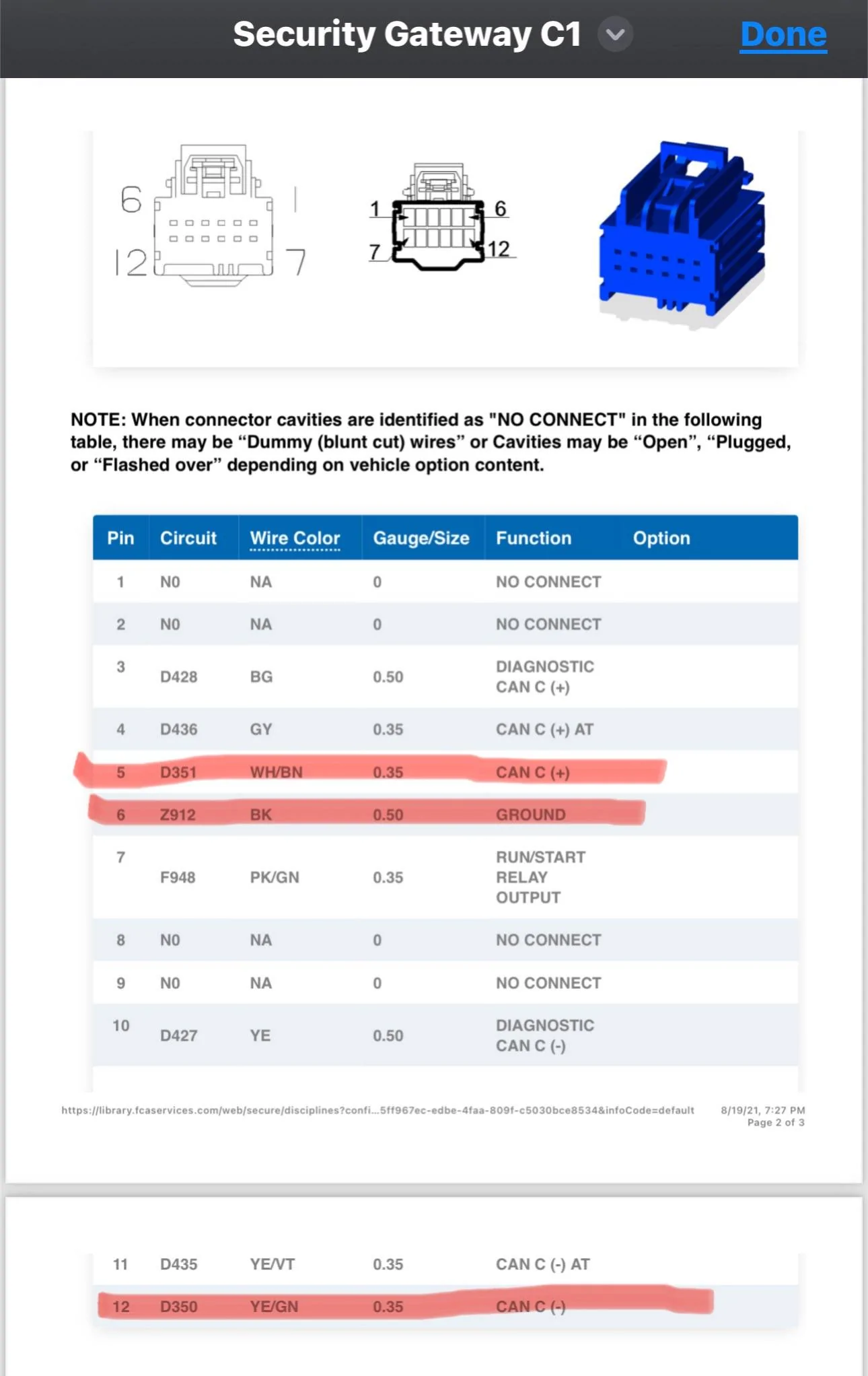

Ok, I DID have to re-read a few times to finally get it to click what you are looking to do. I think an easier way to frame the question for a direct answer would have been “how do I hook up a tazer mini somewhere in the vehicle WITHOUT using or disconnecting the SGW and its connectors.”
Here’s the wires you would use on the two female sgw extensions that plug into the tazer mini:
Jeep Gladiator Tazer Mini Pinout.. IMG_0020
Jeep Gladiator Tazer Mini Pinout.. IMG_0019
You’ll tie those wires to the canbus/constant power tap/ground of the double bypass. The green connector on the double bypass is can IHS, and the white is can C. Here are their pinouts:
Jeep Gladiator Tazer Mini Pinout.. IMG_0023
Jeep Gladiator Tazer Mini Pinout.. IMG_0022

Jimmy thank you! It is very hard to explain over a thread what exactly I am doing but I think you got it.
I will give it a shot and see how it works.
For most people the Ampire will be perfect. Unfortunately for me I don't have factory UConnect so I can never have the Jeep app for remote start. In fact it was you who explained that to me many months ago...
