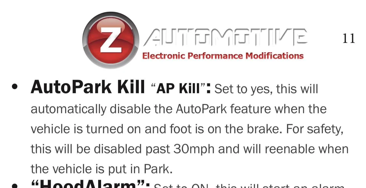

I have a 20 gladiator that came with tazer mini on it. Is there a setting I can change that lets me drive with door open. Right now if door is open and I put it drive or reverse Jeep will not let me go. Thanks for any help.
Should be default. I just installed one this weekend. Forgot about this option but I was out testing other things and I did open door going in reverse and Jeep didn’t stop
Jeep Gladiator Tazer setting questions door open in drive IMG_3465

Also, all you have to do is shift back to park, then drive or reverse again and it disables it anyway. It's there as a level of safety, but if you knowingly choose to shift back again, it will work.

I believe that only resets it, not disables it. Meaning if you activate the auto-park by trying to drive with the door open and the seatbelt off, closing the door or putting the seatbelt on isn't enough. You must also move the shifter into park before you can move again.

Correct. It would have to be done every time, but it adds an extra level of safety and it's not too inconvenient to take 1-2 extra seconds to intentionally shift back to park then D or R so the door can be left open for visibility.

Try it with the seat belt buckled.
That’s the ticket. It’s only mad if the seatbelt is unbuckled AND the door is open. I have a ‘21 and have retrained my brain to just open the window. It used to drive me absolutely nuts. Then my wife told me she has a tendency to leave cars in drive. So now I consider it safety for my jeep. My wife will be fine. She’s durable.
